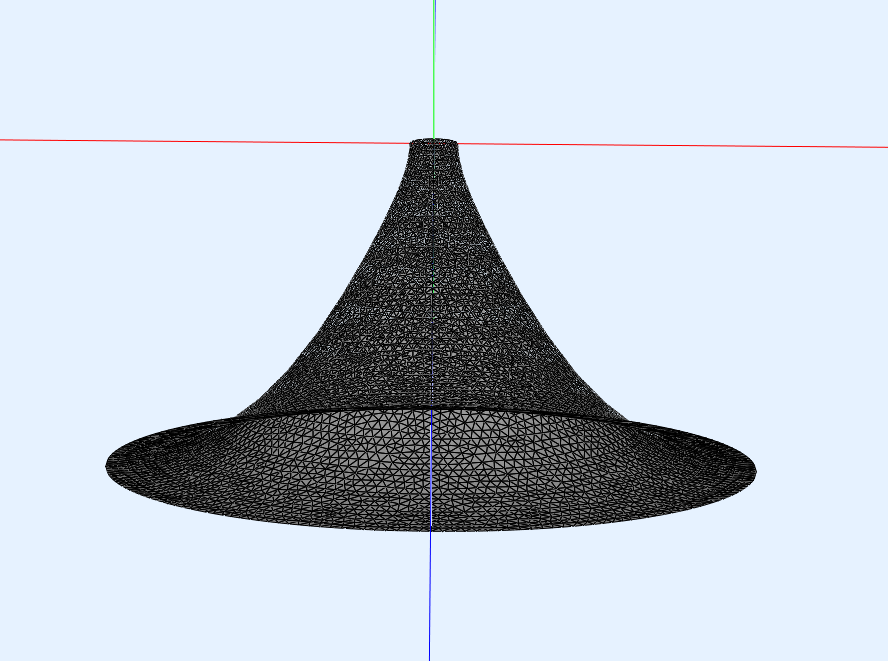

Can somebody post the ABEC results of a good horn they have simulated?
I'm trying to design a 3cm throat / 30cm mouth one and looking for inspiration 🙂

This is what I would recommend: #1402

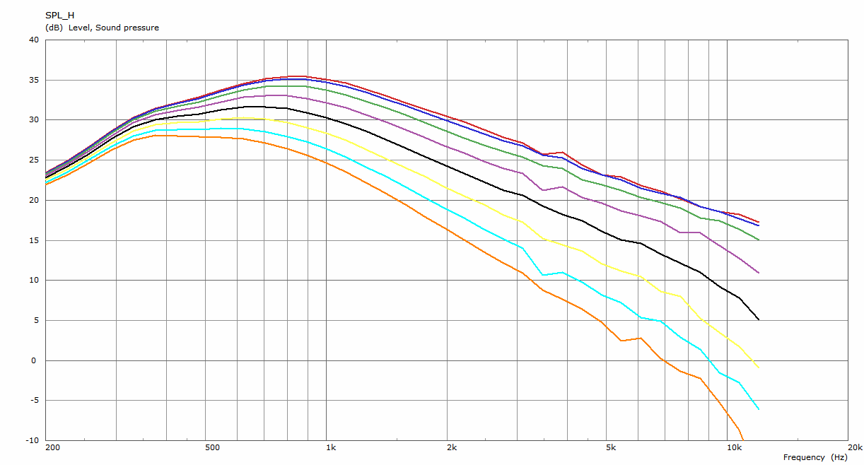

It has elliptical guiding curve and circular mouth. The result is remarkably smooth, still of reasonably CD and almost without a hint of narrowing.
If you prefered rotational symmetry because of the ease of manufacturing, this would by my bet: bmc0's waveguide (should be possible to come very close to that shape with Ath)

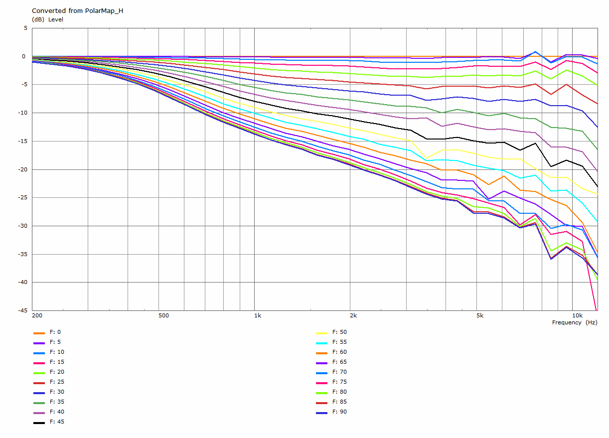

If I were ever to use a large format 2-inch driver as a wide-range source, it would probably be with something like this (27" x 14") -
(There are some numerical defects above 3 kHz, probably still due to mesh coarseness, otherwise it should be pretty smooth.)

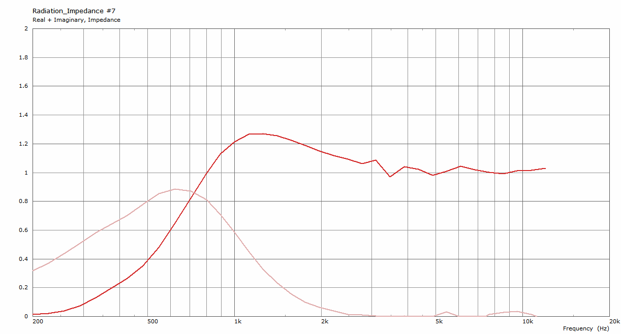

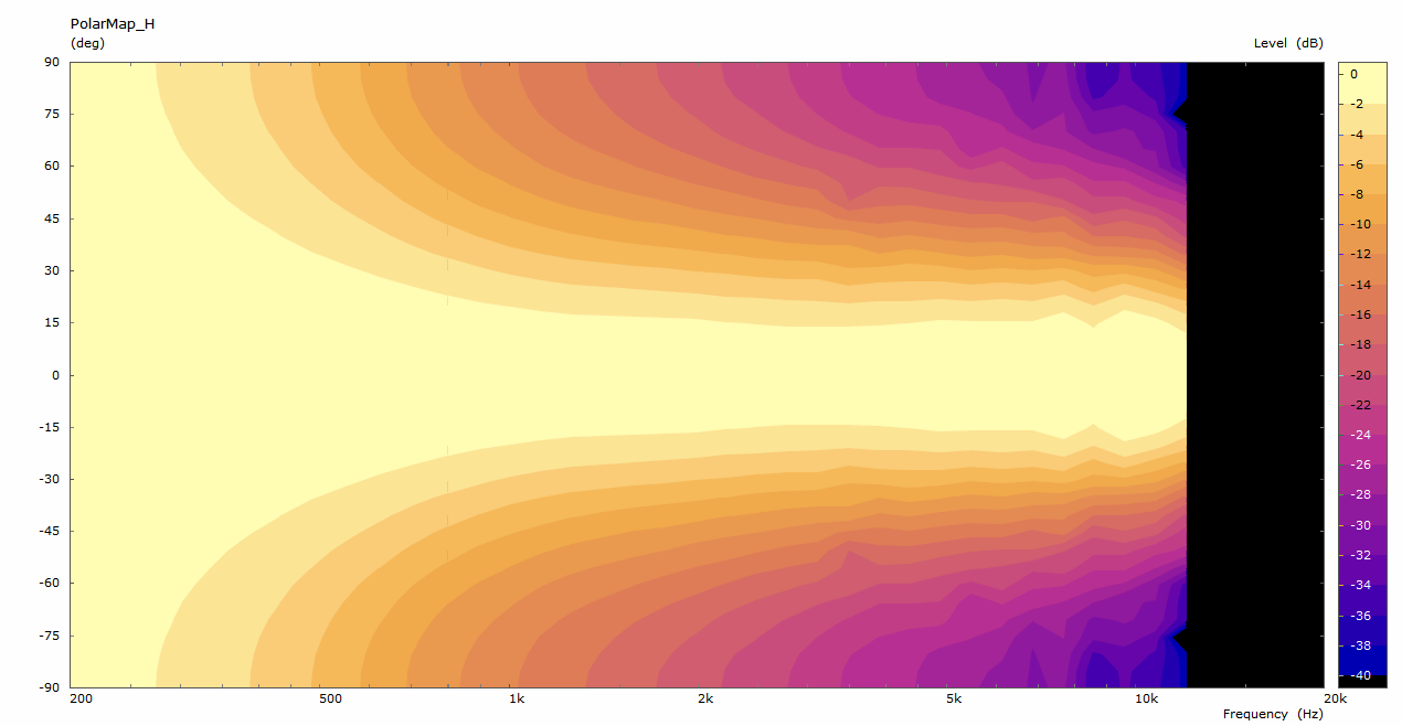

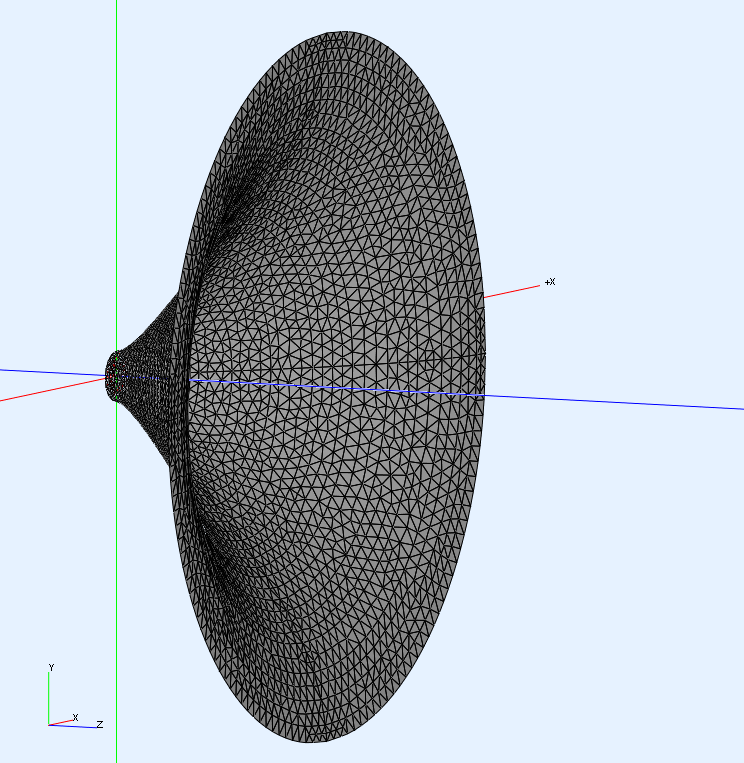

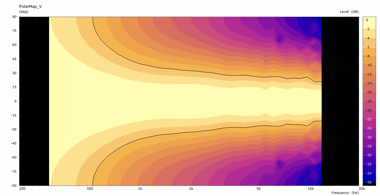

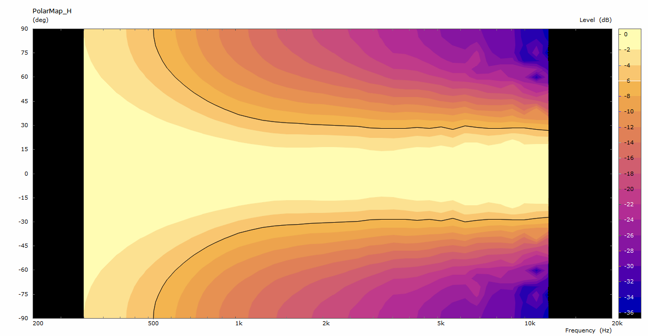

BTW, this is what I get for a waveguide probably not far from what bmc0 has shown in the other thread (0 - 90 / 10 in an infinite baffle; normalized at 15°). It is stricly axisymmetric so that makes it harder to get rid of the ripple but I think what he achieved is already pretty good for the size.

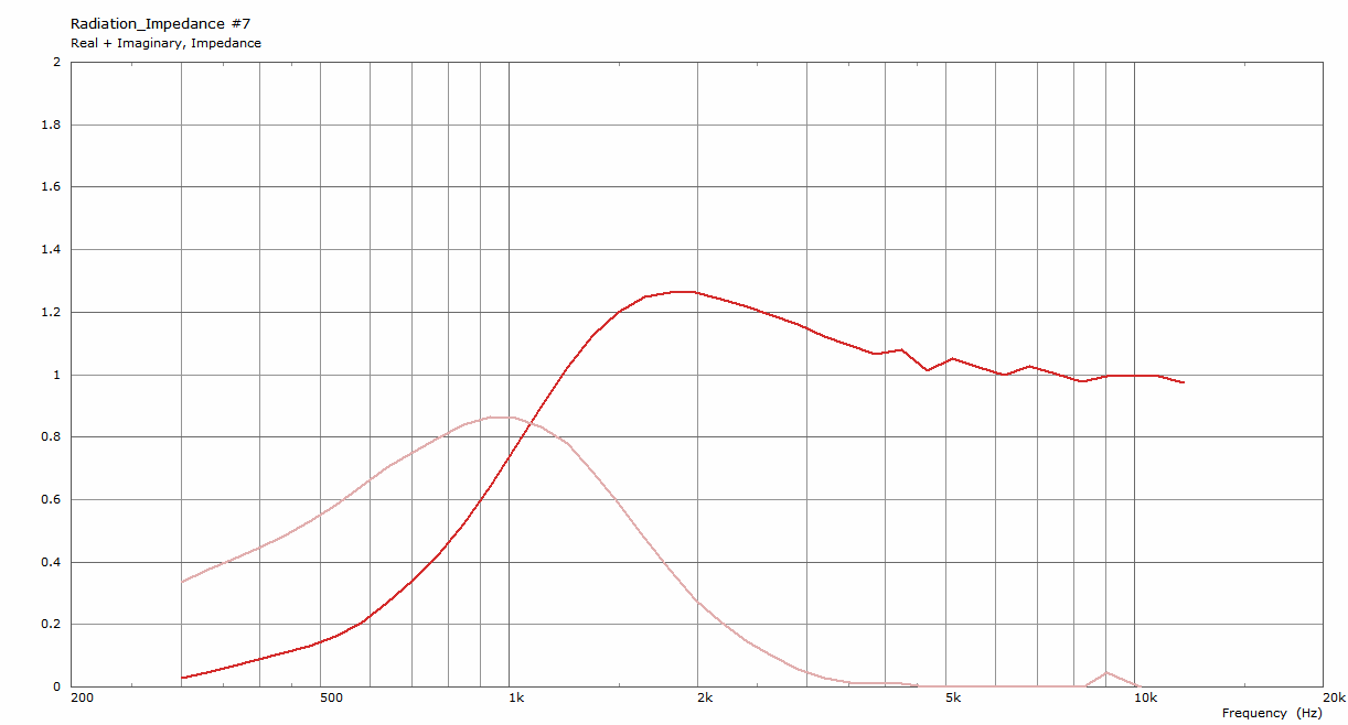

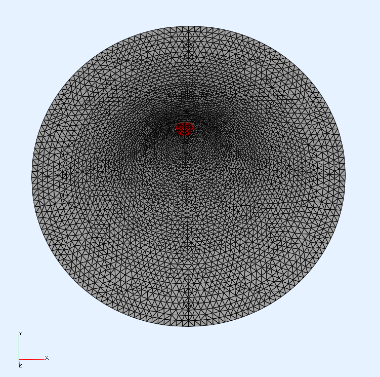

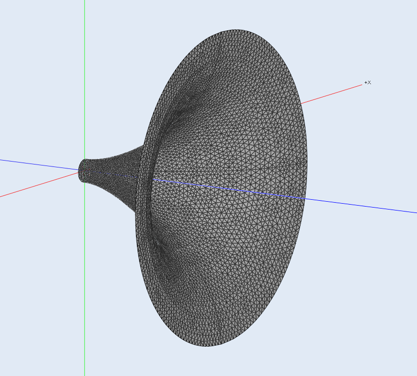

And this would be my waveguide for B&C DCX464 (24" wide x 12.5" deep) - about 60° nominal coverage. Maybe a bit bigger.
This one is axisymmetric?
