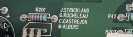

Hey @AcoustatAnswerMan just stumbled on this thread. I recall a model 8' tall maybe 10-12" wide, am I crazy? Is that the 1+1? Thomas Dolby's "Mulu the Rain Forest" sounded really amazing through those.
Yes, all of them. James Strickland, George Rocheleau, Carlos Castrejon, and Mark Albers. I think Mark is the only one remaining at Rockford.
