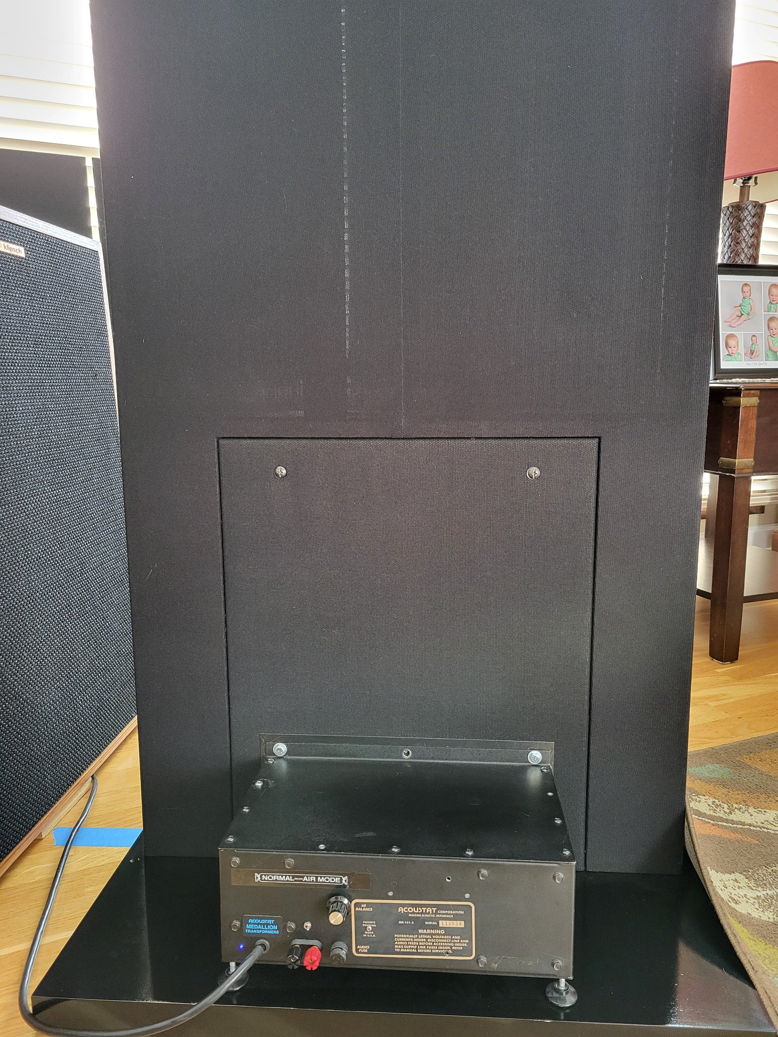

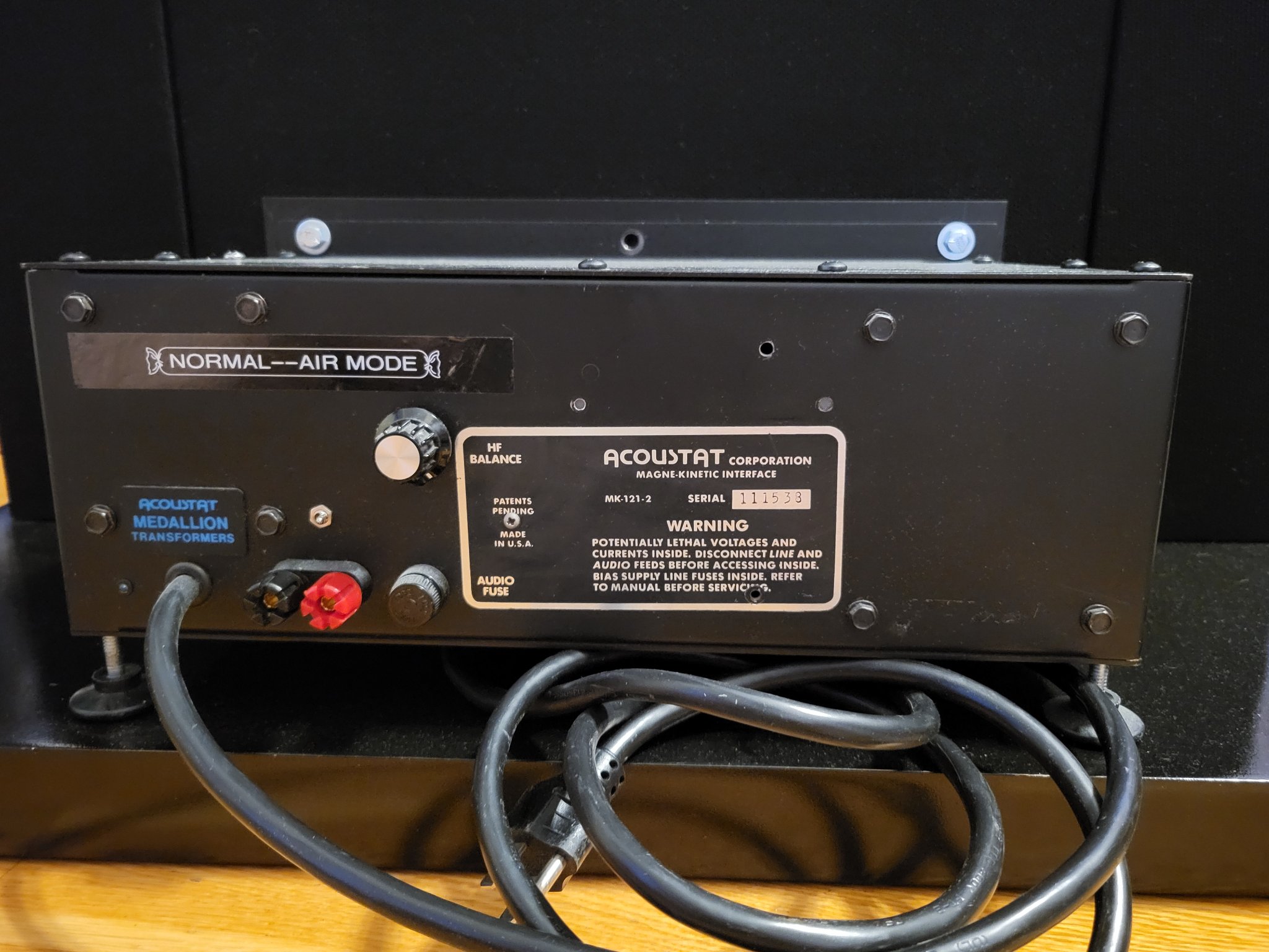

Hello,

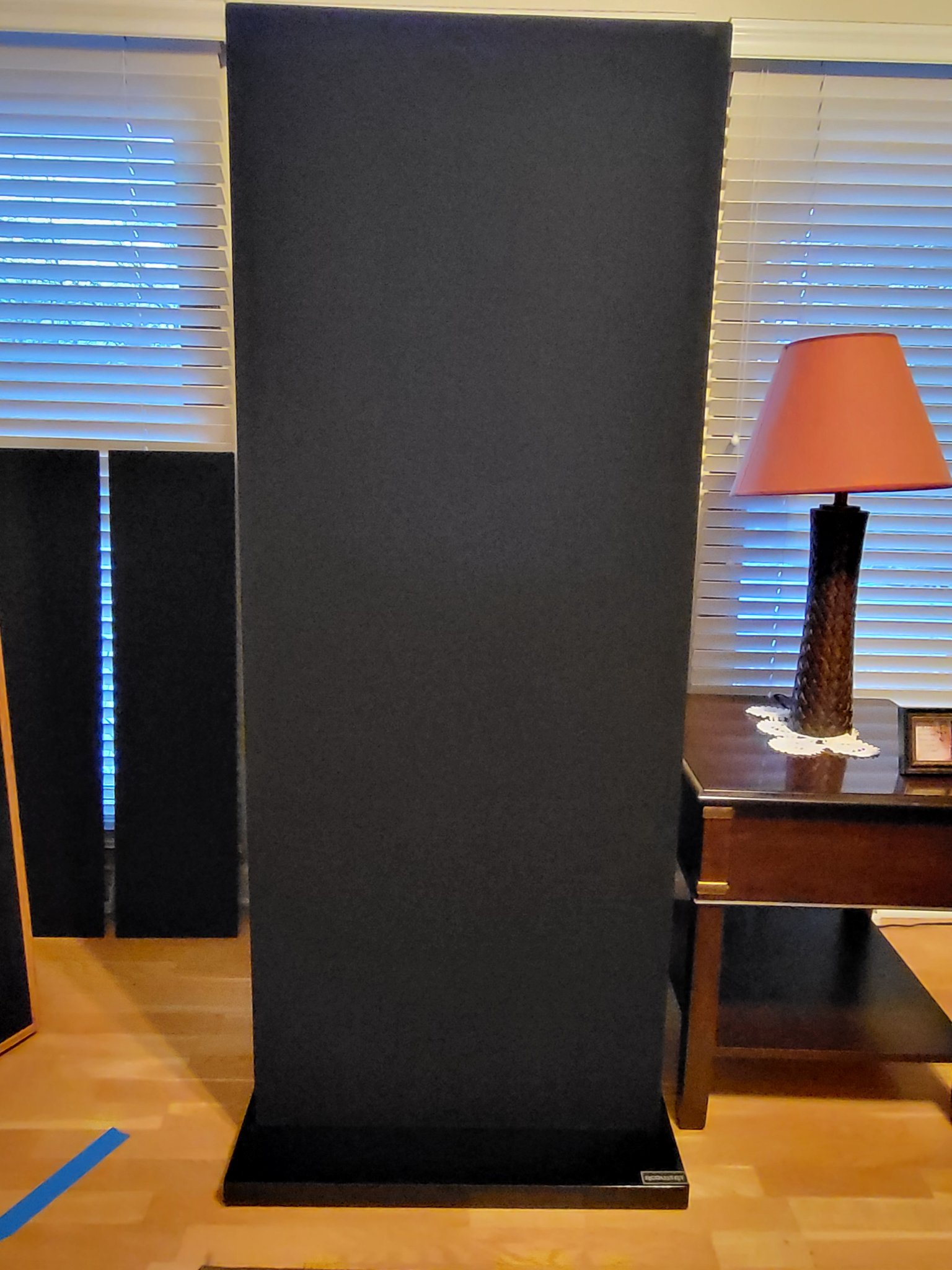

I own what l was told was a model 3.
On the back above the interface there is what looks like a hatch that is screwed shut. I am wondering if someone can give me a definitive answer if these speakers came from the factory as is or were they modded at one time.
Thankyou for your time,
Tim
Tim
The model 3 did not look like that - but as long as the panels are two 9' panels flanking a single 8' panel, and the interface is stock, it should sound same. That "hatch" appears to be a part of the panel to base support.

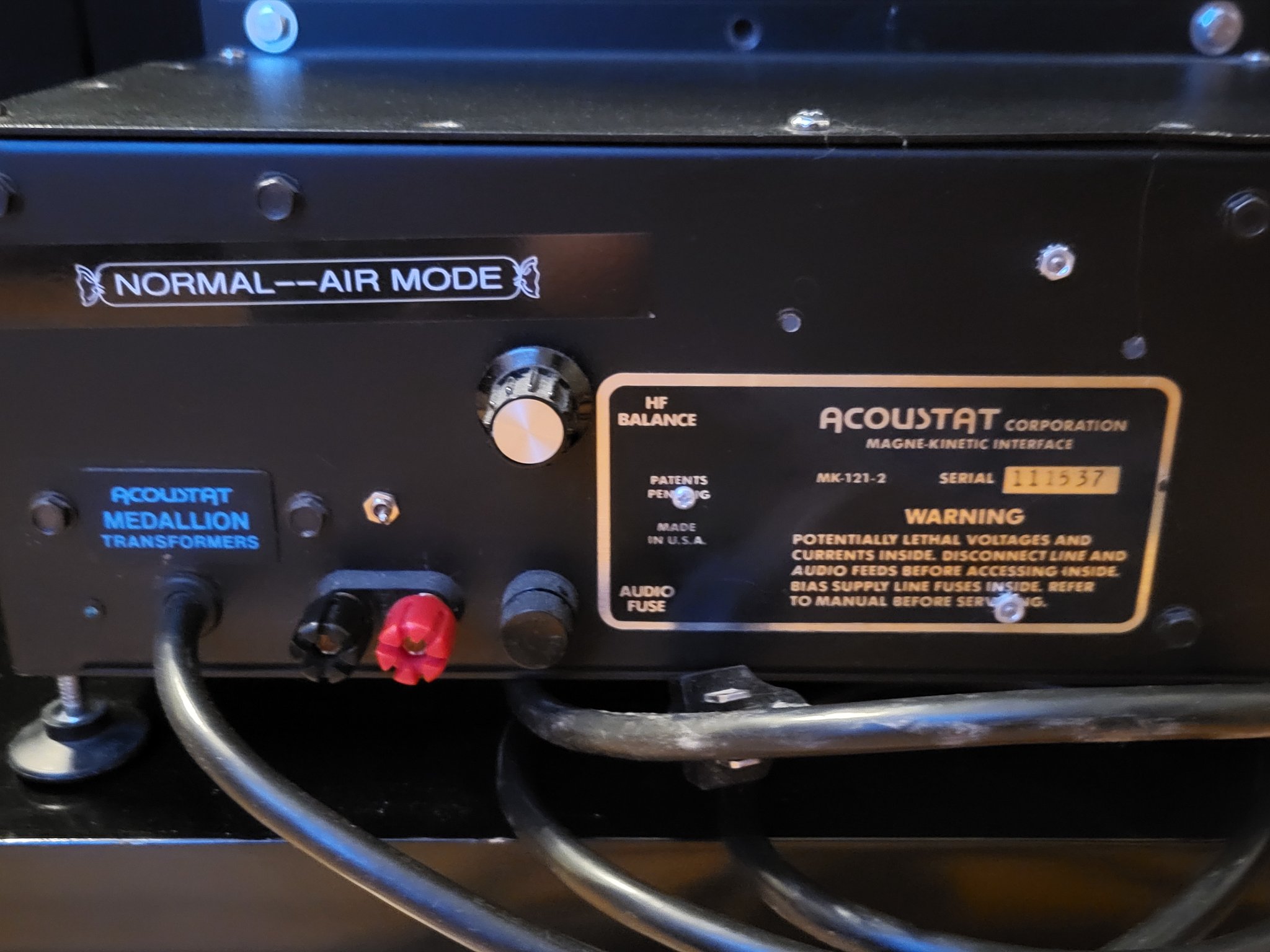

Looking closer, the speaker posts are not original, and appears to have some work done inside...maybe interface has been modified?
What you have is a Model 3M. The hatch on the rear is factory original and was provided for attachment of an optional woofer module, in which case it would be called a Model 3MH, for Modular Hybrid. These speakers used the limited frequency range interface MK131. You have the full-range interface MK121, thereby making it operationally the same as a Model 3. The M/MH series was a "great idea" that didn't last very long, compared to the long-lived Model 3.
Your interfaces were modified by Sounds Like New. You can likely trust the work that was done by them. This pair is in pristine shape - thanks for sharing an unusual model.

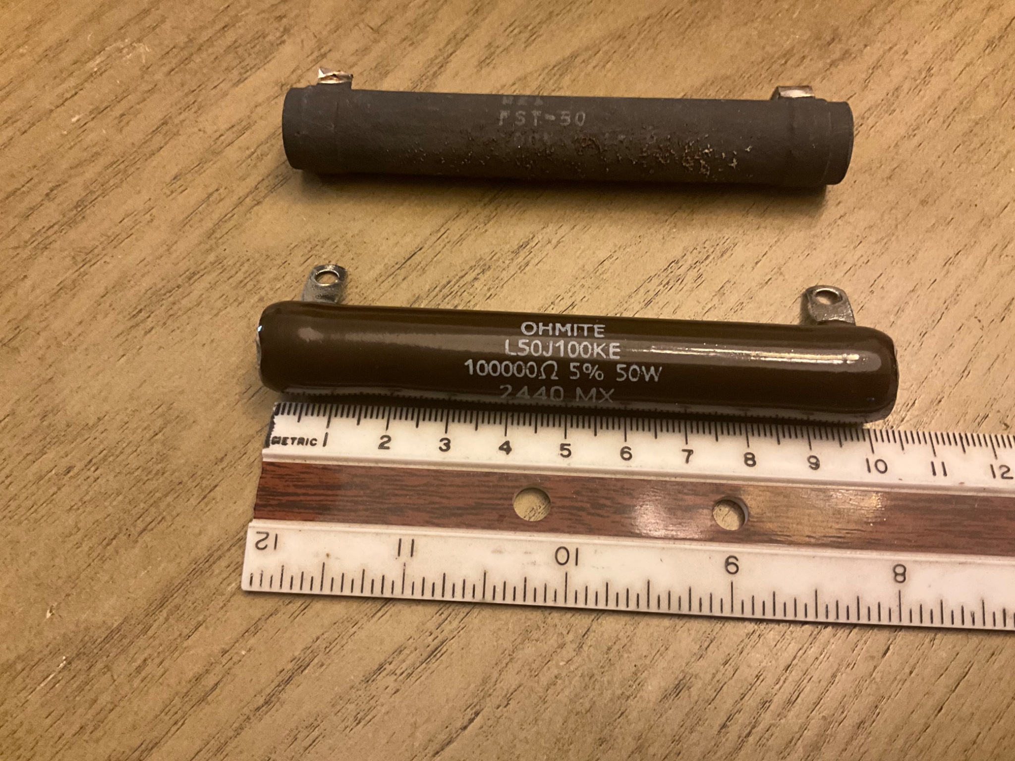

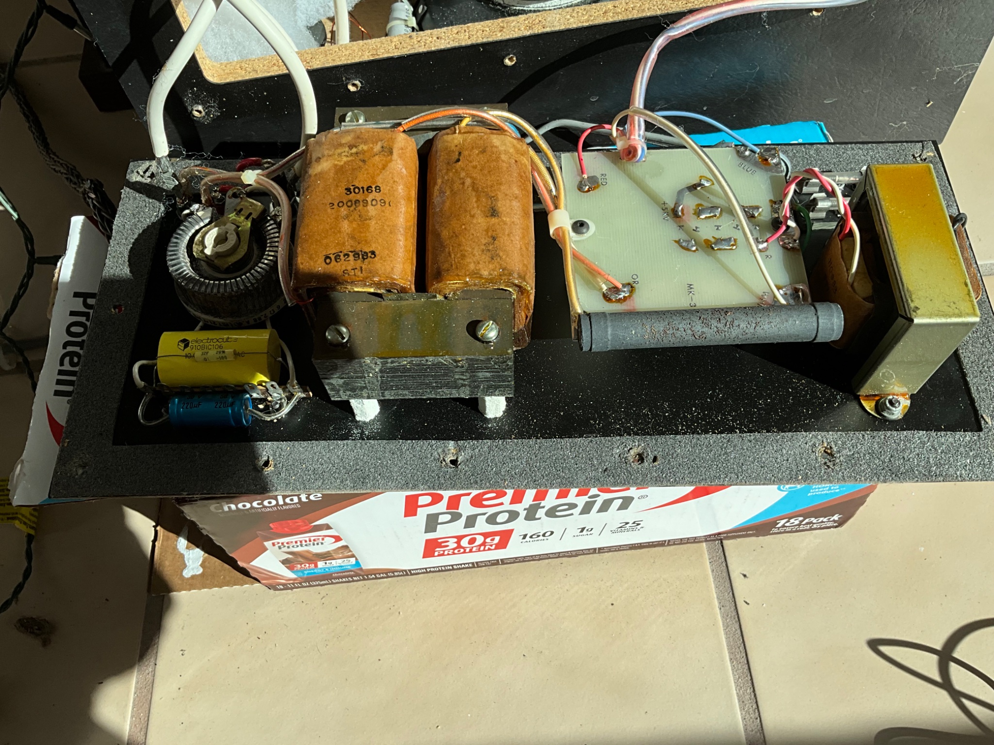

Hi. I have a pair of Model 3MH speakers . The back plate says Mk131 interface but I believe they are 141 due to the 100k resistor present.see photo of (new next to the old).
One of these resistors fried and it melted the panel wires. I resoldered the wires and kept the back open during a test play. The resistor was glowing orange and shooting sparks when turned to high volume levels. At lower volume the speakers still sound good. I’m wondering what else might have been damaged. I have had trouble finding an exact replacement for these 100k 50watt resistors. I found these in the photo at Digikey but they are only rated at 2440v. Do they have to be minimum 5kv rated? If so does anyone know where I can find a pair? I have seen some rated that high but they are too big to fit on the board. Should I replace all the caps and diodes while I’m in there? Thanks for any suggestions.
I think the resistor you found will be okay as long as its physical length is about the same. The part does not need to be rated at 5 kV. Acoustat used a variety of vendors for this part, and voltage rating was never a key parameter. I do find it odd that the resistor was "glowing orange and shooting sparks". This could indicate a problem elsewhere, or not. Failures of that resistor are unusual, so I don't have much experience to rely on in this case. I would suggest you replace the resistor, and make sure no wires are touching it after final assembly. Then proceed carefully to see if you fixed the problem. If not, write back and we'll go from there.
Thanks for your answer. I’m changing the resistors now. Will see what happens. High humidity where I am in San Diego near the ocean. Perhaps 40 years of moisture contributed to the problem? The resistors had some surface corrosion. Hope the other parts inside are ok. Thanks again.

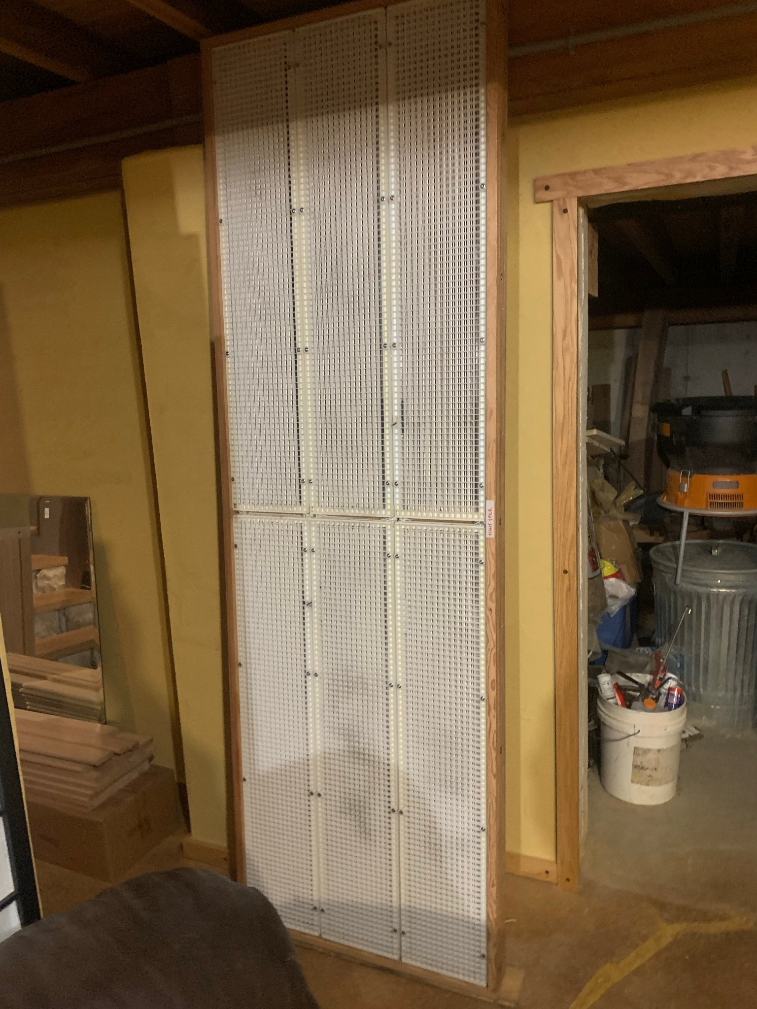

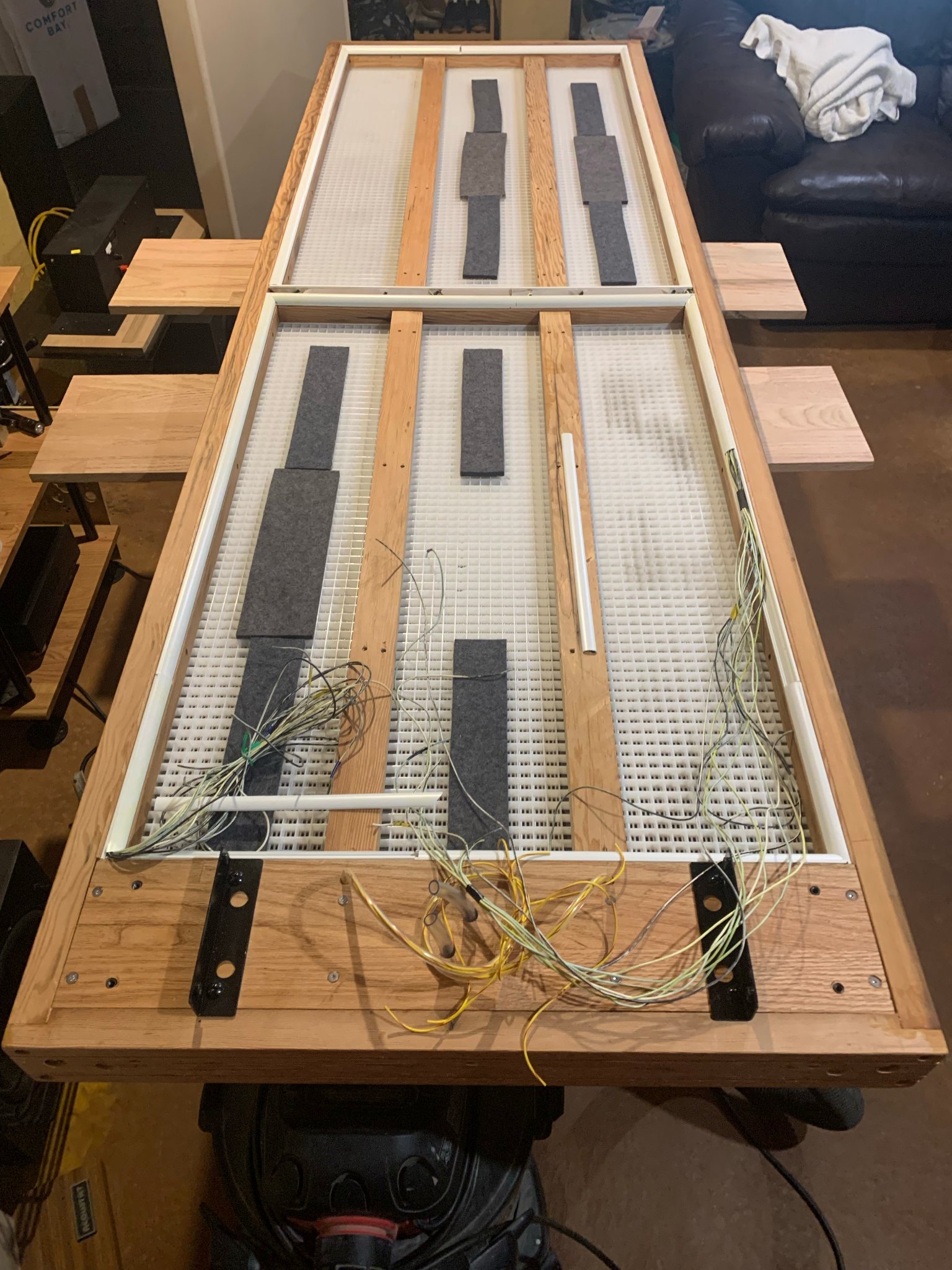

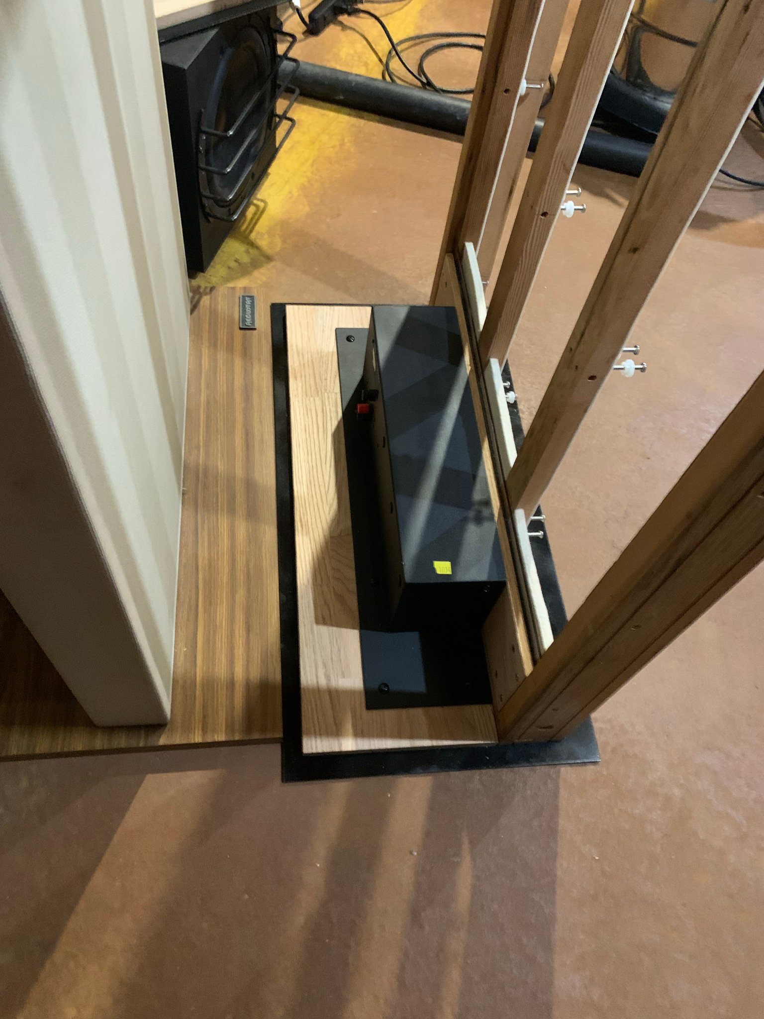

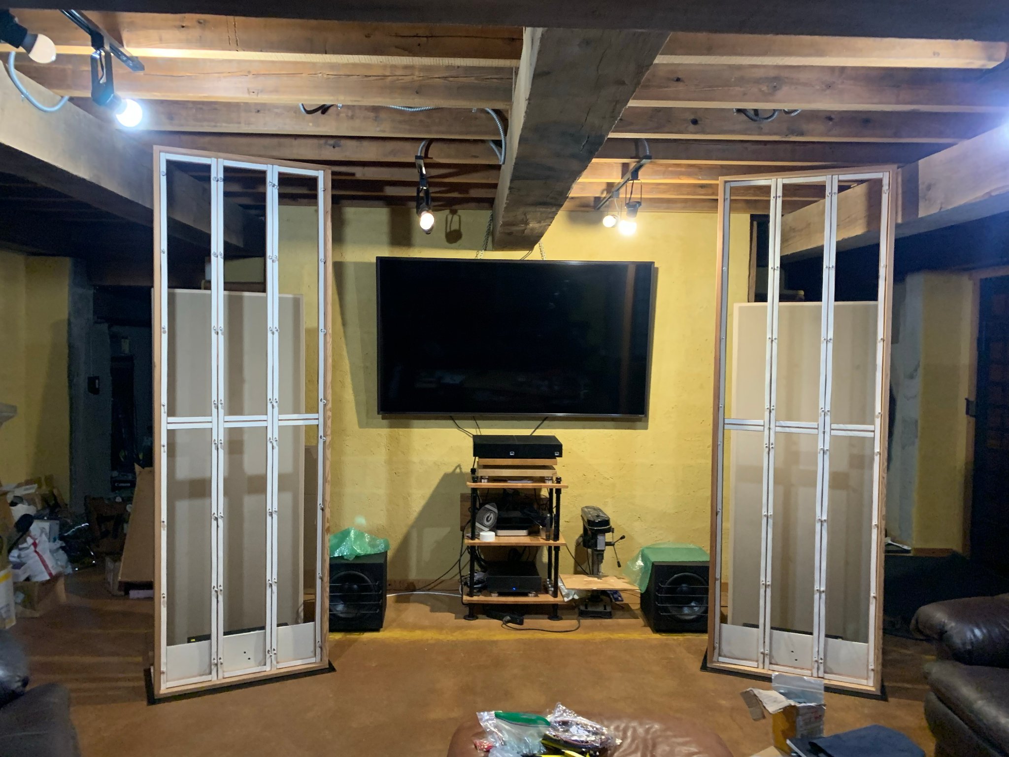

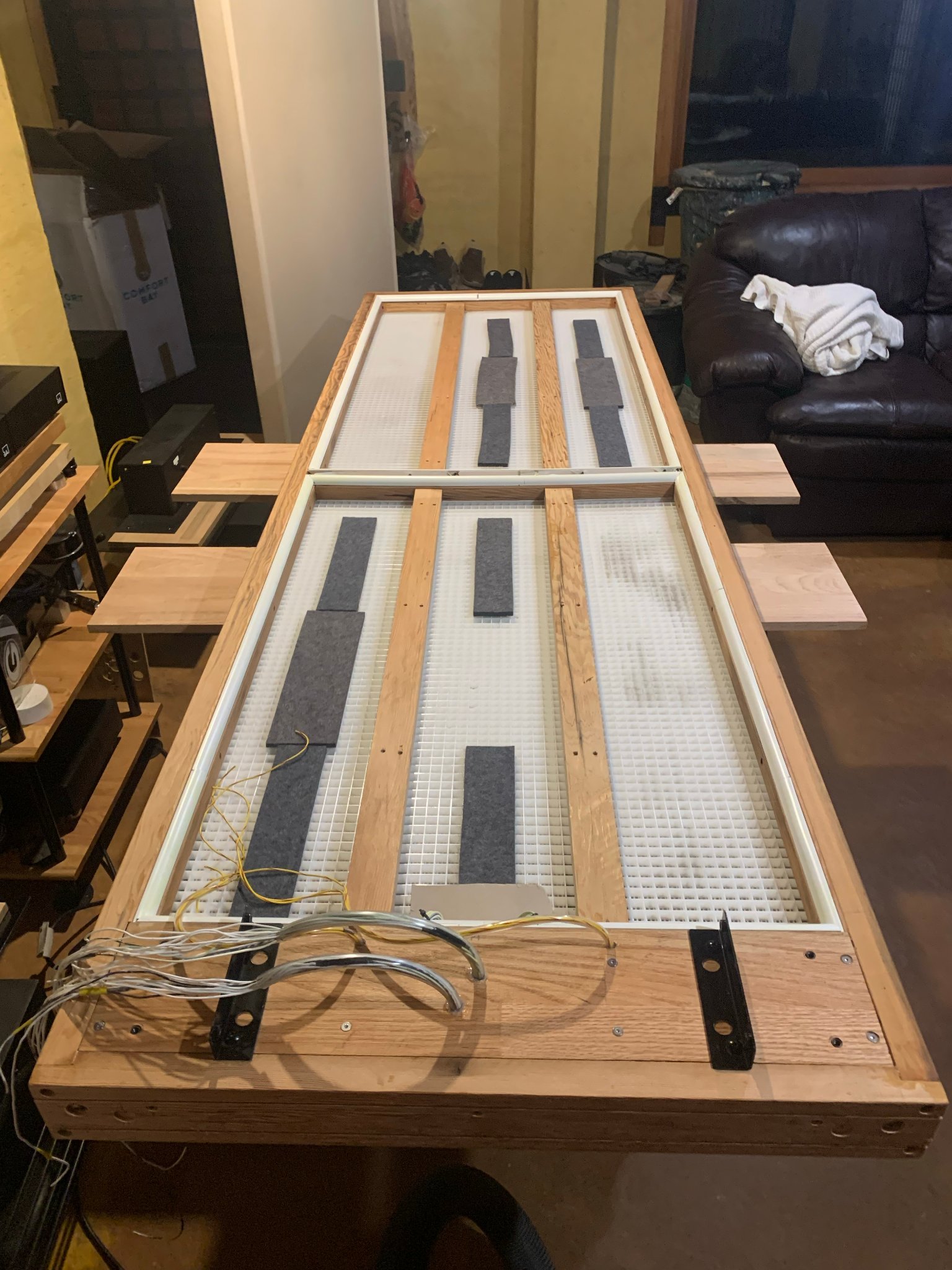

Getting near the finish line on the new frames for the Spectra 6600's I picked up last Spring. Wow, way more work than I anticipated...I made numerous changes from the original, including:
If I had to do it again, I would probably contract it out to a cabinet shop! About 10 times the work I was expecting!
Here are a few picts taken while under construction...
- I used recycled redwood for the frames instead of mdf with all mortice and tenon joints, reinforced with glue and lag screws.
- I placed the vertical and horizontal members behind the panels.

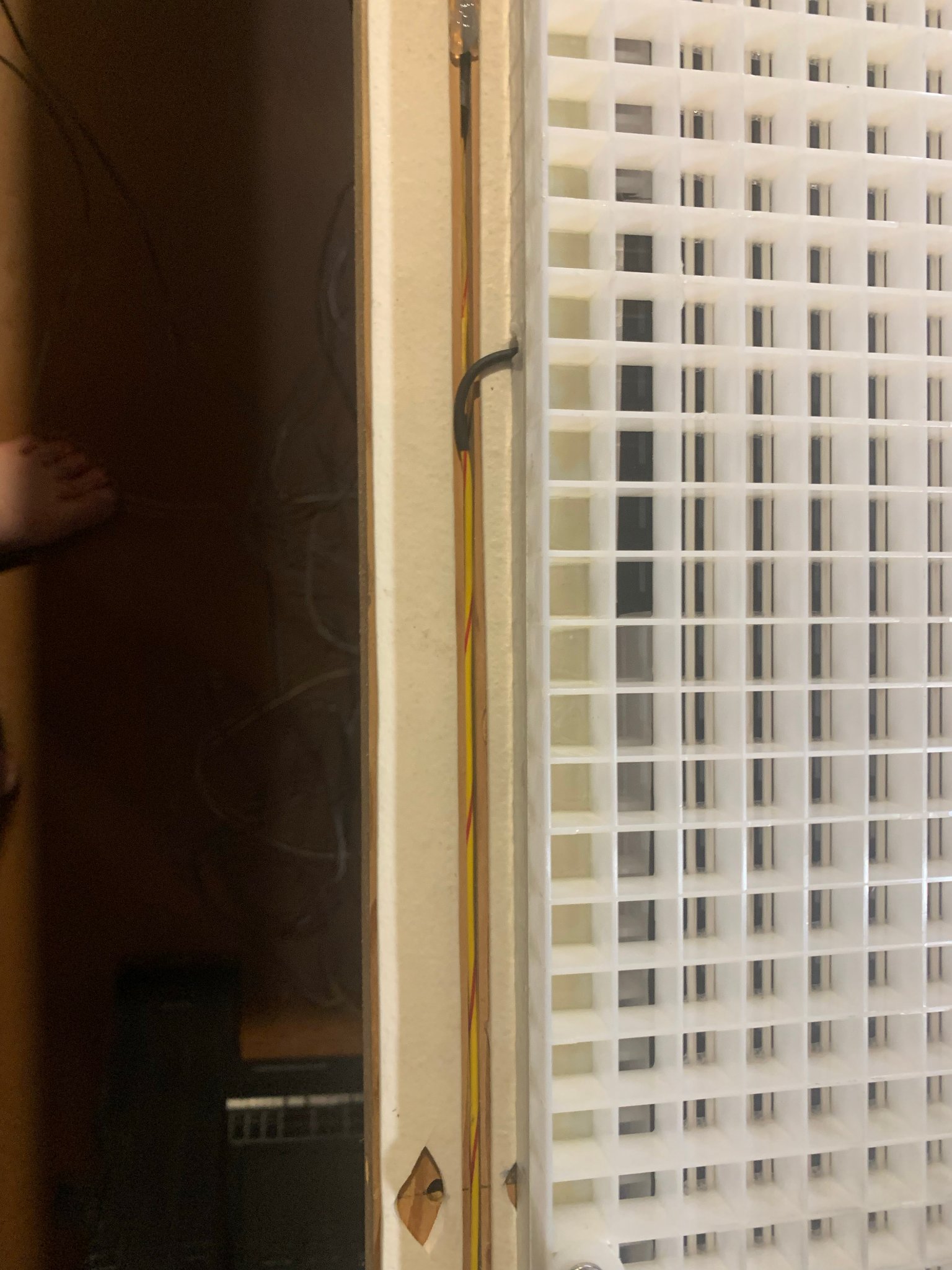

- I routed a channel in the front vertical members and ran the bias wires inside the channel, held in place with rubber screen spline.
- I ran the stator wires down the back outside frame members inside quarter round chases that hide all the wires and gave the rear of the frame a nice rounded profile.
- I made a sandwich of 1/2" felt, polycarbonate, 1/8" steel plate, and 1/2" oak for the lower board that that interface bolts to. I bolted this to the frame members using threaded inserts.
- I used barrel nuts to mount the panels instead of tee nuts.
- I mounted the interface on a steel plate and then bolted that through 3/4" red oak into tee nuts welded to a 1/8" steel base plate.
- I reversed one panel on the top row and one panel on the bottom row so that I could have the bias wires exit all the panels on the side facing the interior of the speaker. This allowed be to route all of the bias wires down the inside vertical members.
- I cut grooves around the outside of the frame and will have separate front and back cloth covering, held on with screen spline in the grooves. This will allow for removal of the coverings independent from each other without all the staples.
- I put countersunk magnets on the outside edge of the frame to hold trim boards that will cover the sides and the screen spines holding on the grill cloths.
