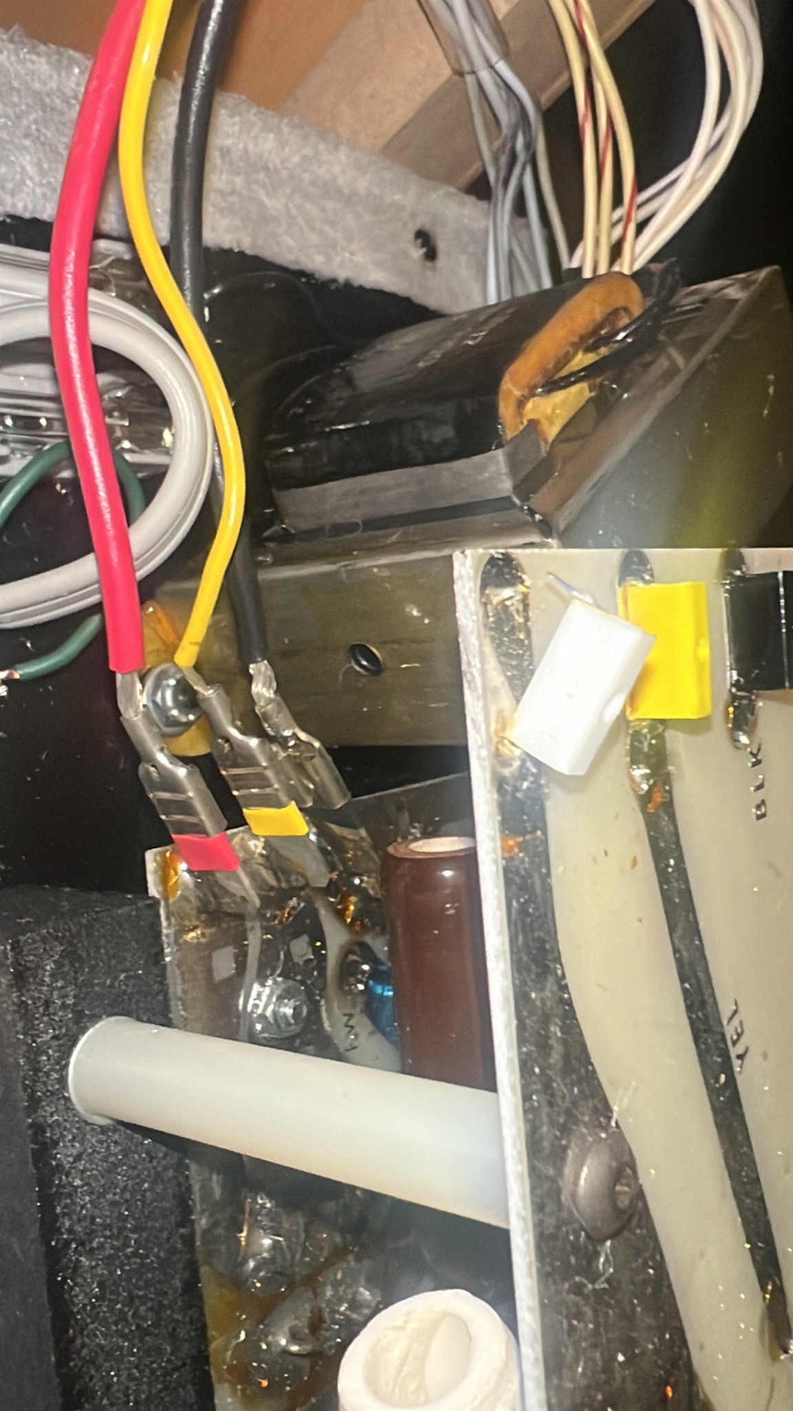

One of my Spectra 3’s is intermittently crackling and going muffled but then goes back to regular sound and volume. I have ruled out the speaker wire connections and amplifier. Any feedback from is appreciated!
This sounds like a classic case of some foreign material caught in the gap between stator and diaphragm. During large excursions, this foreign material may be causing a small arc, which temporarily drains the charge from the diaphragm. This can usually be remedied by fully discharging the speaker, (described above, except I would recommend leaving the pin plugs disconnected after discharge) and then gently banging your open hand on the panels' surface. The idea is to cause the offending material to drop out of position. This process may need to be repeated several times. As a last resort, you may have to remove the grille cloth and gently vacuum both sides of the panel (a process which also may need to be repeated several times). A very gentle application of compressed air may also be helpful. Just be sure the panel is fully discharged each time - any remaining charge will tend to "hang on" to whatever is causing the problem.

I inspected the interface board and discovered the socket for the white wire was lifted at one of the solder joints so I reflowed and it seems to have resolved the issue. I need to do my homework on the design of the speakers. Do you recommend replacing any caps on the board or mods?

I'm glad you found that issue and were able to repair it. Did this fix the problem? I would be surprised that a loose stator connection would have the effect you described, but stranger things have happened. I'm always open to learning new cause-and-effect scenarios.
You are correct, unfortunately I spoke too soon and the issue just happen to not present itself afterward but then returned 🙁
Some times the issue occurs at lower volumes but will definitely occur at higher volumes while the other speaker has been totally fine.
If the issue is due to some foreign material inside then would it make sense that turning the volume up higher can help to get the sound to unmuffle like in the video I shared?

This VERY MUCH sounds like you still have a bad solder joint or flaky connection somewhere. When you turn it up, you are able to overcome the resistance of the bad connection temporarily, getting usable output.
Seems like it's time to go across every connection on the low voltage side of the system and poke around/inspect the solder joints and wire conditions. I bet you find another bad spot somewhere
Reactions: el.pablo
I'm speaking generally. Every connection on the board is suspect at this point 😆. Solder joints can fail over time, and this sounds like a pretty typical bad solder joint/flaky connection. It is certainly unusual that it would sometimes require lower volume to come back, but it's not unheard of. It happens fairly often with moving lead-wire connections to speaker cones/coils.
There is enough complexity in this design that it could certainly be in the HV side of things, or transformer, but it's pretty easy to start by just inspecting all of the low voltage stuff first to rule it out. You might get a wooden dowel or ruler (at least a foot) and poke around at the components while it's playing (to stay clear of the transformer/HV side) to more easily locate the issue. Avoid using a pencil as the graphite is conductive hahaha.
