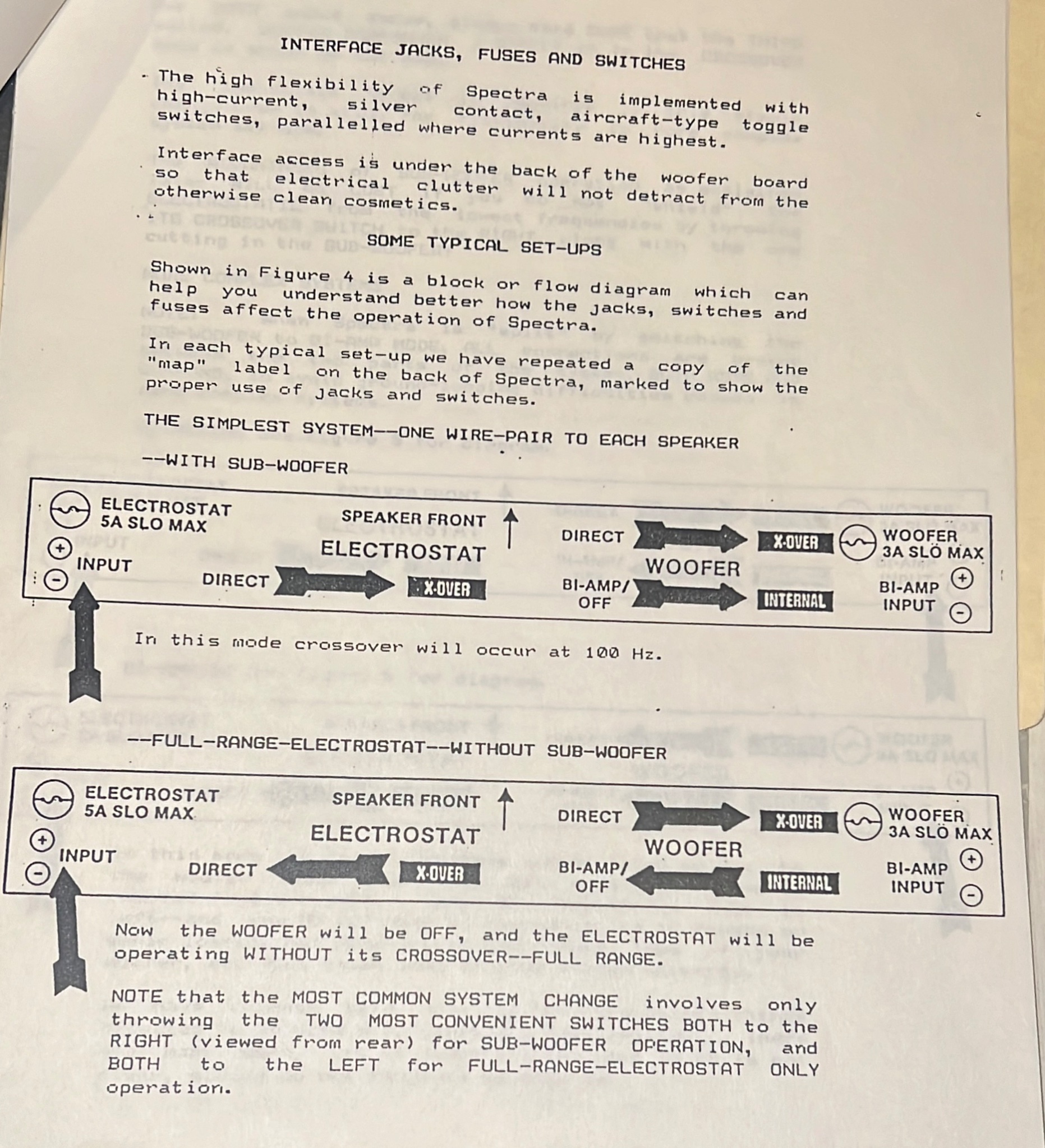

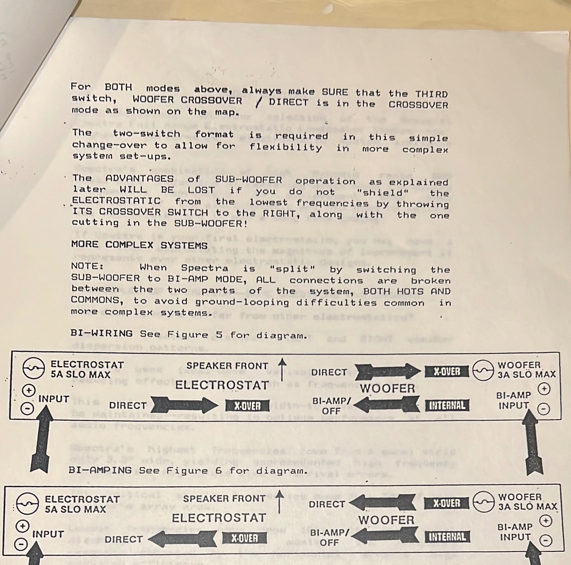

My next question is about the high and low crossovers all the speakers. Do you ever recommend disabling either of them? Is biamping required to do so? With or without using the crossovers do you think that biamping can improve the sound? I know that people say to use an active crossover but also know that is not easy to implement properly. I’m using a Hafler 500 high wattage amp that I have heard is stable down to two ohms. If I were to biamp then I believe I would choice to use an additional Hafler 500. I could even use four as monoblocks to biamp the two speakers but assume that would be overkill.
My last question is about using an external sub. Do you think it improves the sound and if it does is it best to switch off the Spectra sub or leave it running? I realize the answer may be different for stereo music vs surround and the LFE channel.

If I remember correctly, the original Spectra 3 has the ability to have the woofer powered either by the main amplifier, or from a separate amplifier. Clearly the latter arrangement would have some advantages. This would be using the internal passive crossovers already in the speaker.
I generally don't recommend bridged amplifiers for Acoustat speakers. When you bridge an amplifier, each channel is presented with only half the load impedance. Since the speaker is already very low impedance at some frequencies, this presents a very difficult load. In addition, I don't feel there is much advantage in using more than 250 watts per channel, and one runs the risk of damage from overdriving. Therefore, using two stereo amps would be my recommended best practice.

There are high and low crossovers that can be switched on or off. Are there any bias adjustments to be made on this model? Can a subwoofer pair well for stereo and surround sound?

Anyone biamp Spectras using an active crossover opposed to the passive one built into the speakers?
I have a pair of model 3's that I use with a pair of stereo subs. I actively biamp with a dsp crossover to feed the low frequencies to the subs, those above 80Hz to the Acoustats. Not sure what you mean about the "passive one built into the speakers"- if you mean the Acoustats with a cone bass driver or those with a built it passive crossover for a sub, I think the use of an external crossover for the bass frequencies would be easy to facilitate. If you are referring to the transformer network used to shunt different frequencies to different panel sections in the Spectra panels, I doubt that is possible with an active external crossover.

Thanks for your input. My Spectra 3 have both a high and low passive crossover which can be bypassed. My thought was that having a basic active crossover to match the same frequencies would allow the amp more power but I have a beefy amp and any extra load of the passive crossover is probably minimal anyway.
