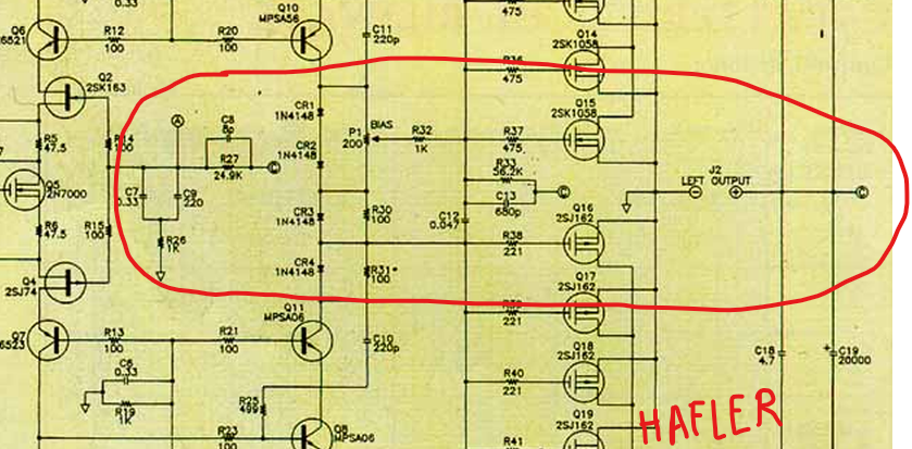

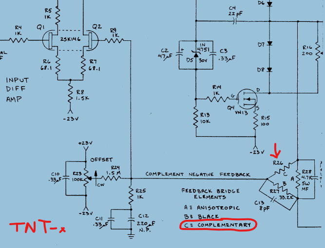

I reads through a bunch of Jim Strickland's notes & schematics on the early Acoustat TNT Transnova amps (TNT-200, TNT-120) while comparing to the later Hafler Transnova versions (9500/9300, 9505/9303 - I just care about the Hafler Transnova designs that use Lateral MOSFETs). Some of Jim's earlier Transnova papers describe "complementary" feedback, which looks to be essentially positive feedback being applied to perform some error correction/cancellation. It looks like that aspect of the unique feedback arrangement was phased out of the Hafler designs. It is R26 in the TNT schematic snippet (blue) attached. A similarly located resistor is not present in the Hafler version (yellow attached schematic snippet).
Although both driver circuits are able to pump quite a bit of current into the MOSFETs (at least 40mA), I have read that Hafler front end was supposed to be more linear than the Acoustat front end. So, was the complementary feedback dropped because it was viewed as unnecessary with the new driver circuit or were there other reasons?
I'm just curious ... I've heard the Hafler versions and liked them but have never heard the Acoustat versions ...
Sorry if this forum is ONLY about Acoustat speakers. I guess the moderators will spank me and move this ...
mlloyd1 - I can't give you an answer. Both the Acoustat Transnova and Hafler Transnova were designed by Jim Strickland, who unfortunately is no longer with us to provide insight about the design decisions he made. The Hafler Transnova was certainly an outgrowth of the original Acoustat models, and in fact, was originally intended as a "next generation" for the Acoustat line. When the decision was made not to continue the Acoustat electronics line, the work was transferred and completed under the Hafer banner.
Thanks, I knew it was a stab in the dark. i'll be playing around prototyping in my free time, anyways.
I will probably poke this question around in the solid state amp forum here and see what bites I get. Just wanted to see if you might have heard any hallway chatter or seen anybody's whiteboard scribblings, etc. on Transnova circuits.

Thanks for posting those documents. Both were published after I left the company, so I never saw them. FYI, I drew both of the schematics you presented above. The Acoustat schematic was hand-drawn on vellum sometime after the introduction of the line, as a publishable schematic didn't exist before then. The Hafler schematic was done in AutoCad, illustrating the change in technology available to engineers during the late 80s - early 90s. I still have a fondness for hand-drawn schematics. And yes, I heard plenty of "hallway chatter", as Jim had a real penchant for "trapping" unsuspecting coworkers into long discussions about his current work. I think explaining things helped Jim to better understand what he was doing. But unfortunately, that was over 35 years ago, and very little of it "stuck" in my head. I also remember Jim having hours-long telephone conversations with Ed Meitner and Bill Conrad.
