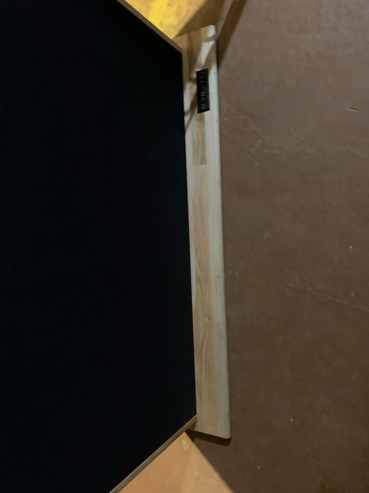

Hi all,
I am looking into new base platforms for my 2+2's (smaller interface). The original owner replaced the originals with a thin plexiglass. I am exploring black walnut wood and have found a lumberyard that can supply plates that are solid, not glued, pieces of 22.5 x 17 x 7/8". I was told that the wood could misshape over time from humidity and to have something under them to allow air flow to prevent that.
What are your opinions or experiences? Is the 7/8" thick enough? I would think so.. I wouldn't want to do a spike as I am sure I will want to freely move them to experiment with placement. They are currently not setup, the interfaces are with Russ Knotts for inspection as I have not run them since the early 2000's.

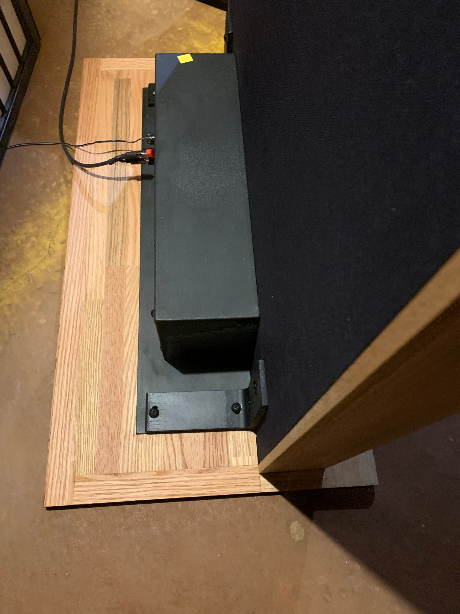

I just finished rebuilding my Spectra 6600's with all new frames and bases. For the bases, I did something a bit different in an effort to add strength...
First, I had a plate of 1/8" steel cut an inch shorter in width and length than the finished base. I had tee nuts welded to this plate. Then I had a second, smaller plate of 1/8" steel cut with a hole pattern that matched the tee nut locations. I bolted the small plate to the bottom of the interface. I then cut a solid, 3/4" oak plank, made up of strips of oak, to the finished base size, drilled holes to match the tee nuts. I placed this oak plank on top of the large steel plate then put the smaller steel plate with the interface attached on top of the oak plank, sandwiching the oak plank between the steel plates, then bolted them together. I ended up cutting the oak plank about 1" shorter in length and width, and planing it to 5/8" before sandwiching it. I then glued on strips to the back edge and sides which where L shaped to cover the top and side edges of the bottom plate. I did the same for the front edge except I used several neo magnets countersunk into to oak strip so that I could remove it if I have to de attach the speaker itself from the interface in the future. Worked out great and the steel plate slides easily on the concrete floor.
Those who are observant will notice the 1/4" thick angle brackets I added to each side of the interface, made from cut sections of 6"x6" 1/4" steel angle.
Reactions: jumpright
Hi all,
As a former cabinet builder, carpenter, etc. I have some experience with wood. If you seal the wood before it warps with a couple coats it is much less likely to warp or crack. Oak is pretty stiff so may not warp even under the conditions described. If you have a choice go with thicker wood as even 1/4" (6mm+) more makes it a LOT stiffer.
Also let the piece of wood acclimate for a couple weeks before you do much with it. If it was locally sourced, not shipped in from a different climate, then you could plane it if needed and cut it to size, as these actions sometimes lead to an immediate warping, which you want to know sooner. Then I would lean it against an interior wall so that it gets air with your home's moisture content on both sides of it. But not near a bathroom or kitchen, and not where sunlight hits it.
I would be more cautious if you change climates such as from desert Southwest to a humid climate or vice versa. Over time it will absorb or give off some moisture which might lead to cracking or warping especially if one side is not exposed and the other is. I suppose you could put strips of wood such as 1x2 under it to prop it up for a couple months if you move.
Hope this helps.

Nice work! Thanks for sharing your techniques with the group.👍 Now that you've finished your project, how's life with Acoustat's finest?
Loving them! I am using a set of subwoofers for some really impressive bass, crossing them over at 60Hz. I am adding room treatments and plan to dial everything in with dsp, both the crossovers as well as speaker and room correction. I also plan to add 2 more subwoofers to get some distributed bass benefits. Not there yet but working on it. Hopefully by the end of Spring! Thanks for all of your help!

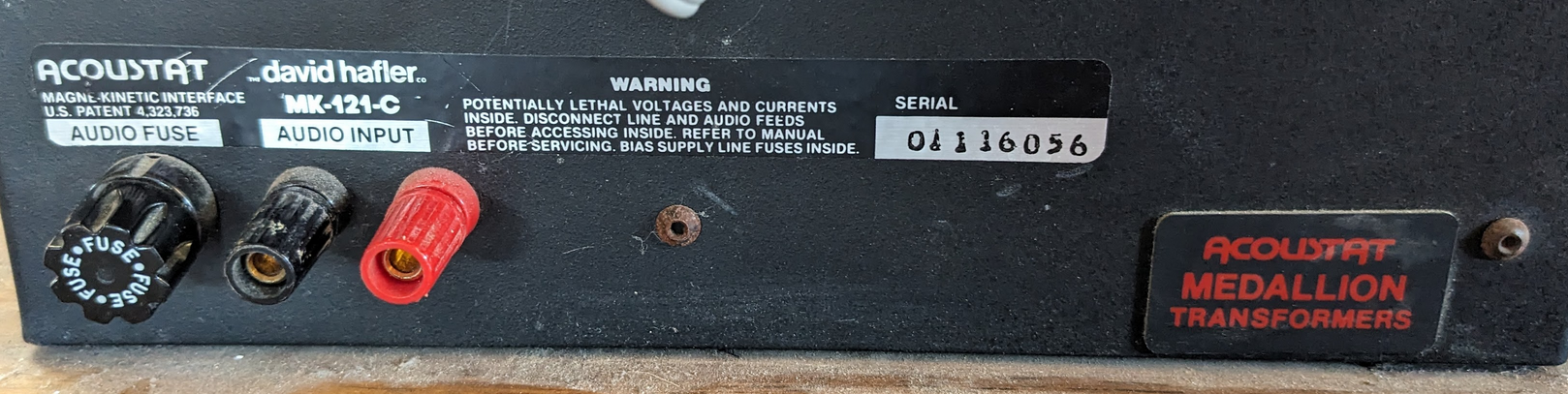

Hello Acoustat enthusiasts!
Way back in the day (1993?) I had a pair of Spectra 2200s. Enjoyed them for a few years, regret selling them. I've got the ESL bug again after recently hearing a friend's Quad ESL63s.
So I recently acquired a pair of Acoustat 1+1s in good working condition. One bottom panel has attenuated treble, so looking to replace/repair/refurbish as needed. Since the upper panel in that same speaker seems to be fine, I'm assuming the electronics are in good working order. Specific hardware details shown in included pics.
I'm assuming I need to scare up a fully functioning panel to get these working properly as a stereo pair. I do have the option of buying another set of Acoustats (can't remember the model) from the same seller, condition unknown, on the gamble that at least one of the panels from them is good.
I also would like to replace the grill socks, which are in good shape (no tears or holes), but just really grungy. Washing them is an option. They are the ivory color. But if I'm going to the trouble of removing them anyway, a new spandex set would be nice.
Question: Are the Acoustat panels germane to all models? That is, will a panel from a different Acoustat model work properly in the 1+1s?
Question 2: What are the typical, known issues with the electronics for this specific variant?
Any tips on the best resources for acquiring/refurbishing/repairing the electronics and the panels in particular would be greatly appreciated. I'm hands on with servicing or refreshing the electronics, but am unfamilar with working on the panels themselves.
TIA
Steve in NM

View attachment 1459959View attachment 1459960
I am not aware of any possible fault in the panel that would cause diminished high frequencies. These panels either work or they don't, the most common faults being extraneous noises caused by loose tension in the diaphragm or dirt caught in the gap. I would look towards the electronics instead. Since only one speaker is having an issue, this is easy to verify by swapping interfaces between panels. If the problem moves with the interface, then the problem is with the interface. Please report back with your findings. You may have a bad capacitor in the HV blending circuit, or a faulty bias supply. The latter is fairly common and easy to fix. Although a low bias voltage should affect all frequencies equally, it is possible to perceive this as reduced HF output.
If you instead verify that the panel is at fault, we can discuss panel replacement further.

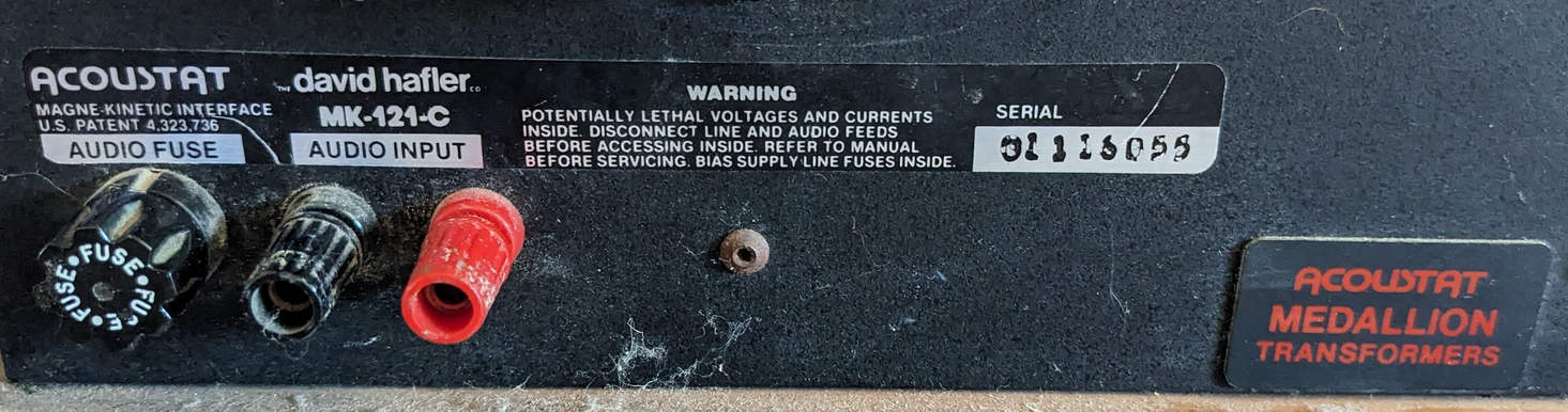

Andy, et al.,
I have the interfaces open and have found several things from close visual inspection. The diaphragm wire connection to the output PC board on one speaker was badly degraded at its pin colar and just broke off when I tried to pull the pin out of the socket. I'll have to resolder that, easy. The HF attenuation resister (+2, 0, -2 dB) exposed windings are blue with oxidation. The third main difference is the audio input fuses are very different, and one looks like its element is barely intact.
Anyone have the schematic for the 1+1 with Medallion transformers? I've tried searching diyaudio.com, but its search engine is next to useless, apparently.
TIA
Steve in NM
Hope this helps.
I wanted to thank you for your thoughts on this, please excuse how late I am doing so! I have decided that a plywood with veneer of choice would be best way to go. Do you agree?

Attached is the schematic for the MK121C. Note there is nothing different about the schematic for the Medallion transformers - they are different internally than the earlier non-Medallion transformer but are connected the same. However, the "C" designation indicates the improved HF primary circuit, which is shown on the schematic. The schematic covers all the models that used the MK121 interface. For your 2-panel Model 1+1, you'll want the LF transformer tap set to the RED position. Other positions (for 3 and 4 panel systems) will offer less bass boost, which you may prefer. There's no harm in trying other positions.
Failure of the connection at the pin plugs and hook terminals is not uncommon after many years of handling. After resoldering, a reinforcement of heat shrink tubing will help ensure the integrity of the connection.
Likewise, corrosion on the exposed winding of the HF Balance resistor is not uncommon. It can be cleaned with some fine emery paper.
