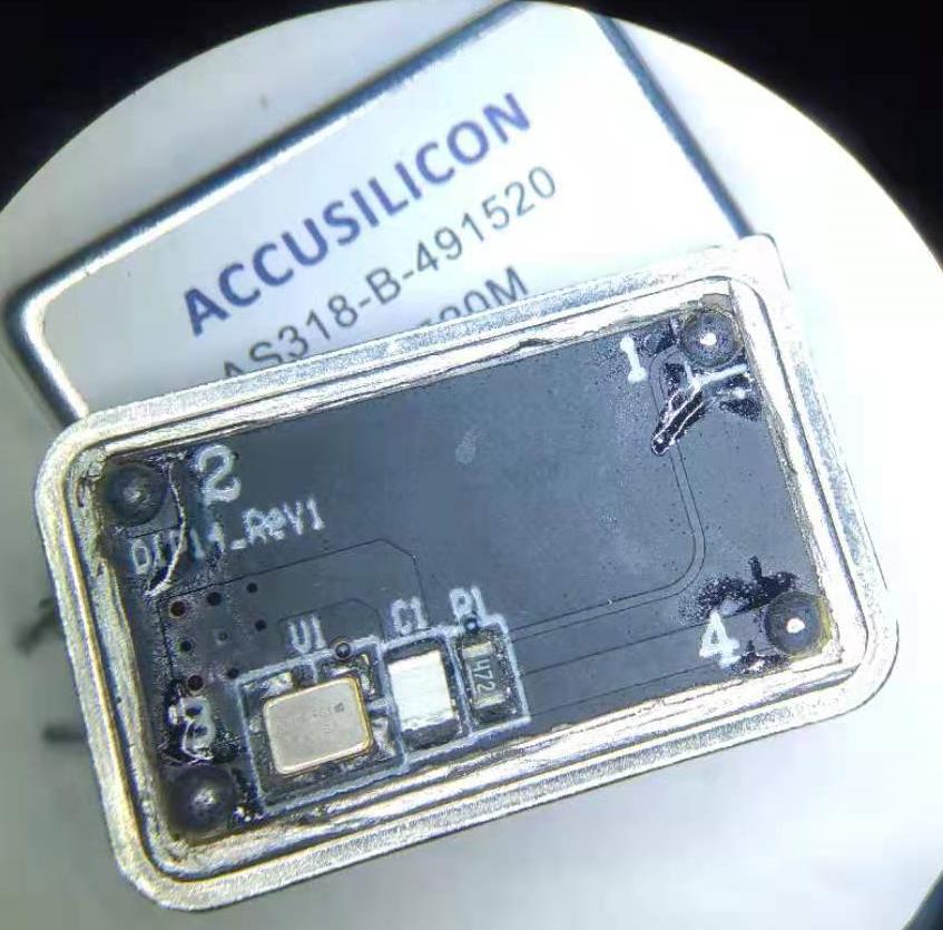

Dear Yunyun,
AS318-B is with the 2520 smd chip hidden inside????
See photo, courtesy of IVX, from post #55
From that photo, AS318-B large can is a repackaged version of an SMD 2520 sized oscillator.
For this reason I do not understand, and tried to be ironic, why a producer like Topping, SMSL, etc are going to the lengths of buying a repackaged, bulky version of a small, cheaper, and much less space consuming small oscillator?
For marketing purposes that is quite clear, otherwise totally senseless?
Another point: You are selling 45/49MHz clocks. Andrea, as he had repeatedly clarified, is not equipped (yet) to measure those frequencies.

OMG, don’t you know that a lot of components are needed around the clock to achieve the best condition? What do you want to say? Another explanation is that AS318-B can be sold cheaper, but the original factory does not retail AS318-B 2520, what can you do?
If you don’t like to buy AS318-B, just buy a much more expensive CCHD957 or other clock. If you don’t like to buy AS318-B with me, then go to a seller who sells 45 Euros to buy it.

Dear Yunyun,
I can.
Ciao, George
Thank you for providing the photo. This photo can prove that I mentioned that it is impossible to buy the real AS318 2520 package on the market. Because of the original factory believes that AS318-B needs a proper metal shell and matching components to achieve the best performance.
