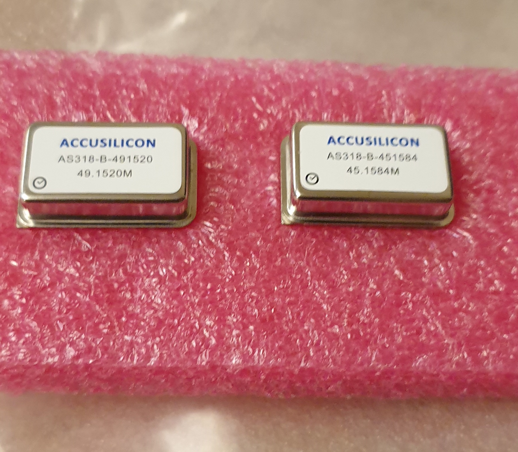

Very nice AirAir.
I just double-checked mine and they are the exact same. AS318-B. I was worried I made a noob mistake for a second on my end.
I looked at your GB and great choice on going SuperCaps. I went SuperCaps last minute as well.

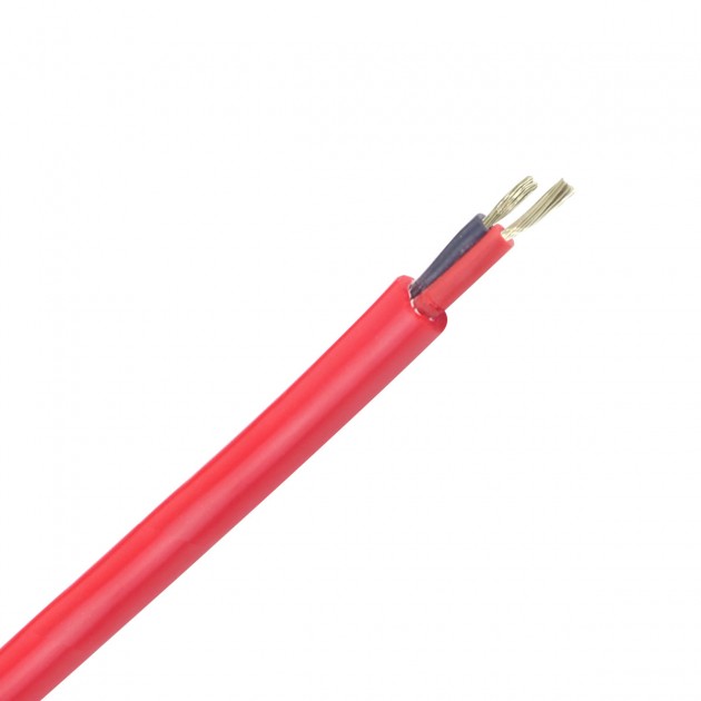

Just make sure you use short thick wires to connect the supercaps, dont dangle them off two feet of bell wire

I plan to use this cable:
Cable Dual Conductor Silicon 1mm2 Red - Audiophonics
I take it you mean 'thick cable' from UcMateConditioner and MKIII to StationPi?
Do you need a thick cable from MKIII to UcMateConditioner/UcHybrid or the supplied Ian cable is good enough (Internal)?
Please let thou know if this cable is not sufficient and need something even thicker. I believe I bought this cable for a more portable battery solution. I wasn't planning a MKIII at that time, so I may need to adjust to a thicker wire...

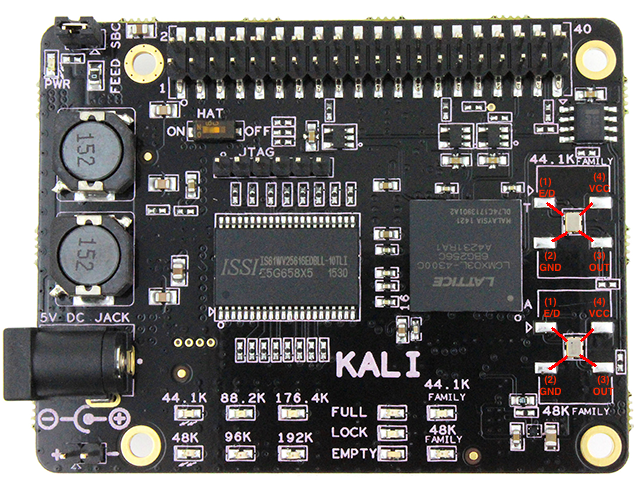

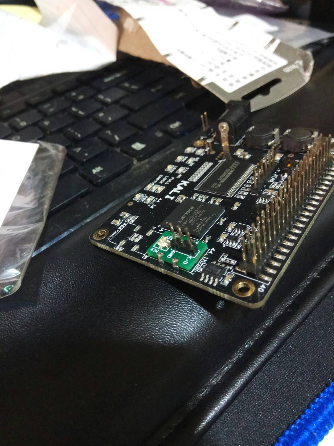

I have bought KALI products from ALLO. KALI is really a good product, but the ndk nz2520sda used on KALI is really not ideal. I asked ALLO about the KALI clock definition , as attached. I designed a clock signal converter by myself to replace the clock signal on KALI, which greatly improved the performance of KALI, such as accessories.
