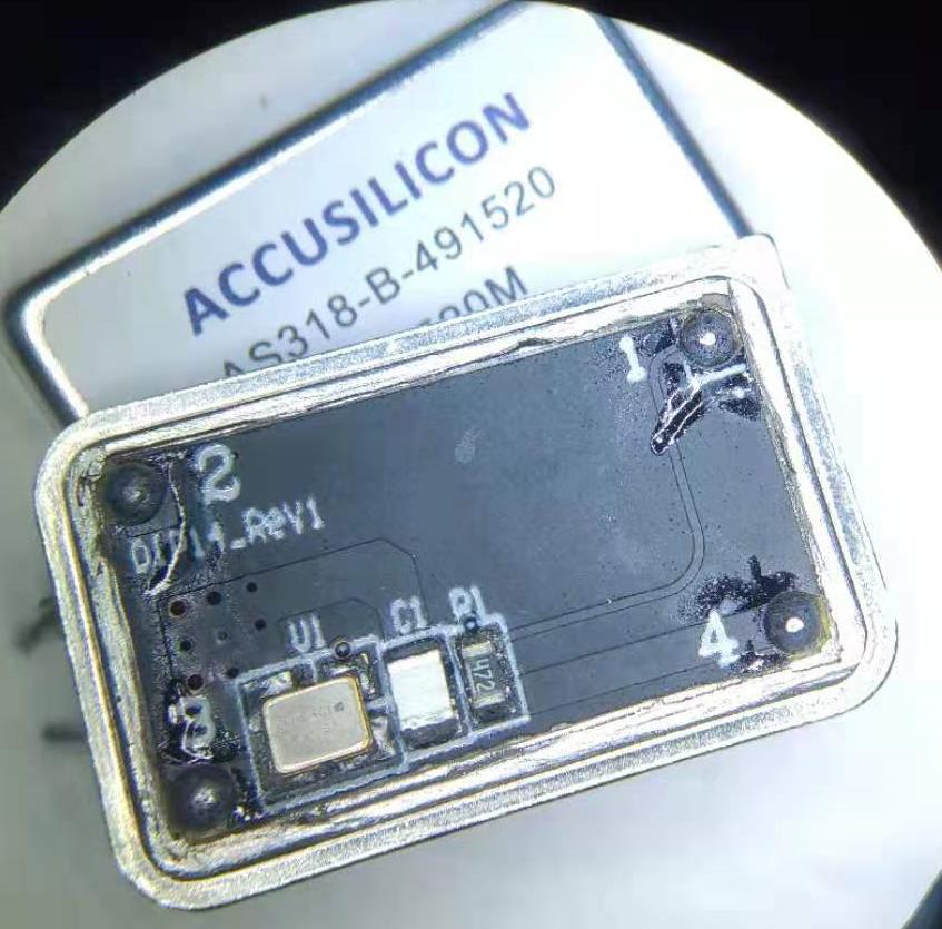

I did try that oscillator with a very jitter-critical ADC clock, and found it just Ok. For instance, Epcos SG-210STF has ADC noise a bit less than 20x times more expensive Accusilicon. I have no equipment to measure the phase-noise but ES9822 ADC SNR very sensitive for a jitter, so I got the best SNR with Epcos SG-210STF, Accusilicon the second, and NDK NZ2520SD the worst of 3. Actually, NZ2520SD looks like a bit better than Chinese noname oscillator, and worse than mems SiT devices. BTW, inside of the DIP Accusilicon I found 2520 SMD, see attached.
Yeah. They offer AS318B in three different can sizes. The smallest can requires a bypass cap with minimal inductance between the cap and the clock ground pad. There is an illustration in the datasheet for the layout. Figured they must put the cap inside the bigger cans.
