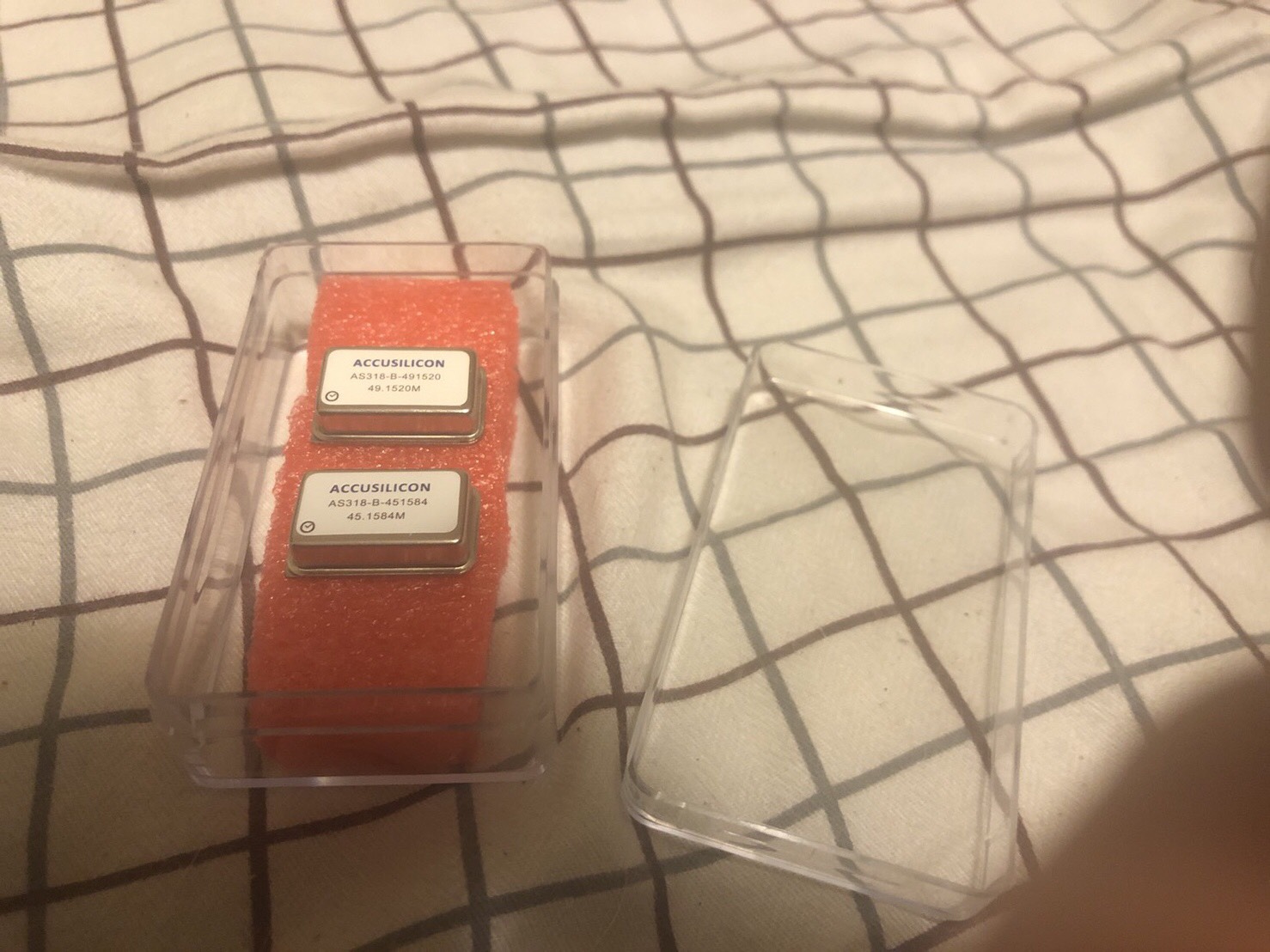

I did try that oscillator with a very jitter-critical ADC clock, and found it just Ok. For instance, Epcos SG-210STF has ADC noise a bit less than 20x times more expensive Accusilicon. I have no equipment to measure the phase-noise but ES9822 ADC SNR very sensitive for a jitter, so I got the best SNR with Epcos SG-210STF, Accusilicon the second, and NDK NZ2520SD the worst of 3. Actually, NZ2520SD looks like a bit better than Chinese noname oscillator, and worse than mems SiT devices. BTW, inside of the DIP Accusilicon I found 2520 SMD, see attached.
Hi
This looks like a ndk nz2520sd or sda made on a pcb and installed a sealed housing.
Are you able to take a closeup pic of the osc inside so we Can see the text on the top?
Br
Caad
Hey IVX~I 've been searching for the AS138-B in 2520 case for sooo long, can you do me a favor? just take a close shot on the 2520 and shows the marking. Thx for help!!!
AS318 2520 is actually not retail, so if you can buy it, it will be very strange. AS318 2520 only accepts a large number of orders from the factory, and the factory is unlikely to resell it because it does not cover the cost.
I will only place bulk orders for AS318-B, and I can do retail. The retail demand of AS318 2520 is too small. Just imagine, how many have the ability to manually solder such a small chip?
