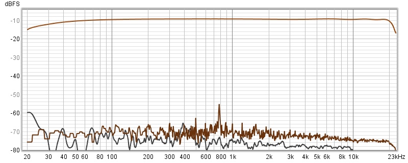

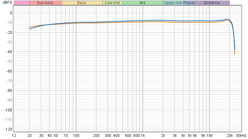

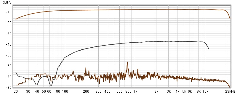

DI box "tube" circuit(With the tube effect turned all the way down) vs bypass. Both FR's are almost identical. The big difference is that the distortion is profoundly lower in bypass mode, and noise is about 6 db to 8db lower in bypass mode, So bypass mode with (massive) copper shielding wins.
I think it's very safe to say that the copper shielded DI box in bypass mode with the vibration sensor will give extremely accurate readings of side panel resonances, for under $50. It will also give accurate panel measurements in "Tube" mode(With the effect turned all the way down), if you don't mind the added distortion and noise.
Both ways are identical..

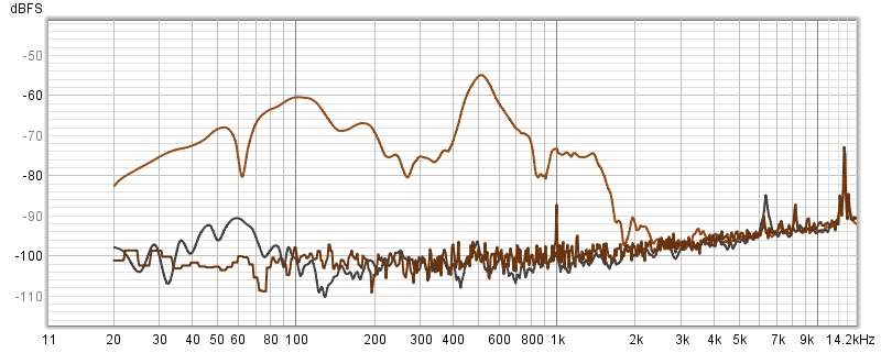

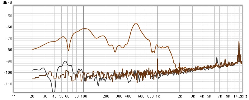

1. KEF Q100 panel with bypass mode
2. KEF Q100 panel with "Tube modeling" circuit applied, but turned all the way down.
One thing is for certain, Q100 panels are terrible!

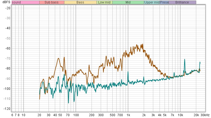

Piezo contact mic vs thin film piezo vibration sensor..
I imagine that the main difference in the response on the conventional contact mic is due to the picking up of sound through the air, which they are known to do.
Red trace - Thin film vibration sensor
All else is equal between measurements. All I did is switch one out for the other
