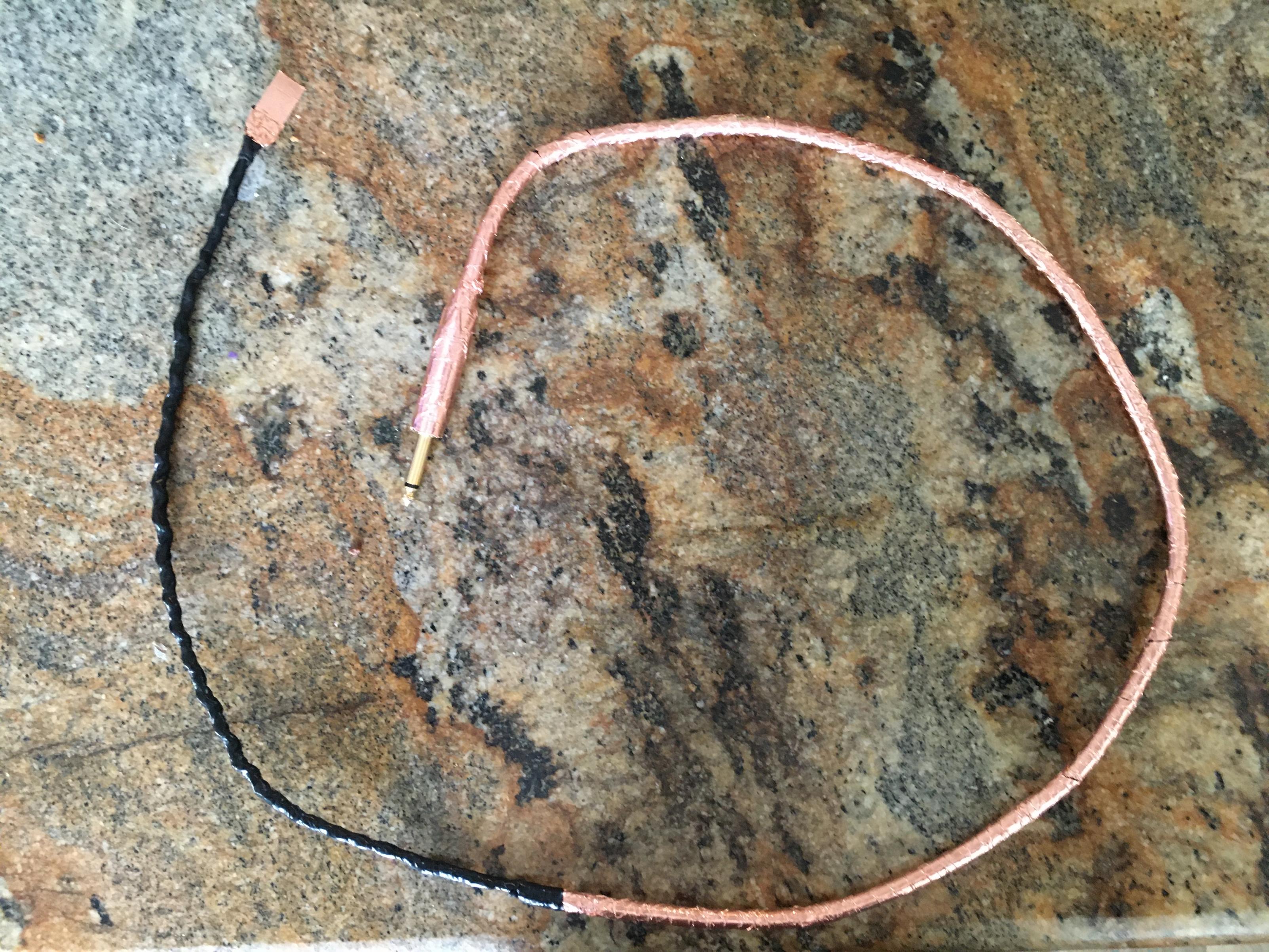

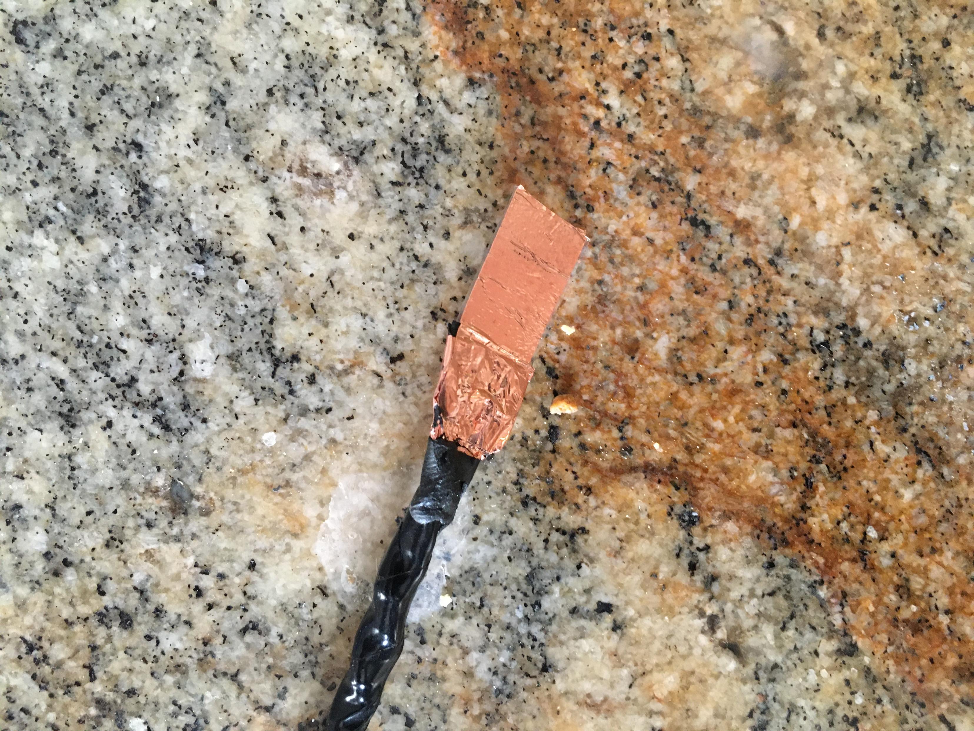

The copper goes from the plug, all the way to the sensor. Nothing was left to chance

That's electrical tape over the copper on the twisted wires to hold it all together.

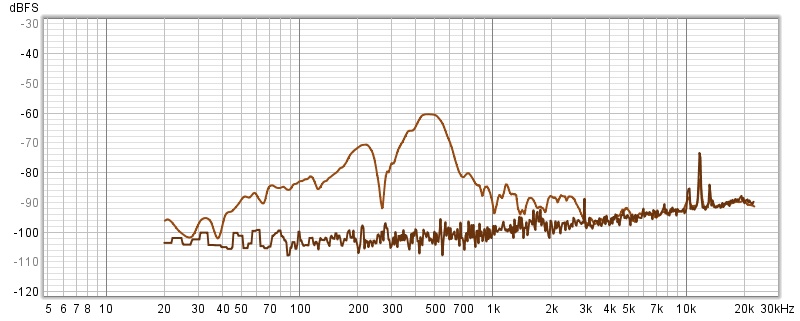

Here is the side panel resonance plus thd and noise with speaker playing a sweep at 100db/1m, with the tube modeling blender turned all the way down. If there was a lot of tube modeling "Processing" going on, I would imagine that thd and noise would be higher than what it is.

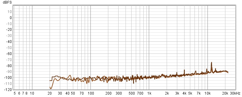

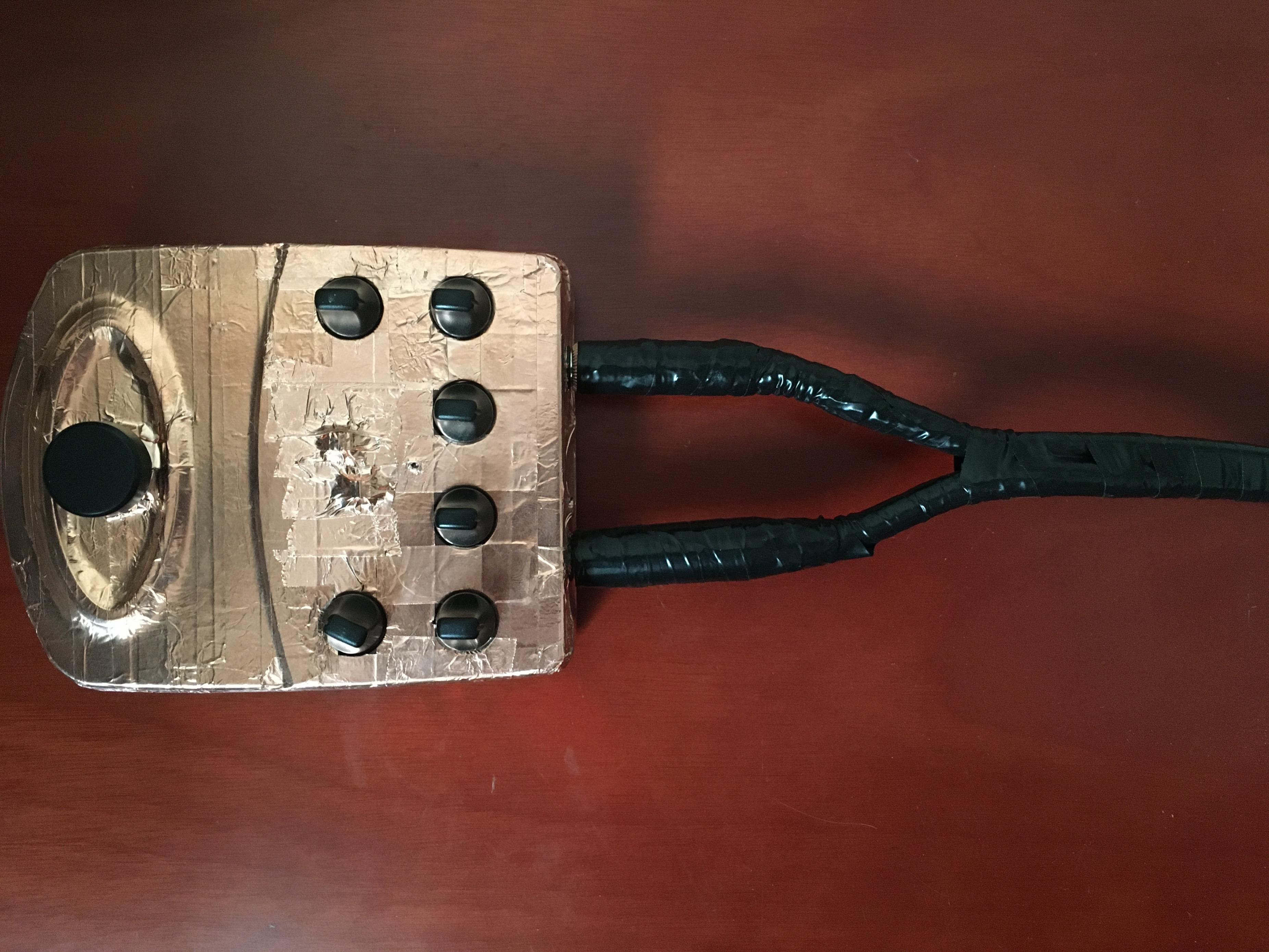

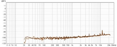

I really want to use bypass on the DI box for obvious reasons, so I went for an all out shielding effort. Each thing I did dropped the Emi a little bit further, to the point that it’s perfectly useful in that mode. It was fun to see the results after each stage. The first stage was the input cable, the second was the box and the third was the output cable which was creating another loop. The 60hz hum is now down to negligible levels in the bypass mode.

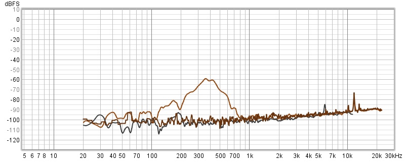

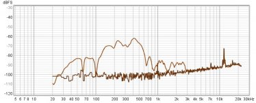

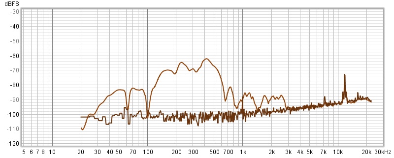

As you can see, the panel resonances are now very easy to differentiate from the noise floor. This was with a 95db/1m output on the mid, with no crossover filters applied
Second graph is the opposite panel, same cabinet.
In reference to the above, essentially anything made of plastic that was not already shielded was wrapped with copper shielding tape.
A metal di box would be better(maybe) than the plastic Behringer, but the only one I could find that compared spec wise is $230 compared to the $30 Behringer. Shielding it with copper tape was a small price to pay.

I have a feeling I know why the side panel resonances are different on both panels. The CLD baffle I made has a very narrow fit in the recess on the cabinet and the metal parts may be contacting parts of the baffle in certain places, which would bypass any benefits of the CLD and could explain for the differences between the two sides. My next step is to widen the recess another 1/8" all the way around to provide for more clearance.
