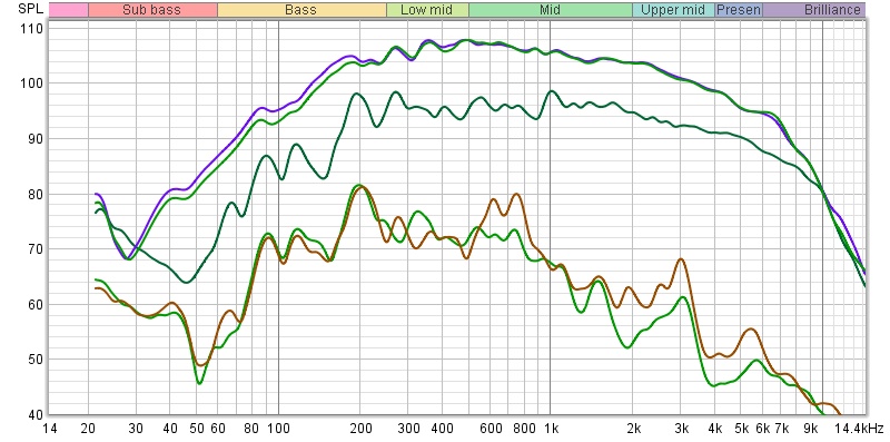

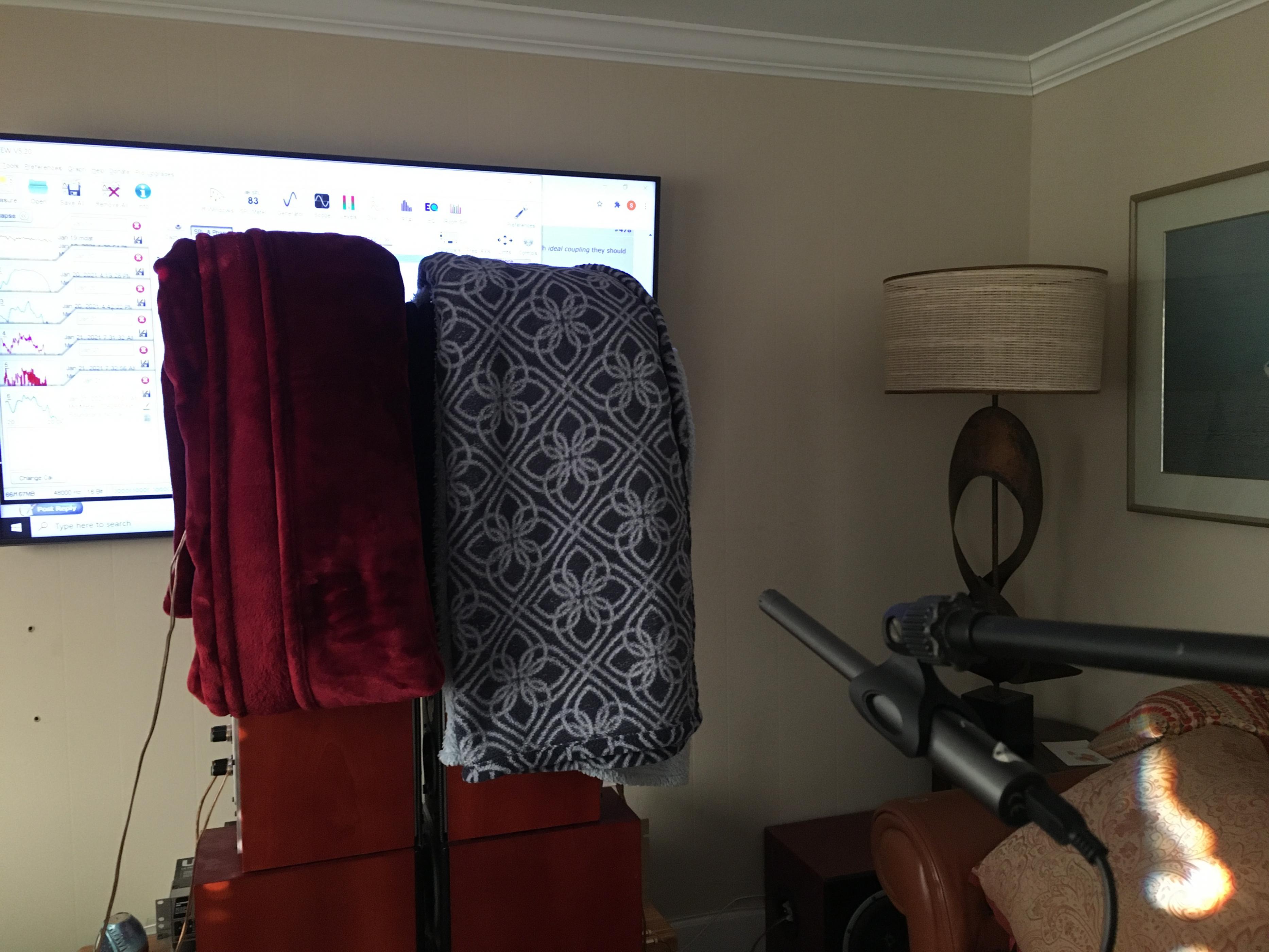

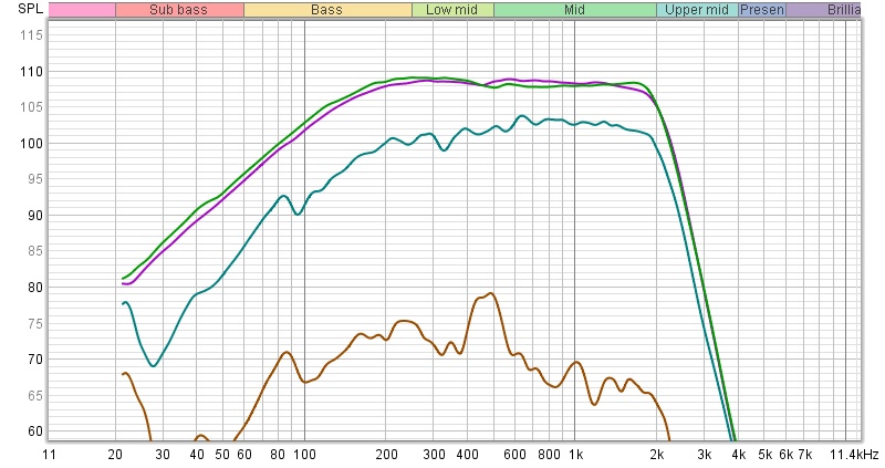

This time, everything is on one graph except for panel vs noise..
Top two traces; Driver matching at 18" measured at exact same spot in room.
Dark green; Single speaker, on axis at 50"
Brown; Panel at 50"

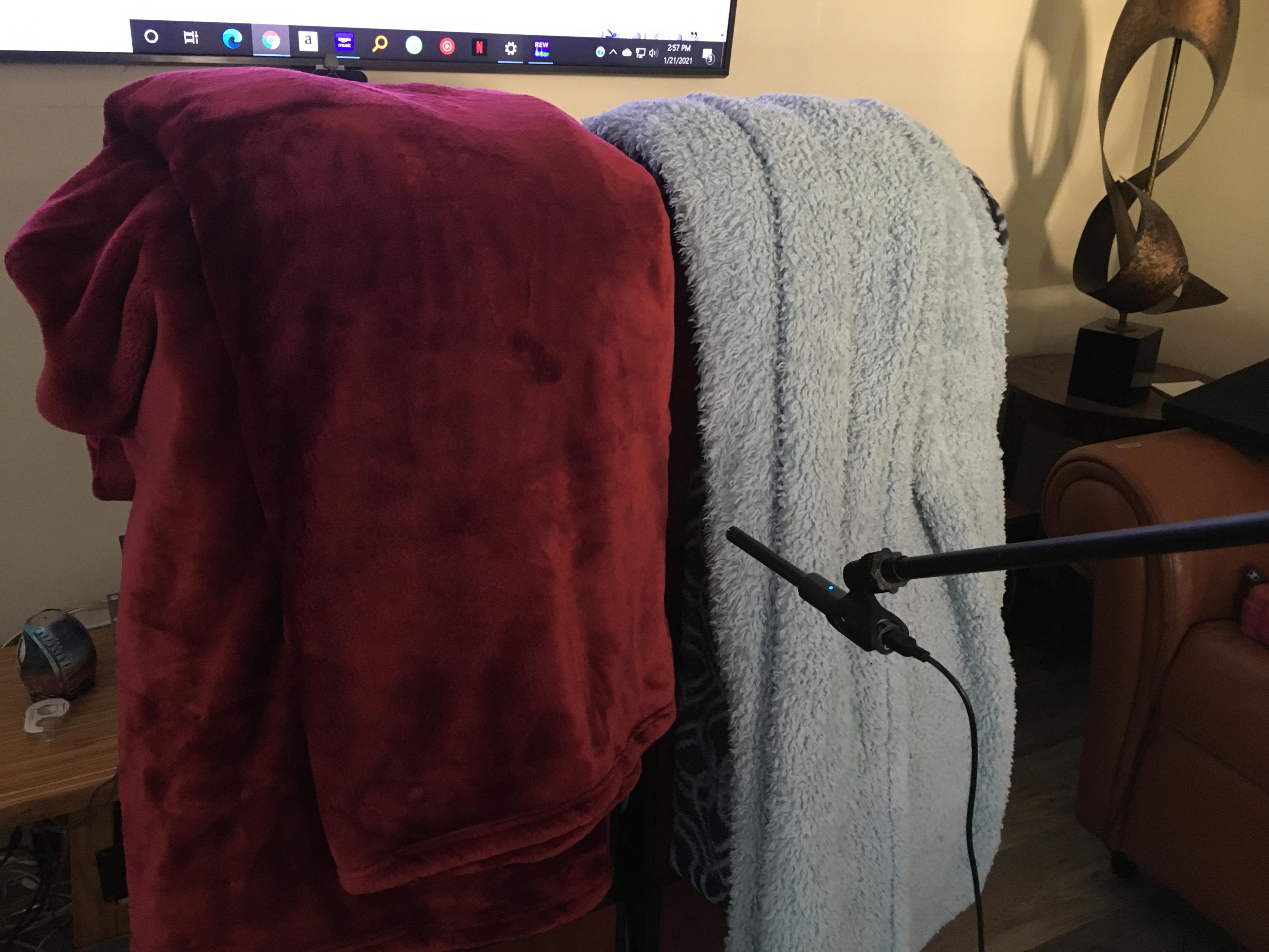

Light green; Nulling baffles on axis, where they meet, with thick blankets over both panels at 50".(picture)
It looks like the blankets are almost totally transparent and not making any difference below 250hz, so the null method looks to be accurate only above that. Does that sound correct? Good cabinet bracing will push it above that point anyway, so it may be a useful tool to analyze the audibility of well braced cabinets, of which the Dunlavy certainly isn’t.

I was suspecting that the blankets might prove too transparent in the bass. 🙁 The only practical thing I can think of is sandbags. I have some and could make more, maybe I'll give that a try tomorrow. Thanks for all your hard work!
In the mean time, why not try the same set of measurements but with the mic 19-20" away (50cm)? Or even at 25cm. You might be able to better isolate what the mic is picking up.

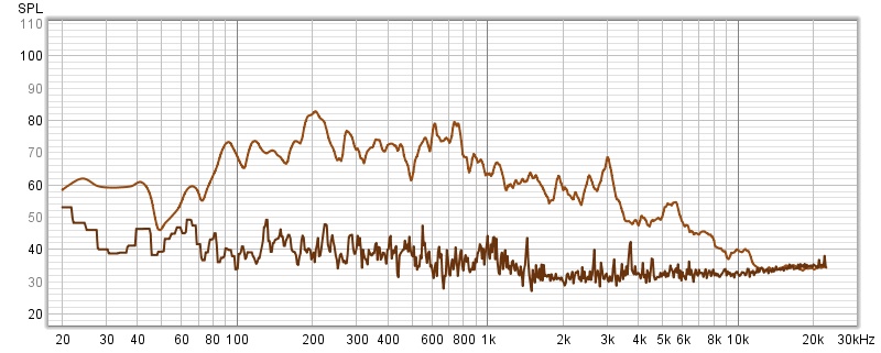

Thank you! I Wanted to see if the Panel resonance could travel that far in the room, but your right, the resolution is not good, that far away. This next graph is my own speaker, but at 20"
Top traces, driver matching.
Green- Driver on axis at 20"
Brown- Panel at 20" using null method.

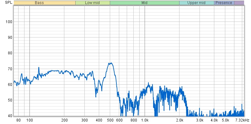

Wow. I did the null test on my speakers with the mic situated in between, and blankets on both. This is what I got. So the bump I thought was coming off my side panel at 500hz is actually coming from a resonance in between the baffles, I'm assuming from the phase plugs interacting with each other and interfering with the null. That's the only thing I can think of. So that's a good thing, because it's not coming off my baffle. It's most likely very silent all the way across the spectrum, Just like the vibration sensor was reading. The good thing about doing lots of measurements, is that a lot of assumptions get overturned. I'm realizing just how important the vibration sensor is in addition to this. They both have limitations, but when used together, you can definitely get a more complete picture.
Ah ha! Good find. I did wonder just how good a null could be achieved. This seems to show that it's better at some frequencies than others.

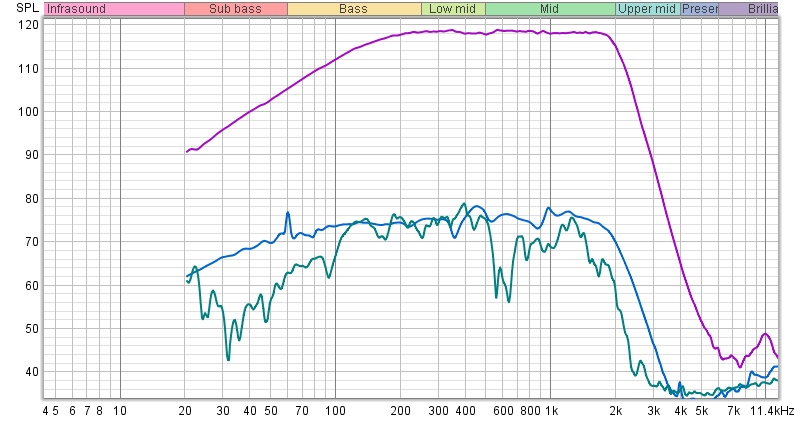

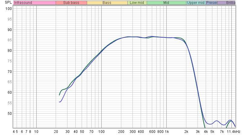

Oh yes, I forgot to include driver matching which was done this time with my solid state amp. It was the tube amp that was a little off on the previous driver matching I attempted. As you can see, the drivers are very closely matched this time around, so the test is valid down to around -25 or -30db(Per Jim's table) through most of the range, which is much better than through the tube amp.
Well I would say that the mic and the peizo basically agree, tho their frequency responses may be different. That notch around 600 could be cancellation of the out of phase drivers, or maybe cancellation of air and speaker panel being out of phase. Hard to say.
These look like useful results to me.
Understanding exactly how unmatched drivers effect the null results really helped a lot, to me understanding more about what's going on.

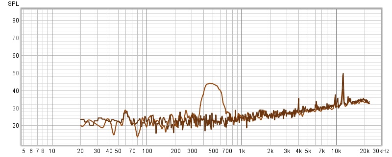

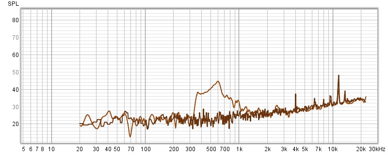

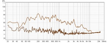

Finally getting a handle on this. Apparently the DI box in bypass mode was causing the entire problem. I fixed it by taking it out of bypass mode, and then turning the effects dials down all the way, with only the level control dial turned half way up. Now the only part of the fundamental that is popping up above the now drastically lowered noise floor is the panel resonance, which is exactly as it should be. This is with the midrange driver being run without any crossover filters applied.
When I originally put this setup together, these were the result that I was envisioning.
The second graph is the opposite panel on the same speaker.
