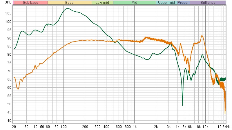

I would too, but it's still interesting from a scientific standpoint. Remember the sensor on the driver result from a few pages back with 48db per octave smoothing? It registered an obvious response. !/3 octave would have smoothed out the notches..(Orange is the acoustic response)
First, either the signal generated by the sensor is accurate or not. Second, analysis of the signal by the software is what it is. The software doesn't know how it was generated. Third, what is being measured is acceleration or force/mass, not the output of a tweeter, but something related to the force generated in reaction to the force applied by the tweeter's motor. That the response is relatively flat just indicates that there is no energy storage in the panel at those frequencies. Either that of the sensor is generating a spurious signal.

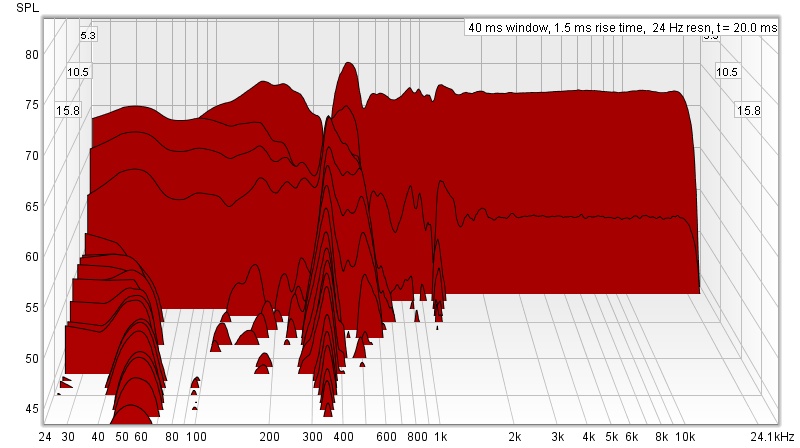

You might also redo the CSD ploy using a smaller time increment to see how the higher frequencies decay.
Here's the shorter time window, John. The reason I used a longer one earlier was to compare it directly to the dunlavy which needed the 80ms window for it's storage problems to play out. Acoustically measured, this resonance at 450hz is 40db down from the output of the driver measured at the same distance, so it looks bad but is acoustically extremely low in level

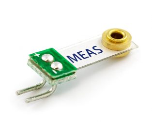

An piezo accelerometer has a known mass attached to the sensor that bends the sensor to generate a signal.

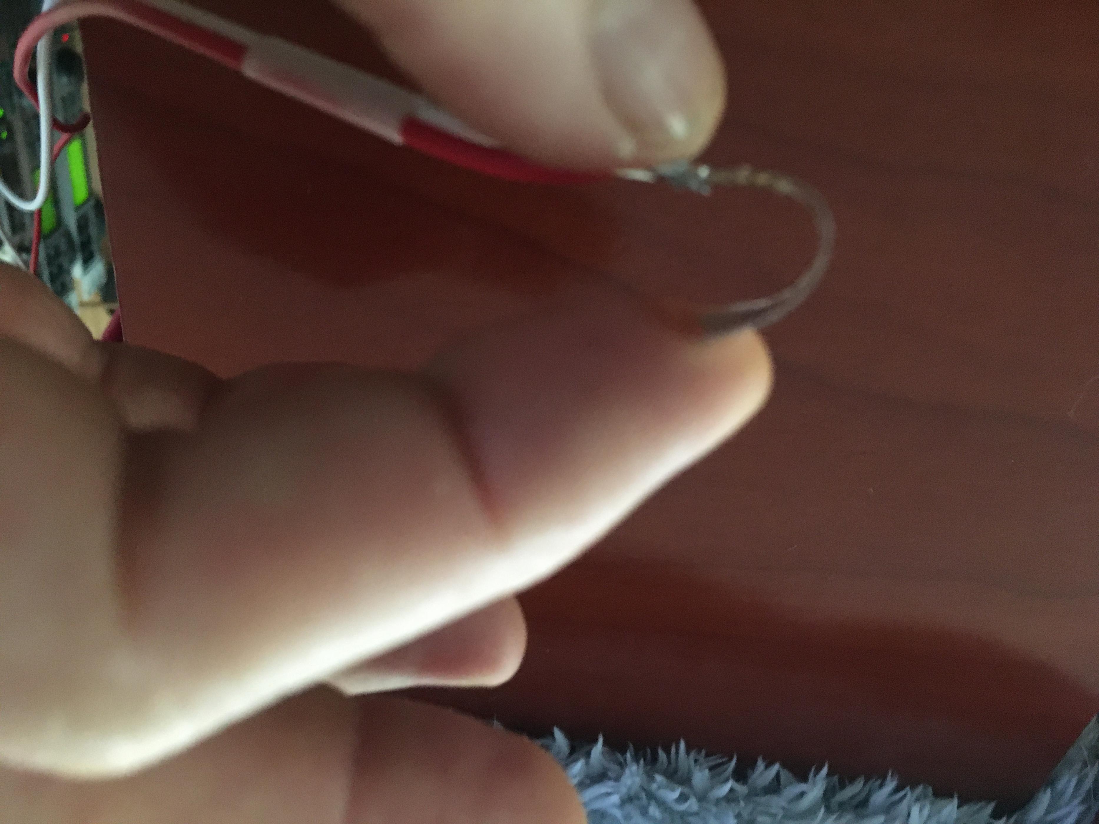

The way we are using the sensor is a little different, as we are attaching it to a surface and that surface has to bend to generate a signal in the piezo. It seems to work on guitars and even speaker box sides. I was a little worried about putting it on a cone that should be acting as a piston. If the sensor doesn't flex, would it generate a signal? It does, but maybe isn't very sensitive at higher frequencies. The Sorbothane test was interesting in that regard.
[/IMG]
"Lightweight and very durable film tabs can be used in a wide range of applications. As a flexible Switch, a Vibration Sensor, an alarm system sensor, product damage/shock detector or as a contact mic/audio pickup. They can be mounted on any instrument that produces vibrations in addition on wind instruments as well. They produce no self resonating characteristics as in traditional ceramic piezo discs. These Film Tabs offer wide frequency response range from 0.001Hz to 1 billion Hz. They are quieter sounding than traditional ceramic piezo discs. The ground or positive may be soldered to either connector but should be wired the same in any one application. Shielding with copper tape is suggested to reduce hum in audio applications. They produce a very wide dynamic range, low acoustic impedance, high voltage output 10 times higher than piezo discs."
Features:
Wide range of applications
Thin polymer film laminate with 2 crimped contacts
Easy interface with the Basic Stamp, SX, or Javelin Microcontrollers
Did the documentation with your piezo transducer give any kind of frequency range?
It is possible (likely) that the transducer is not valid above some cutoff frequency. I don't know about other industries, but in aircraft structures, we rarely measured vibration response above 2 kHz. And we always bonded our strain gages and accelerometers with epoxy (flight and ground test) or cyanoacrylate glue (ground test only). I am suspicious that double sided tape can work at high frequencies. It will almost certainly have some damping properties, and it may partially or fully decouple the instrument above some frequency.
https://www.te.com/commerce/Documen...DS_DT_Series_without_Leads_A1.pdf11026275-00
We are mostly concerned with cabinet structural resonance below 1k anyway, so I would be comfortable in just ignoring anything above 1k...

It is flexible and that's what makes the signal. But if it's held rigidly against a surface, how much can it flex? Obviously some, or there would be no signal.
Perhaps you could try attaching just the bottom terminals to the panel, leaving the film to "flap in the breeze" so to speak. You might need a thin spacer under the attachment point to keep the film from contacting any surface.

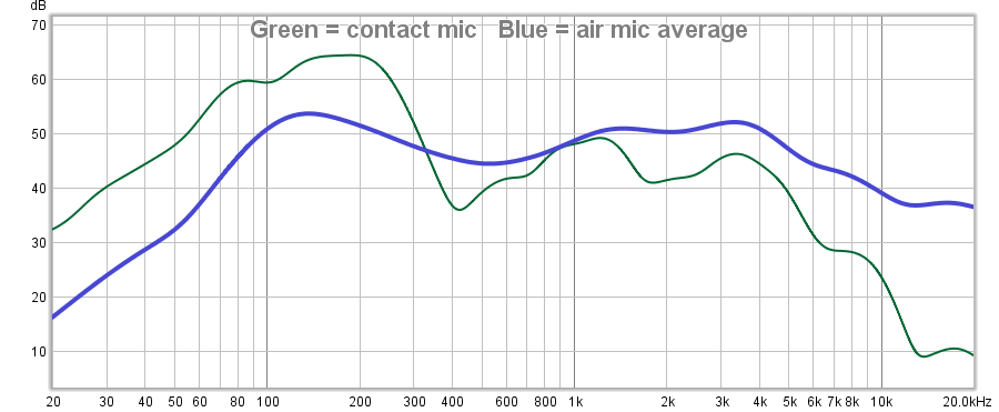

Are we sure that SPL is linear with acceleration at different frequencies?
SPL is a measure of radiated power (Watts). The power required to drive a surface in harmonic motion is proportional to acceleration divided by frequency
Power(RMS) = (1/2) * Acceleration(RMS) * Force(RMS) / angular frequency
So in other words, for 0.1 W of radiated power at 100 Hz we need a certain amount of acceleration. For 0.1 W of radiated power at 200 Hz, we need twice as much acceleration. This would be (I think) a 6 dB higher acceleration measurement at 200 Hz.
But another complication to this line of thinking is that we are rarely dealing with one single frequency, we are dealing with a broad band spectrum. White noise is equal energy at each frequency. Pink noise is white noise that is filtered at 6 dB per octave, such that there is equal energy at each octave.
So perhaps with broadband noise signals, acoustic power (SPL) is proportional to acceleration... I am not sure. It has been too many years since the university
Any thoughts?
