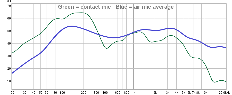

This is what I got from an averaged cone measurement around the piezo position vs the reading piezo itself. This is 1/3 octave smoothed. We can see an exaggerated bass response similar to that found by Remlab.
I used this result as my piezo calibration.

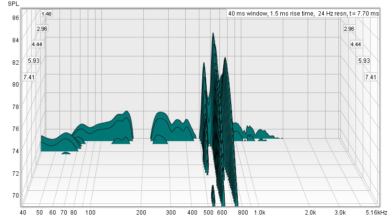

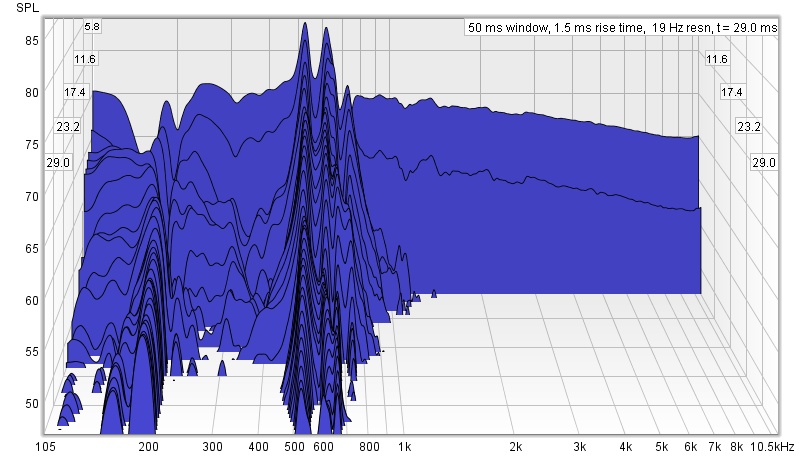

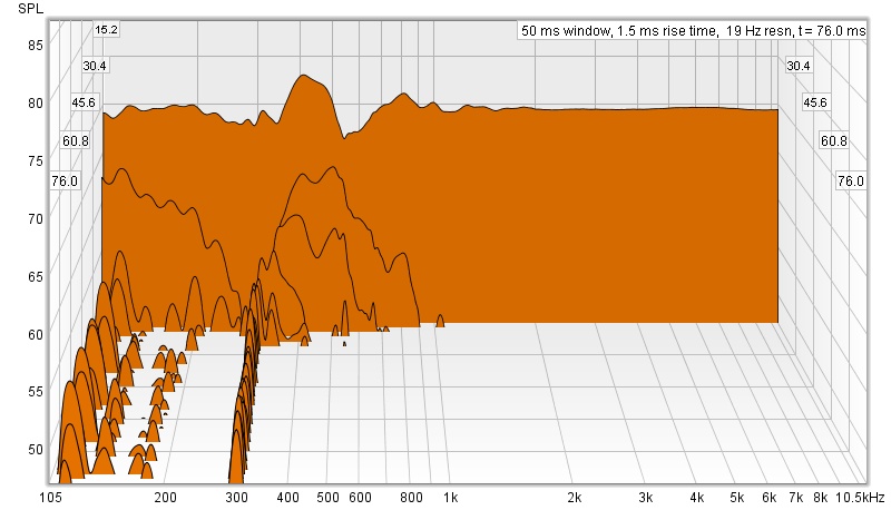

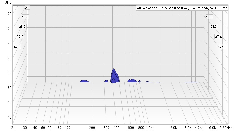

Now that I have some good double sided tape, I can take some accurate panel measurements. The exact center of both and very loud sweeps..
Blue- Dunlavy
Orange- CLD baffled speaker

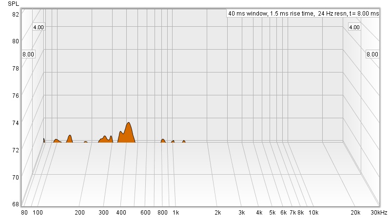

I think I figured this out. the area where nothing is happening(Straight line) should be just below the floor of the csd measurement, so the above, orange image should actually look like this, I think..

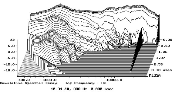

Both of these Stereophile graphs are of the same B&W 805 matrix loudspeaker side panel. The first graph is with the measurement baseline above the floor, and the second graph is with the measurement baseline below the floor. The baseline is where the accelerometer is not picking up any vibration of consequence. In other words, the second graph is what your most likely to hear coming from the cabinet sidewall, while the first graph is giving more information in absolute terms, whether you are likely to hear them or not.
[/IMG]
The interior bracing used inside the speaker in the above measurements. Once again, the first graph above looks much worse than it actually is, as far as audibility is concerned. The second graph is much more representative of actual side panel audibility.

I don't understand the purpose of the lowered graphs. :scratch:
Could you explain what you don't understand in a little more detail? I explained the best I could in the above several posts. Maybe I'm missing something in the explanation. Do you see the straight line in this graph above 2khz? It represents where the accelerometer is no longer picking up vibration. So like John Atkinson is doing on his graphs, I'm dropping that line to just below the floor of the measurement because it's irrelevant. it represents pure silence from the panel. The string resonances you see are from electronic noise getting picked up in the graph.
Is this the correct way to display this graph? Maybe, Maybe not. I'm just trying to emulate what John Atkinson is doing with his panel measurements, which no one seems to have a problem with.
912850d1610929790-accelerometers-measure-panel-vibrations-cld-panel-jpg

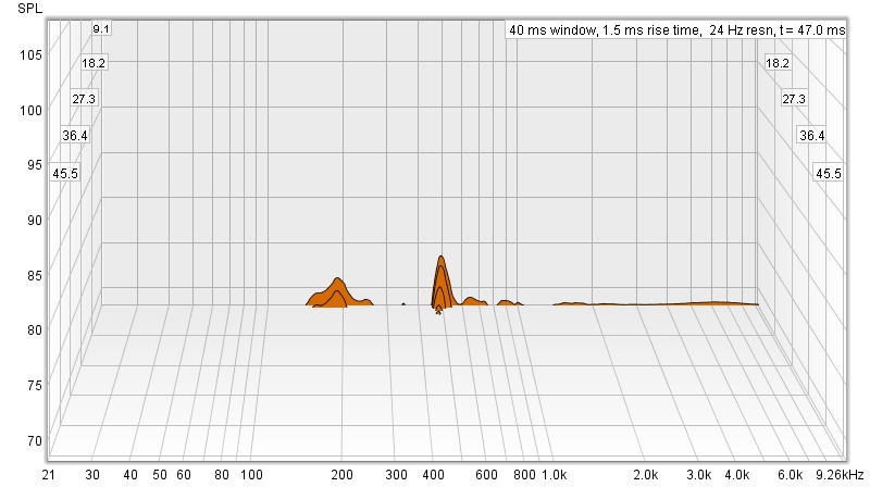

The next two graphs is right vs left speaker. I made a mark on both speakers signifying the exact center(measured), so everything would be as identical as possible. I also placed the accelerometer vibration floor so it is just visible on both speakers. The resonances are extremely low in level but different from each other, which is what you would expect at that level. Tiny differences between cabinet and baffle construction on each speaker are responsible for this discrepancy.
Is it? Perhaps I don't understand waterfall plots then. I'll have to do some reading. I thought that the rear most line/slice was the immediate frequency response with each slice coming forward the frequency response going forward in time. I tend to use spectragrams instead, so maybe I'm seeing this wrong.
Bringing the plot down hides ringing as far as I can tell. And the ringing is important to see.
Pano

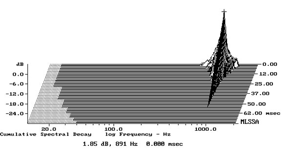

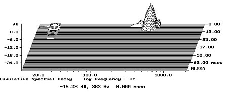

Your absolutely right about that when it comes to acoustic csd measurements using a microphone with a sound source(This is where the confusion lies). An accelerometer has a vibration floor that is represented by a perfectly straight line. What happens above that vibration floor is the cabinet vibration pulsating outward, and what happens below that vibration floor is cabinet pulsating inward.
These are two csd charts of the same speaker. One is an acoustic csd measurement and the other is an accelerometer csd measurement of the side panel.
Do you see the difference? He's not showing what happens below the vibration floor of the accelerometer graph because he probably feels that it's irrelevant, as far as audibility goes.
Whether someone thinks what happens below the vibration floor of the accelerometer is important is their own choice, but John Atkinson seems to think it's not, at least as far as how he presents those measurements in Stereophile.
OK, that makes more sense to me now. However, I'm not using an accelerometer but a contact microphone, which is level sensitive like a normal mic. Zero signal will result in about -120dBfs on a plot. I suppose that given that, the best is to use the waterfall pots as they are used with a normal mic.
One big problem I see with plotting accelerometer measurements on software meant for acoustic measurements are the decay measurements, which have to be looked at differently, as explained above, and the "spl" levels which mean nothing at all. The only way you can do the side panel csd accelerometer amplitude thing is by making sure that the loudspeakers being compared are being played at the same acoustic amplitude levels before doing the comparative accelerometer csd plots, which is what I did when comparing the Dunlavy with my own speaker, and what John Atkinson does with every speaker he tests. For me, it was 95db/1m for both. If you don't level match, the more efficient speaker will look worse on the comparative accelerometer csd than the less efficient speaker, all else being equal.
