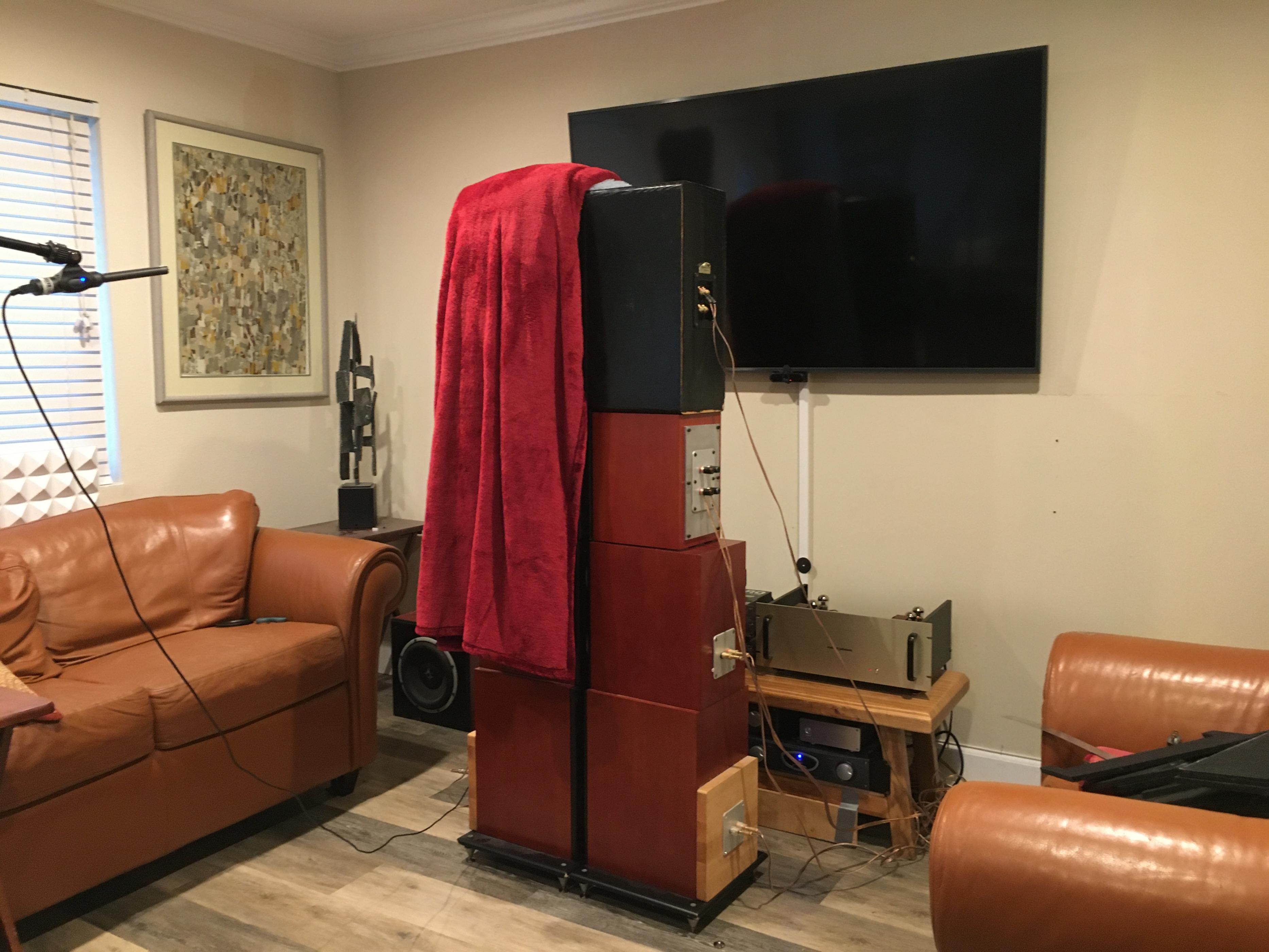

Okay, I have some potentially important information here. I just completed a more rigorous side panel null test, taken at 50”. This is from my phone, so I’ll post an image of the setup first. In a few minutes, I’ll post the measurements through my computer. It all looks very interesting!

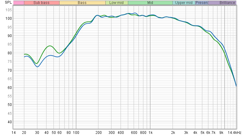

1.The first graph is to test loudspeaker driver matching, so we can see where the cancelation will be off. These were taken for both speakers at exactly 18" and exactly on axis. Measured each speaker 3 times just to make sure.

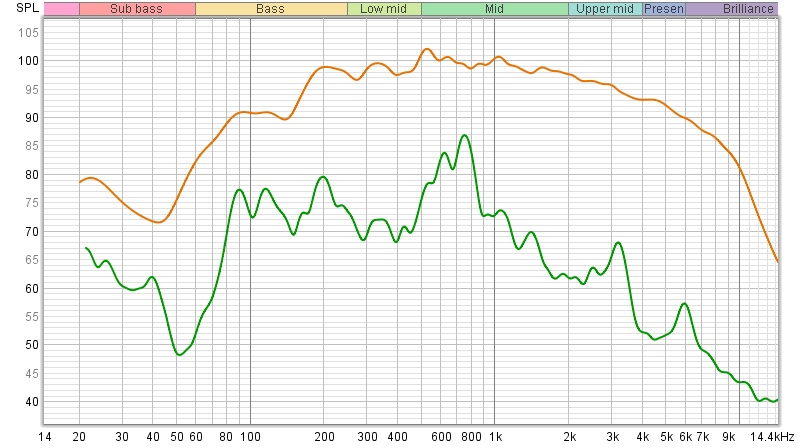

2. A. The second graph is the loudspeaker on axis at 50"(Top trace)
B. The side panel (Null method) with the measurement on axis to center of panel at 50"(Bottom trace)
Now we have to decipher exactly what's going on, and what's not going on🙂
Hint: You can enlarge both images and place one directly below the other to compare. Line up the scales too.

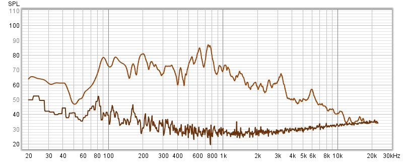

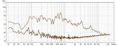

Sorry, but I need to add one more graph of signal to noise for the panel trace to show how noise may be effecting the measurement. Very important! Looks like were pretty good above 90hz, and even better above 170hz. Both traces on the first and second graph(Above) are both true and relative spl!

Hey Remlab. What I see in your latest measurements is this:
Illustration 1, post 469 shows measurements of the two drivers on axis at 18". They seem a rather good match and with ideal coupling they should almost cancel out each other.
Illustration 2, post 469 shows A: One speaker on axis at 50". B: Two speakers facing each other in opposite polarity, measured at 50" from the side on the box, the other speaker with blankets over it.
Is that correct?
What I don't know from illustration 2 is the SPl at 50" of the nulled drivers. Is it 10dB lower than a single driver, 20dB lower? We don't know. So what is being measured in plot 2B? Is it the box panels, the residual of the nulled drivers, a combination of both?
The info isn't obvious, if it's there.
It's not going to be easy to measure and separate driver from box, but you might be able to.

Yes, that's exactly correct.
How about this idea. I could do the "null", but with several thick blankets over each side panel, and the mic placed nearfield and farfield, on axis at where the baffles meet. It wont be perfect(The lower the frequency, the more transparent the blankets become), but it would get us a little closer to eking out more information about what's going on in the lower frequencies.

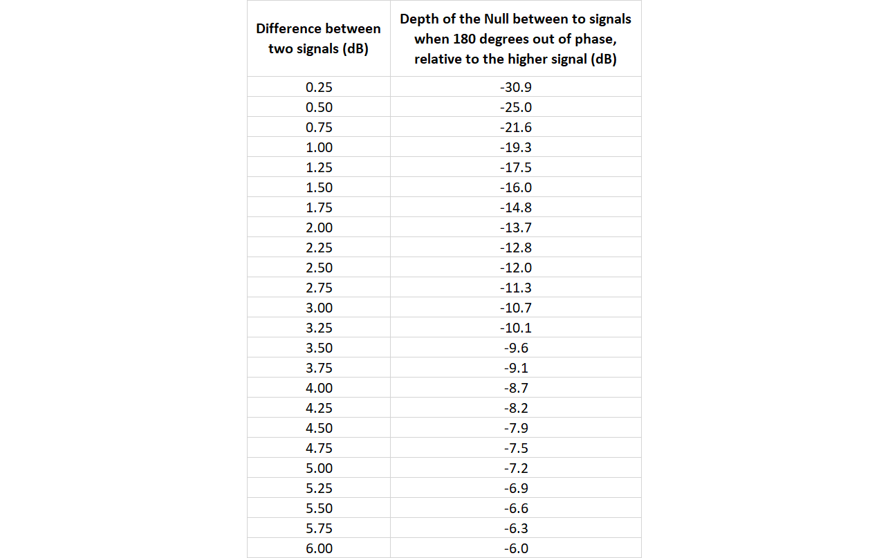

This may be useful. It is a chart which shows the depth of the null we would expect, based on the difference measured between two signals.
Example of how to use the chart: If two signals differ by 0.25 dB, then if one of the signals is 180 degrees out of phase with the other, the resulting null will be -30.9 dB below the baseline signal. The baseline is the higher of the two.
Example: If the two signals are 3 dB apart, then when one is reversed, the null will be -10.7 dB below the higher signal.
