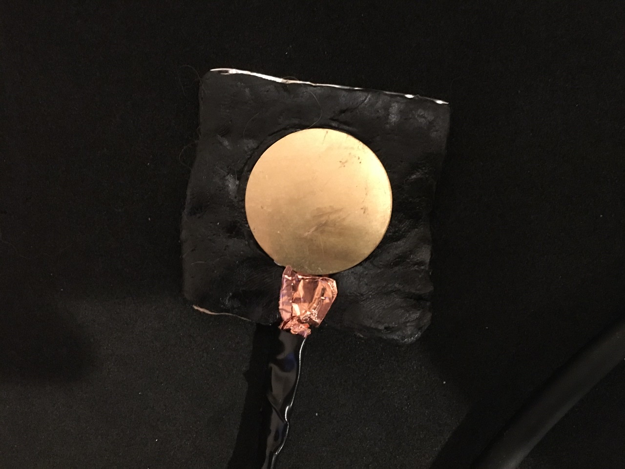

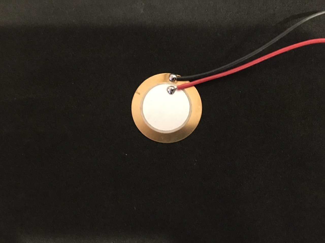

What do your peizo disc mics look like?

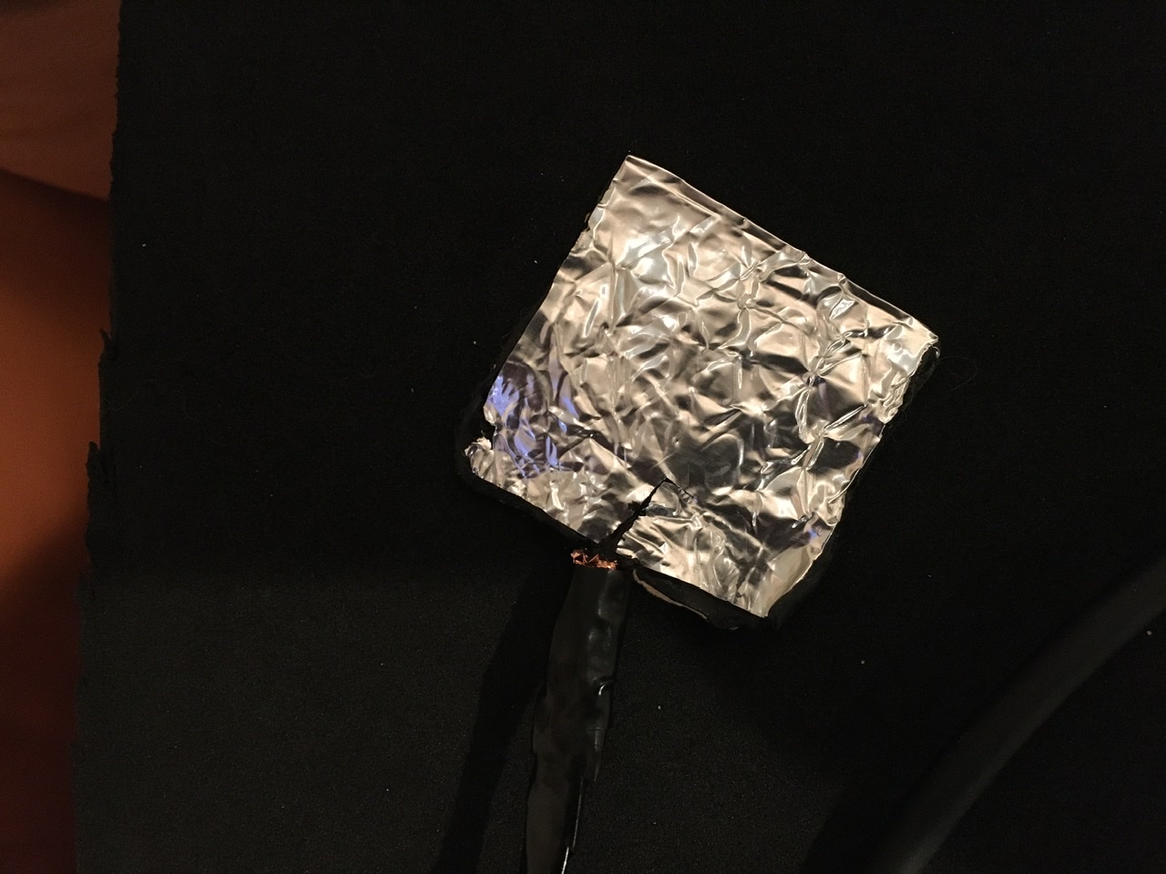

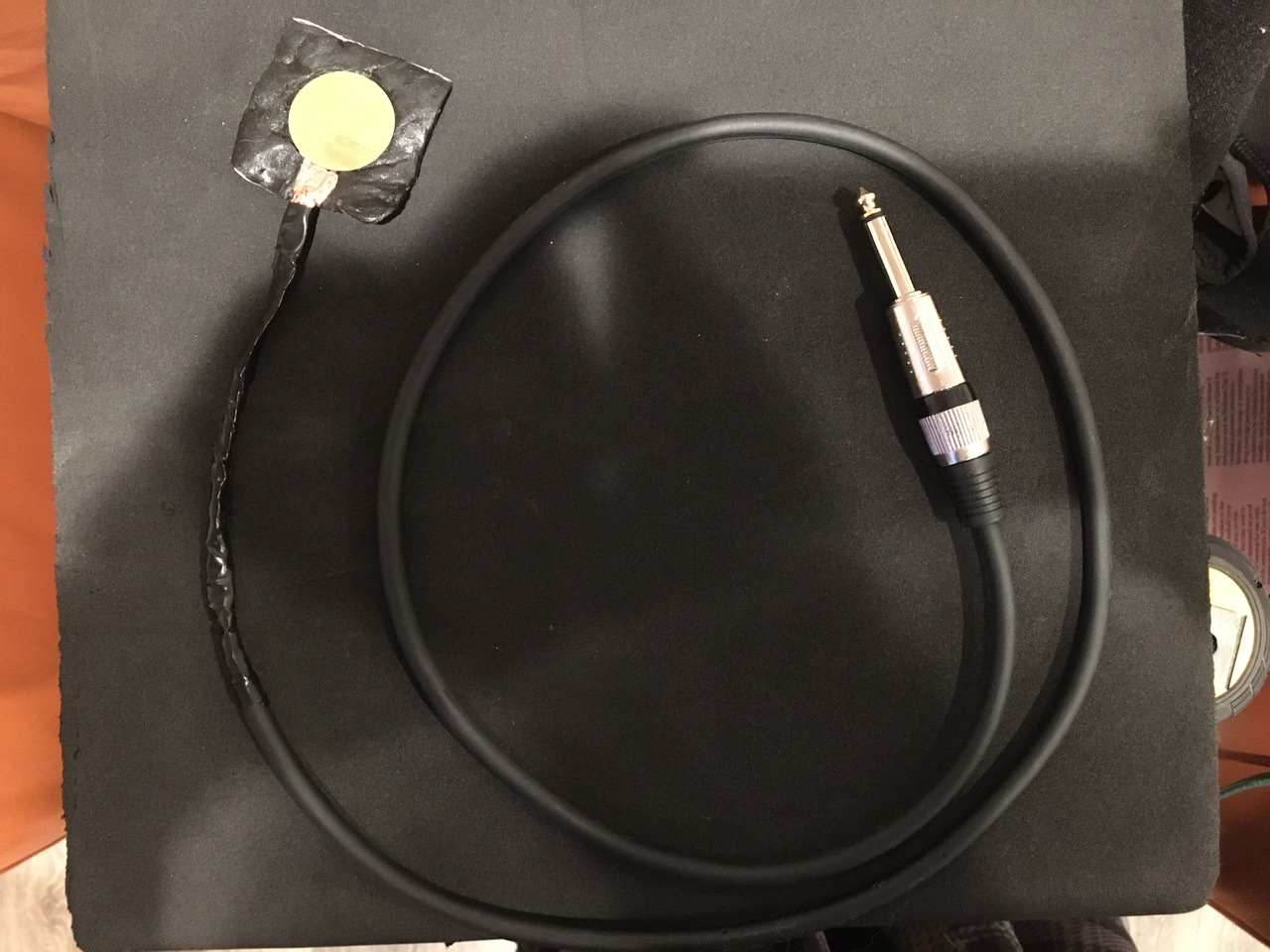

The raw piezo disc was picking up so much sound that I decided to use a patch of Noico car panel deadener on top, which also acts as a really good reusable adhesive. As you can imagine, it helped a lot, but surprisingly it still picks up a ton of airborne sound

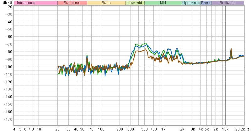

Have some more interesting data involving the loudspeaker stand interface. I need to get some blu tack type product also for testing. So far, Sorbothane wins... By a lot. But the competition so far, sucks:)
Green-Spikes
Blue- nothing
Brown-Sorbothane
I also tried a neoprene sheet, but believe it or not, it was identical to the spikes.
Yes, the items are placed between the stand and the speaker, and the sensor is placed on the center of the side panel. I did make a mistake though. This is with the crossover set at 500hz and 2kz. I'll do more measurements with only the 2khz applied next time(The Sorbothane might not do as well in that situation. John Atkinson did the same type of testing back in '94. I thought it would be interesting to reprise it and add a few things, like Noico car panel deadener to the test and of course, Sorbothane.
Yes. Actually, it was '92 when Atkinson did this study with the accompanying article. It has a ton of really good info for anyone who's interested.
The Sound of Surprise (the loudspeaker/stand interface) | Stereophile.com
The three Sorbothane feet used in his study were very thick(not good) and only three were used(Also not good). It needs to be a relatively thin sheet and all four corners of the speaker need to be supported with it. In other words, it needs to used in the same way he used the Blu-tak.

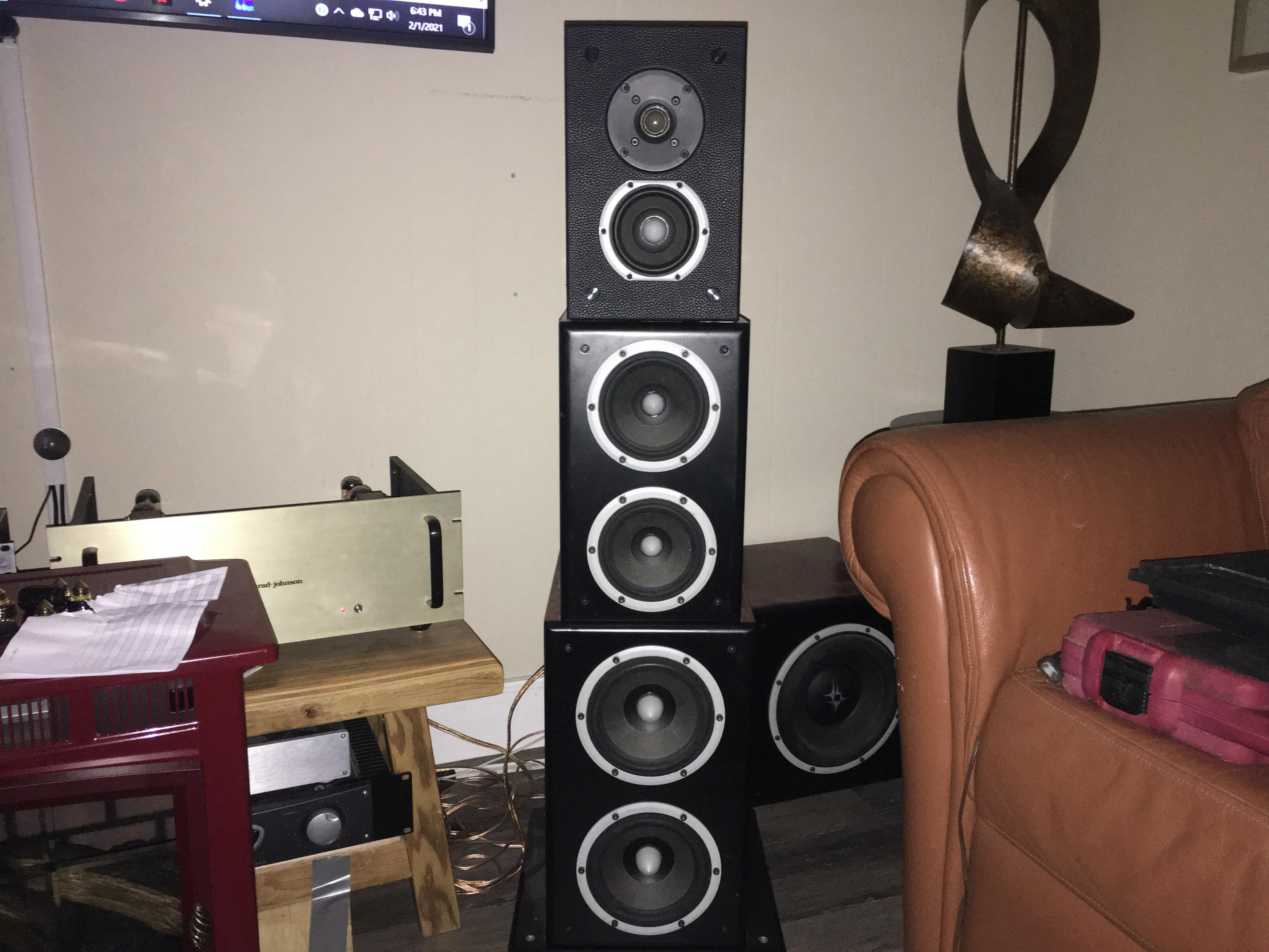

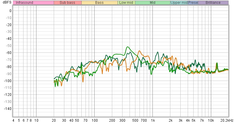

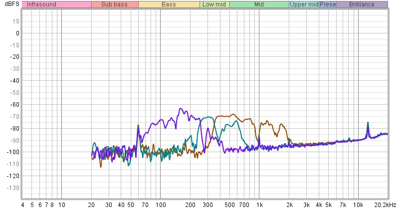

1. The side panel resonance of all three modules with no crossovers applied..
2. The side panel resonances with crossovers applied to specifically deal with the primary resonances of each..
It should also be noted that what is left is extraordinary low in level compared with the module outputs of 90db/1m

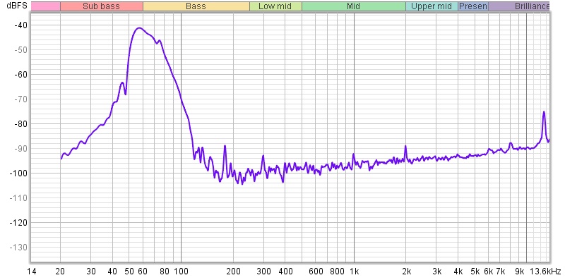

3. The subwoofer panel resonance will be a tougher nut to crack:)
