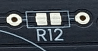

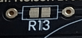

For clarity about the optional gate resistors, R12 and R13, you must either install a resistor, or bridge the pads inside that footprint with solder. Otherwise the MOSFET gates are not connected to the JFETs . Special thanks to @wg45

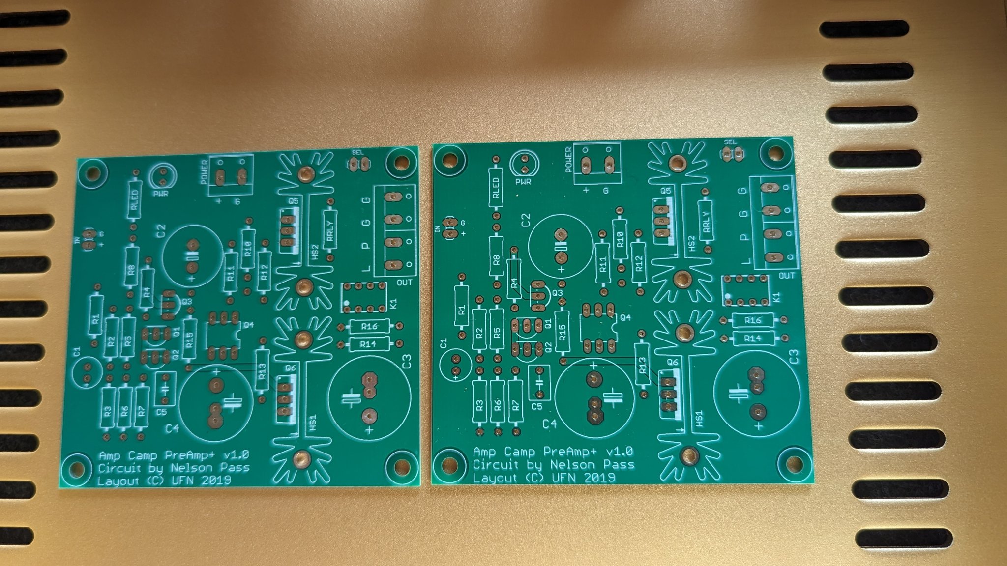

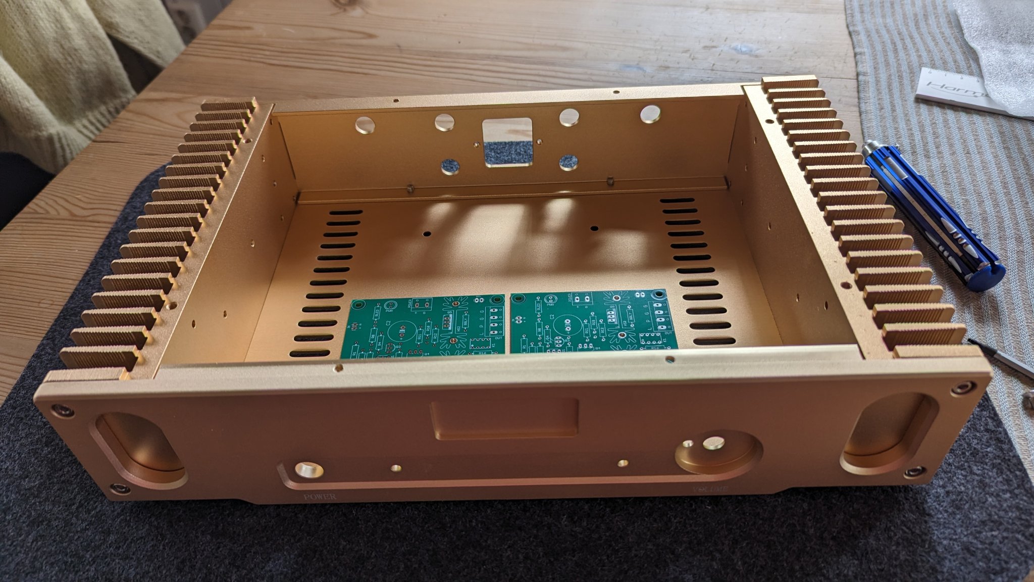

I have these small ACP+ mono pcbs, and I got this small amp box.

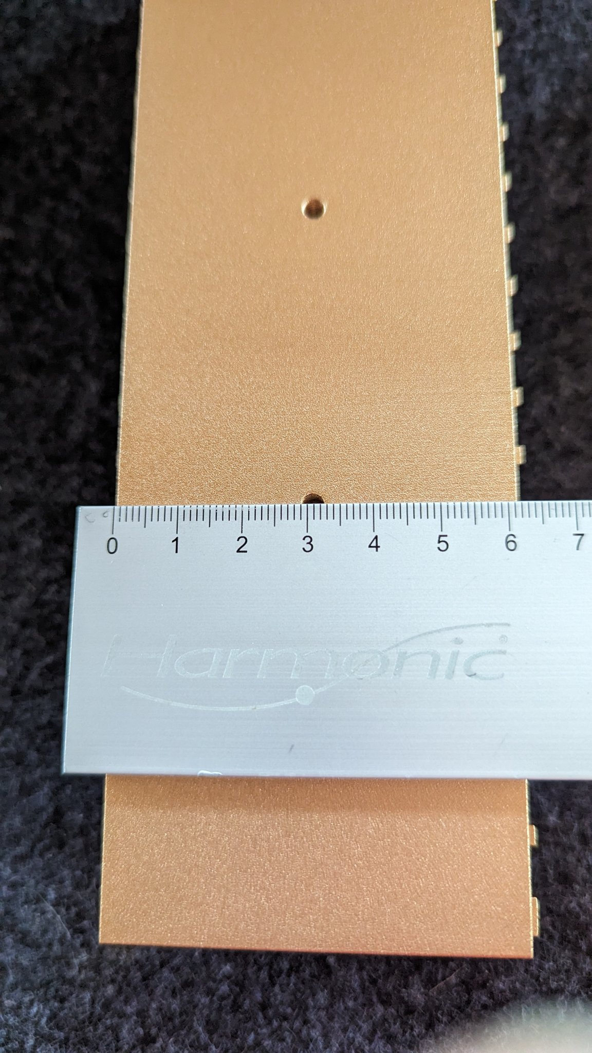

Could somebody please measure the width of the pcb (hoping it is 60 mm or less...)

That chassis looks absolutely gorgeous although I personally would have kept HS black to maximize thermal performance. Good luck with the integrated build!
The MinMax PCBs are 60mm x 127mm. A bit more length is needed because one of the FETs extends beyond the board area, about 135mm total.Could somebody please measure the width of the pcb (hoping it is 60 mm or less...)
Also, what kind of power output into 4 or 8 ohm (?)
Nobody has done a direct measurement of output power yet, and it will depend on the bias current. Nelson Pass estimated "a bit more than 10 watt/ch into 8 ohms" when using a 36V PSU and 1A bias.
Me too. The chassis is actually a delivery from Aliexpress that went very wrong. Somewhere out there is someone with a black 3U power amp chassis + a couple of other black boxes...
Got a refound and bought the correct chassis from modubox instead.
I got to keep this chassis and up until now I didnt know what to do with it...

They should (barely) fit then.
