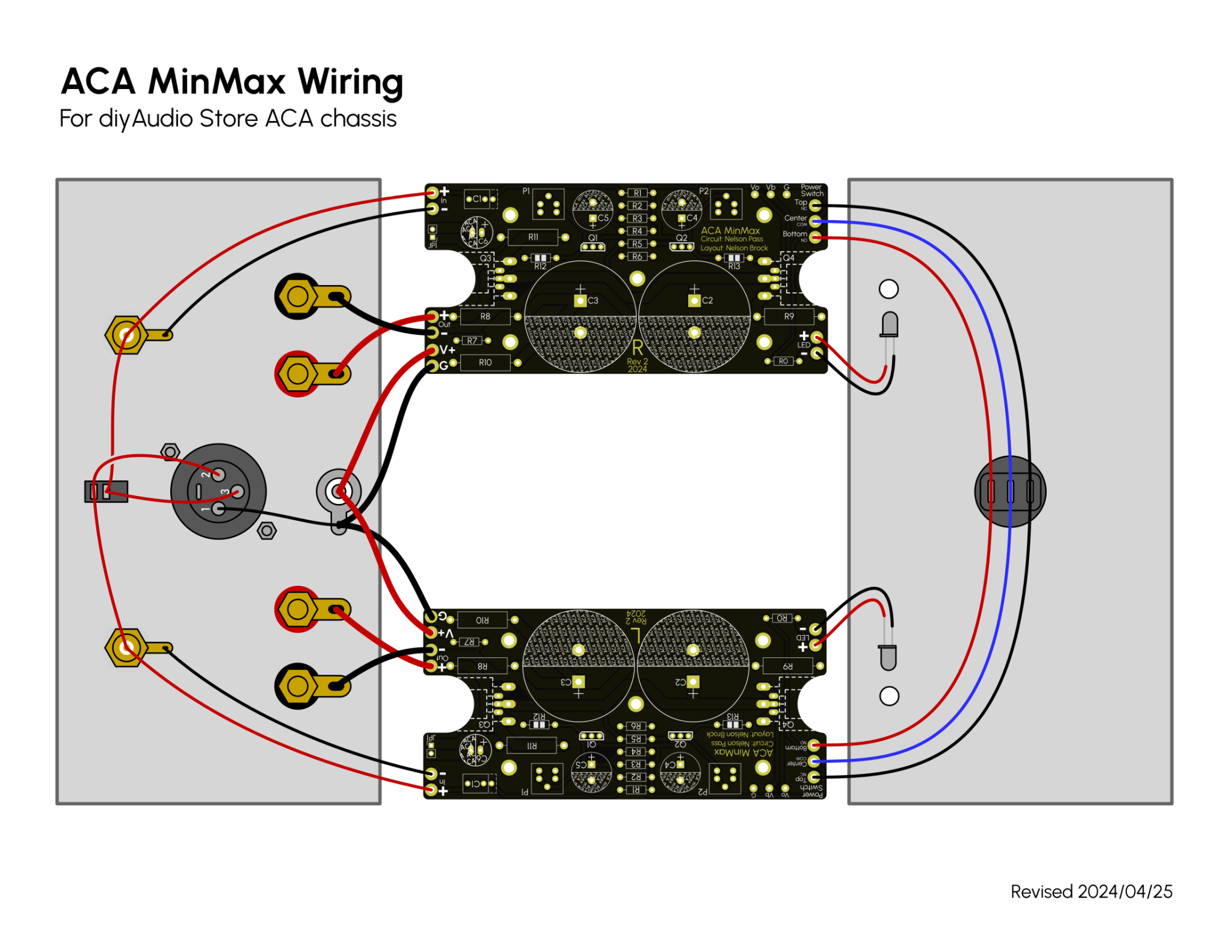

I've updated the wiring diagram to include the XLR connector and rear switch for paralleling inputs.
Can anyone comment if it makes a difference that I'm showing the XLR ground connection straight to the DC jack ground, as compared to connecting to the RCA grounds, for example? They're all electrically connected together, and to the chassis.
As long as the barrel ground is actually connected to chassis (bare aluminum, etc...) then this as drawn will avoid the "pin 1 problem" and is correct.

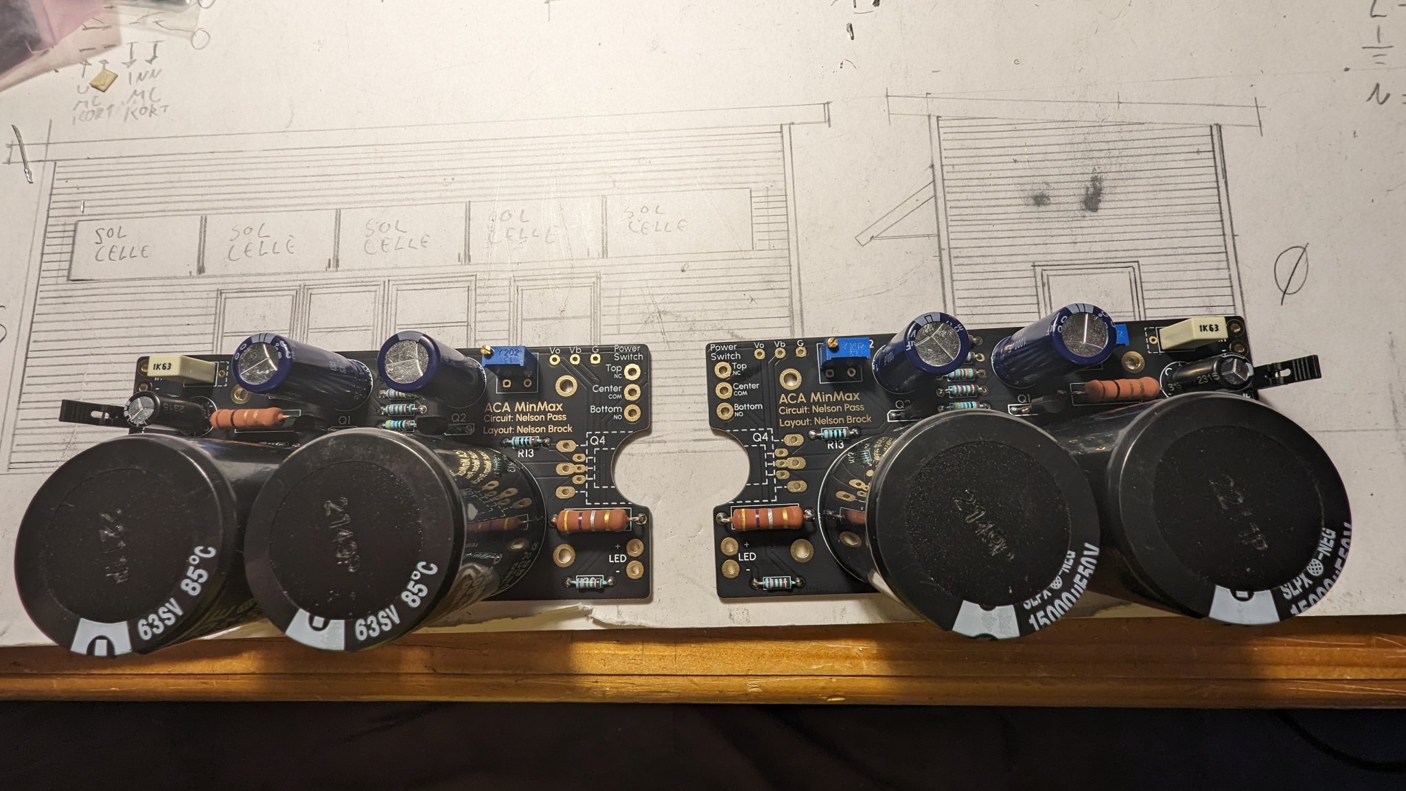

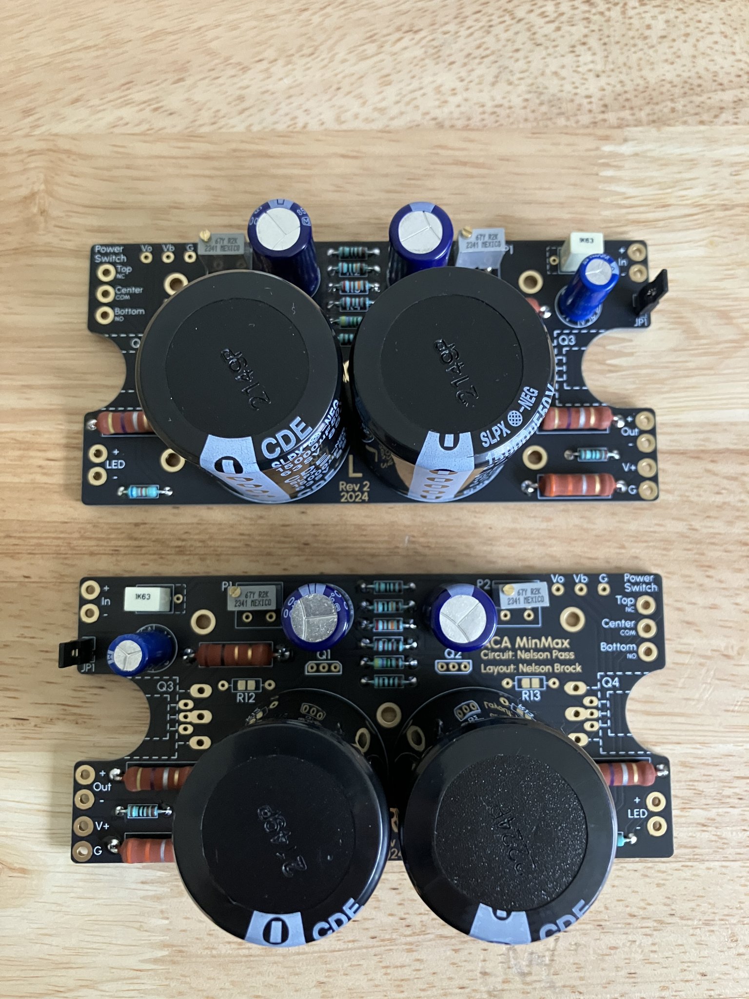

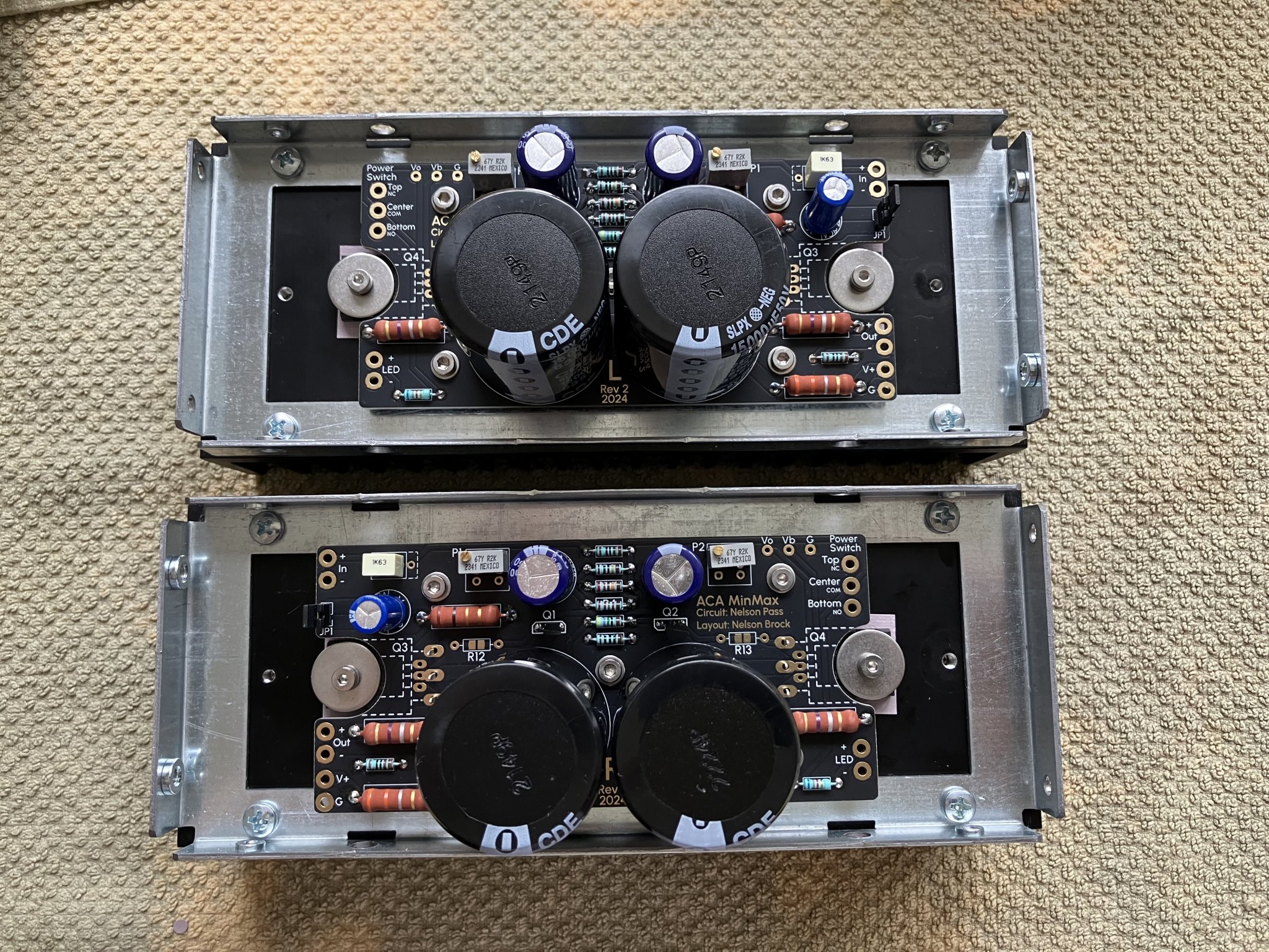

Boards (sans FETs) are soldered up. Next weekend, planning to add those while mounting them and wiring into the chassis. A nice quick project.
After a couple of hours, it looks like this
jfets soldered in. Mounted to the heatsinks with the MOSFETs dry fitted. Need to jumper the gate resistor pads. And go back thru and do a Thoreau read of the build guide and this thread because I just found out about bridgin the pads. Then, time to start building harnesses for the chassis wiring.
