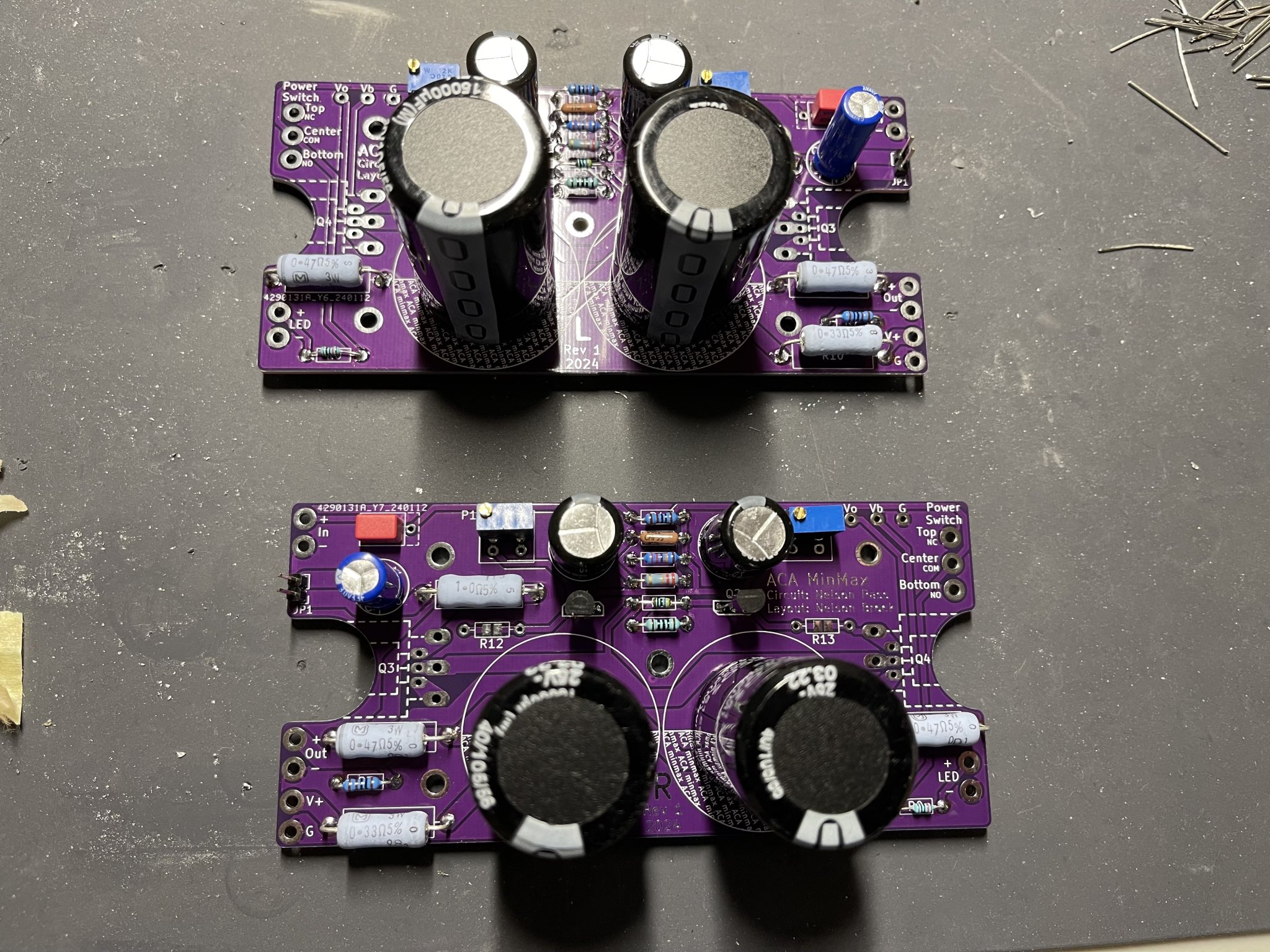

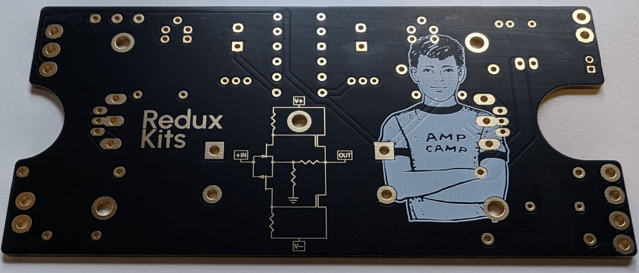

Just one functional change for rev 2: I reversed the connections to P1 and P2 to make the starting position before first power on and bias fully counterclockwise (like a volume control). On previous revisions, zero bias was fully clockwise.
I am also putting together a complete kit for the diyAudio store that will be bundled with the usual ACA chassis and a 36V power supply. A small test run first to work out any issues (Jason calls it a pioneer batch) then the goal is to keep it in stock as a regular product. This is my first time going through the store, so I don't know how long it will take for the listing to appear on the website. I'll share more info on the kits closer to when they become available but feel free to ask any questions you have now.

That's what I do with all trimmers in the PCBs that I draw up. Full counterclockwise on all trimmers before first power-up. Rotate clockwise after power-up for setup. Easy to remember. 🙂Just one functional change for rev 2: I reversed the connections to P1 and P2 to make the starting position before first power on and bias fully counterclockwise (like a volume control).
How do you deal with the chuckleheads who have inline-pin trimmers [not triangle-of-pins trimmers] and install them upside down (rotated 180 degrees) ?? You know, "If ya got it, use it!!" chuckleheads?
That is what I intended to do initially, but I assigned the schematic / footprint pinout incorrectly and didn't catch it until prototyping. I think this is where the issues in post #16 came from, had the pots all the way up when I thought they were all the way down.That's what I do with all trimmers in the PCBs that I draw up. Full counterclockwise on all trimmers before first power-up. Rotate clockwise after power-up for setup. Easy to remember. 🙂
I try to stay away from those by using triangle style footprints. Builder beware when substituting parts with alternative pinouts or footprints.How do you deal with the chuckleheads who have inline-pin trimmers [not triangle-of-pins trimmers] and install them upside down (rotated 180 degrees)
I cheat by using multi-turn trimmers with pins that are in a straight line. I then figure out which way they go when I stuff the board.
Not that I advocate the extra work, but I find placing the location of the trimmer adjustment screw on the silkscreen to be helpful in many cases. Example below.How do you deal with the chuckleheads who have inline-pin trimmers [not triangle-of-pins trimmers] and install them upside down (rotated 180 degrees) ?? You know, "If ya got it, use it!!" chuckleheads?

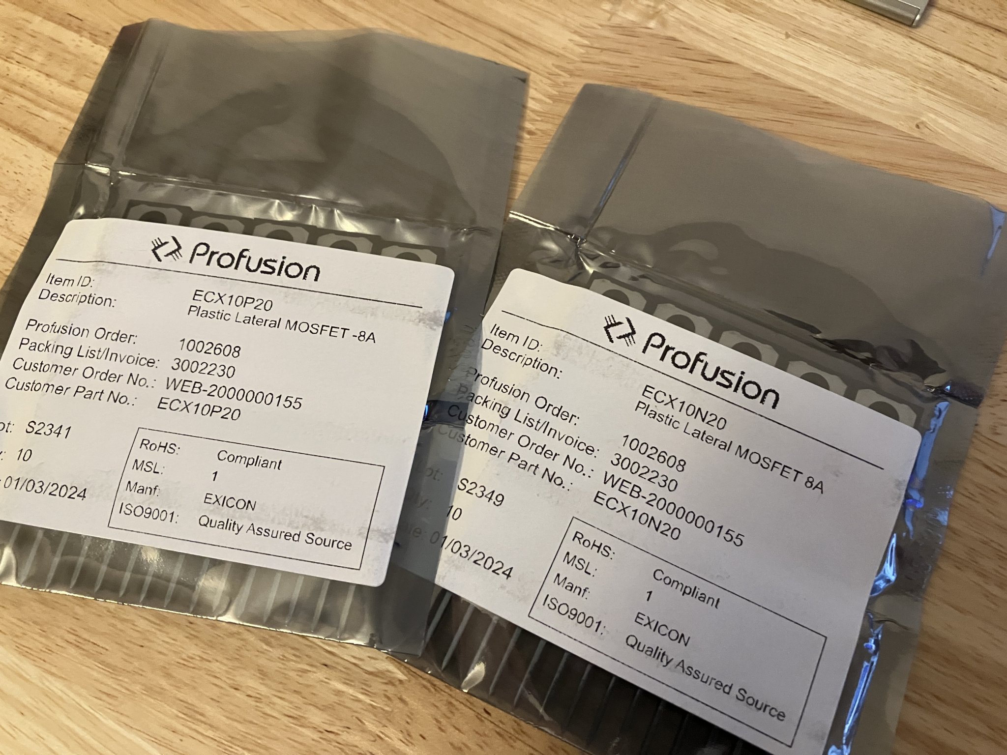

Do realize that the pin configuration for lateral mosfets is different than vertical mosfets that this board is designed for and also that lateral mosfets have negative thermal coefficients instead of positive thermal coefficients.
There are other differences as well…

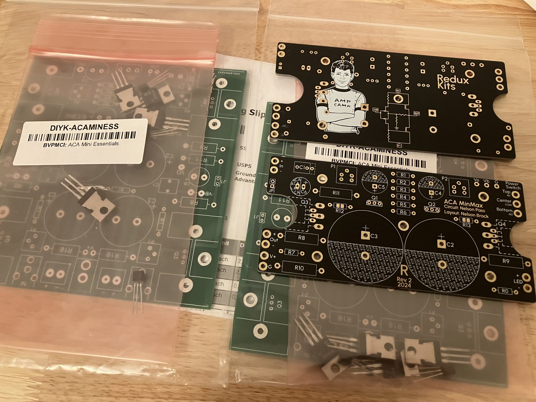

OK! Got my boards, and an ACA Mini Essentials kit, power supply, and a F5M kit on the way as well, so time for a digikey order.
I see that folks have used both the original ACA Mini output devices (IRF9520/IRF520- with 0.75R degenerating resistors, perhaps?) and the larger IRFP9140/IRFP140 units (in the BOM with 0.47R degenerating resistors).
I like the idea of using the matched set of originals I got with the ACA Mini Essentials kit, but am concerned about heat depending on high I bias. What has been other folks experience with those?
If I were to order some IRFP9140/IRFP140 units, how many wold I likely need to find a good match, or is matching of the MOSFETs less important than I am assuming here? Or will I just be fine using the IRF9520/IRF520?

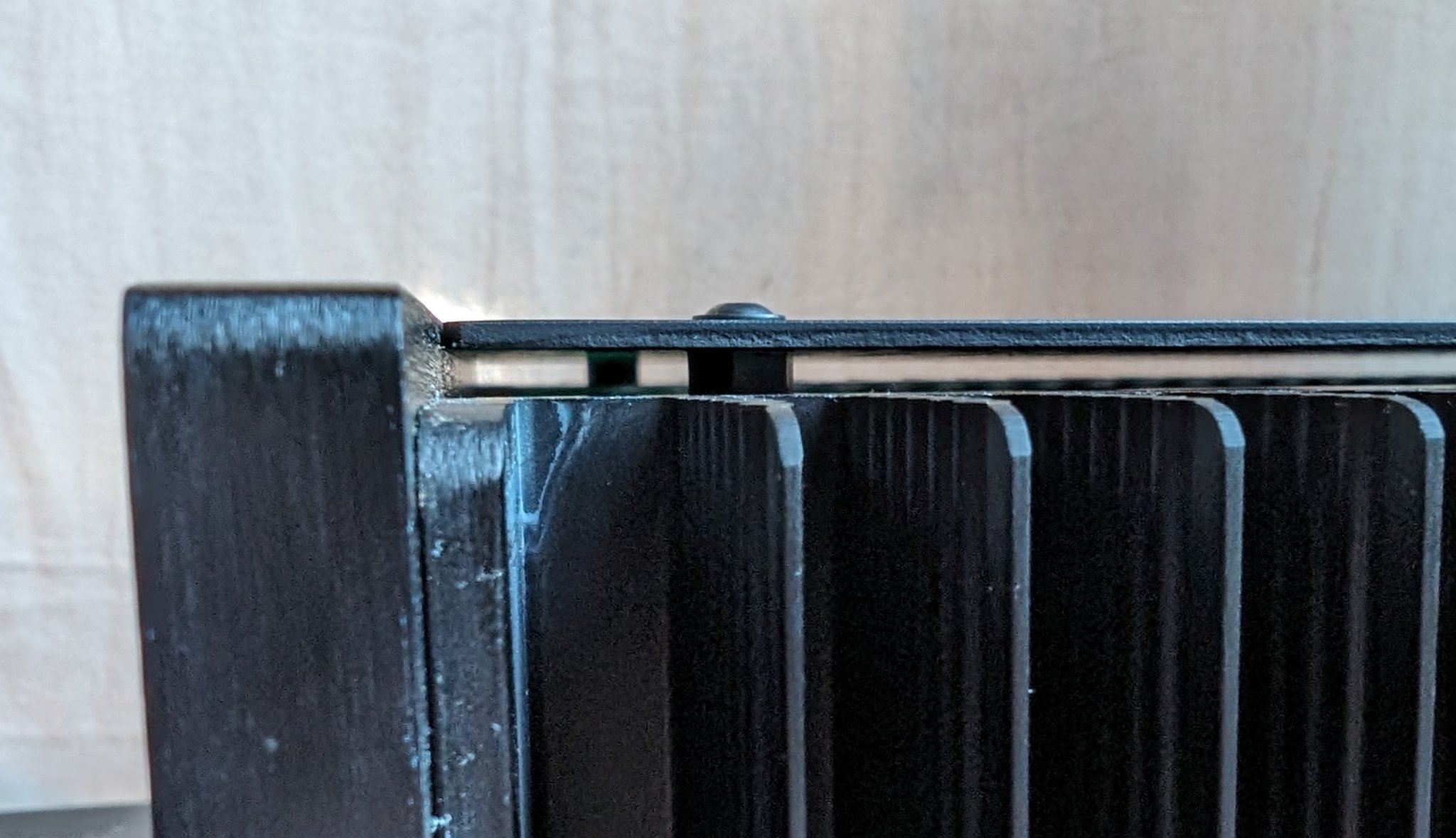

Ventilation is another factor I'm interested in that should influence how warm the inside of a chassis gets. I ran two tests, one with the top and bottom plates attached as normal, and one with the plates spaced off by 3mm using nylon M4 nuts (see pic). This gap increases the total ventilation area from 3600 mm² (slots only) to 6900 mm² (slots + gaps). With slots only, capacitor C3 measured 58 °C. With the gaps, the same capacitor measured 54 °C. A fairly minor difference, and no problem in either case for caps rated 85 °C. However, some supercaps (C6) that would otherwise be suitable have a 65 °C rating (like this one) so I chose this cap with an 85 °C rating for C6 in the kits.
The ACA Mini / MinMax does not require matching of the output MOSFETs.If I were to order some IRFP9140/IRFP140 units, how many wold I likely need to find a good match, or is matching of the MOSFETs less important than I am assuming here? Or will I just be fine using the IRF9520/IRF520?
I'll leave it up to you and the data above to decide between 520/9520 and 140/9140. What matters most is to build it according to your own preference.
