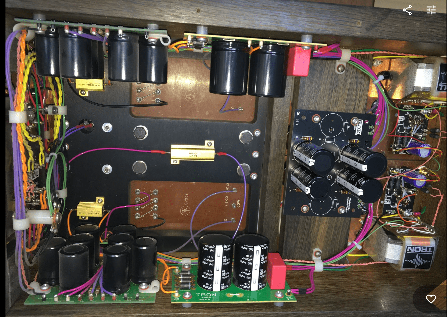

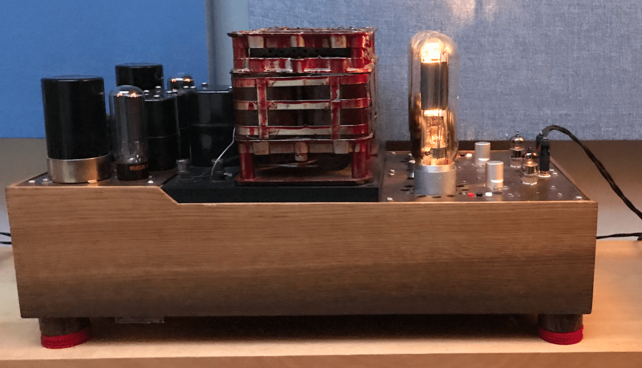

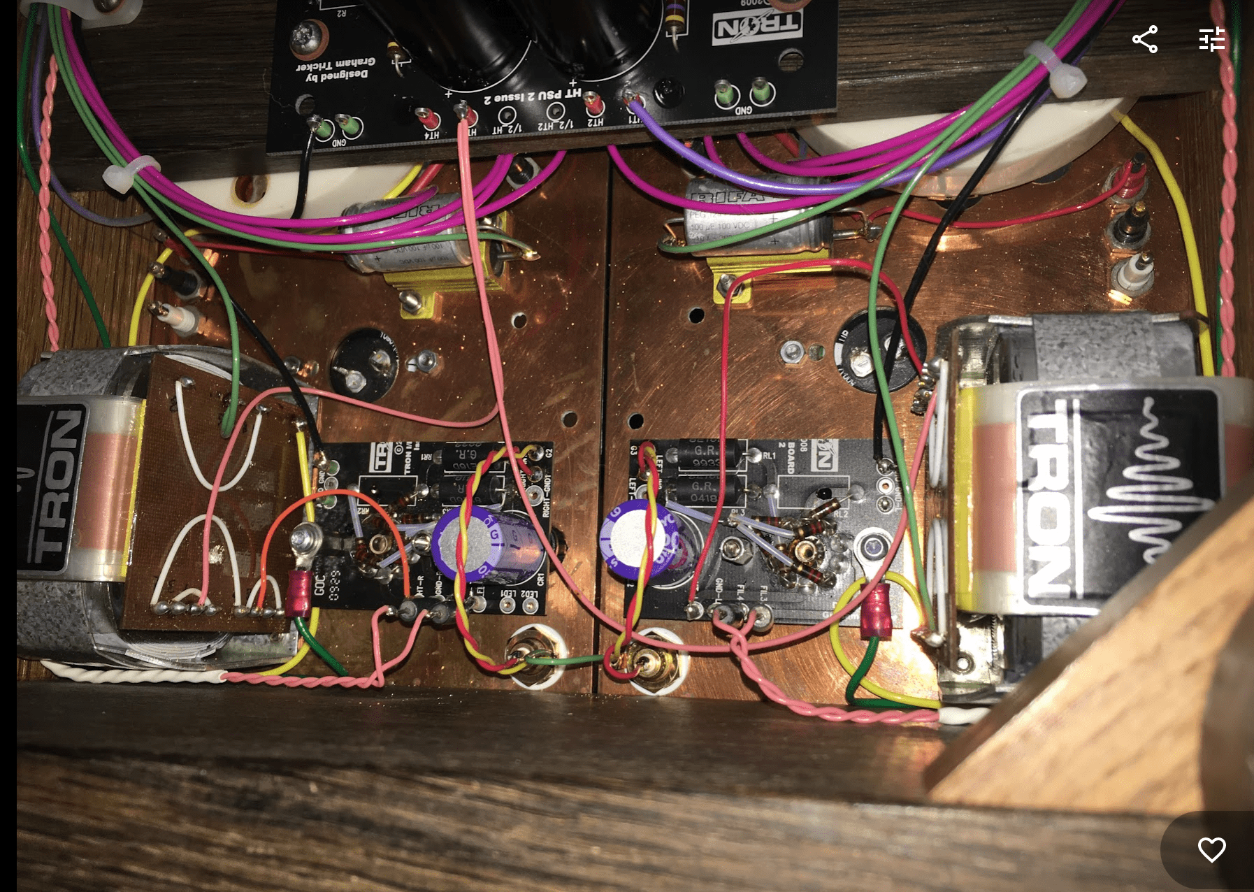

Well actually I have been busy with non-audio life, and I have been reading with interest the debate and knowledge shared - so thank you!
I am a mechanical engineer from first training so I sort of understand a lot of the logic, again thank you.
The 211 circuit is unknown to me, it was build 25 yrs ago by a contact of mine who did not share the design, fitting a lot of his own commercial designs into my half built chassis that I ran out of talent finishing. Next time it is off the shelf I intend to do some more measuring to deduce the circuit and PS if can. It's a voltage doubler from a 450V tap using two 5u4GB valves to achieve the 1000V B+. The driver valve is a 6c45, and it runs through an interstage transformer into the 211 (Lundahl LL1660 I think)
The PS has 2 Lundhahl 1673/10H Chokes, and there are also 3 vintage oil filled chokes used in the rest of the power supply - two I think in the driver power supply coming off half the doubler circuit. You can see a lot of the topology in the attached photos.
The idea of a choke to improve the sound quality of the heater circuit is also interesting, I had looked at these before in a moment of distraction but had sort of thought that at only 10.5 AC there was not enough voltage to be able to get to 10V DC with a choke? Then I read a few discussions whereby AC heating was stated as providing superior SQ, hence the post.

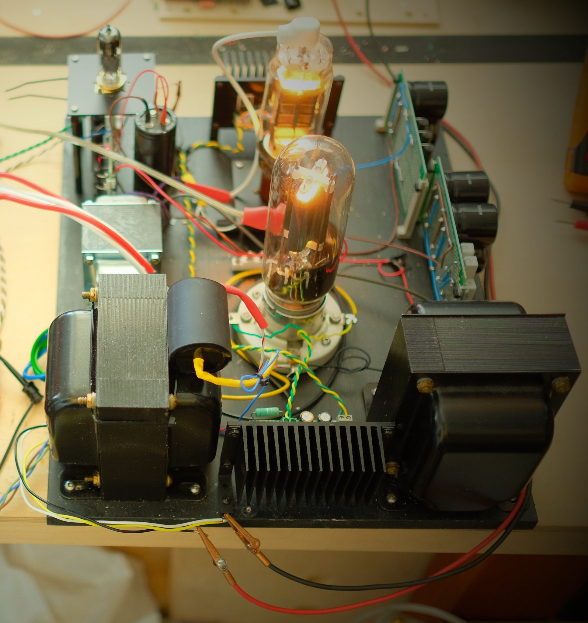

In order to consider a Coleman Filament supply I assume I need an additional higher voltage transformer to power this, not being able to simply use the 10.5 AC tap in existence?
One of the problems of filament DC is rectification. All SS rectifiers (as opposed to tube rectifiers) are noisy. Diode switching noise is not the only problem - there is also transformer ringing due to abrupt current cutoff at diode's forward voltage. Diodes with lowest forward voltage and slow switching are antique Ge things, but these deteriorate with time, and one have to check 30-50 of them to find a marginally usable pair. Rectifiers using controller-driven MOSFETs have zero forward voltage (very good!), but controllers are designed for capacitor input supplies, which is bad because capacitor input filters cause gross distortion of transformer current waveform. Intractable problem.
Ahh, yooze an engineer. (I'm not!) Your 'speech' was pretty unassuming and a bit hard to judge where you were coming from so I felt cautious about egging you on.
By Rod's general info sheet, you want a minimum of 3.5VDC for the Coleman reg. - Nominal 4.2VDC (and Max 7.)
This is where I was interested in your secondary's current capability as for a bridge rectified output for 3.25A I think you'd want it rated for something just under 5.5A at least. (I divide by .62 as from Hammond's recommendations)
It's nice to see all the room you have in there though. From the picture it looks like you could fit an R-core or toroidal power transformer quite easily.
I do agree that Rod's regulator is a very good way to do it (they're on heatsinks in the 211 breadboard pic below), but I have a thing about people being dissuaded from checking things out for themselves so had to chime in. Once you've got it off the shelf and if you have the time, I still think it's worth trying before you go to something more sophisticated.
