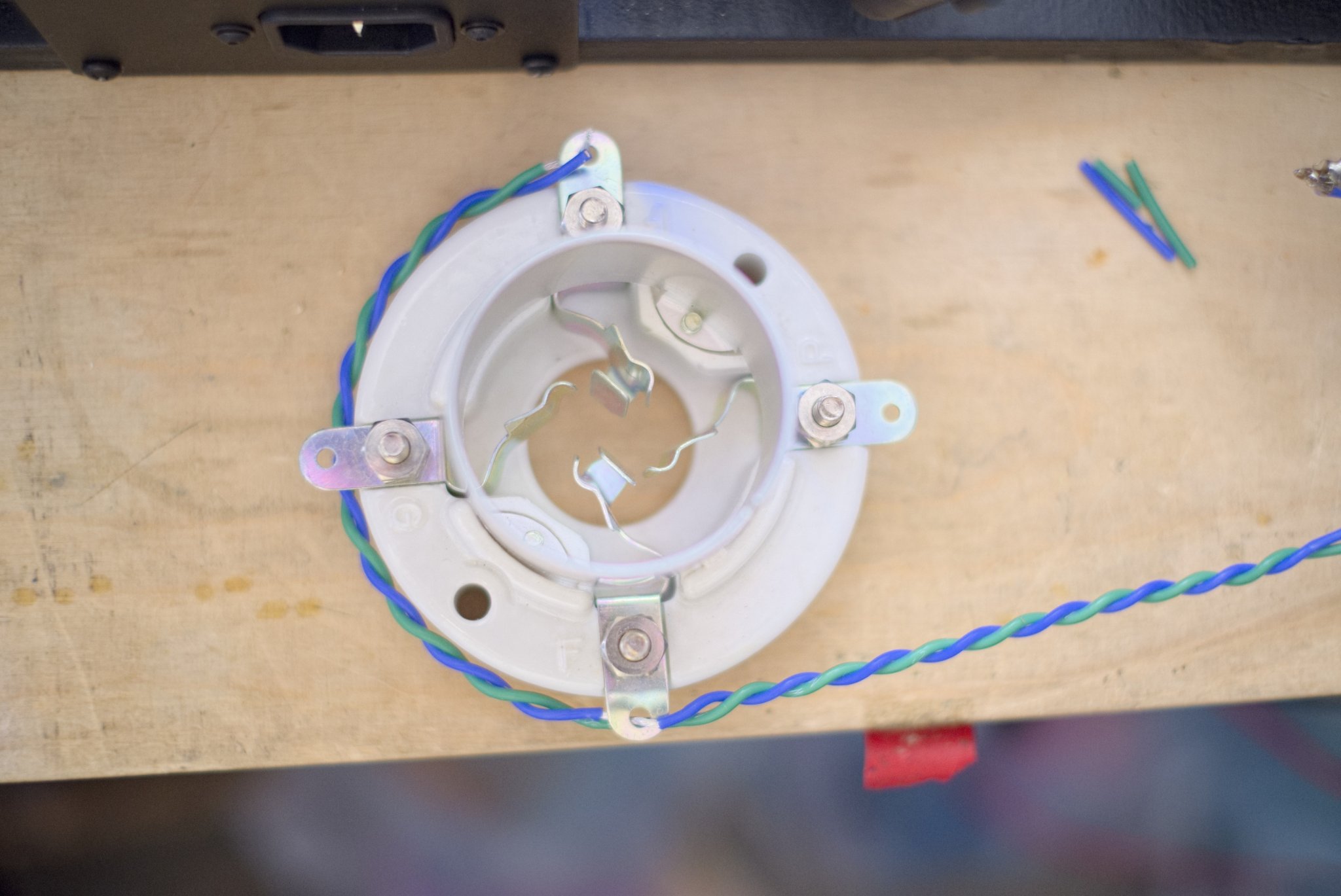

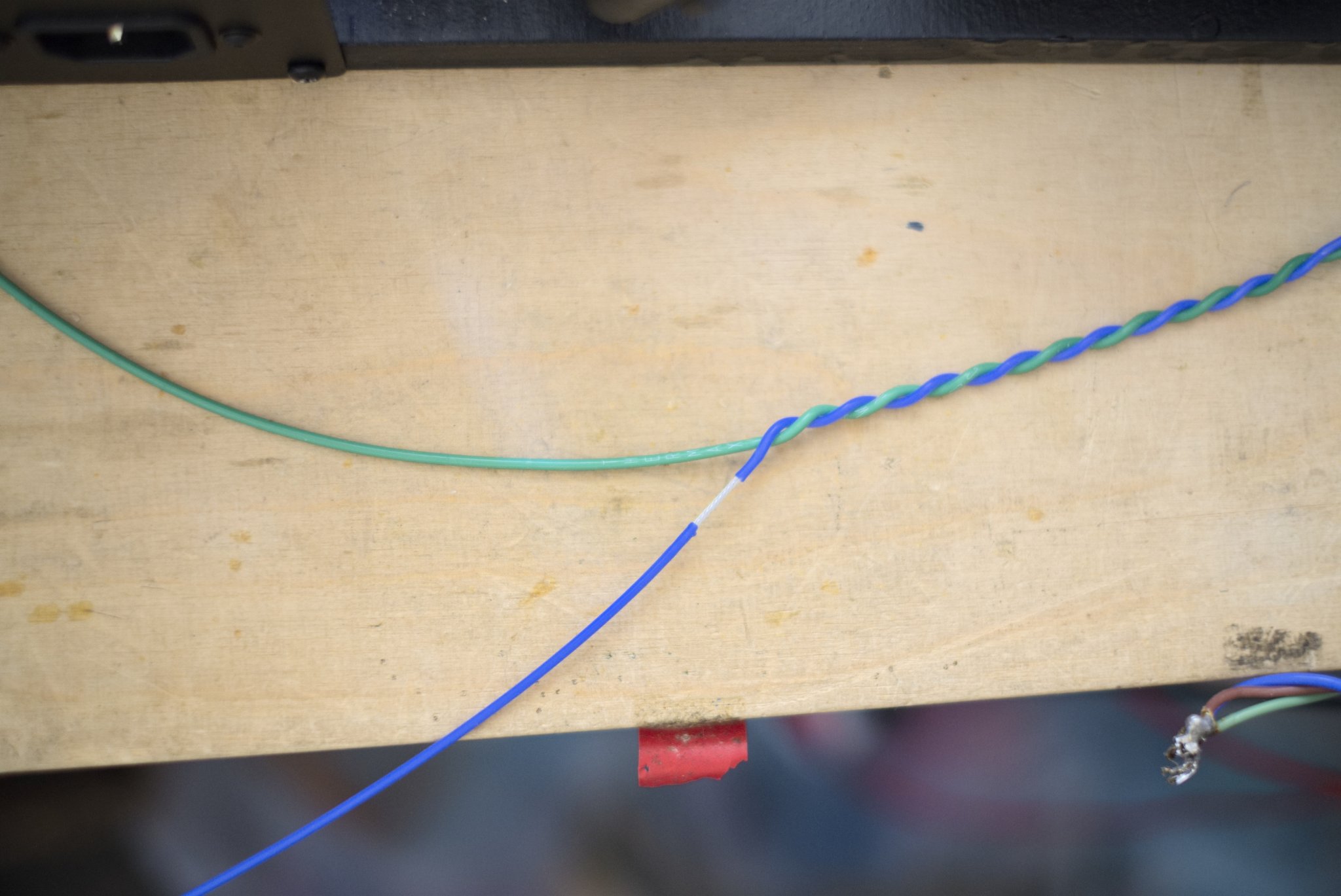

Anyway, to answer your above question about wiring dress, I assume you mean the AC to the socket, I'd probably do it something like in the pics.

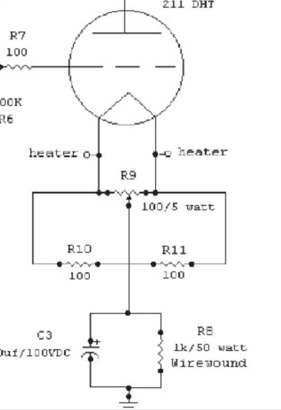

If I do a trial of moving to AC, and just see what happens a couple of questions:
1. If I have over 10V AC - how is it best to reduce the voltage, a series power resistor?
2. Do I need to add some fixed resistors either side of the hum bucking pot to the wiper/cathode like the image attached?
Thanks!

This is a great design of the layout, fantastic - thanks!

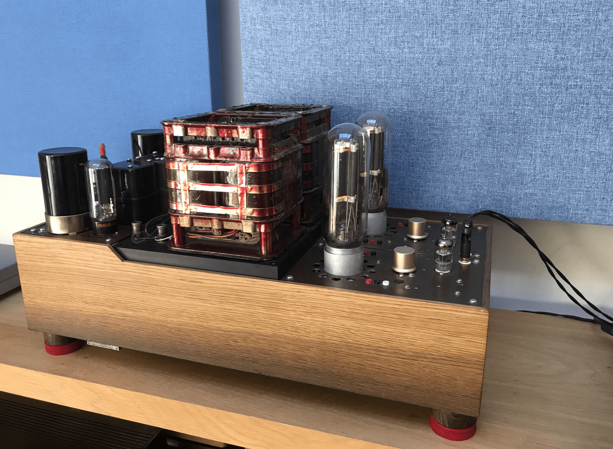

The amplifier is shown here and very large transformers, bog oak chassis and large plates of aluminium just add up.....it's about chest height on a shelf to keep 1000V well away from my 6 yr old 🙂

I assume the top blue is not connected to anything and the green is soldered here, and the blue is soldered at the bottom terminal?
so the blue from bottom to top is just carrying voltage, but not current?
Could it also work by sort of running a 'ring' all the way around each valve socket, and retain the flow of current along all the twisted pairs?

I assume . . . . . .
Yes, but I do it this way for my own reasons and put it there after looking at a few pics of 845 amps with everything crammed together at very close quarters and thought yours might be the same. I made the photos with some off-cuts. Ordinarily I'd measure the length and cut first then pull the blue insulation so when finished the end of the blue insulated conductor is not exposed.
You might be just as well off running twisted to one and from there single around to the other.
The 'ring' around the socket thing doesn't make any sense to me.
I started off my first reply not having seen the photo and assumed that if it was a commercial product it was probably ok with the AC filament. Perhaps even some sort of hum reduction in the overall circuit etc. It would be good to know exactly what the original circuit was.
I've seen a photo of that amp somewhere else before, years ago, the red colour on the transformers is unforgettable. No schematic or power transformer I.D. , etc. ?
I'm not expert enough to give more than basic generic opinions, I only know what I know and what I don't know and limit myself to building as well as I can within a fairly narrow framework. Your mention of your six year old turns on my caution light.
