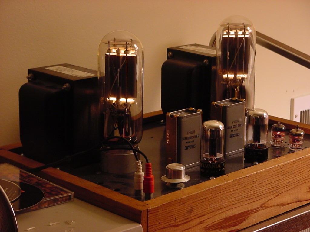

Years ago I build a single ended 845 amplifier with the power supply on a separate chassis. It uses AC heating with balance pots and the hum is only audible if you put your head next to the speaker. I enjoy the industrial beauty of these large "ancient" tubes.
Nice amp!

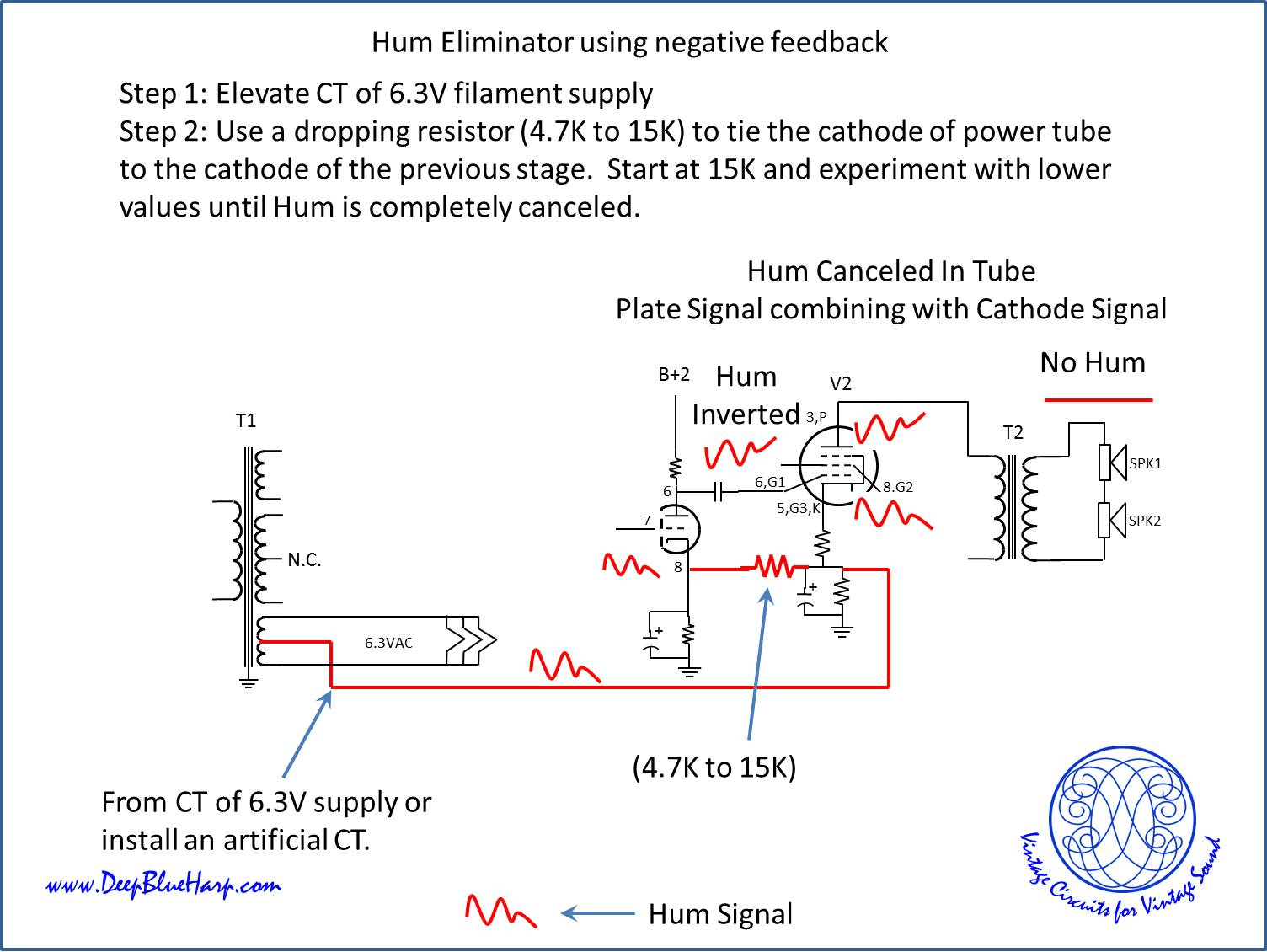

Something wrong here.....
Since this is AC and NOT bridge rectified, you don´t get the double frequency (100 or 120 Hz).
You get exactly, what´s in the mains: 50 or 60 Hz hum. Btw easily cancelled out by using a "hum-bugger" (balancing pot on the filaments
to cancel hum), or you can use a hum cancelling feedback circuit
It's a nice suggestion, but as a check on how effective it's likely to be: consider the path of the AC waveform on the anode-cathode curves (and imagine it for the grid to cathode curves, which are also exercised by AC-heat). In both cases, the waveform tracks above and below the operating point; and as the music-signal amplitude increases, the (above→below) symmetry breaks down. This degrades the effectiveness of any cancellation.The issue of signal modulation by AC filaments can be attacked by using even numbers of identical valves in parallel with opposite AC polarity or in push-pull with same AC polarity.
