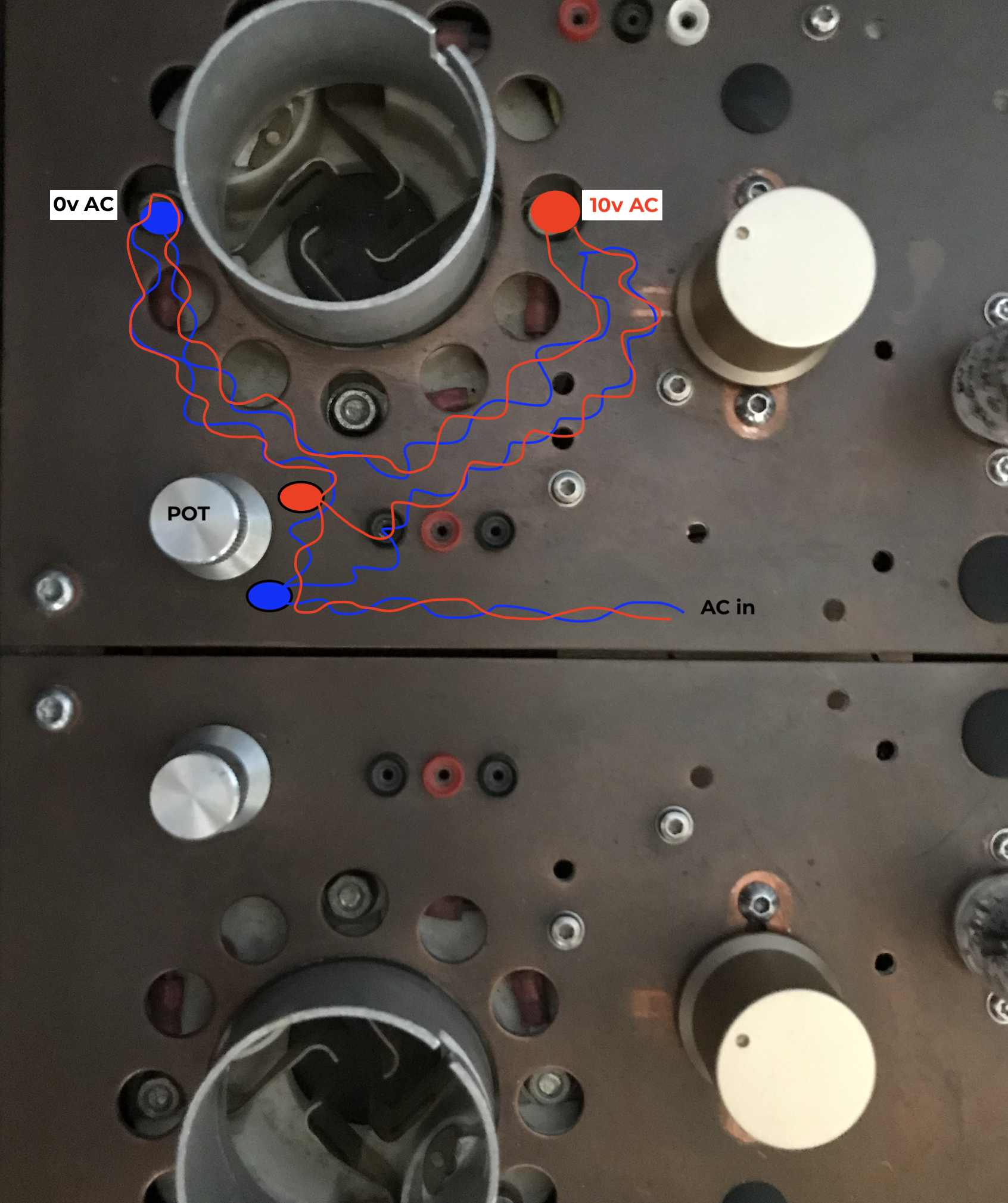

Hello everyone, just to update you I have now purchased the regulators from Rod, and will build myself a DC supply to feed based this upon some repurposing of the existing DC supply (new diodes STPS1545D )
I will also go through the exercise of listening to AC first as it's not a huge amount of work, and I can share my listening experiences in my system.
With respect to using AC for the first trial then I have a couple of questions.

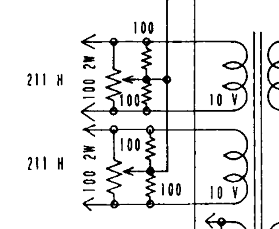

  1. If I find the 10.5AC quoted creates to high AC across the filament (I will put a dummy load to see) then is it just a simple job of adding a small value power resistor on each side of the AC line. This would be pretty simple as I am going to join to the existing twisted line from the transformer and I can just add two series resistors here on each wire.
  2. When I run the AC into either dies of he balance pot, I see many circuits also utilising two fixed resistors (e.g. Ongaku schematic with image attached) that run across either end of the pot to the cathode/wiper connection. I presume I just follow this approach, and add these resitors to the install.
  3. When I wire my AC as a twisted line, there was an earlier IMO great idea of also twisting the last leg of the install (thankyou Hearinspace!) with a blind(un connected) wire to keep the twisted affect. I am still unsure if this works even when there is no current flowing in the blind lead, any smarter than me dudes care to comment?
Thanks!!

Really nice that you're actually posting a follow-up. That doesn't always happen.
I've never seen it done the way shown in your posted screenshot and don't know what benefit that way of doing it might be outside of its use with the Ongaku's grid bias scheme.
I'm used to seeing the added resistors at each end of the potentiometer's resistance element (not connected to the wiper), limiting the pot's balancing influence to a narrower band either side of centre and making the set voltage more finely tuneable.
I have never measured the influence of the extended run (or lack of it) but for all the work it entails it seemed like a good idea on a very tight phono circuit I built a few years ago that came out very quiet and so I just keep doing it whenever quiet is the chief concern in situations with very tight spacing. I doubt you'd see any difference at all on your circuit without it. (I didn't use it on the Coleman regs in the pic I posted.)
Is your 10.5VAC winding centre-tapped?
Twisting two conductors together works to minimize coupling in and out because, at a distance, it averages the fields of the two wires, and because the destination is differential, meaning being sensitive to (only) the difference between the two wires. It must have "common mode rejection". Simply corkscrewing a wire has no effect on external coupling.
There's likely no advantage to splitting your dropping resistors into halves - transformer secondaries aren't symmetrical anyway - but it doesn't hurt. Live it up. Be sure to size them to survive turn-on cold filament current for a few seconds. Instead of hot load of about 3R, for a few seconds you have a cold load of maybe 0R6, fairly serious. As R. Coleman has made clear, you want a hot filament voltage of 9.5 Volts (RMS or DC).
Another option for balancing trim pots is to use a much larger value than the main current carrying resistors. I like 50R main resistors and a shunt 1K pot. This lightens the DC current through the pot's wiper (for longetivity) and makes it a finer adjustment (less sensitive). If you're careful in its use, you can make a headphone adaptor from speaker outs directly to headphones, no attenuation, for easiest zeroing of these trims.
All good fortune,
Chris
yeah I found this this also and the extra resistors may be a safety in case the pot lost contact.
I can't help but wonder if that isn't a response to the wiring in my posted pic. It never occurred to me it might be interpreted that way, so maybe not.
I simply had a twisted pair in the drawer and backed them apart enough to get to the socket lugs.
Funny, now I can imagine somebody sitting there with a chopstick, coiling their hookup wires . . . . . .

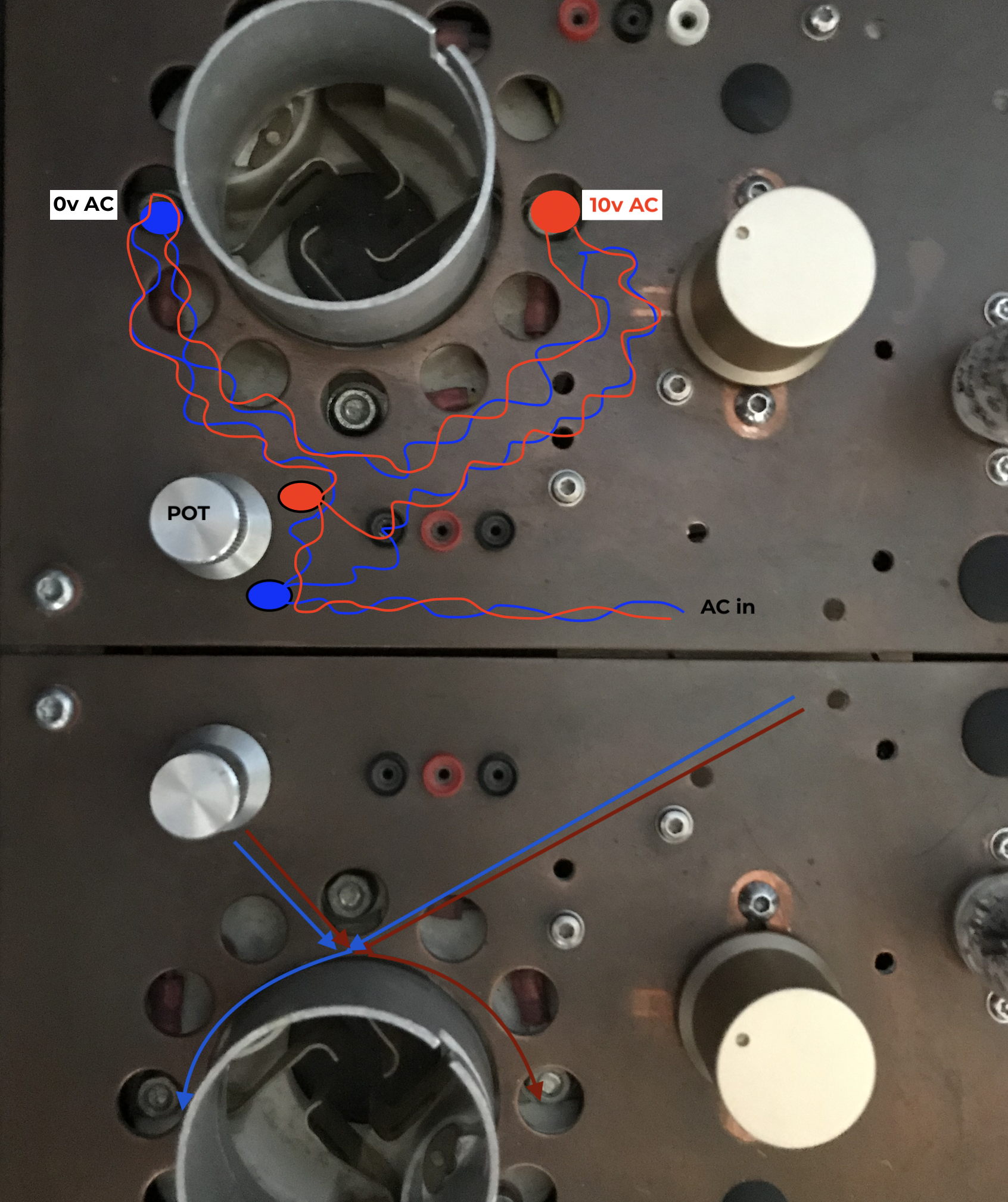

My thoughts.
If doing it as though permanent I'd probably do it something like how I drew it, where the side by side runs represent twisted pairs. But it all depends on what you actually have to navigate around in the circuit.
If it's an experiment first, no need to wire it all professional finish like. I'd start with a more 3d layout. Twisted pair hanging down and away from the AC source and circuitry, rising up again to make the connection from under the socket. Simple and almost nil chance of getting hum from the wiring. Then, if there's audible hum , you know it's not the wiring but just the fact of AC powered filament. If on the other hand you like what you hear, then you can set about figuring how to do finished wiring without introducing unnecessary additional hum.
I always keep in mind a story I heard about how Telefunken got their old tube radio receivers so tightly packed with transformers, components and wiring all snugged up together. Lots of engineers and techs, trying it this way and that until they got it quiet.

thanks, due to room restrictions and access without taking too many things off the amp, I will probably prepare the pot with all the necessary twisted prepared leads and then pop this into the unit, I will keep a record when I get around to it 🙂 and share for those who might have an interest

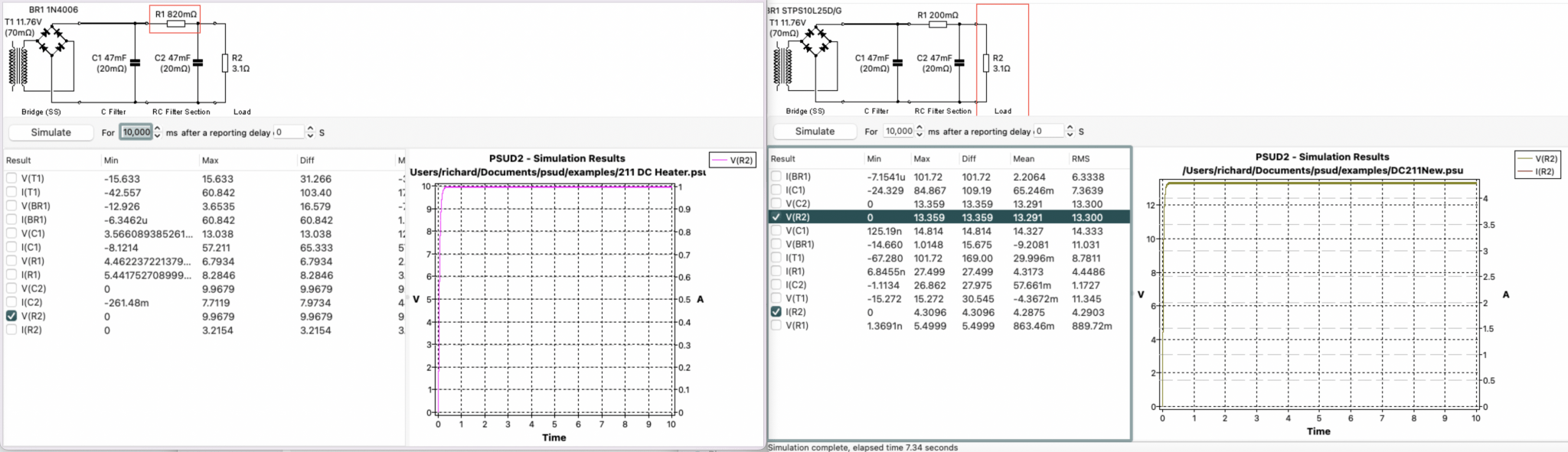

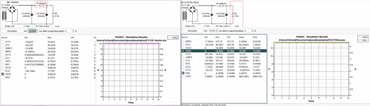

Following up on the suitability of the voltages and choice of diodes, I have been trying to make sense of things from some measurements I made on the amplifier without any stripping down.
Here are two plots using PSUD2 which I am starting to become familiar with. I used some of the capability of this to hypothesise the internal transformer resistance as I did not measure this directly. This seems to suggest that with Diodes with a low forward voltage I should be able to get to 13.3V as I am getting 10V DC now across the valve and measured about 2.4V across the R82 resistor.
I have modelled a 200 mOhm resistor and used STPLS20L25 diodes
I have a hum pot in the circuit too and I don't really know how to model that.
I have had to increase the voltage at the transformer to get the simulations to create the measured outcomes.
Input welcome 🙂

Hi Rich
The original diodes you have were on a board marked 300B - and I think that's why they are under-rated. The types I use will give much lower drop ar high current (the only place it matters!).
With PSUD2, the built-in type 1N5828 comes close, use that for your estimates; 1N5822 is nearer to the 300B version
PSUD2 PT voltage is the unloaded voltage - easy to measure
