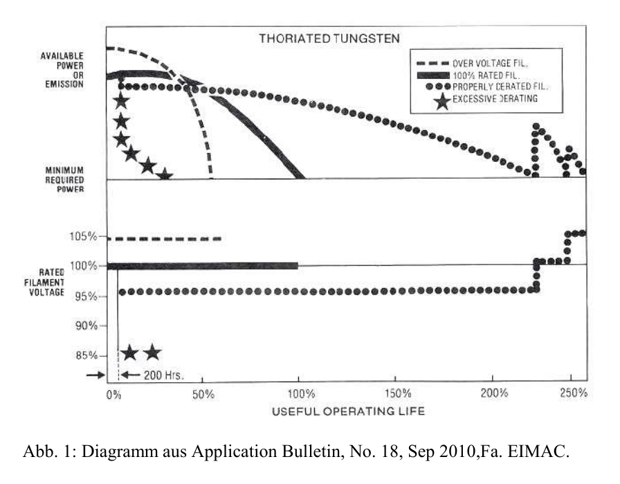

Given that the tube has a thoriated tungsten filament, one optimisation that is very useful in this case:
controlled reduction of the filament voltage. Run at 9.5V, and gain another 0.5V in headroom for the regulator.
This has two benefits: Gives more overhead to work with - and makes the tube last much longer.
The picture is from an Eimac application note (AB-18, 2010 revision). It shows how stabilizing the filament voltage at -5% of nominal (after the burn-in phase) can potentially extend the tube's lifetime by more than double, compared to running at nominal Vf.
As the emission starts to become exhausted (indicated by lower output, or increased distortion), the filament voltage is adjusted, in steps, at the end of the tube life, to extract the last drops of performance ( and serves as a warning to locate new tubes!)
Given the ±5% or even ±10% Line voltage tolerance (in Europe + other countries), this is not a viable option with AC-heating. Considering the cost of replacing transmitting tubes, allowing Vf to wander around with the (AC-heat) Line voltage is a wholly false economy.

Yes, reducing heater / Filament voltage has a similar effect in all tubes, and lamps as well. No surprises here. I completely agree with you on giving the regulator more headroom while extending tube life. It just simply makes sense to do this.

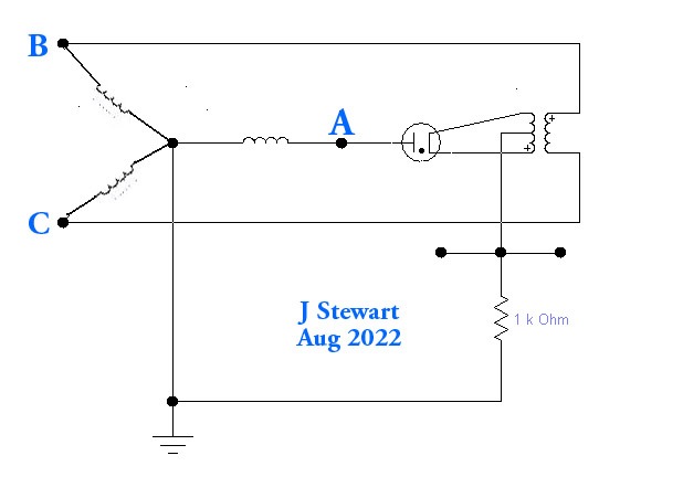

quadrature heating
My comment was kind of a fishing operation, any folks with power engineering in the crowd? Looks like maybe not.
Quadrature heating of the cathode was used with gas & mercury rectifiers to solve a cathode emission problem.
The drop is usually only 8V. So that even tho the potential across the length of the cathode is at max 2,5*root of 2,
in a single phase circuit most of the current will always come from the same end.
That problem can be minimized in a 3-phase system. In the diagram, if phase A is to be rectified a voltage 90 degrees
out of phase can be obtained using a step down transformer across the ends of phase A & phase B.
And similarly for the other phases.
But there would always be six rectifiers in a full bridge, The simple diagram here makes poor use of the copper & core
of the transformer. A figure of merit called 'Utility Factor' by people who design transformers, for power in particular.
A resistive load with no rectifiers gets a rating of One.
Quadrature heating of this kind would never be used in an audio amplifier circuit. Except maybe the rectifiers! 🙂
Put this in your file of 'May As Well Know'.
