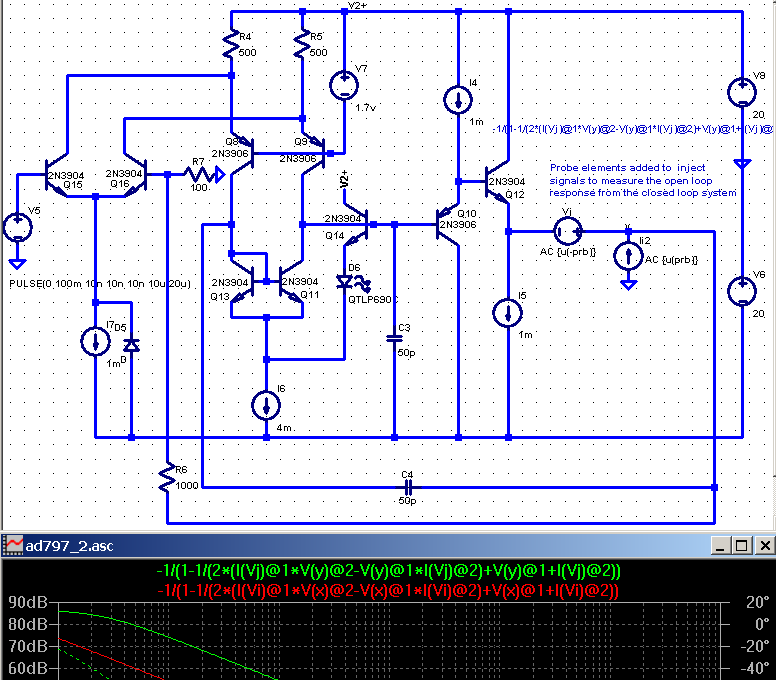

As your nice amplifier is close to AD797 input and 2nd stage
you may some time when you wish,
try to use the AD797 second stage idea.
See attachment. Also same diagram can be found in AD797 datasheet.
This is a jcx posted variant of AD797.The LED in second stage is not in the original.
The idea is to use a floating mirror - gives at all output voltages same Vce across Q8 and Q9.
😎 This is one of the secrets of AD797 exceptional performance.
Lineup 😉 regards
Lineup 😉 regards
Well, the idea behind floating CM is to present the same higher impedance on both sides of the LTP outputs, hence a very well balanced first stage at all working frequencies, hence a very high OLG, but unfortunately, only at LF.
The Achilles heel of this topology is VAS output impedance, which is high. Any attempt to load the VAS will ruin OLG.
It actually works really well only coupled with a very well designed output stage.

Hi lineup,
I try to avoid complications if the results are not going to realize a substantial improvement. One area in this topology that I'm trying to avoid changing is the VAS. I don't want to upset the stability of this design - it is the biggest attraction.

MJL21193 said:Hi lineup,
MJL21193
Maybe you did not notice, but I said:
... maybe some time if when you wish
Meaning, put it into your knowledge bank and try it out some other time.
Now, I know you have got a new idea from me.
Would I expect a thank you .. maybe.
But I can not require any thanks from anybody, I know
There are so, so many people without any sense of gratitude on our forum.
Lineup 😉
