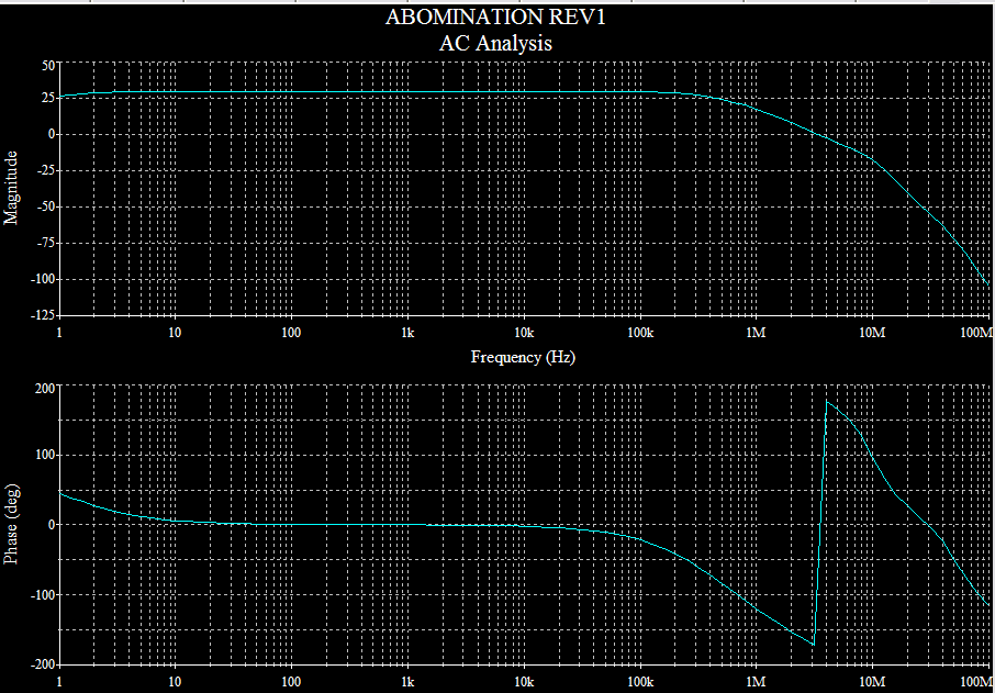

ostripper said:
No comp, let's see now, unity gain will be in the MHZ, Cdom
will be the Cob of the tranny. Will make a good RF
amp..😀
OS
AC analysis of the compensated amp:

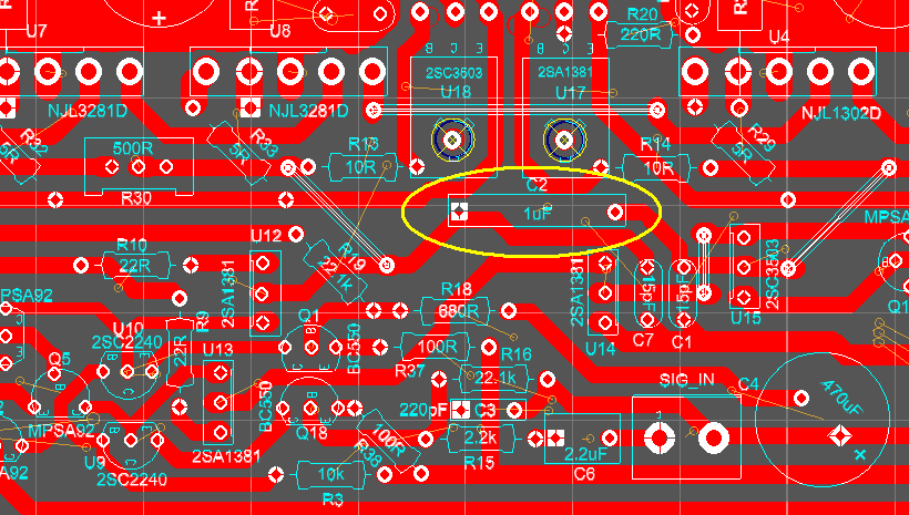

Hi MJL21193
Have you thought of using a Foil Type 1uF and 0R8 (approx) in parallel with R35.
This is suppose to assist with the charge suckout mechanism (as described by Hugh) and Roender found that it had a very positive impact on bass control at high program levels. Roender used a 0R82/0.6W, metal film resistor in series with 1uF Vishay Roedestein mkp1839 to control ringing in driver transistors.

KLe said:Hi MJL21193
Hi KLe,
I need to post a more complete schematic. The board layout does have the cap you mention. although it is a regular poly film 1uF.
See the pic below - the yellow circle.
EDIT: No, I am wrong (as usual). That is not it and it is my intention of adding that cap. I will post a revised schematic and change the board layout to include it.

It will probably work great with standard outputs and a Vbe multiplier - why not. According to the On-Semi application sheet, the TT transistors real benefit are realized when you want to run a higher idle current and avoid runaway. This is something that I want to do with this amp - run it at a higher idle current.
A candid look at the board layout. This matches the schematic above and is just slightly different from my prototype of this amp.
With a little guidance from a friend I will be trying some changes, especially to the front end. Stay tuned.

Sacrilege!! You have ruined my art!!! Devil!!!!
yes, but it simulates VERY good..
strange, but those 15p compensation caps act as shunt compen
sation in your amp (not Cdom) that's why you can run
without them...🙂 The Cob of your trannies seems to be the
only pole keeping this amp stable.
