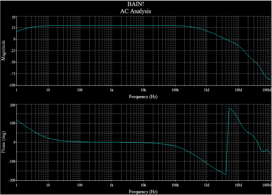

I abominated the abomination and It flys.. 1.2mhz unity gain
stable with no caps (really). All the gain is in the first stage
LPT and cascode (that is why it can do that). here is my
effort...
I added the widler buffer to your VAS CM (better VAS linearity)
and upped the VAS current to 5 mA (balances load to LPT)
It beats mine. but WOW thats alot of trannies.. 😱

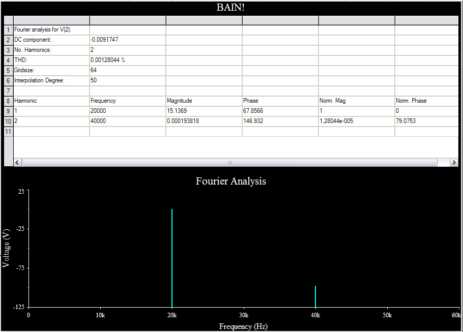

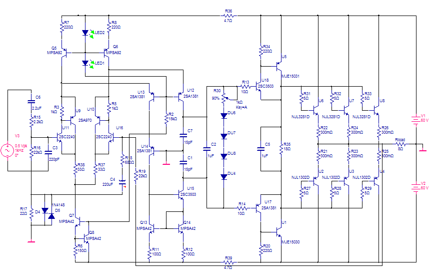

Further tinkering has produced this:
I have changed the devices in the CFP LTP to higher power and increased the current. I have also increased the current slightly through the VAS. This equates to much better simulated performance.
U1 and U5 are really 2SC4793/A1837 but I use the MJE's for simulation.

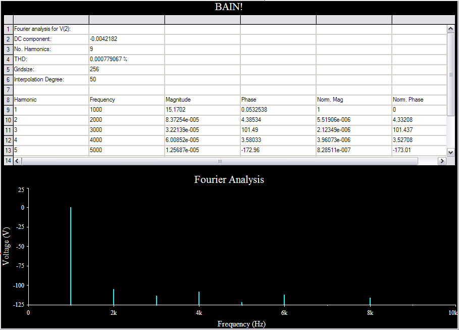

re: Post #71, the higher order harmonic artefacts are now below -125db ... nice real nice 😎
MJL21193, do you know what value the PSRR is?
What do you think of ostrippers variation?
jaycee said:Interesting work with a CFP input stage! Are the 2SA1381's really warranted though?
Hi jaycee,
They are dissipating ~200mW (I figure?) and they are not bad in that position. They have higher gain, high voltage and low Cob. I thought about using the 2SC3503 in place of the 2N5551's, but thought that would be truly overkill.

Hi Stinius,
No changes - the Abomination is in the books. Board layout final and all.
This is an off shoot design, a real difference from the original (RMI). I wanted to try out a few ideas and suggestions. It really doesn't have anything to do with my (fake!) dislike for LED's.
It's to be known as Bain!
KLe said:Wow MJL21193
Hi KLe,
Yes, the increase in front end current has pushed THD even lower. That this is happening while not changing any of the devices used is a good indication that we could expect a similar result in the actual amp.
Also, these were taken at a medium idle current. The thermal track devices are supposed to allow a higher idle without the threat of runaway, meaning even lower high frequency distortion.
