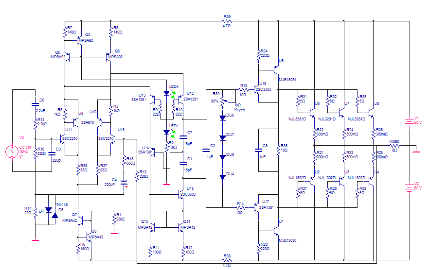

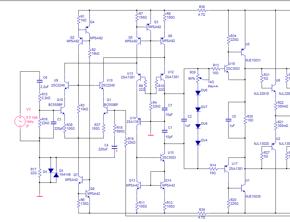

Here - no stinkin' LED's. Still needs work, wanna help? 🙂
MJL21193 said:
Nice. 🙂
It's not a competition, you know.
Missing resistor/diode/LED/something between the Q3, and R4.
Sajti
Sajti
Yes. Hastily put together but I have something just a bit better...
John,
Besides the fact that you have some mistakes in the schematic, the main two issues are related with highly asymmetrical clipping and headroom.
M
ps. Where did you get that input stage? Maybe AKSA?

roender said:John,
M
I put that together in 2 hours, so i expect there will be mistakes.
Hugh suggested the CFP input but "gave" me nothing. I researched it, in particular D. Self's book.
I'm not totally without a clue. 🙂
