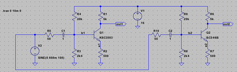

And at 100kHz curves looks almost the same (just rescaled x axis).
After commenting out QCO=... in KSC3503 model, both outputs becomes
almost the same - just at 100kHz BC546 recovers little slower from
saturation, as I expected.
... eeh to much off-topic. I'll post futher about that (if any) on separate thread.
wojtek5001 said:Sorry for off-topic again, but that simple drawing shows what am talking
about.
Yes, the real circuit wouldn't do that - it would only clip on the bottom, not the top. This is something the sim gets wrong (the one I use too).

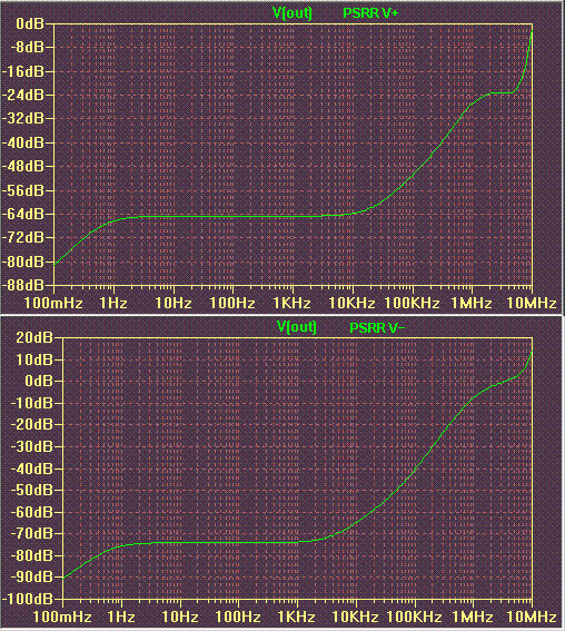

Hi MJL
What is PSRR value of the Abomination and Bain?
Keep up the good work ... that MJL and everybody.
great job!
PS: It would be nice to have Power Regs for these excellent amps ... any ideas in this direction 🙂

KLe said:Hi MJL
Interesting...
PSRR should be better on Bain as it has active CS front end, but the sim shows it otherwise.
First, here is Abomination. I put .3Vrms AC in series withe the power supply, shorted the input to ground. Notice the scale highlighted in yellow. Bottom trace is output from the amp showing the amount of ripple.
Next is Bain. This surprised me because I thought it would be at least as good.
By changing the CS to LED biased improved this significantly, to equal the PSR of the Abomination. I'm curious if this is a real world thing too. I assumed that better PSR could be realized by using an active CS. Is this not the case? Is a LED bias better?

roender said:John,
Negative and positive PSRR for RMI-FC100 without separate and stabilized power supply for input stage.
Now you see why is necessary a good power supply for voltage amplification stage?
Nobody complicate the design for nothing ...
M

John,
You mast be joking if you think that PSRR can be measured with a simple scope!
We talk about ripple rejection in frequency domain

MJ, the PSRR of your amp may in fact be very good, but, you seem to be just measuring residual noise. The scope will work, but you need real-world hash on the supply lines to get a true picture (specan would be nice, bu I don't have one for audio either). A few mv of hum from an unloaded supply isn't doing it. Try connecting two channels to the same supply, driving the crud out of one, the seeing what comes out the other. Lots more 120Hz than you get just sitting with one channel and the input shorted. And harmonics of the signal driving the other channel.

wg_ski said:MJ, the PSRR of your amp may in fact be very good, but...
Hi wg-ski,
I'm trying to put things in perspective. That screen shot above is the actual output from a powered amp. It shows no signal magnitude.
Lets look at the supply ripple:
That's what is coming out of the supply, BUT although the scope is still at it's lowest setting the probe is set to 10X! Significant ripple, no?
This is what the amp is rejecting and not amplifying.
wg_ski said:MJ, the PSRR of your amp may in fact be very good, but, you seem to be just measuring residual noise. The scope will work, but you need real-world hash on the supply lines to get a true picture (specan would be nice, bu I don't have one for audio either). A few mv of hum from an unloaded supply isn't doing it. Try connecting two channels to the same supply, driving the crud out of one, the seeing what comes out the other. Lots more 120Hz than you get just sitting with one channel and the input shorted. And harmonics of the signal driving the other channel.
Or if you are feeling really adventurous you can return the amplifiers power supply to ground via 4 or 8 ohm resistive dummy load, and drive this resistor to, say, 10 peak, with another audio power amplifier driven from a signal generator. Sweep 10Hz-100kHz.
