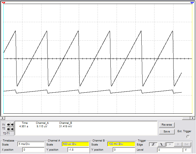

Here's how the sim shows it with a "real" power supply. Notice the magnitude of the ripple on the output as opposed to that from the supply.
MJL21193 said:
That sounds like a worthwhile thing to do.![]()
Well of course the PSRR is high at such a low frequency, genius.

MJL21193 said:
That's what is coming out of the supply, BUT although the scope is still at it's lowest setting the probe is set to 10X! Significant ripple, no?
This is what the amp is rejecting and not amplifying.

Ok, now I get it. Yes, I feel embarrassed - slightly. I'll recover . 🙂
I did as wg-ski instructed:
I connected another amp to the same supply (OS' Frugal2) and drove it with my signal generator. It was connected to the 8 ohm dummy load. I drove this amp to clipping at different frequencies.
The amp being tested (Abomination) was connected to the scope and a fullrange 8 ohm speaker. Even though the scope did show some ripple, especially at higher frequencies, there wasn't enough to be audible through that speaker. Not depending on my hearing, I asked my 18 year old son to have a listen - nothing. To be sure I switched to a square wave and then and only then could he hear a very faint buzz from the speaker.
Oh well, it must be below the noise floor, and apparently I have a good design AND layout. 🙂

Hi KLe,
The sim may show some DC on the output (it does: -3.5V) but that can't be relied on. Real measurements are needed and to justify extra DC offset, it would need to "sound" better, so some critical listening would be in order.

Hi Kle,
I will look at it more closely. The sim suggests a reduction in THD, though I don't know if it specific to the third.
I think (think) the large offset is the result of the "constant power" cascode (going to the tail of the LTP) but I'm not sure. I can play around some more to see if I can get some concrete answers.
