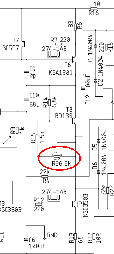

Hey Prasi . Before switching the boards on the first time , on your layout , am I correct in thinking that trimpot screw must be turned all the way counter-clockwise for minimum bias setting ?
Quiescent current can be set to 80mA (measured over fuse holder with fuse removed) , or 20mA over 1e emitter resistor ?
I suggest using an ohmmeter to measure the resistance between pin1 and pin3 of the R36 trimmer potentiometer, after it has been stuffed and soldered to the PCB. Whichever setting gives the LARGEST resistance from pin1 to pin3, is the safest (lowest bias) starting point for bias adjustment. Measure it twice and reverse the probes for measurement #2. Patiently wait 30 seconds to allow the reading to settle.

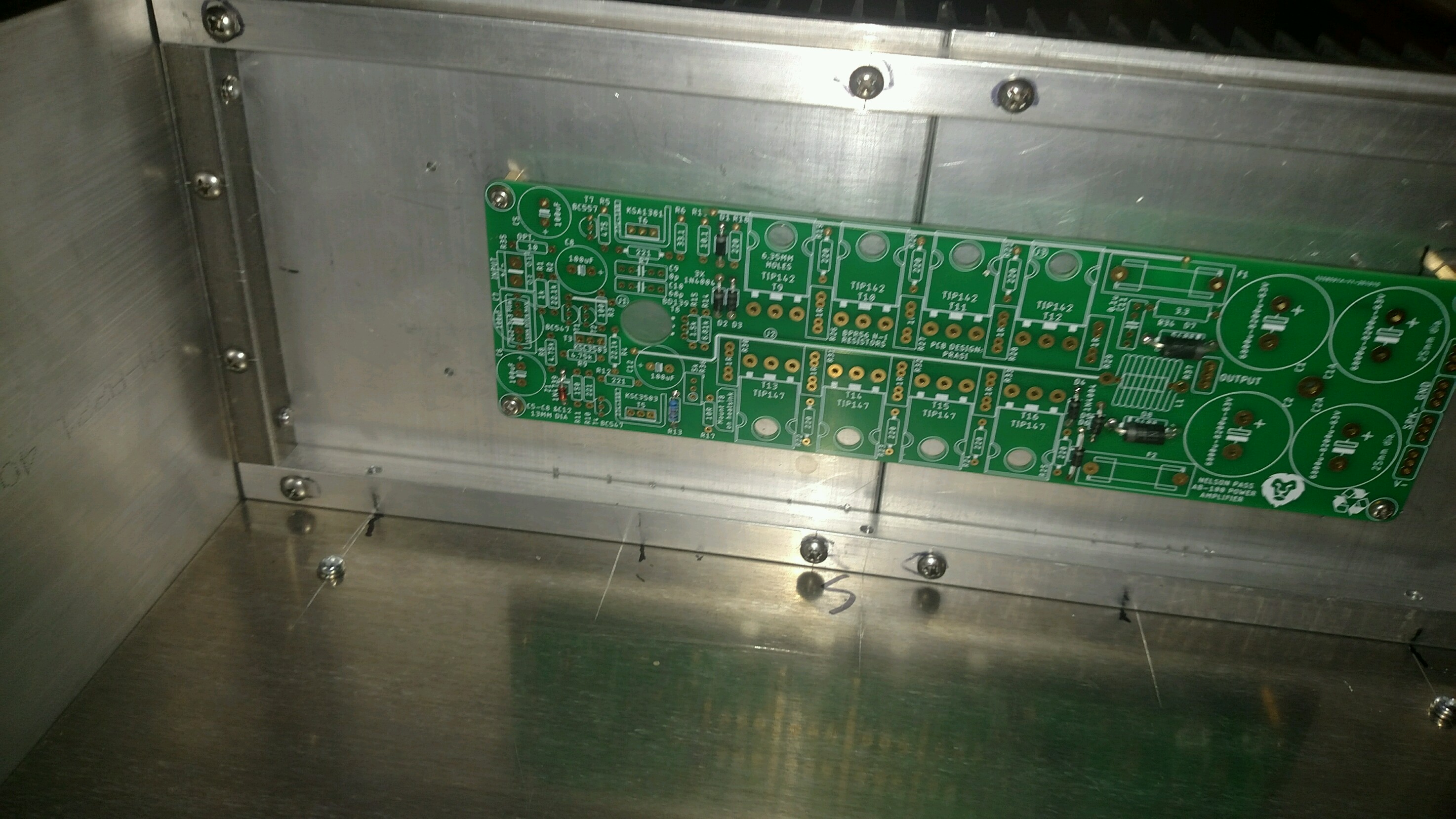

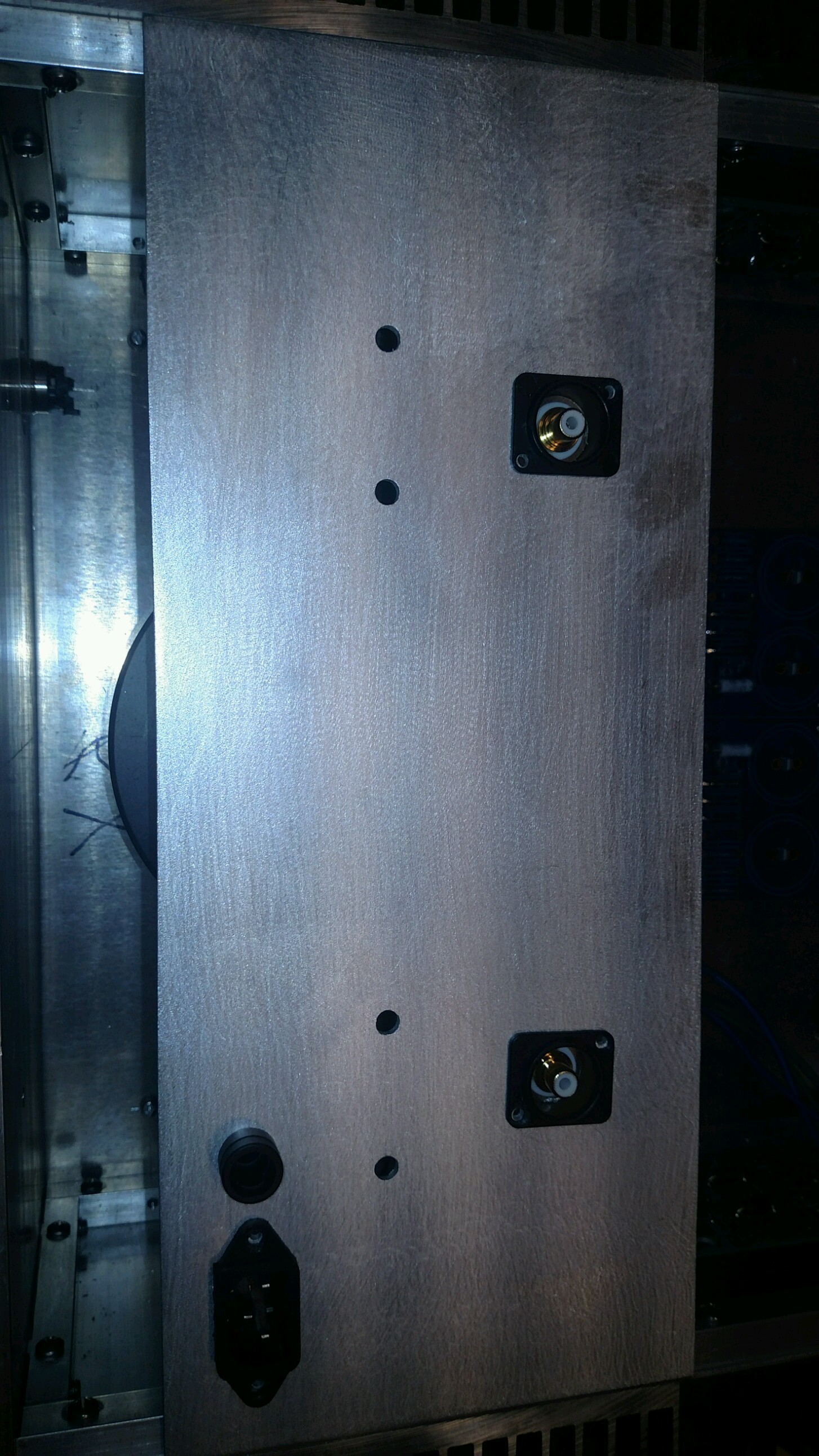

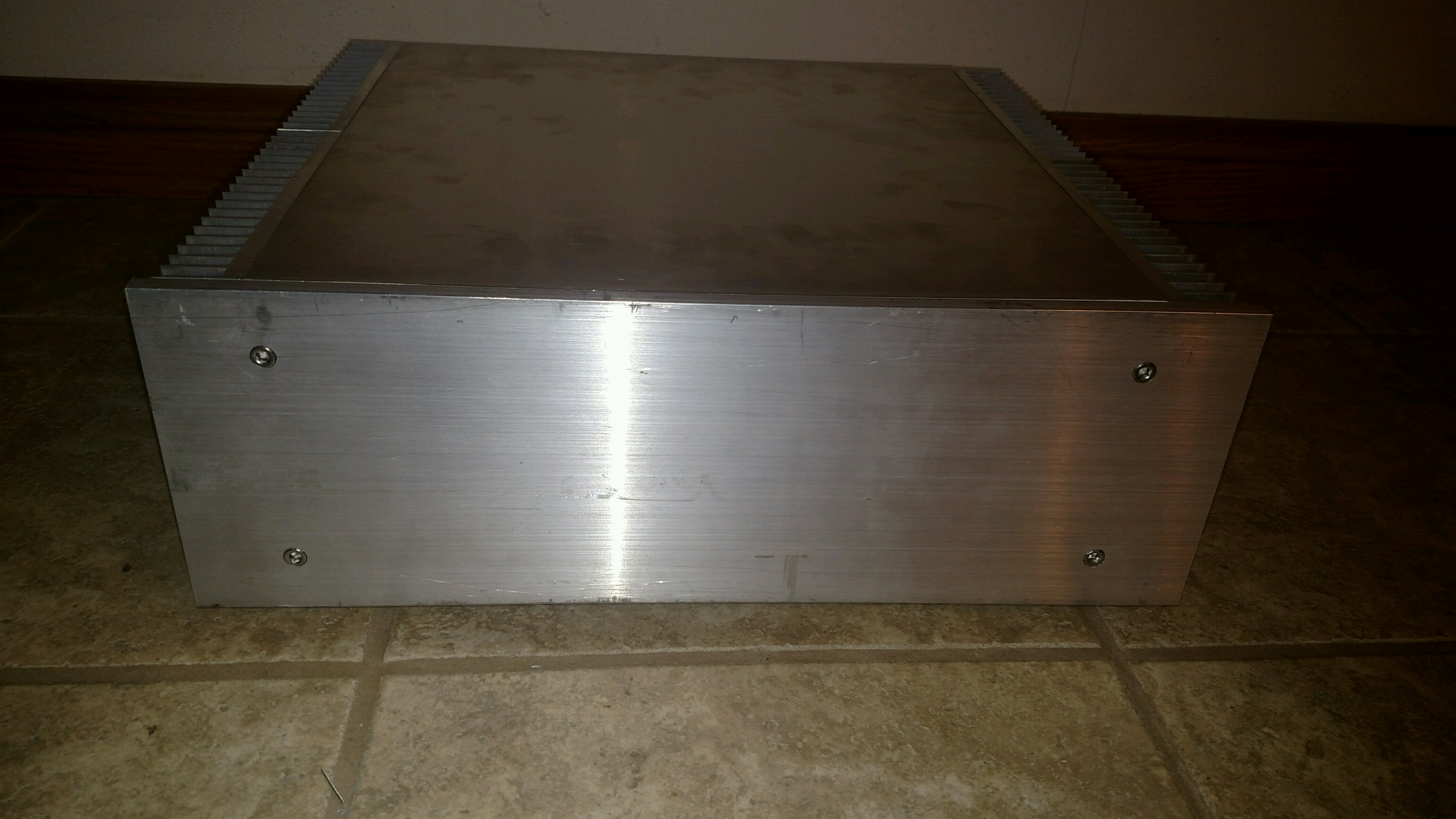

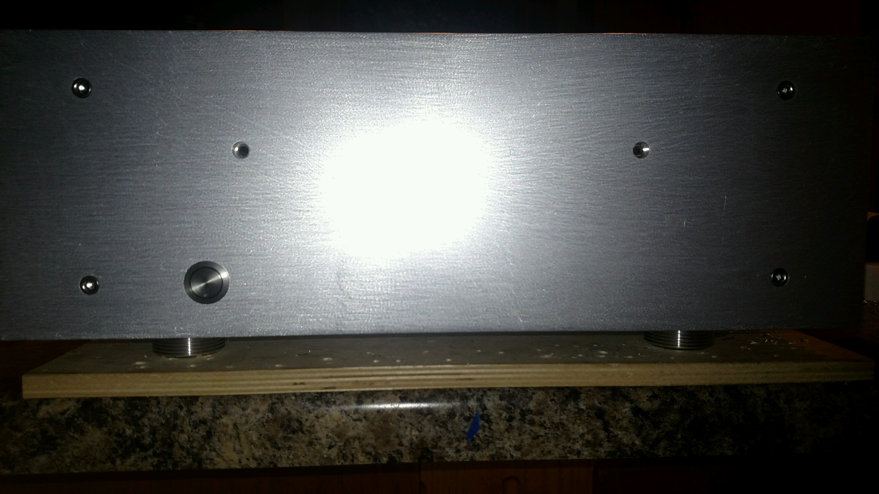

progress
Managed to gain a little ground.
Got my boards mounted to the heatsinks and the front face mounted as well.
At last count that leaves 22 more holes to drill and tap.
Slow work takes time.

Looking amazing flamethrower1 . Well done !
