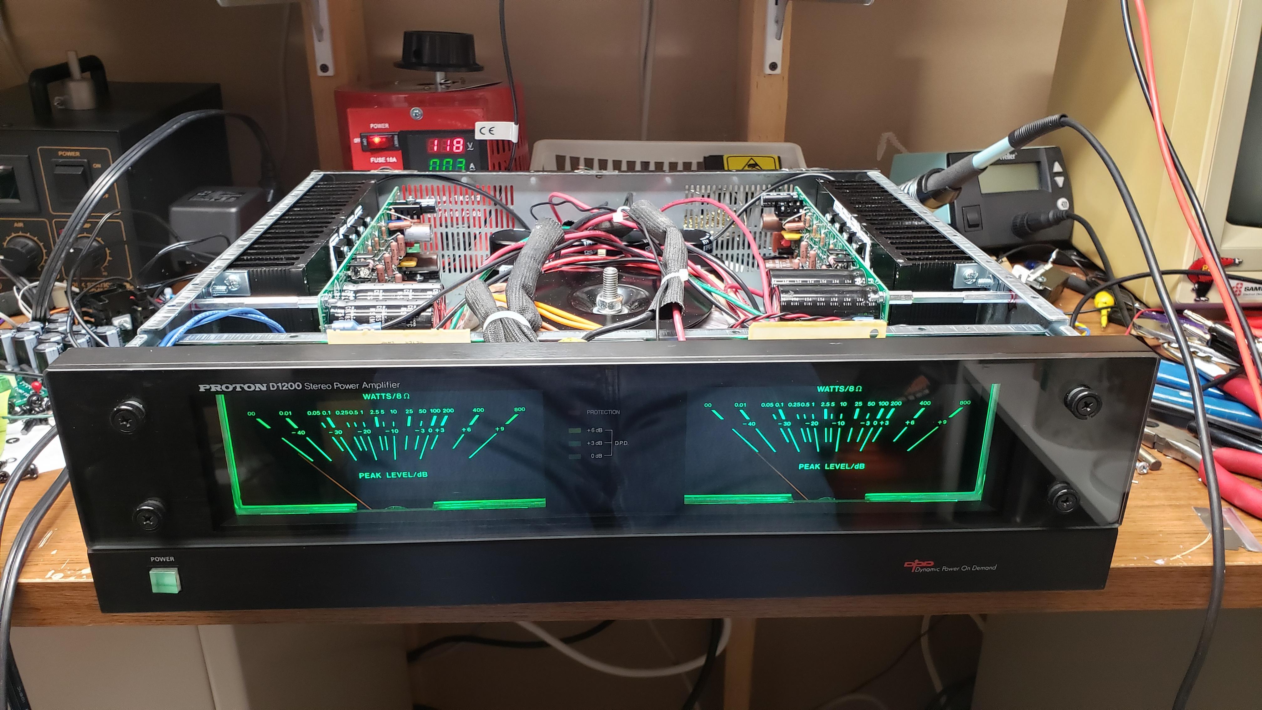

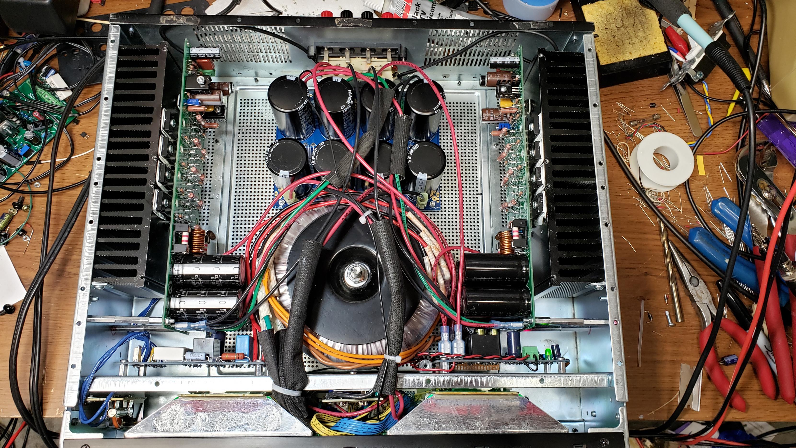

Finally got around to building this amp. I had a Proton D1200 that self destructed so I gutted it and installed the AB100 boards instead. I cut the meter driver portion off the old circuit board and made a small power supply to drive those. It sounds great, but not nearly as authoritative as the original.

I'm running +-50VDC rails and haven't measured temps because it doesn't get hot enough to be concerned with music.Nice build.
What are you running your rails at and what kind of temps are you seeing?
