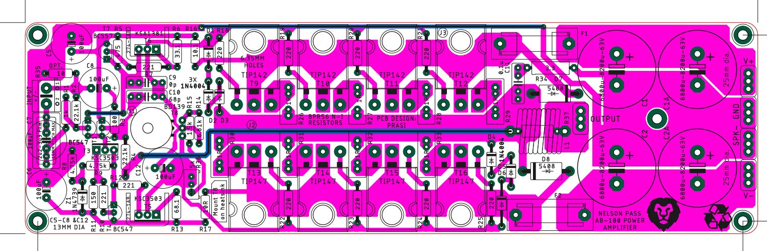

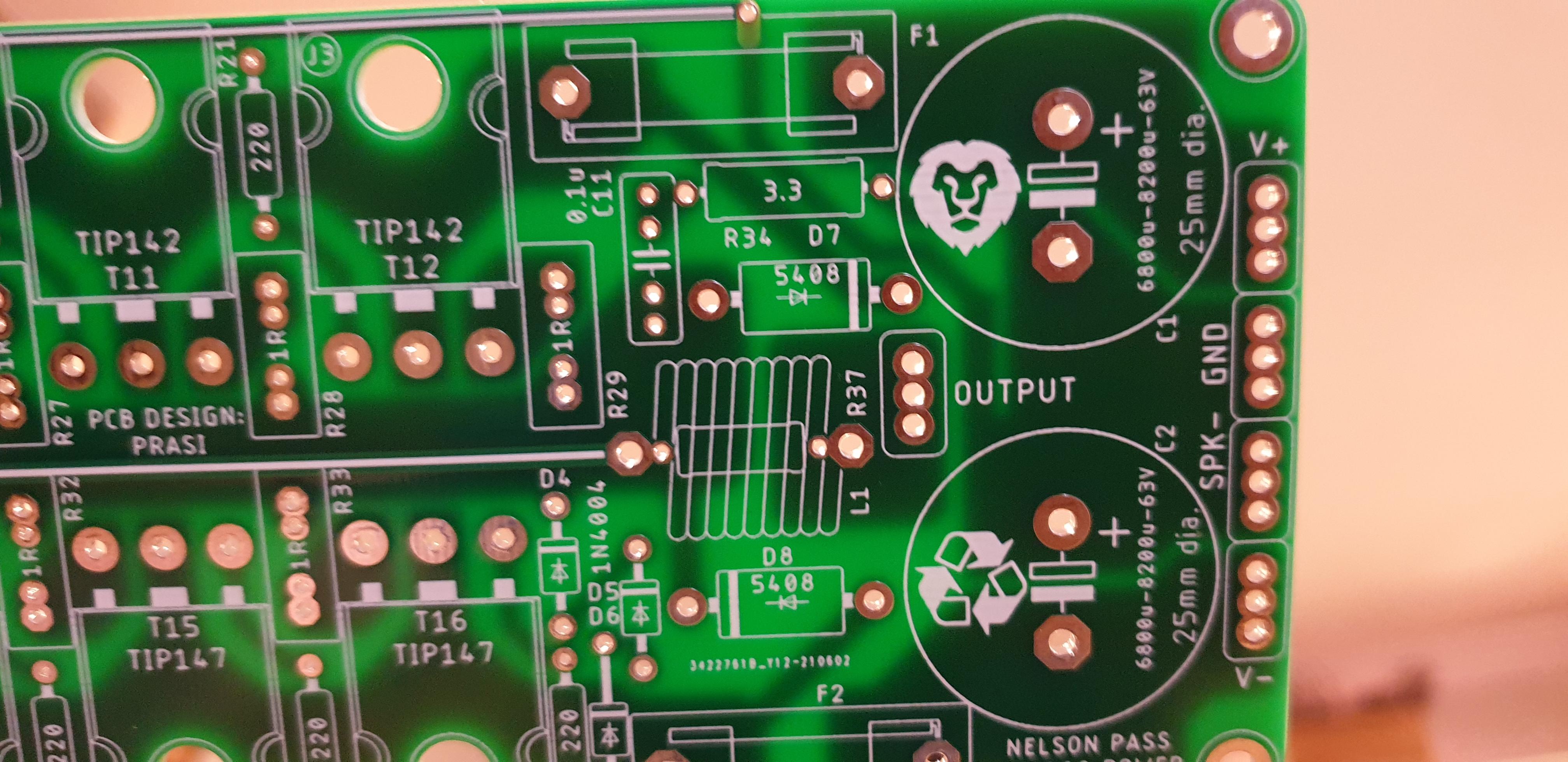

I've read the majority of the thread so apologies if I missed it. I have taken delivery of Prasis AB100 layout.
If I am reading the schematic and board right then R16 10.1 is linked to F1 via jumper wire J3. Thick white line along the top edge.
Looking at my board J3 doesn't go to F1 but to GND.
Do I need to do a little modification?
The stuffing guide image i have been referring to is the same as my PCB.
I'm sure this is my inexperience and not an error!
