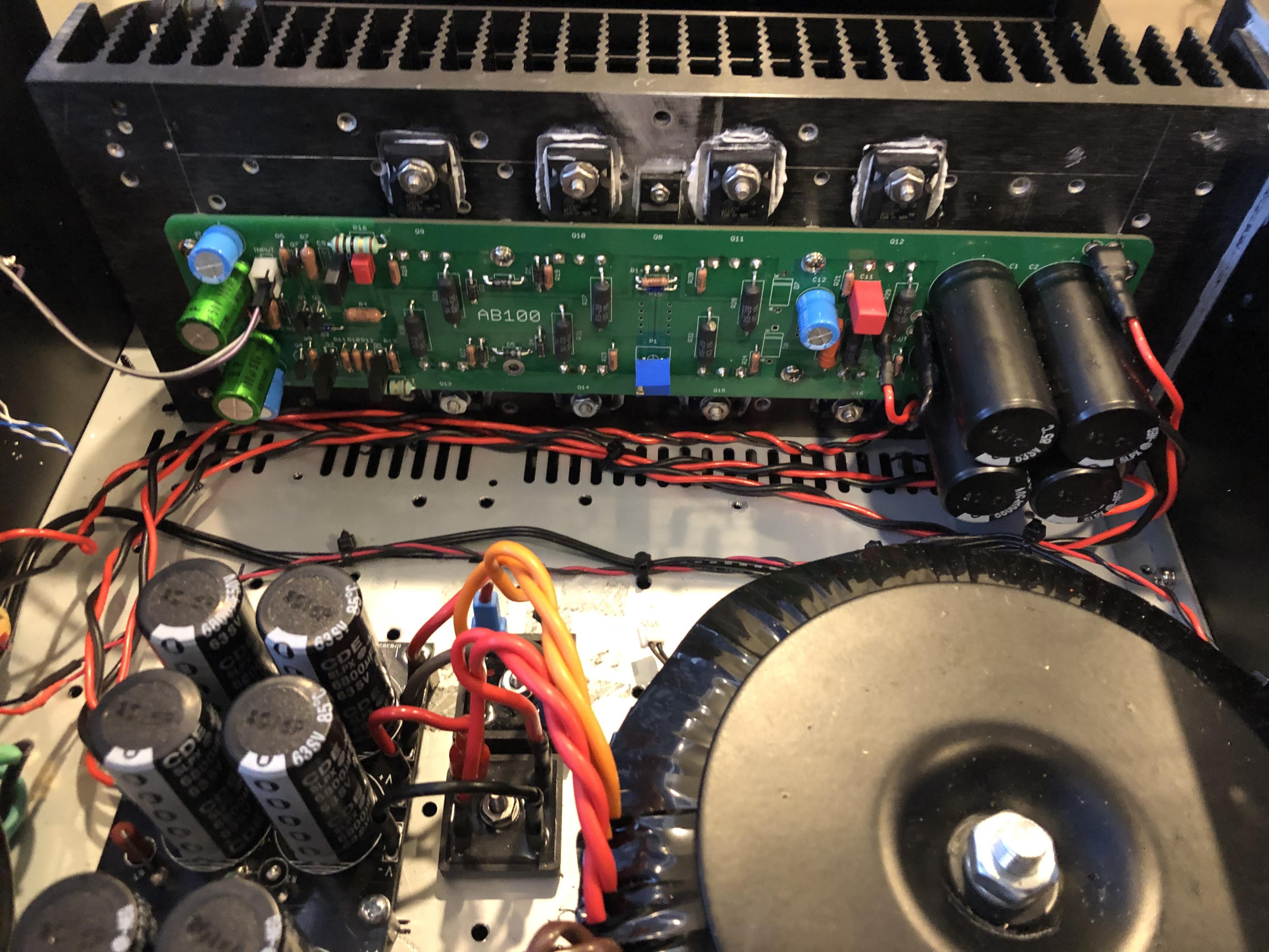

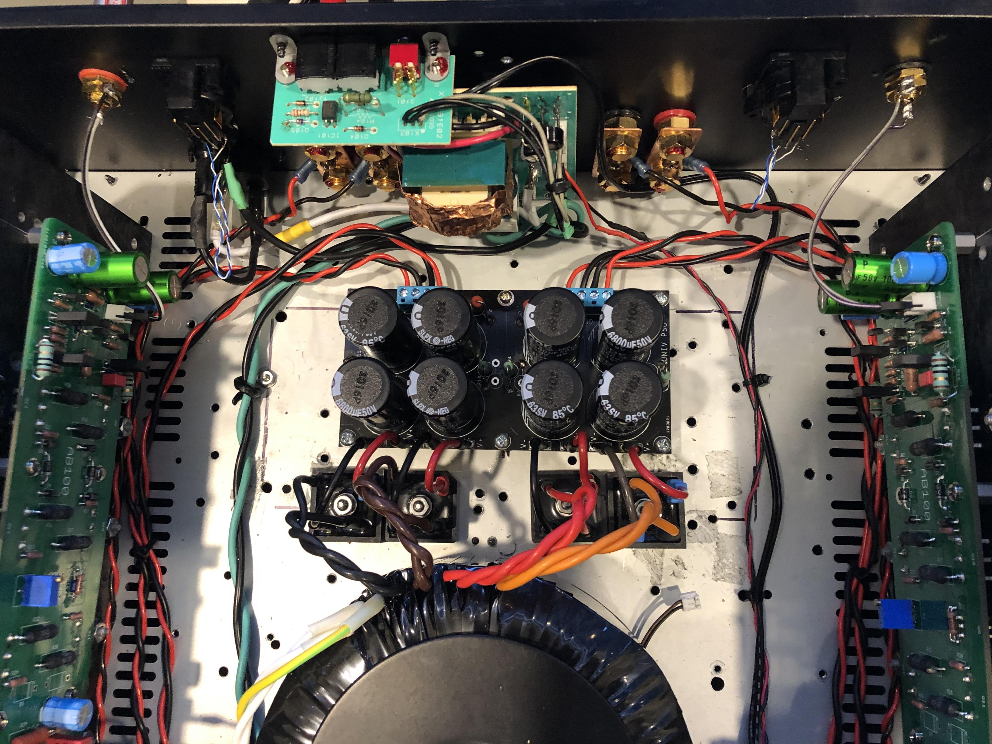

I just finished my AB100 in an old Rotel case, with boards from Alexcp.
Rails at +/-51V and 27000Uf capacitance per rail. I am worried about those caps are rated 50V. Offset 10mV one channel and about 20mV the other one.
The heatsinks are full of holes because I built 3 amps in that case, F5, F6, and F7, and now AB100
With bias at 20ma per transistor and Re 1 ohms the heatsinks are cold.
I want to improve this amp by changing the emitter resistors and adjust the bias for lowest possible distortion. D. Self mentioned to use 0.1 ohms resistors. Did anyone use 0.1R emitter resistors?

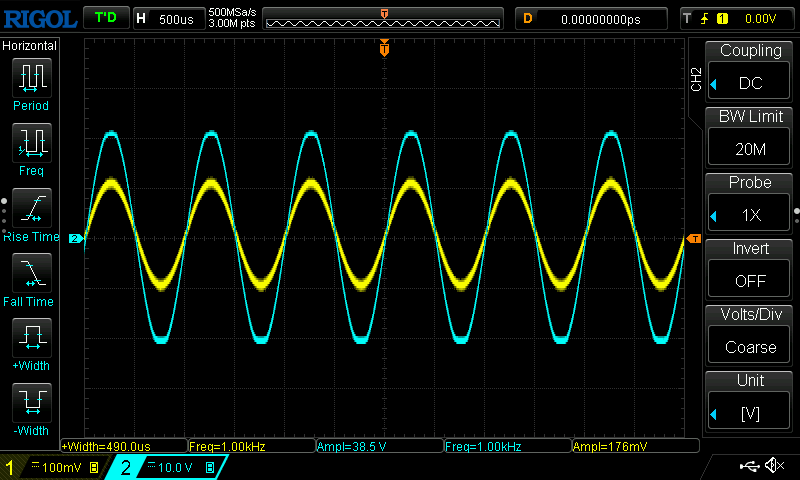

Gain Question
Hi Guys,
Finally managed to put my boards together, and mounted on a heatsink for some intial testing, and I noticed something weird.
I was feeding the amp a 1kHz sine wave at about .1V and was getting about 20V at the output on the scope.
That would seem to me the gain is somewhere at 200 and I though it was supposed to be in the order of 20.
I have about 2.5-3 amps as per rail current going but nothing changes even if I turn down the resistor all the way so the current is like .1 amps, still getting about 20V output.
Any thoughts, since its an order of 10 off I was thinking maybe somewhere I have a part wrong, but short of checking them all anybody have any ideas?
What parts exactly control the gain factor?
Will post some pics of the scope traces and the board later.
Thanks all

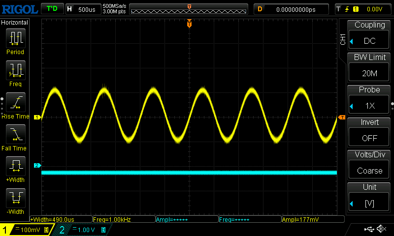

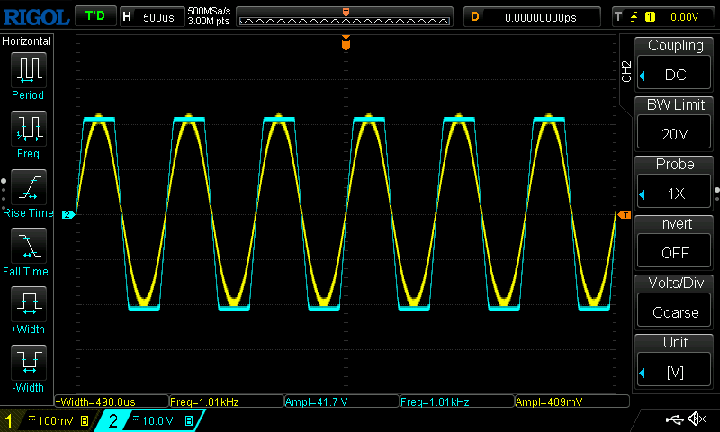

Hi All,
So much thanks for the quick replies,
so it looks like R3 & R4 are correct, I did notice that R14 is only 3.5k instead of 6.8k, think this could be the problem?
Also here are the scope traces
