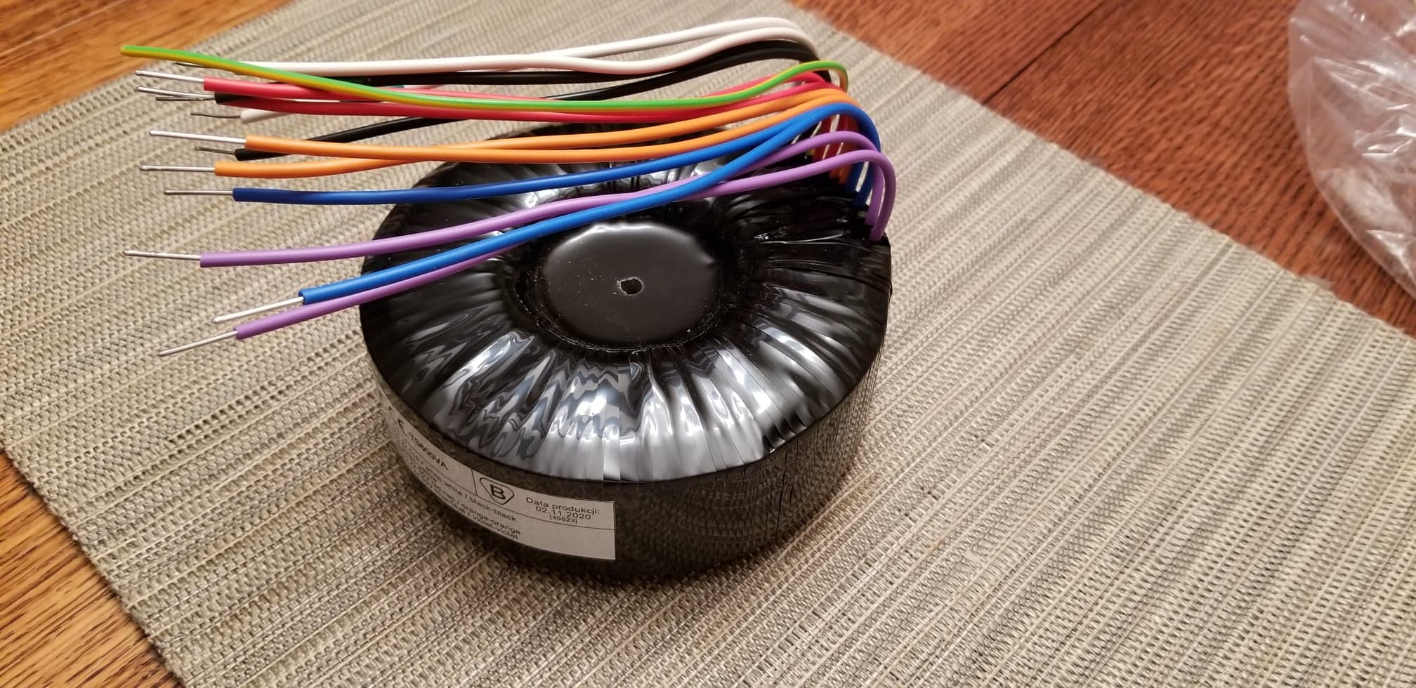

this transformer has 2 of 2x35V?This is a strange thing to say, but this is a really nice looking transformer!
How much was this shipped to you?

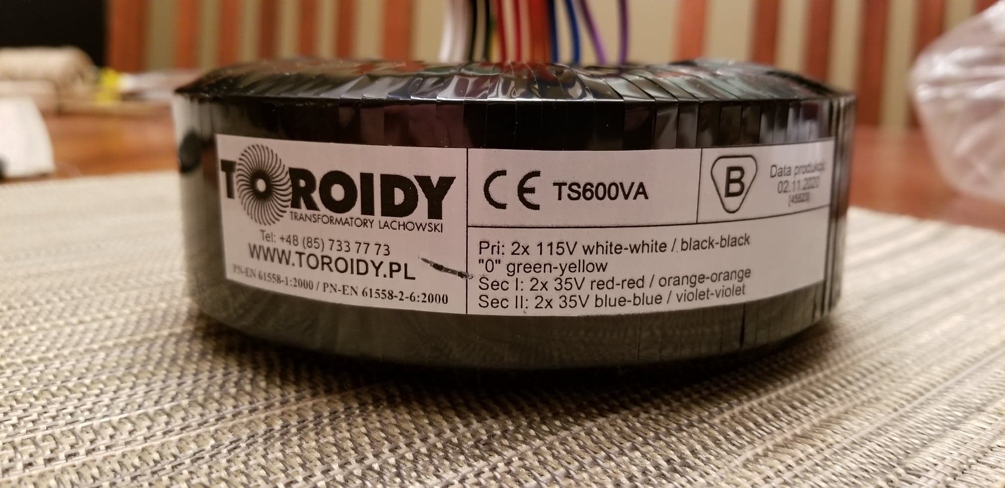

Audio grade transformers:
TS 600VA PRI: 2x115V SEC: 4x 35V (4,28A) - cost: 92,10 EUR/pc (0% VAT export price).
Our offer is valid for the 30 days.
In audio grade, noiseless transformer price You'll get transformer winded with with the largest possible inductance.
Core will be measured and selected, nominal induction will be lowered for the leakage flux minimalization
For a best noise reduction core and all the windings are impregnated.
Transformer will also has electric and electromagnetic shields and epoxy filled interior.
Shipping cost to Canada - 52,00 EUR.
About $220 CDN or $170 USD, not cheap, but not totally unreasonable either.

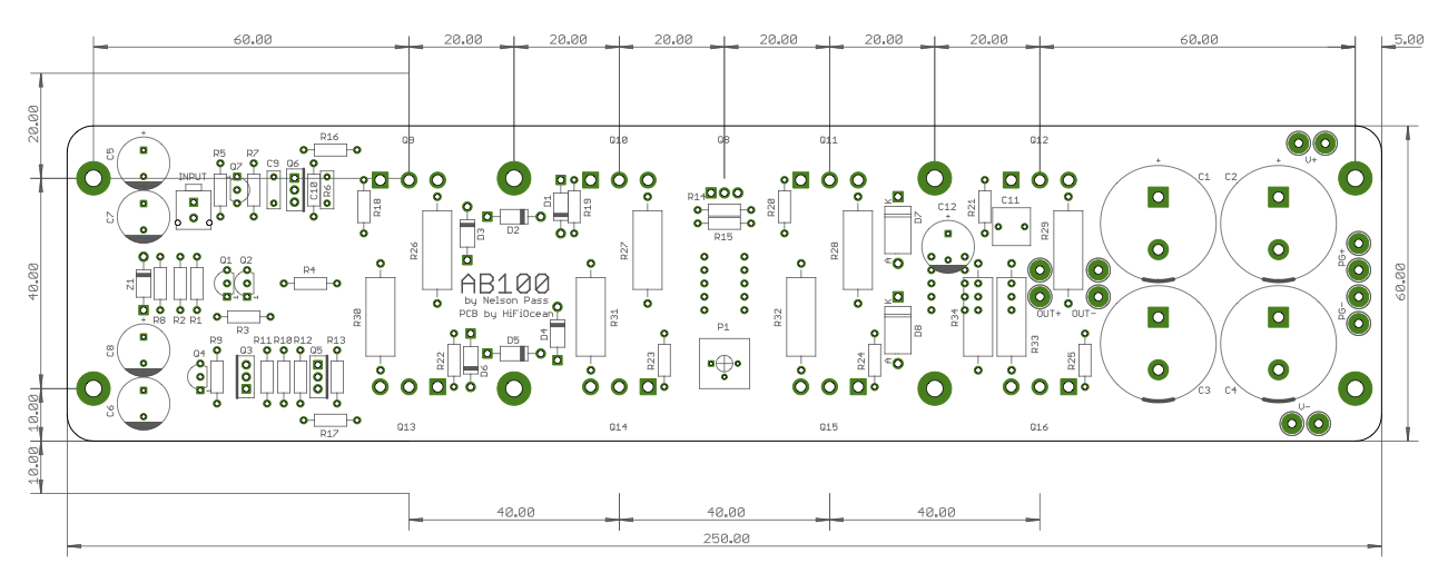

Gerbers for another AB100 PCB
Attached is the set of gerbers for my version of AB100 boards.
The layout quite closely follows that of Nelson Pass (post #463), I just added mounting holes conforming to the diyAudioStore's Universal Mounting Specification. One would need a heatsink about 100mm tall (wide) to be able to mount the output transistors on both sides of the PCB.
These boards have been built and tested - see post #1020 above for the picture of assembled board of a heatsink. They work as intended, and BTW, I still have a pair of extra boards left.
Thank you Mr. Pass for publishing both the schematic and the PCB - there are neat tricks I learned from both! Happy New Year!

Nice board Layout Alex, Ever thought about doing some SMD verions ? Could make the board smaller ? Melf 0204 and Melf 0207 Etc etc.. Dual layer, thicker copper pours..
Thank you.
SMT is certainly possible - I have done this for other amplifiers - but to make AB100 much more compact there would need to be changes in the layout of the output stage. I wanted to keep the board compatible with the pre-drilled heatsinks from diyAudioStore, but if you throw that out, many interesting things can be done.
In the new year, perhaps
I will try to create a version, that is wider and not so long. Want to make two monoblocks with this design and it would be better, if i can use heatsinks on both sides. Only 4 transistors on each heatsink. Hope i find the time in the next weeks...
