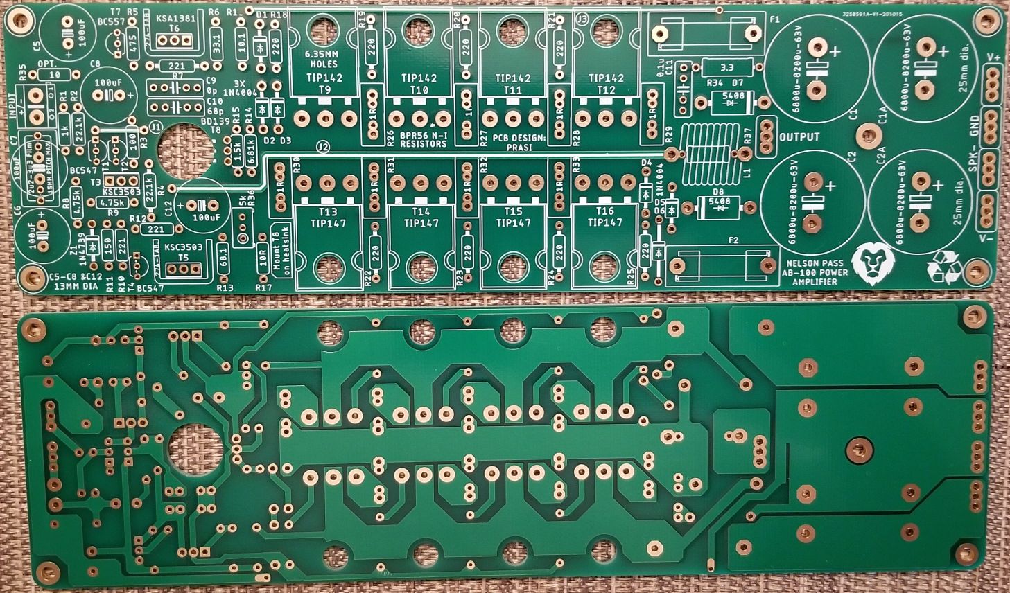

Here is another version, with less expensive parts.
Any feedback would be appreciated.

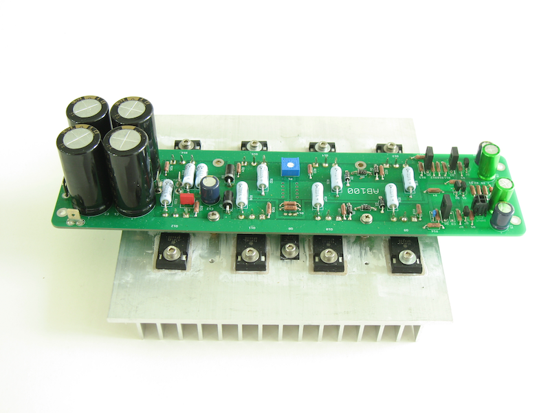

Small questions
How much heatsink does this amp needs?
How about power supply 50/0/50Vdc ?

+ -50V DC is also mentioned in the original NP mini article.So this is exactly what is needed for this amp. Higher voltage will not work without changes in the circuit - lower voltages will work.
Heat sinks should be quite large if there is a + - 50 VDC power supply ..... As with any serious 100W-120W (8 ohms) or 200W (4 ohms) AB class amplifier.

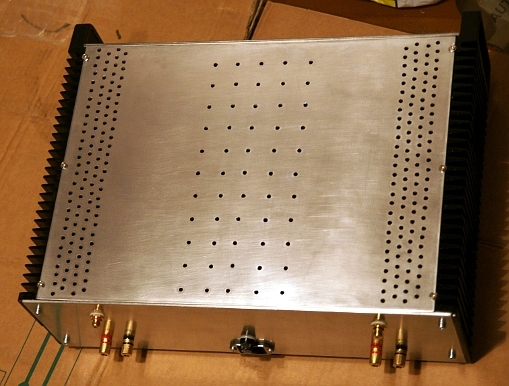

Now for the heatsink I have seen a few pictures here from members that build it and it ranges from small (osscar) to Class A size from another builder (Vrystaat)

I would not call my heat sinks small - they have a thick base and the overall size is large. They have never even been really warm (only when I put in a 100Khz full signal square wave accidentally 😀)
White one running at 38 V and black one at 43 V
