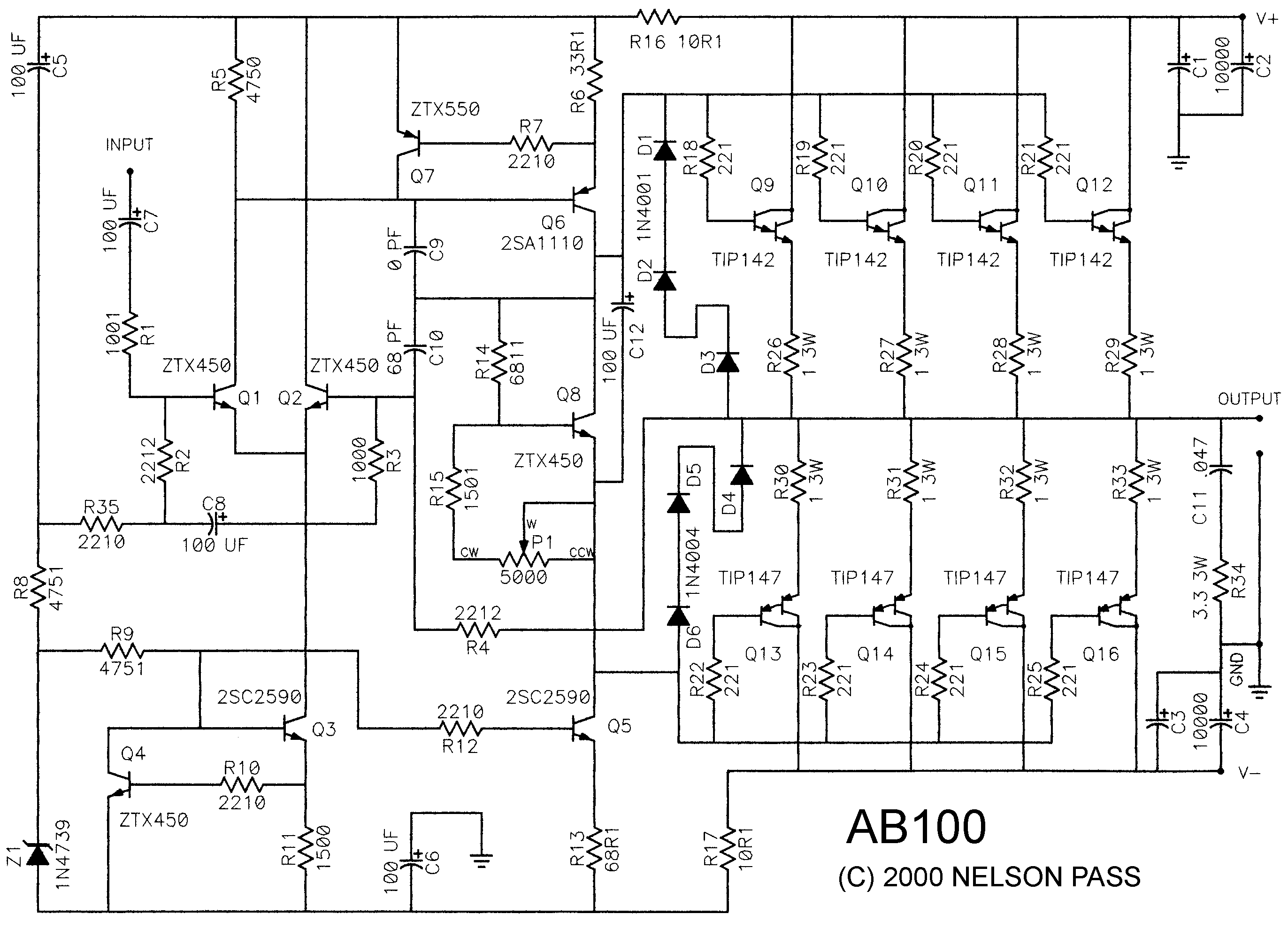

Correct schematic for Prasi pcb
Well shucks, looks like I get to try my unwelding techniques, glad they are somewhat isolated
Hey @flamethrower1 , here is the last schematic from Prasi , that should be used with his boards . It has the R3 correction of his previous schematic @ the correct 1k , not 100e .
Post 11234 of this thread : AB100 Class AB Power Amplifier
Values are correct for all Prasi boards . The schematic just indicates 2x big caps per rail compared to the 1x cap per rail version

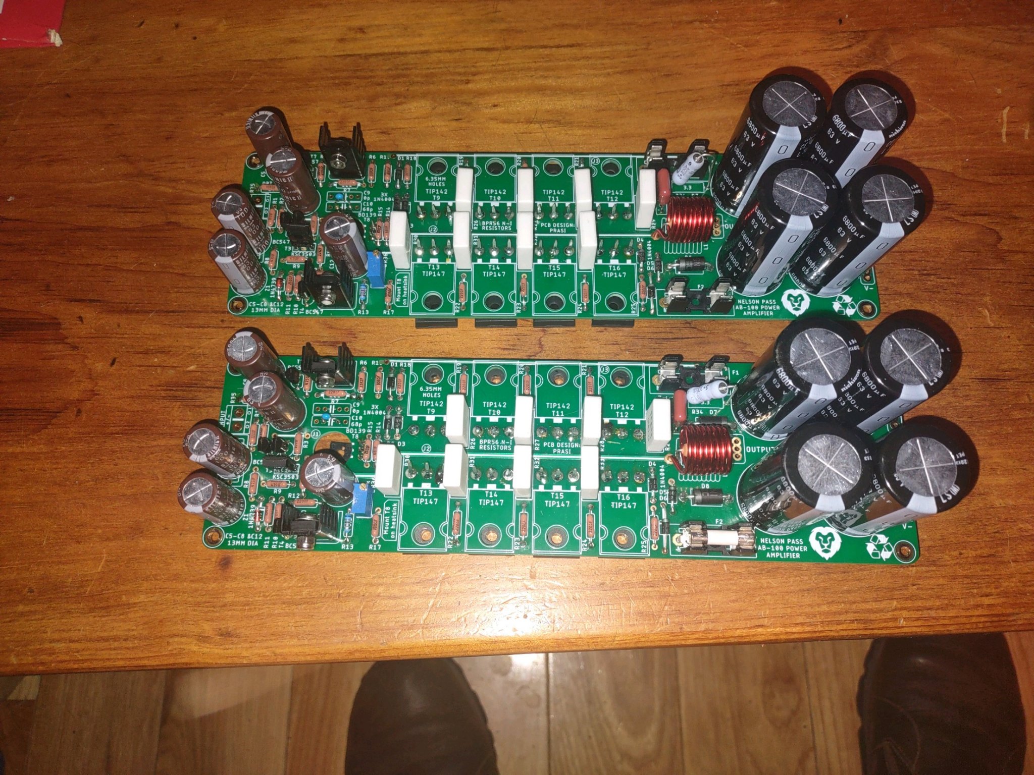

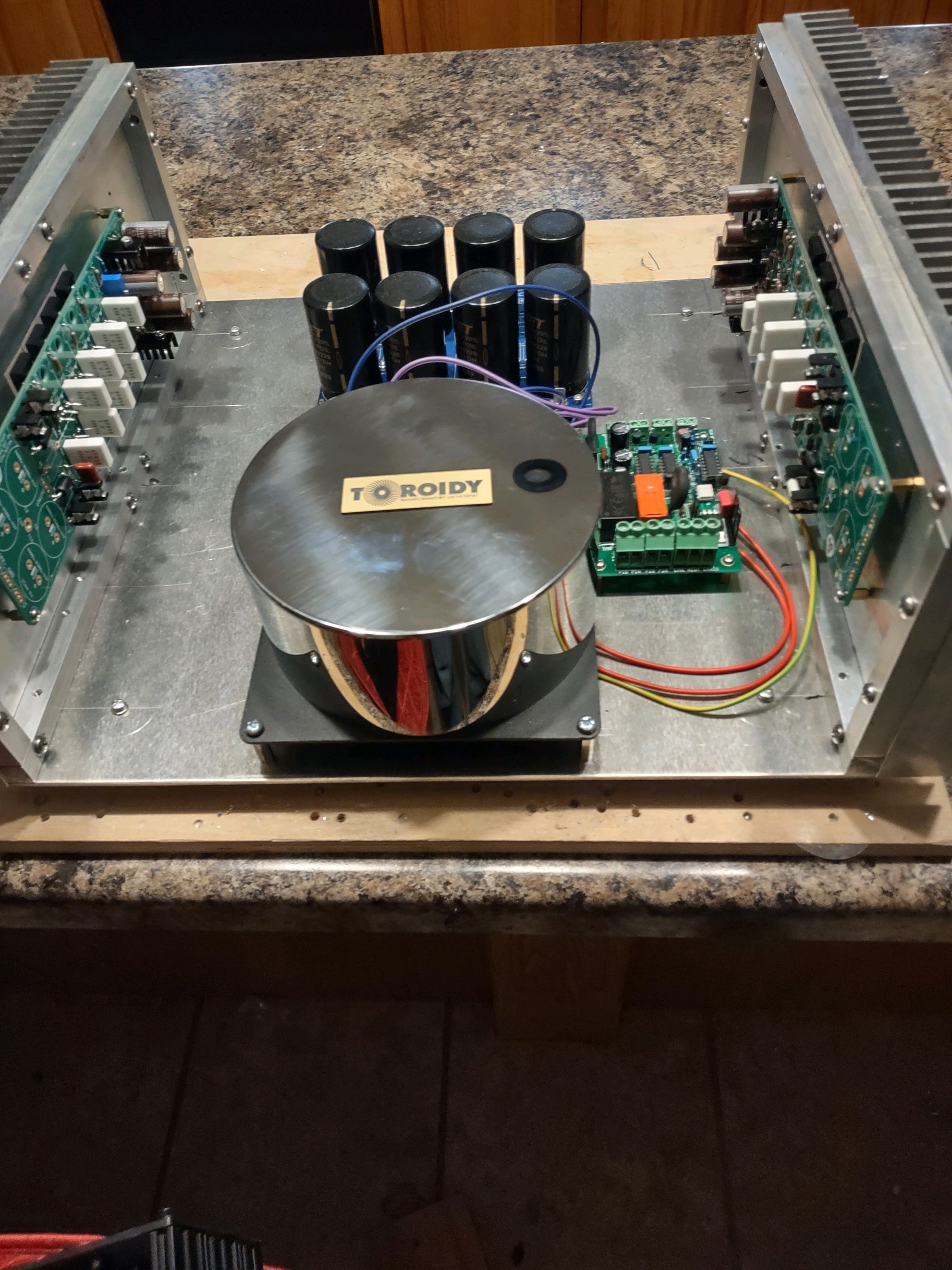

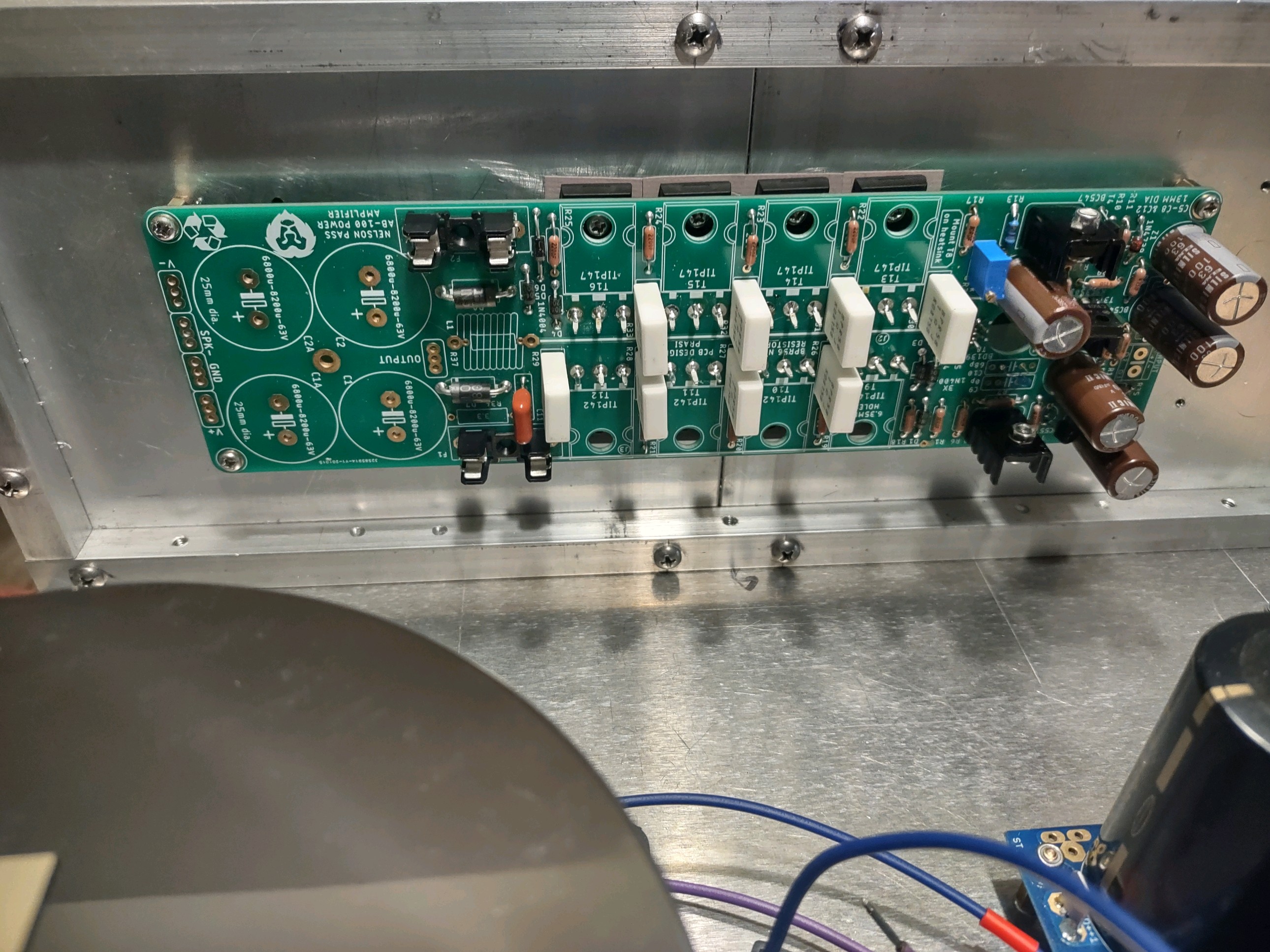

Well, since I had to order another resistor, I did not totally finish my boards.
They are however close enough to take the chassis apart cut some ventilation holes and get this out to be anodized.
This project involved a butt load of soldering, good practice anyway.
