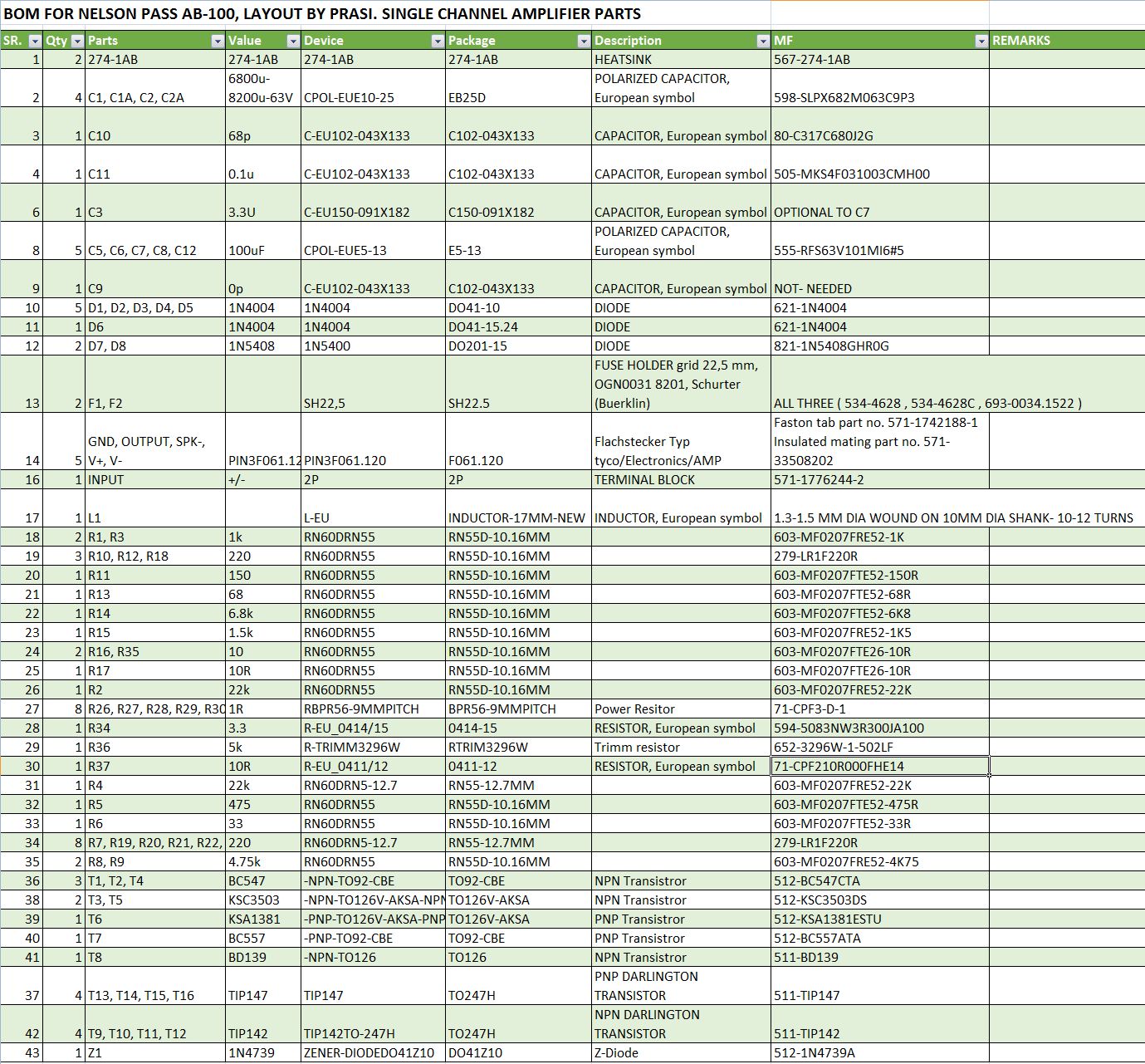

Am I the only one who missed that Prasi posted a full BOM in message 1121?
Link to Prasi AB100 BOM
Almost everything is in stock at Mouser right now, just not one 2 watt resistor and the TIP142/147.
