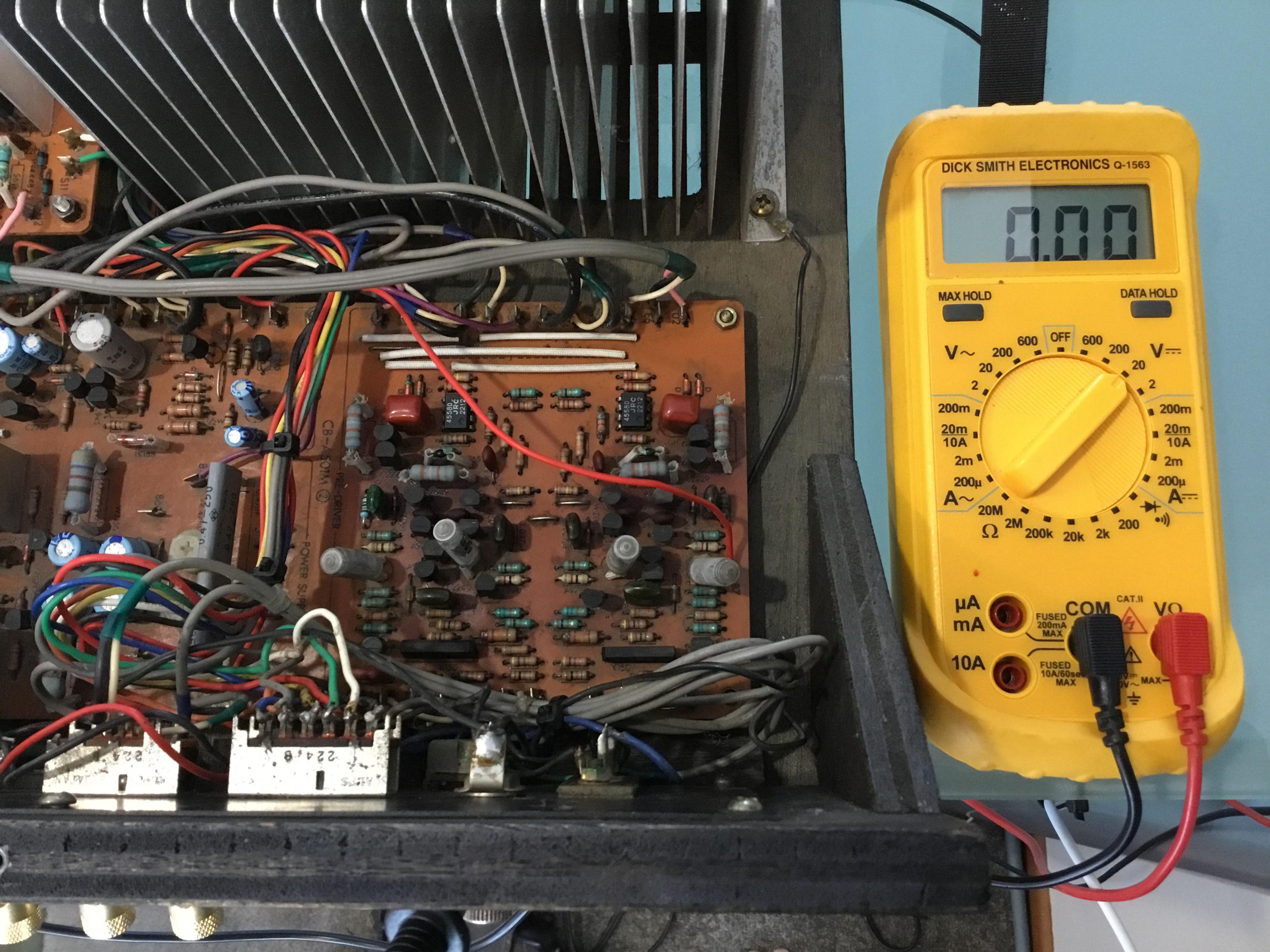

I used the CONTINUITY setting on my multimeter to test between the 02 LEG-8s. One test-pin connected to each LEG-8. Continuity tone sounded each time. Never failed. Hard to imagine that I might have done this wrongly.
I figured that this was a correct reading because the schematic shows a clear line of connection between these two LEGS. Your comment about LEG-8s should read the same prompted me to recheck all of the LEG measurements.
So, I rechecked the LEG-8 measurements (VDC) again and you are correct. They are both around 14.84, but not stable at all. The values slowly tumble around.
(It seems I recorded the figures wrongly last time. That NEGATIVE symbol in front of the measurement was a mistake. Apologies.)
With my error in mind, I re-checked all measurements again, with the amp powered-up - se photo attached for VDC range - as follows: -

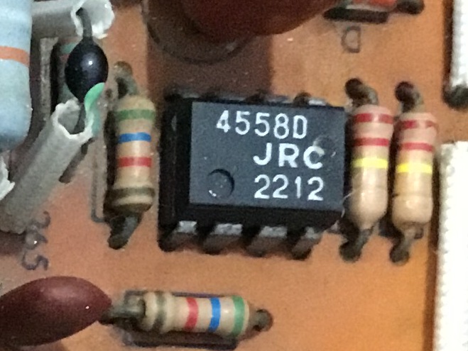

I have cast around looking for replacement parts for my suspect 4558D JRC 2212 OPAMP. (See photo...)
The nearest similar part that I could find on offer (globally) is called 4558D JRC 6044B - so perhaps not identical. Would this part work as a drop-in replacement for my suspect OPAMP? (See attached Datasheet...) If so, these would have to be shipped from the US so up to a 1-month wait here in NZ... 🙁
Alternatively, a local supplier has a supply of 4558D JRC 0079T that I could get my hands-on in a week's time. Would this part work as a drop-in replacement for my suspect OPAMP? 🙂
Alternatively, another local supplier provides a "generic" range of 8-leg OPAMPS that appear to be similar. They are called the NATIONAL SEMICONDUCTOR LM741 "family" and have a few variations including LM741, LM741A and LM741C. The variations within the family appear to relate to just SUPPLY VOLTAGE and OPERATIONAL TEMPERATURE RANGE specs. (See datasheet attached) Would this part work as a drop-in replacement for my suspect OPAMP? If these could work fine, I could grab a couple of these parts today, for a weekend swap-out project! 😀
Can I be guided by you guys on this one please? Appreciated.

4558D JRC 0079T will do the job just fine.
But LM741 is a single opamp, so it is not your replacement, 4558 is a dual opamp.
I understand that you are worried about wiring, but that is part of the job, be gentle and you'll have everything in order when you turn around board.
I don't understand what is your place, because parts you mentioned are from mid 80's of the previous century. Also, who suggested LM741 is not expert in electronics, so beware of his opinion.
If you have unstable power supply of the opamp (pins 4 & 8), you have clear sign of poor filtering, or another language speaking your capacitors are probably bad.

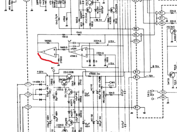

Grounding pin 7 artificially pulls the servo output to zero volts which would allow the main amplifier to work conventionally.

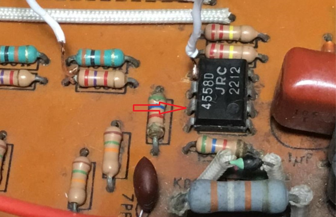

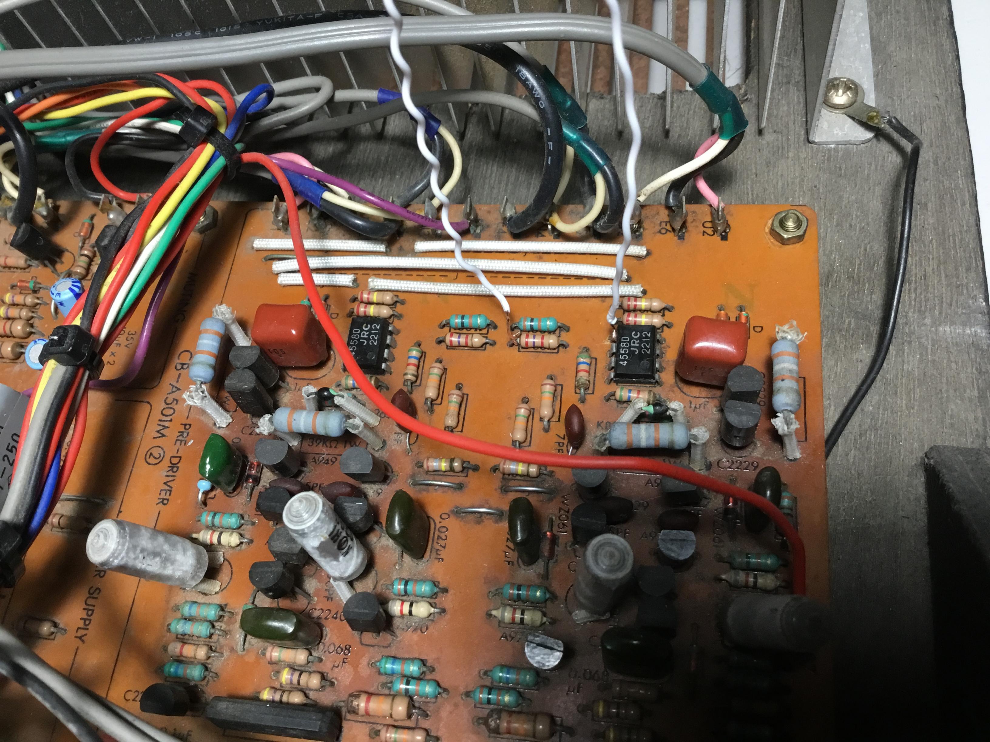

I managed to find the resistor associated with LEG-5, using the CONTINUITY mode, as you described.
I attached a thin (white) wire to LEG-5 and to the other end of the Resistor knowing that this would leave the Resistor involved, as you prescribed.
(See Photo...)
I tried to power-up but the Protection Circuit still locked me out. No progress there.
I'm not sure what I have just proven, if anything...

Did I grab the wrong leg?
Sorry MOOLY, I think I grabbed the wrong leg.
Tomorrow, I’ll move the wire to LEG-7 and try the test again.
That may change the outcome.
I’ll report the results.

Does pin 7 of the opamp now read dead short to ground (with the amp off)? That is what we want.
Pin 5 doesn't go to ground directly, its the other end of the resistor connected to pin 5 that does.
Also measure the DC offset at the main amplifier output in this new condition.
That board looks very crusty around the IC. If the amp performs OK with the shorting link then it might be worth giving the opamp and its pins a scrub with iso (alcohol), particularly on the pins 1 to 4 side. Don't be afraid of wetting the board and components with iso.
The input to the servo is high impedance and so easily affected by unwanted conductivity. The IC is still the last suspect in all this... yes it might be faulty but I certainly wouldn't bet on.
My thinking was: that opam is easily available in electronic spare parts store and to me your location written in the sign confuses me. My thoughts were that in Auckland New Zeland there must be many such stores, or there is something wrong with my perception.

Some more quick measurements...
MOOLY
I can see that I did attach my thin white wire to the wrong leg.
While in this condition - before I change the wire to LEG-7 - I have provided some more measurements, as you have requested.
P1 (LEFT): .1 VDC (Perfect!)
P2 (RIGHT): 6.8VDC 🙁
MOOLY
There appears to be no CONTINUITY on my multimeter between LEG-7 and Chassis Ground.Does pin 7 of the opamp now read dead short to ground (with the amp off)? That is what we want.
Yes. I understand that. That is why I connected the Resistor on the far side, so that the Resistor still stays involved in this little work-around.Pin 5 doesn't go to ground directly, its the other end of the resistor connected to pin 5 that does.
Checking DC OFFSET with the amp power ON: -Also measure the DC offset at the main amplifier output in this new condition.
