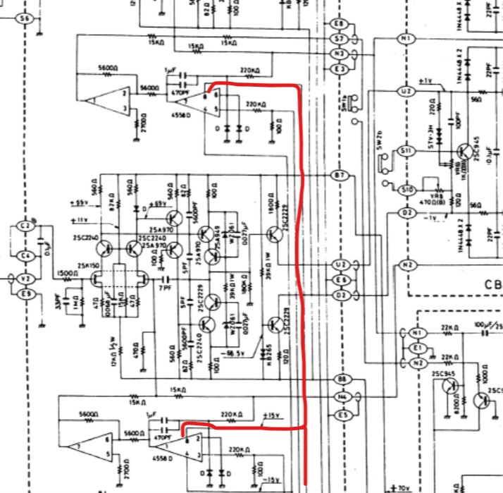

Positive rail appears missing on pin 8. It should be plus 15 volts. That suggests a problem like a crack in the print somewhere or a bad joint.
Switch the amp OFF and check for continuity between the two pin 8's of the opamps. You could link the two pins on both opamps as a test and see if the amp works normally.
I have to go out shortly, but this looks a definite easy fix based on the reading.
Finding a break in THAT line...
This sounds like progress MOOLY!
My challenge is relating THAT LINE to the circuit board.
I can see that it is a logical connection between the 4558D LEG-8s, but finding that physical pathway looking at the top of the circuit board is a bit daunting...

NO BREAK BETWEEN LEGS-8...
Having thought it through, given that clear continuity exists between the two LEG-8s on the different 4558D OPAMPS, I guess we cannot blame the circuit fault on a break here.
As an aside, continuity also exists between LEGS-4 on both 4558D OPAMPS, as the schematic confirms it should.

You are probably correct about 4558, missing corect voltage on pin 8, but you were on wrong path with thinking that something is wrong with semiconductors and resistors in the amp section. Please don't be missunderstood, I understood your point of view.
I hope that SONDEKNZ will solve his problem by correcting supply issue on 4558 of the right channel.
It is not unreal that opamp will fail, despite it's overcurrent protection.
Also, on pin 2 it is strange voltage, it should be voltage of the amp output (in this amp fault condition), it monitors DC offset.
Probably crack on the board, or cold joint.
