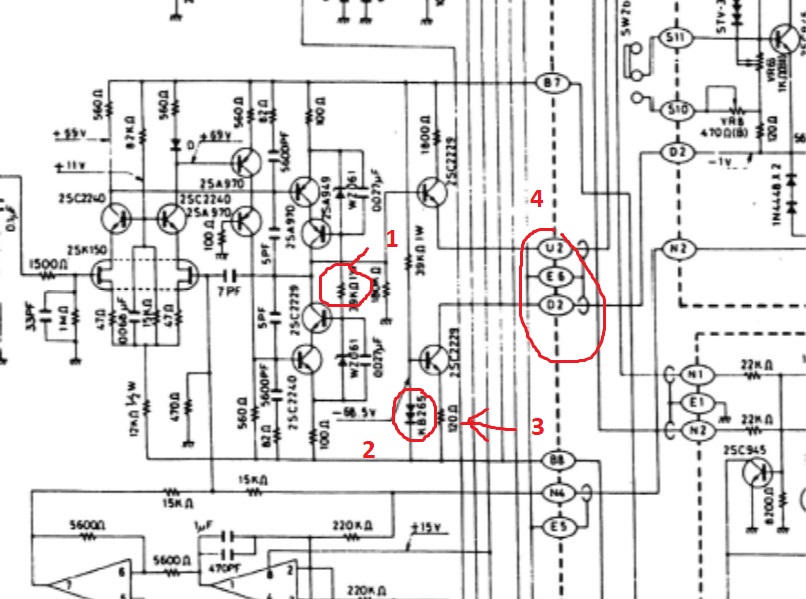

The diagram isn't terribly clear so hope this makes sense. I've numbered a few things.
1/ Check this 39k is OK. It's typical of a part that would fail, a high value resistor that sees high voltage. If it is as hot as the other channel its probably OK. If not then lift one end and measure it.
2/ Check there is around 1.8 volts across this diode combination.
3/ Check there is around 1.2 volts across this resistor.
Across means putting one lead on one end and the other lead on the other end 🙂 and not measuring to chassis.
4/ What voltage do have on points U2 and on D2?
I would check those parts I mentioned earlier and then do a few careful voltage checks.

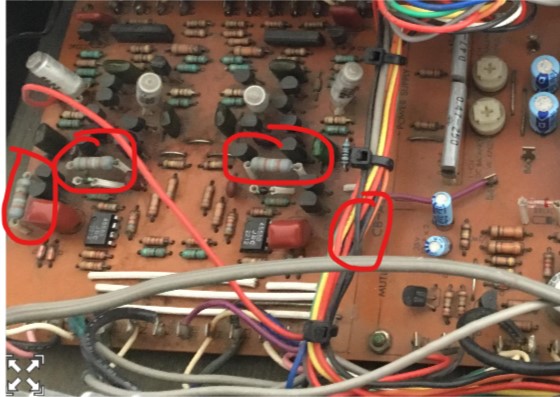

Before doing anything, just check these four resistors. I actually hadn't spotted the other pair when I looked at the circuit. These are metal oxide resistors and they run hot which means they can fail by going high in value or open circuit.
Quick 'engineer mode' test check is just to see if they all run about as hot as each other 🙂

As you will know, these Resistors are specified for 39K each.
(By the way, this amp is loaded with these METAL OXIDE Resistors, all of which seem okay, as follows...)
Measured in circuit - across each Resistor - with the amp completely powered down and drained, they each measure around 38K. Within .1K of each other.
Seems like they are okay.
I have poured over every resistor several times and measured in this way.
Sadly, no last minute "AHA!" moment at this end.
As an aside, can you explain what you mean by "Quick 'engineer mode' test check is just to see if they all run about as hot as each other..."
The reason I ask is that I can't get them hot to check as the Protection Circuitry has locked me out. The amp will not power up at all.
