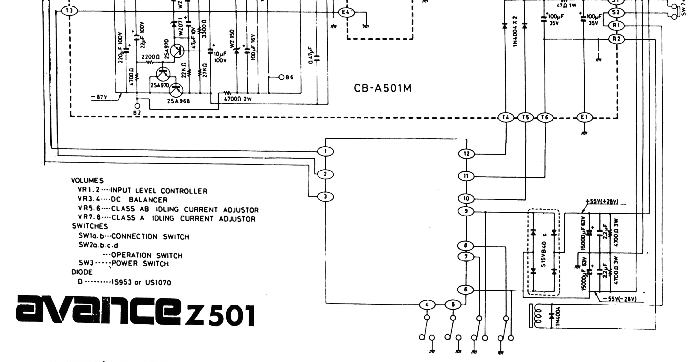

As the title of this post suggests, I'm considering changing my US-centric AVANCE Z501 from 120V to 240V operation, to fall in line with local mains supply in AU/NZ.
I'd like to source a suitable PT replacement - unluckily, my original US PT model 2553 is the model WITHOUT the spare windings for 240V operation - but the Z501 schematic does not state voltages on the windings.
Would you happen to know the transformer specifications for the 240V AVANCE Z501 PT?

Due to the various specific tappings on the transformers secondary winding's (see circuit diagram), it wouldn't be a simple job to find a suitable 240vac primary replacement transformer. You would probably need to have one specially made to fulfill the same (various) functions. It's a fairly complex arrangement with the ability to change from class AB to A via a switch/relay combination.
You could try to find another 240vac tranny from another 240v Z501 model? there may be an old non working one out there somewhere that could be salvaged for parts - poss place an advert for one? The other possibility and the more likely of quick success is to supply the amp from a step down transformer (which I assume you do now). The larger rated in volt/amp terms that the step down transformer is the better otherwise the mains impedance of the supply could suffer (increase) using a small underrated step down tranny and your Z501's full potential wouldn't be realized. A 1000va one would be ideal though you could get away with less current capability. Mains impedance (resistance) is important especially with a power amp as it draws heavy current from the mains each time it's required to 'top up' the amps power supply reservoir capacitors on demand.

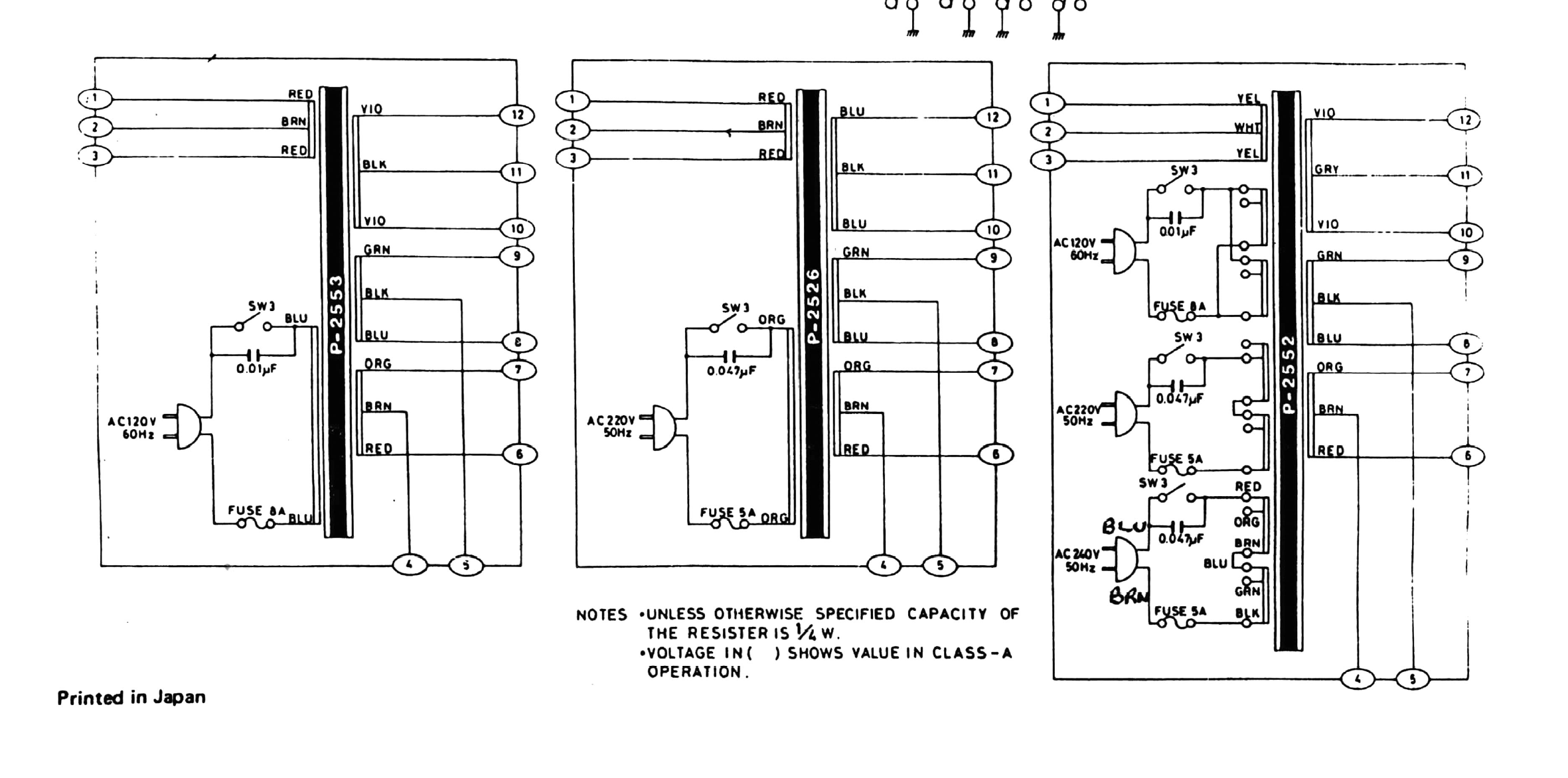

I have kept my eyes open for a parts donor amp for some time now, but the few of these rare amps that come up for sale are typically 120V also.
I agree that my last resort is to price-up a new 240V power transformer, which is why I am trying to confirm exact PT specifications.
Yes, I have the original owners manual, which has a very clear schematic of the amp at the rear. Exact PT windings values do not appear to be stated.

Due to the fact that you live in New Zealand with a (230v/50Hz) mains supply and you are powering your Z501 from a 120v/(60Hz)? power transformer I thought I would let you know (although you may not like to hear it) that supplying a 60Hz transformer from a 50Hz supply could over stress the transformer (overheat) in your case that would be in class A mode at fairly high power levels.
Running a 50Hz transformer on 60Hz would be no problem at all though, 50Hz transformers are typically 20% larger than their 60Hz equivalents. So it probably would be a good idea if you could get your hands on a 50Hz rated tranny?
