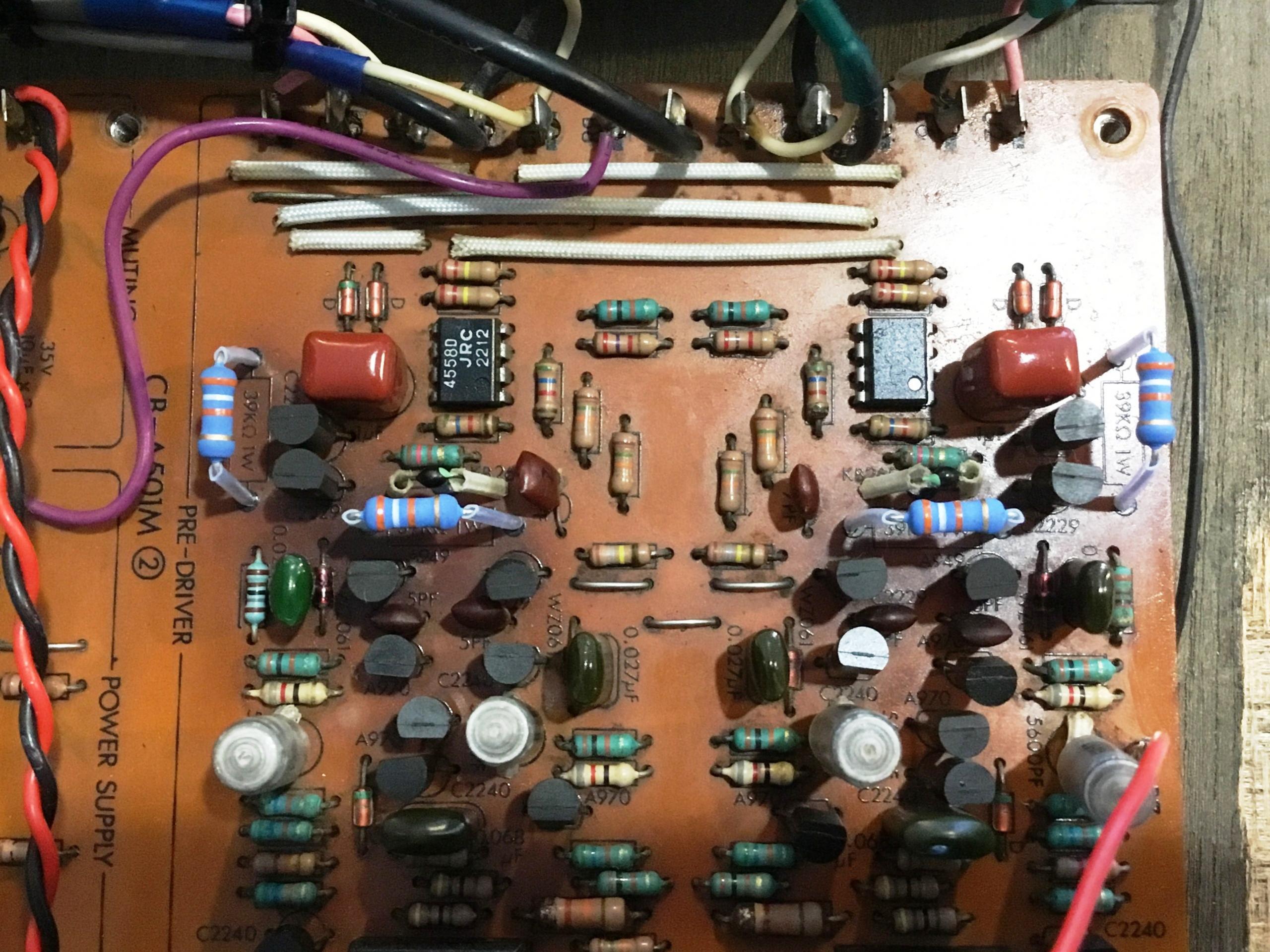

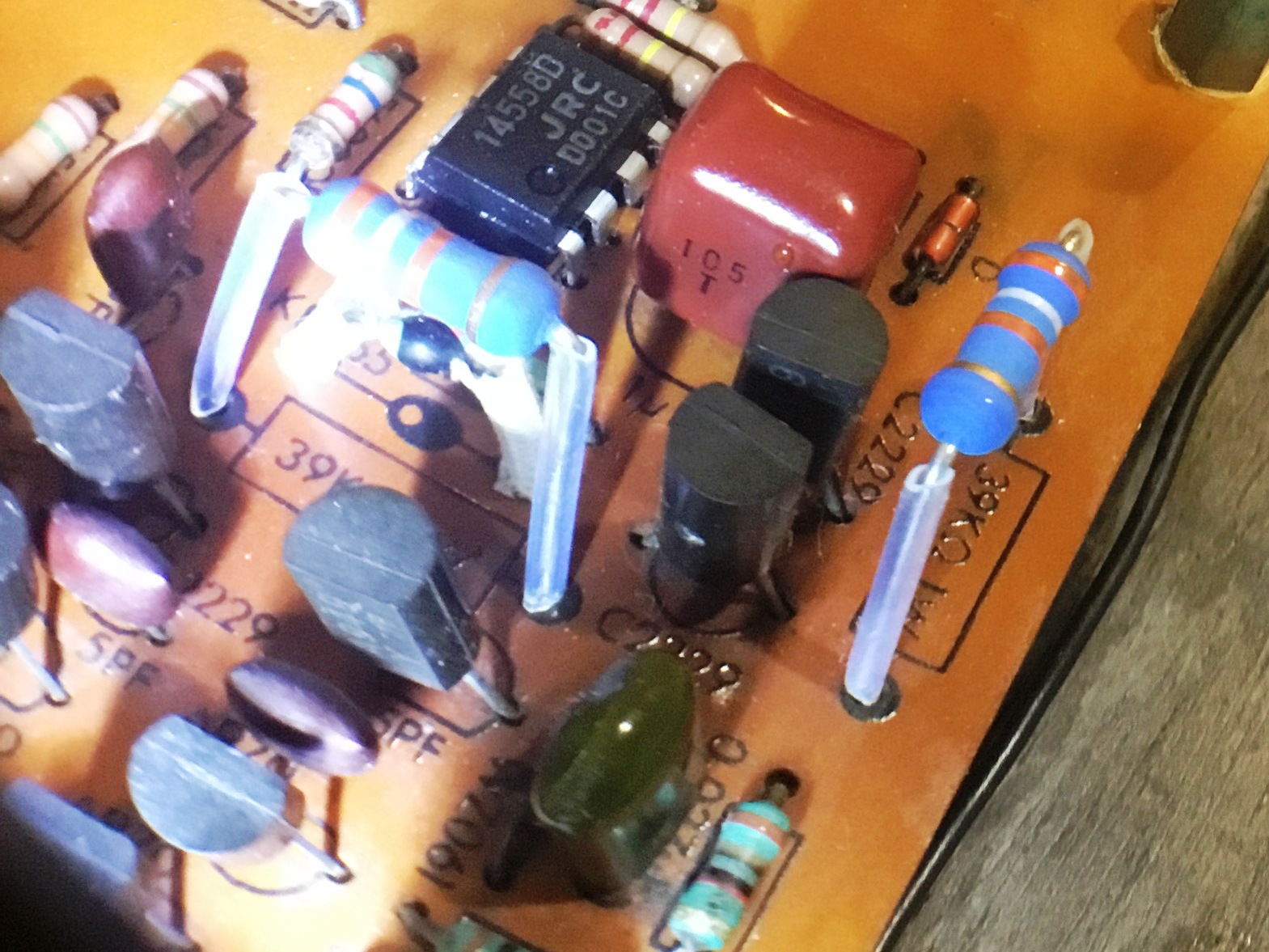

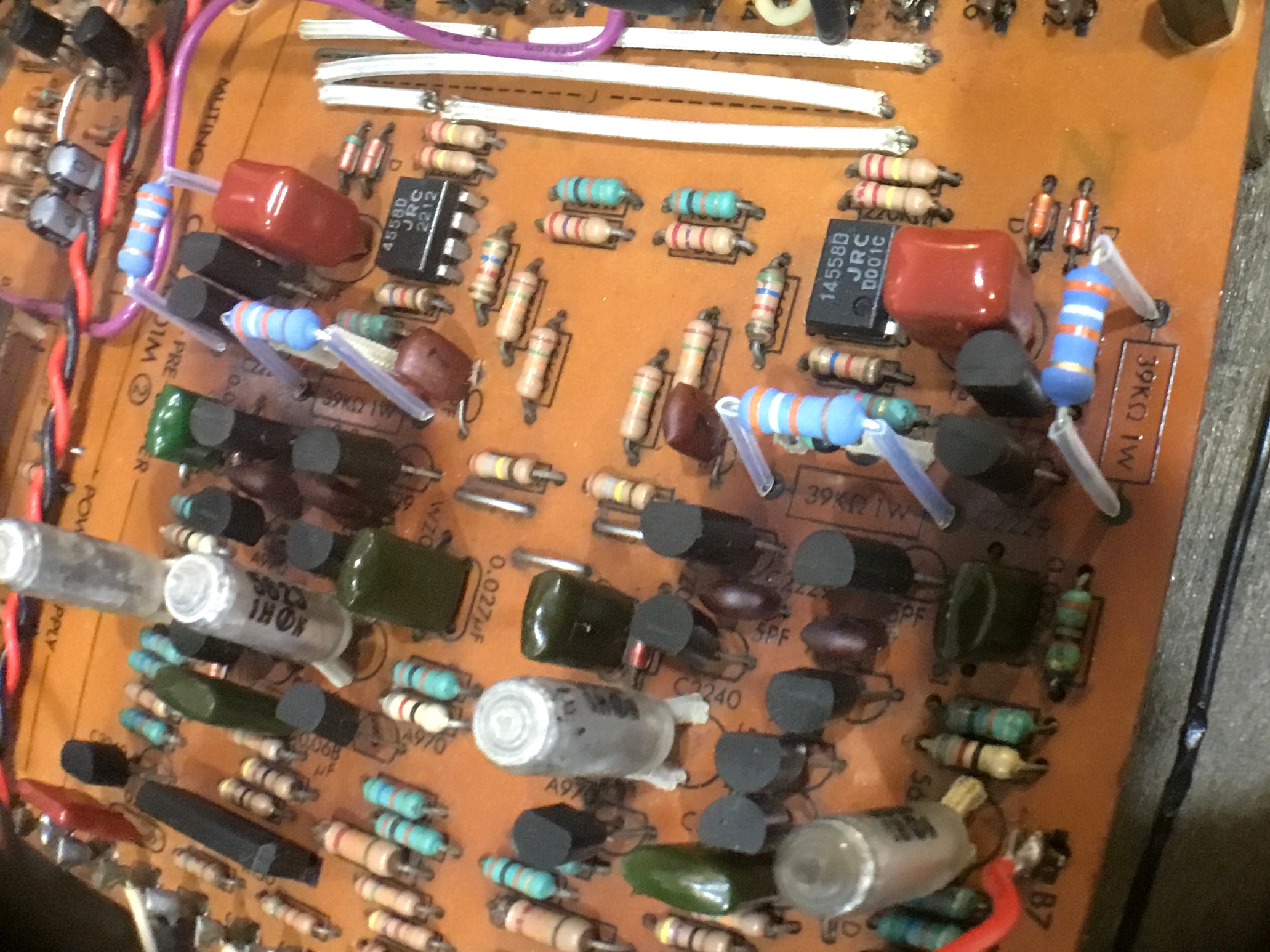

Thanks PITBUL.
On your recommendation, I returned to the 4 x 39K Ohm / 1W Resistors in the PRE-DRIVER area. Sure enough, the sparkle returned to the sound. You were right.
See pic below of the new 1W Metal Oxide Resistors.

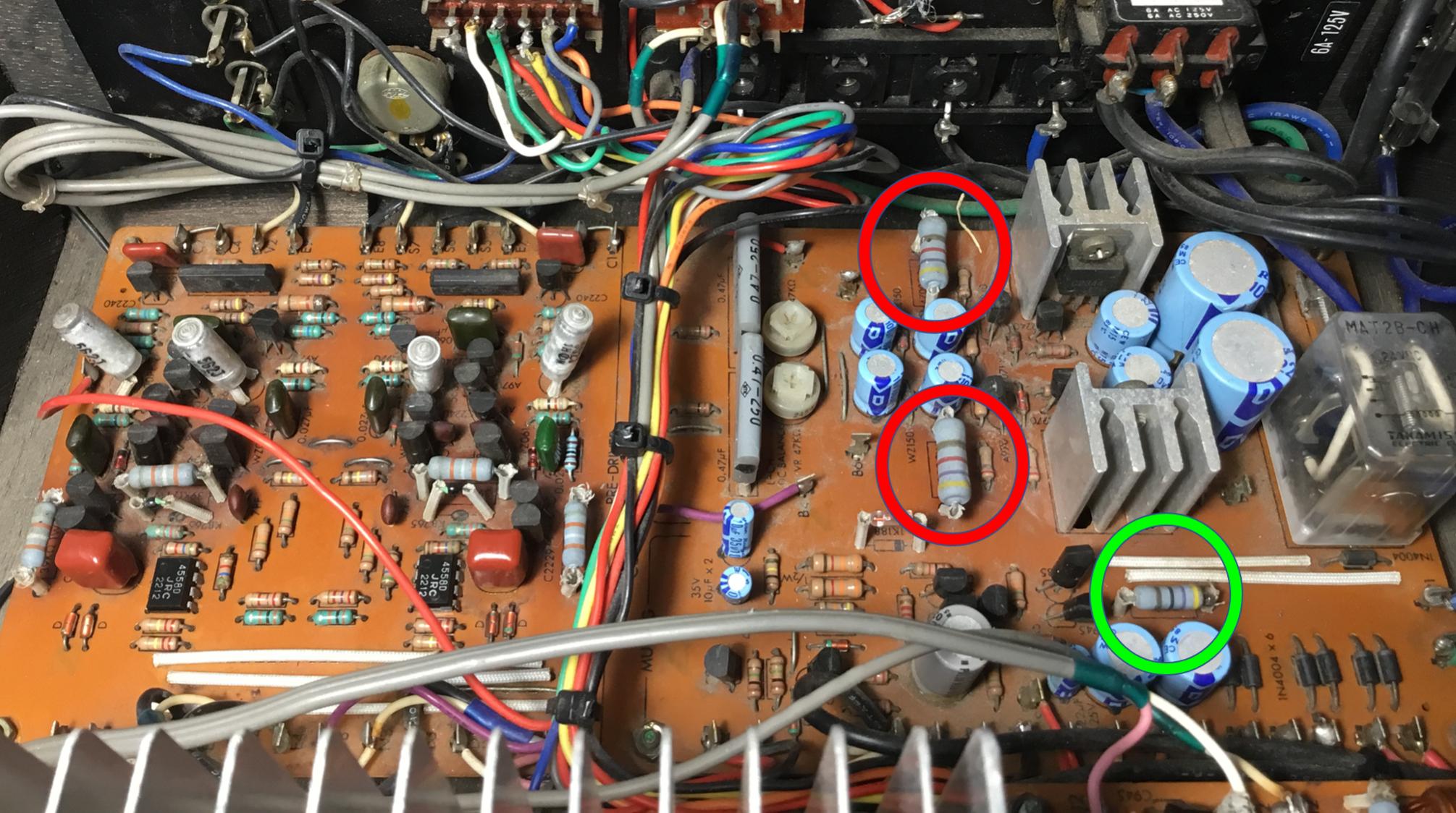

On to the Power Supply / Muting Board Resistors...

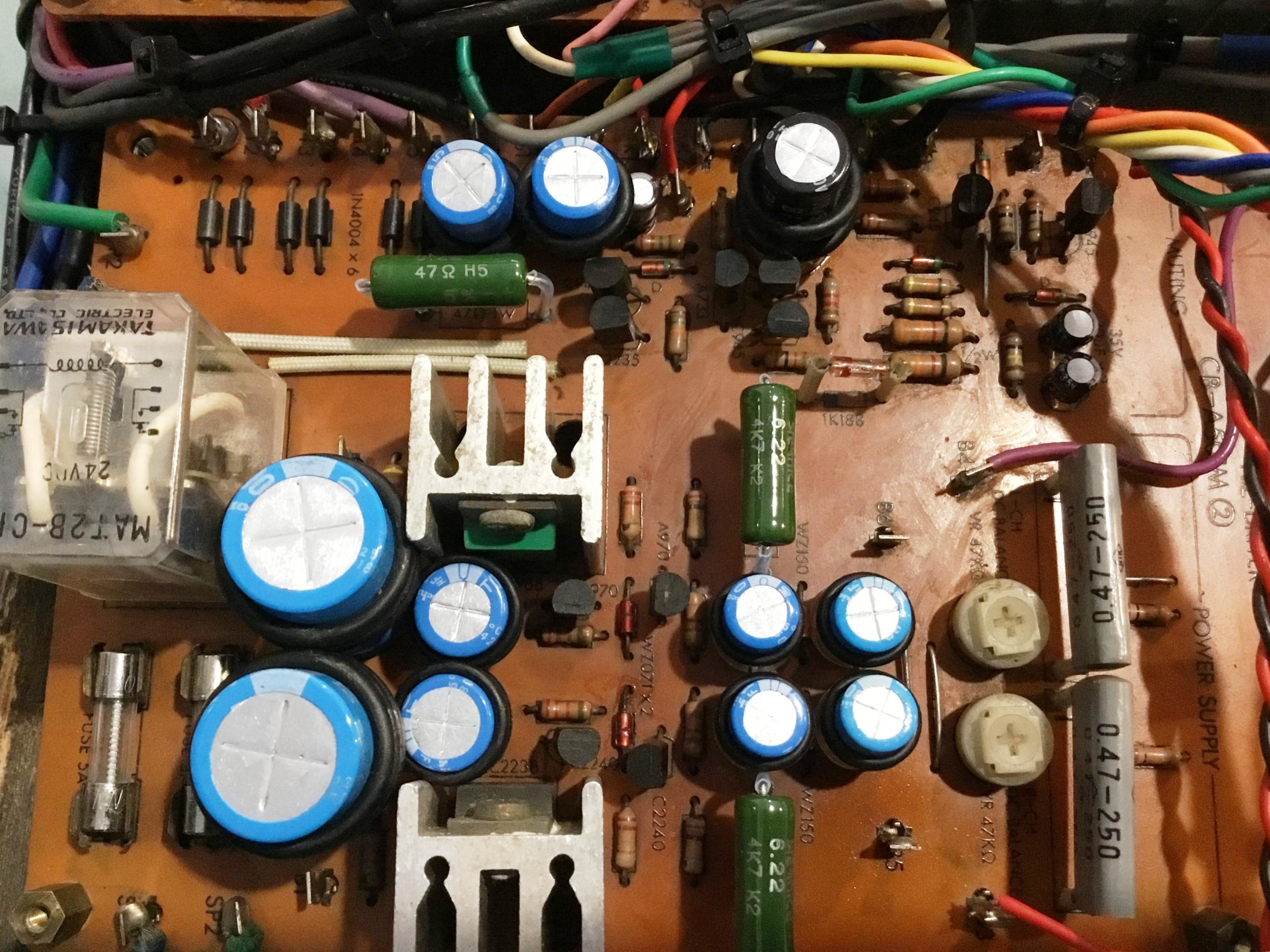

Since then, I have moved-on to the Power Supply / Muting Board, where all of the Electrolytic Capacitors are located.
While I was replacing all of the Electrolytic Capacitors, I also took the chance to change the three key resistors in that area.
All 3 Resistors were Metal Oxide types. I replaced all 3 with Wirewound types.
2 Resistors are 4K7 Ohms - located close to most of the Electrolytic Caps (RED circles in the pic) - and the other 1 Resistor is 47 Ohms, located near the Zenered Diodes (GREEN circle in the pic).
The specifications call for the 4K7 Ohm Resistors to be 2W; and the 47 Ohm Resistor to be 1W. I replaced all three at specified Ohm values with "lossy" 6W Wirewound Resistors, in the hopes that this would help keep noise down in this area of the circuit.
When I powered-up the amp, once again I had lost the frequency extremes.
This surprises me as the resistors that I have replaced only help with power rectification and relay control. (I think...) So, I would have thought that as long as the resistance value was correct - as specified - I would be able to install a resistor of ANY power rating, without impacting sound quality. Apparently not???
Please see the two photos attached for a "Before" and "After" view.
(NOTE: There are no heat-reliant diodes near these 3 resistors, at this end of the circuit board...)

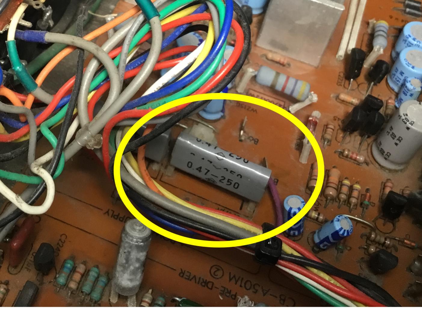

After struggling to get back to the previous high levels of quality sound quality - following a recent Electrolytic Capacitor upgrade - I realised that the sound quality was mainly inferior in the LEFT CHANNEL only.
This lead to a bit of a witch hunt, during which I discovered that one of the other types of (original, unreplaced) capacitors in the Power Supply has split open.
I'm thinking that this is the cause of my sound quality my problem.
I have taken a photo (below) of the offending capacitor - shot taken before the split - in the hope that someone might be kind enough to confirm my assumptions about this part.
It's pale grey in colour, 20mm long x 10mm high x 4mm thick and appears to be a .47uF (470nF) / 250VDC Film Capacitor.
My thinking is that this could be replaced with any PET type capacitor of same values (or perhaps with higher VDC) as long as the dimensions fit.
Question: Have I got this right?
Question: Would I gain anything by moving to another type of capacitor of the same values?
Appreciate any expertise provided here.

I see a total of six .47uf film capacitors on the schematic, two are on the output of the +/- regulated supplies and two on each channel for +/- rail decoupling. The first two I mentioned will be common to both channels so not your suspected problem. The second four I mentioned might be audible. Any .47uf film capacitor @ 100v or greater should be fine.

Upon closer inspection, the damage on this capacitor is not a split as I first thought; just a little bit of "lift" of the outer wrapper.
On second thoughts, I really don't think this capacitor is a problem at all. I will leave it as is, for the moment.

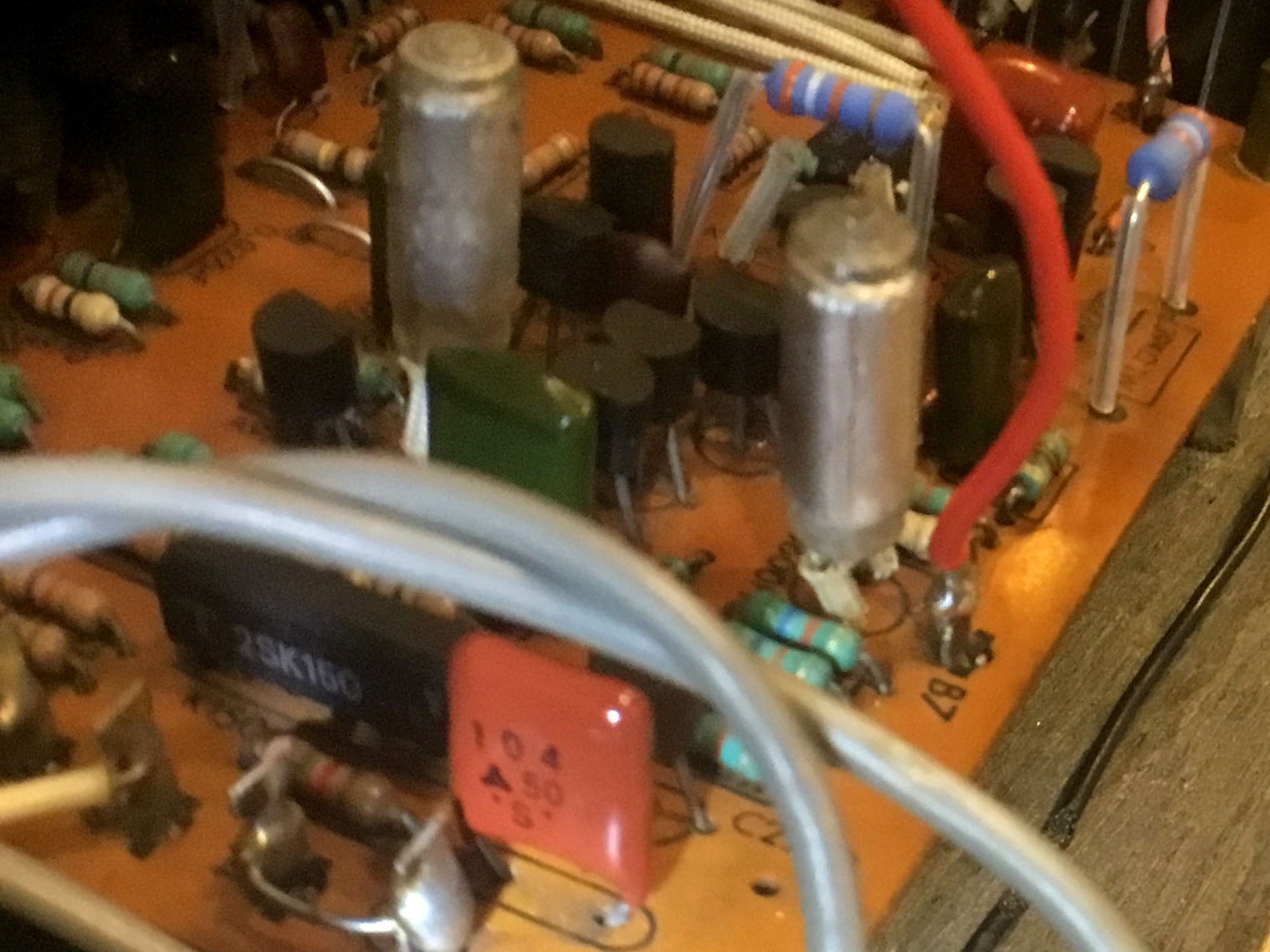

I have included snap-shots below of these big (cubic-shaped, brown-coloured) plastic caps have very few markings. All it says on one side is: -
105
T
(I assume 105 refers to maximum temperature?)
Actually, there are a couple other similar - smaller - caps on the same board. They only read: -
104
A 50
S
(Again, I assume 104 refers to maximum temperature. Not sure if the "A" is a logo or a letter...)
While I'm under the hood, are these 40-year old caps worth keeping? Or can they be easily bettered with modern equivalents?
If I should replace them, would any or the experts have any recommendations?

105 means 1000000 nF (1uF) and T is tolerance marking (+/-22%-33%),
104 means 100000 nF (0,1uF), rest is unknown to me and also irelevant (maybe it is Matsushita manufacturer marker, old symbol-triangular, not A).
For better audio you could try WIMA caps 1uF/50V, they are similar in size and could be easilly fit on place of old caps.

Thanks PITBUL. I would not have got halfway here without your help - and that of MOOLY. Many thanks for sticking with me on this project. Appreciated.
With these old brown caps, would a best replacement be Polypropylene Caps?
I have had great success with Polypopylene Caps in other amp projects and wondered if they would be a good fit here?
I'm also unsure how to calculate the Voltage Rating as all of the surrounding Resistors are rated in "Watts" - as in they are mostly 1/2W rated. Not sure how this relates to Voltage Rating in Caps...?

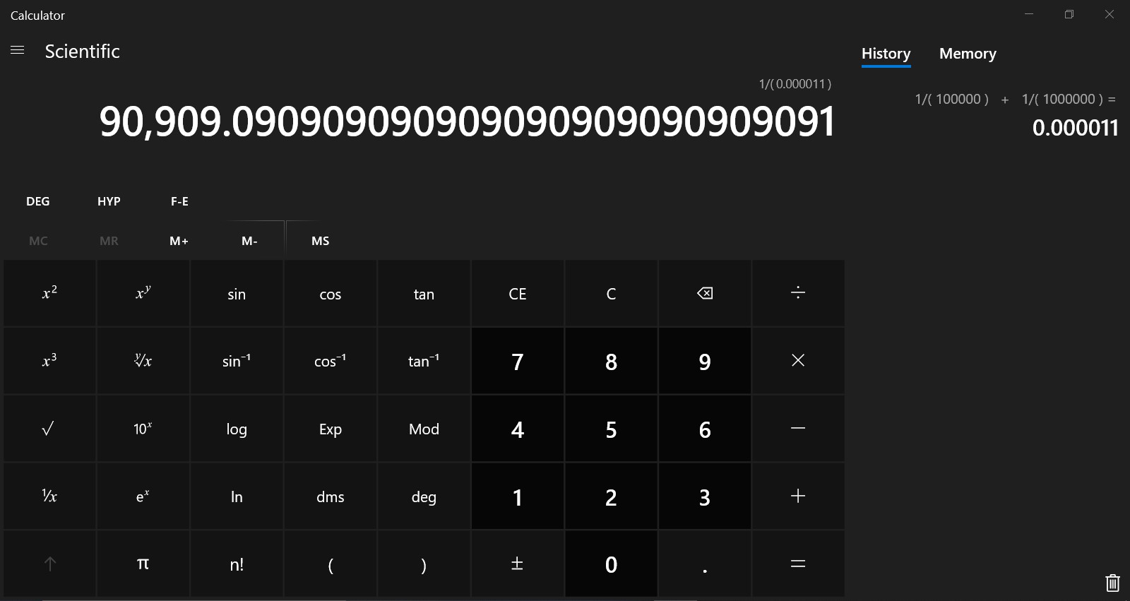

For easy reckoning the input impedance of the actual power is 1Meg (more accurately 1Meg + the series 1k5 at DC and for AC it is the same plus the effects of the parallel cap and the parallel junction capacitance of the FET)
So 1Meg nicely covers it 😉
The 100k pot is included in the overall calculation as a parallel resistance and gives an input impedance:
1/( 100000 ) + 1/( 1000000 ) = 0.000011
The combined resistance of those two parallel values is the reciprocal of 0.000011 which is 90.9k. The 1k5 and caps have been discounted.
So a 10k pot at the input will give an overall input impedance of:
well you work it 😉
Edit... and the final result also depends on what setting the pot is at. Again, the round value of 90k in original form covers it 😉
well you work it 😉
