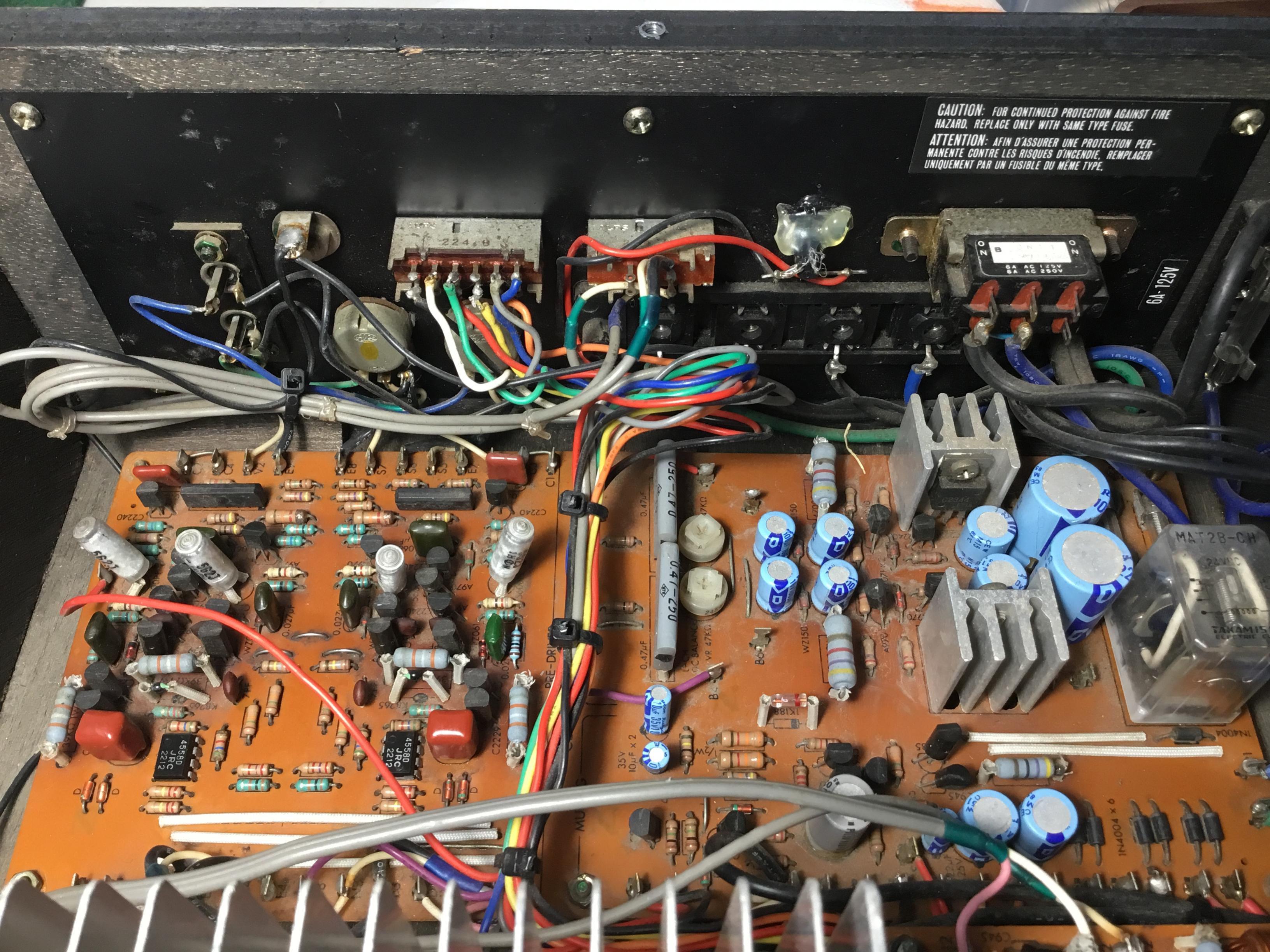

In the interim...
While I am waiting for the massive Power Supply Capacitors to *discharge - before I try swapping wires around - I thought I would mention...
This old 1981 LUXMAN LUXKIT AVANCE Z501 normally sounds so darned good, I just can't abandon it!
It is in my thinking that sooner or later - depending upon family demands at my end - I will transplant this amp into a modern enclosure. This will give me the chance to really "go to town" on this amp and give it a real Birthday, with all the trimmings.
I guess a purist would want to keep it all stock in the current (plywood) enclosure, but frankly, it's not much more than an old crate.

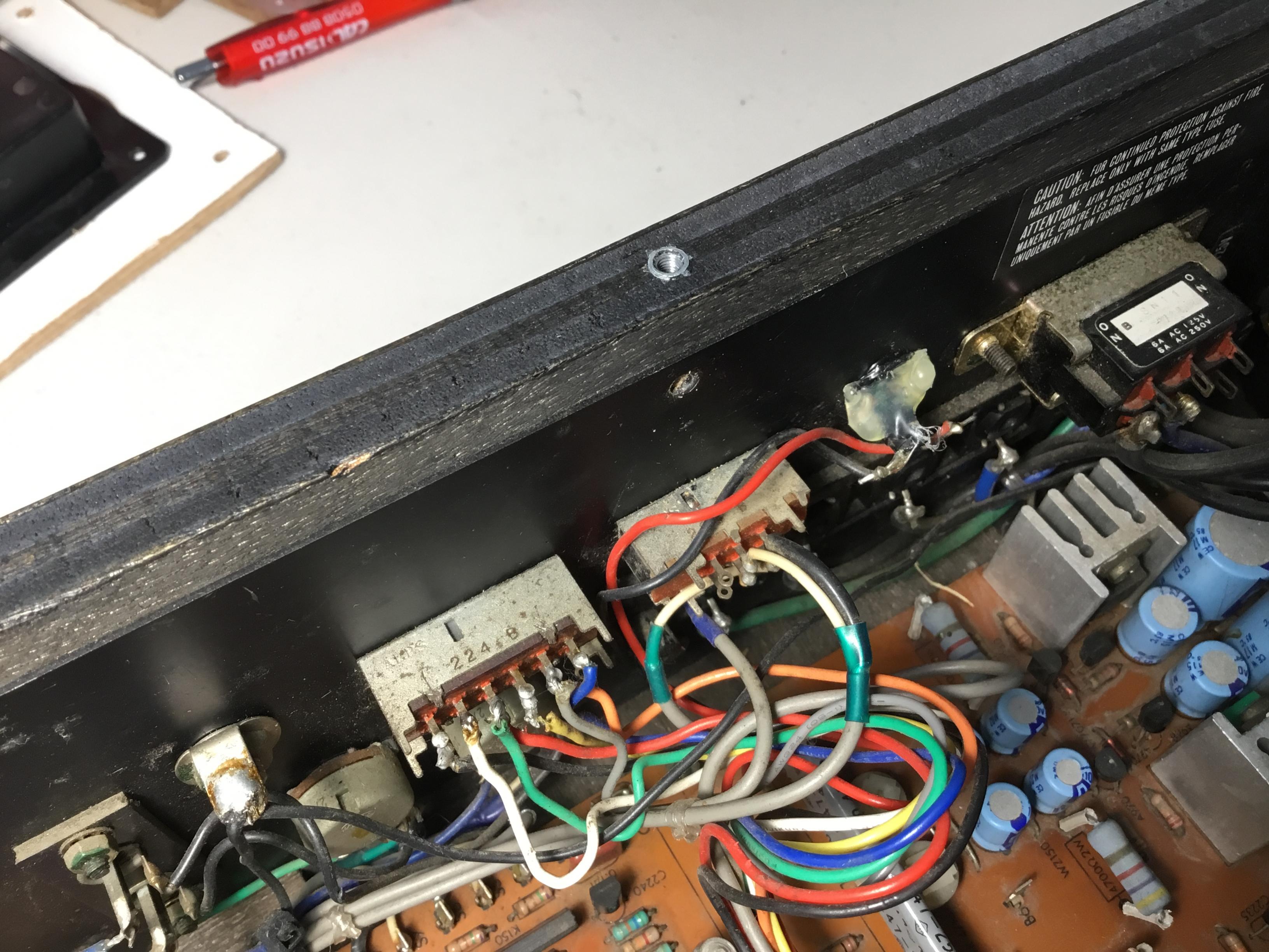

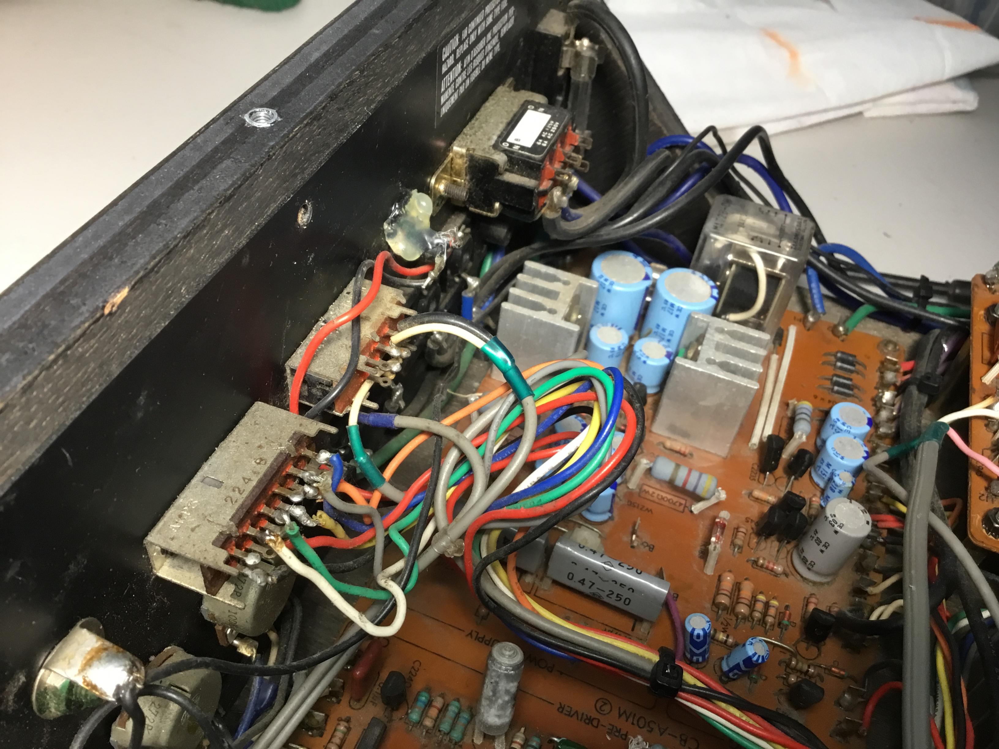

Back to the test...
MOOLY
I swapped my thin white jumper wire to LEG-7 - as you originally suggested - but this time I was unable to secure it, as it is so darned close to the LEG-8 you mentioned. So I held it there manually.
I believe that this achieved the little workaround, exactly as you had drawn earlier in this thread.
This time, there was a different result.
Previously, the amp Protection Circuitry locked the amp up, leaving the red LED winking in disapproval.
This time, I heard a relay "click" and the red LED was left solid red.
This definitely seems like progress!
I know it would have been helpful to re-measure P1 and P2 at that point, but holding the white jumper manually, it was just not possible. Sorry.
Now here is a question: I cannot clearly recall whether this LED's normal "PLAY" position is solid red, or whether it should change to solid green. I just can't recall.
@DRUIDAUDIO Can you confirm what the normal "PLAY" state of the Control Console LED is on your Z501 please? Is it solid red? Or does it turn solid green?
In any event, I'm not sure what I have just proven - if anything - but hopefully this is good news!

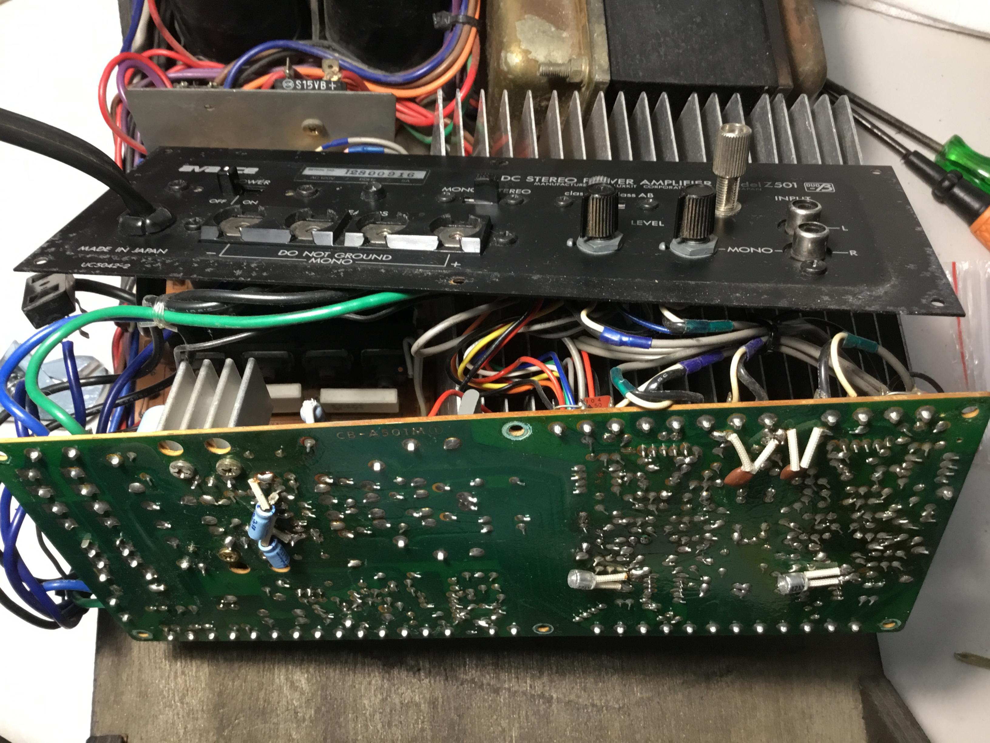

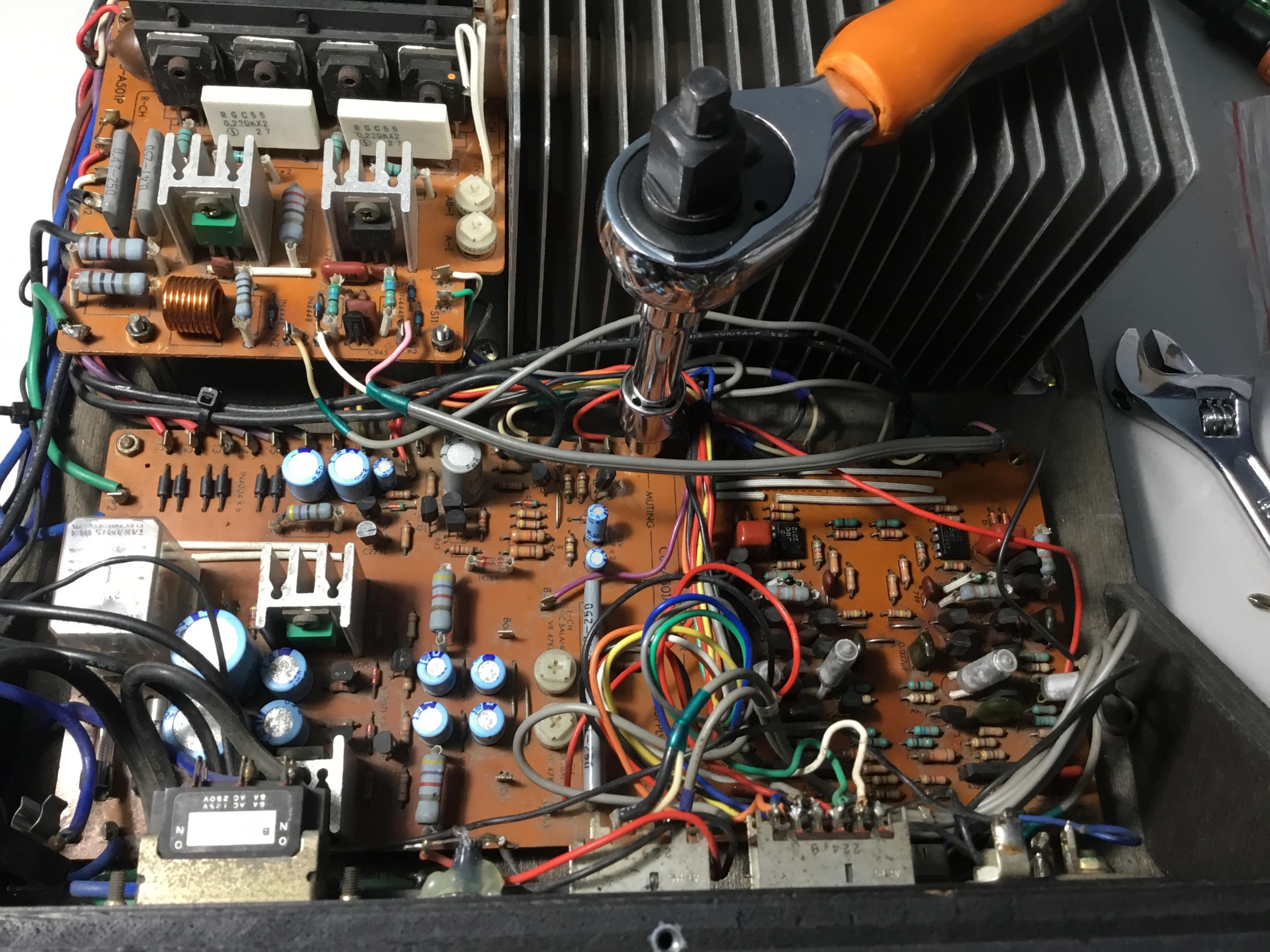

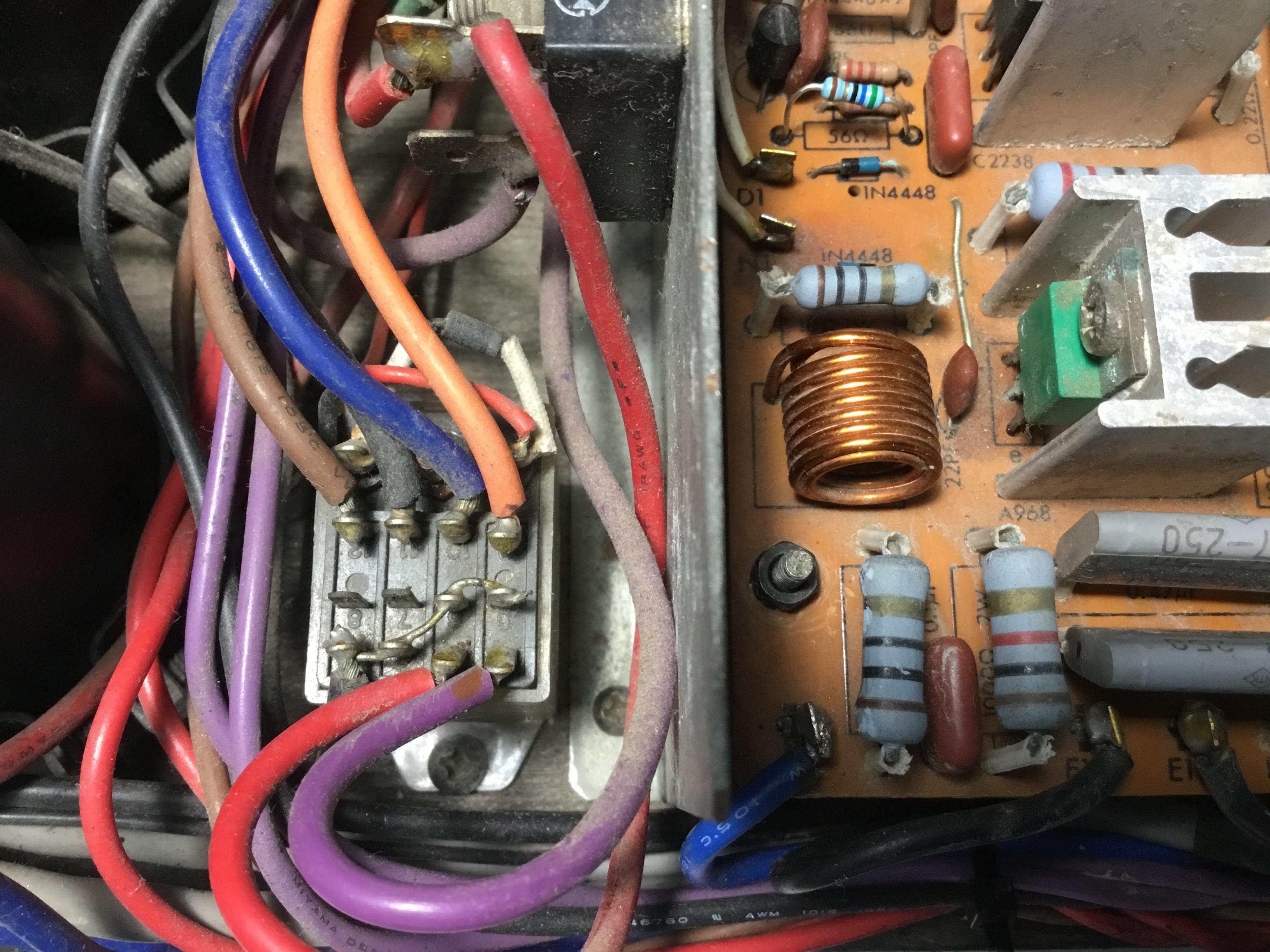

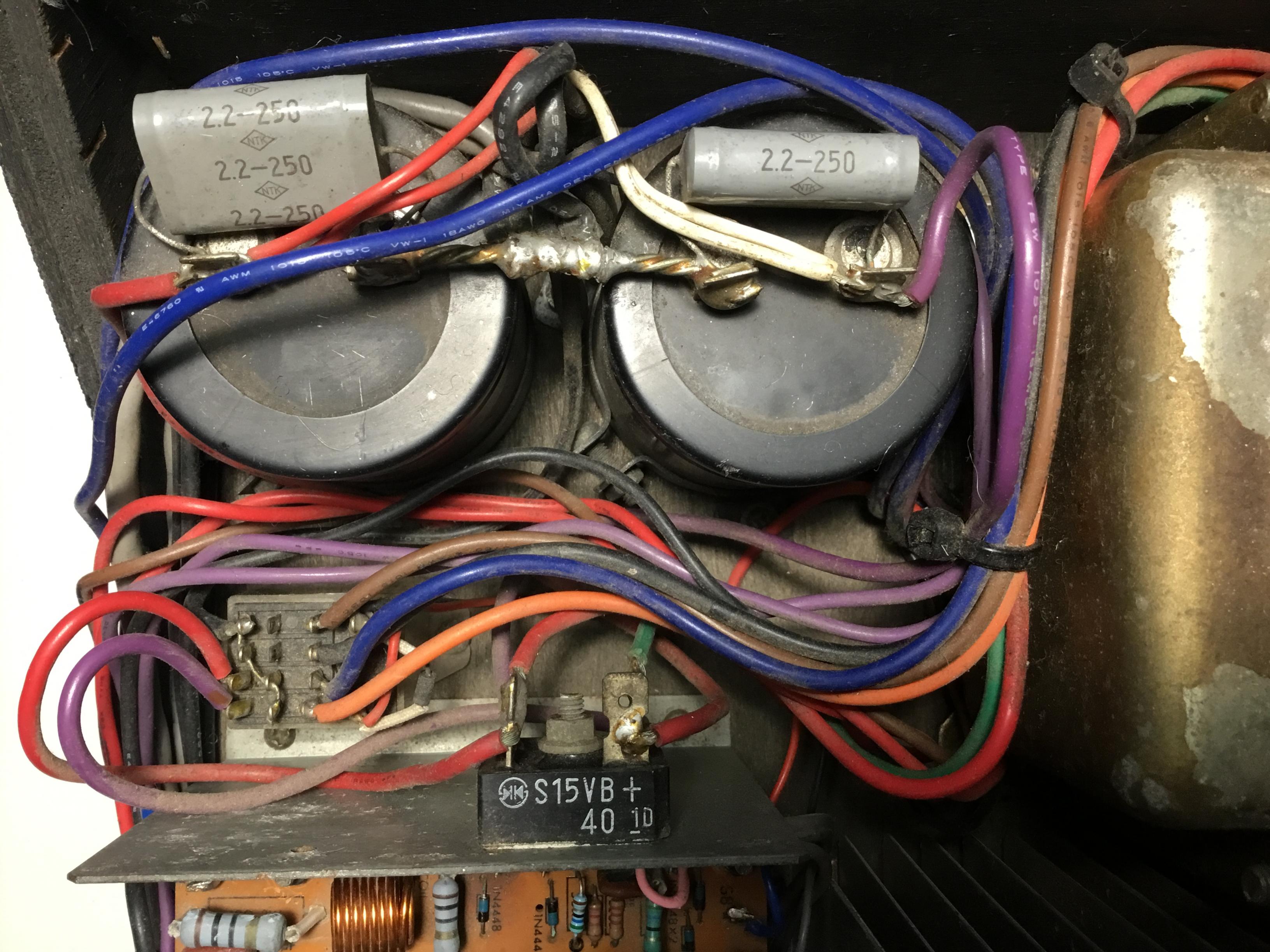

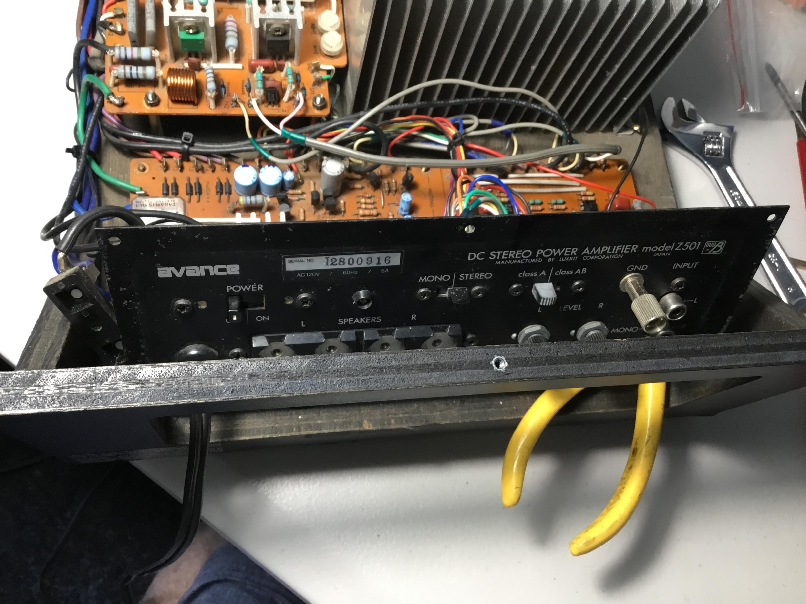

Knee Deep in the Hoopla!
Well, I had talked about it for long enough... The time came to leap in!
The next few posts will document the next part of my journey - which required gaining working access to the underside of the Power Supply circuit board.
A picture paints a thousand words, so I will let the photos tell the story...

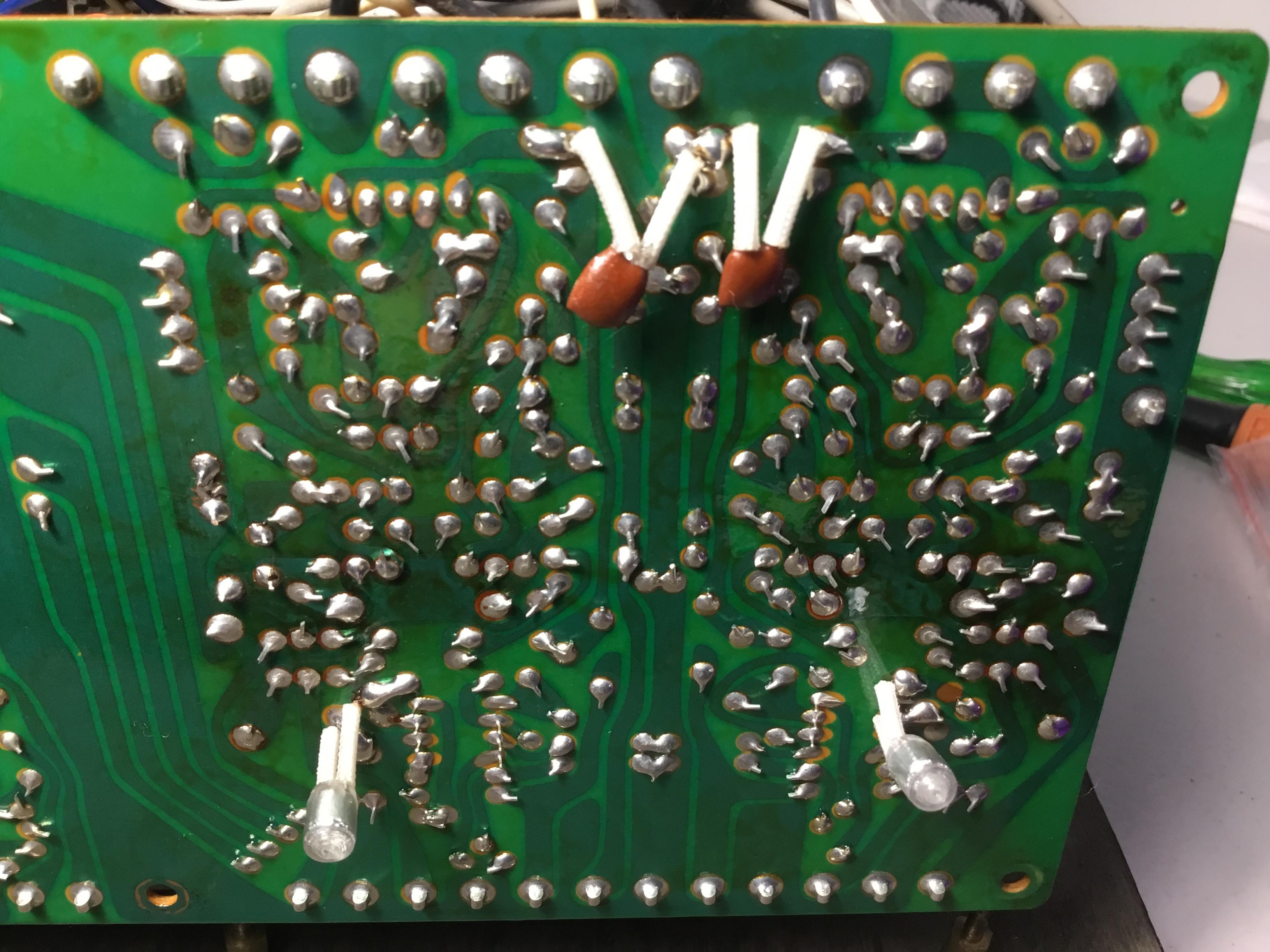

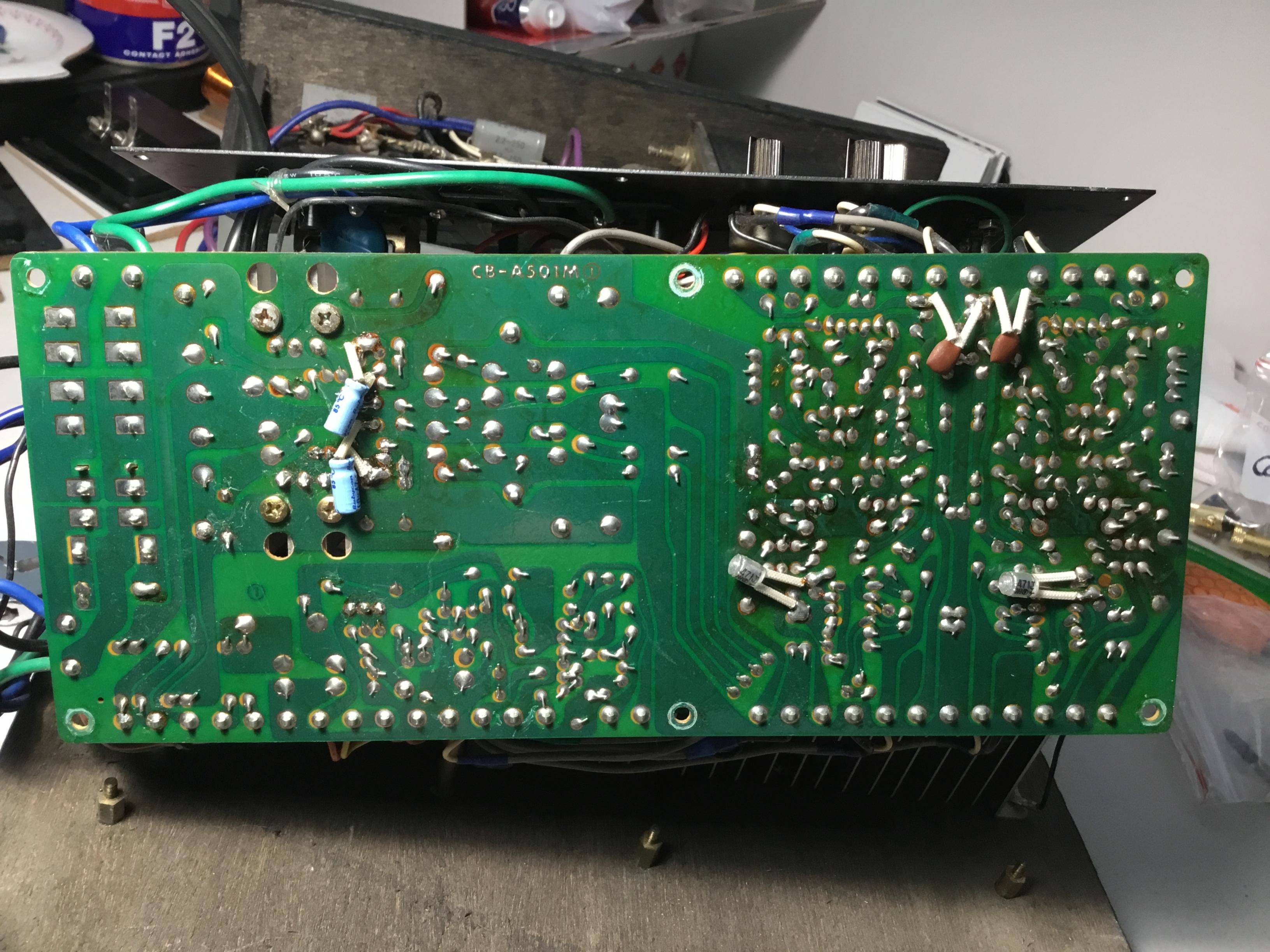

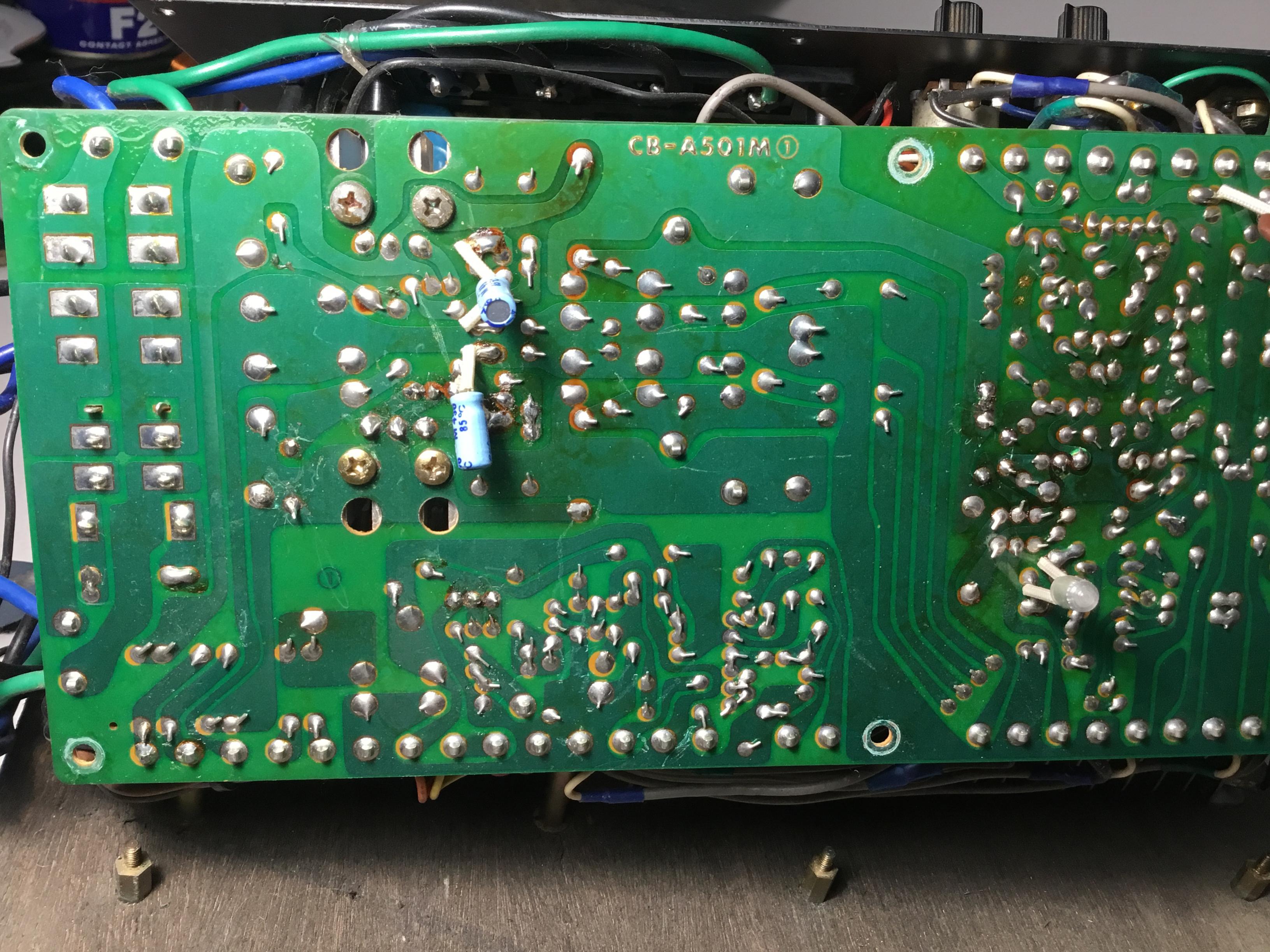

First Glimpses!!!
After about 30-minutes of careful and gentle persuasion, the shiny green underside of the circuit board finally emerges to reveal its secrets...
Initial observations reveal that: -
* The area of the circuit board that has been supporting the OPAMPS has been getting pretty hot; and
* On at least one prior occasion, someone else has been stirring this porridge!
I elected to give the areas of concern a bit of a clean to see what is really happening on the underside.
I was quite surprised that many of the underside solder joints spilled into each other. Based upon several areas of judicious "scraping" that I can see, it appears that an earlier explorer has also attempted to remedy this solder spillage.

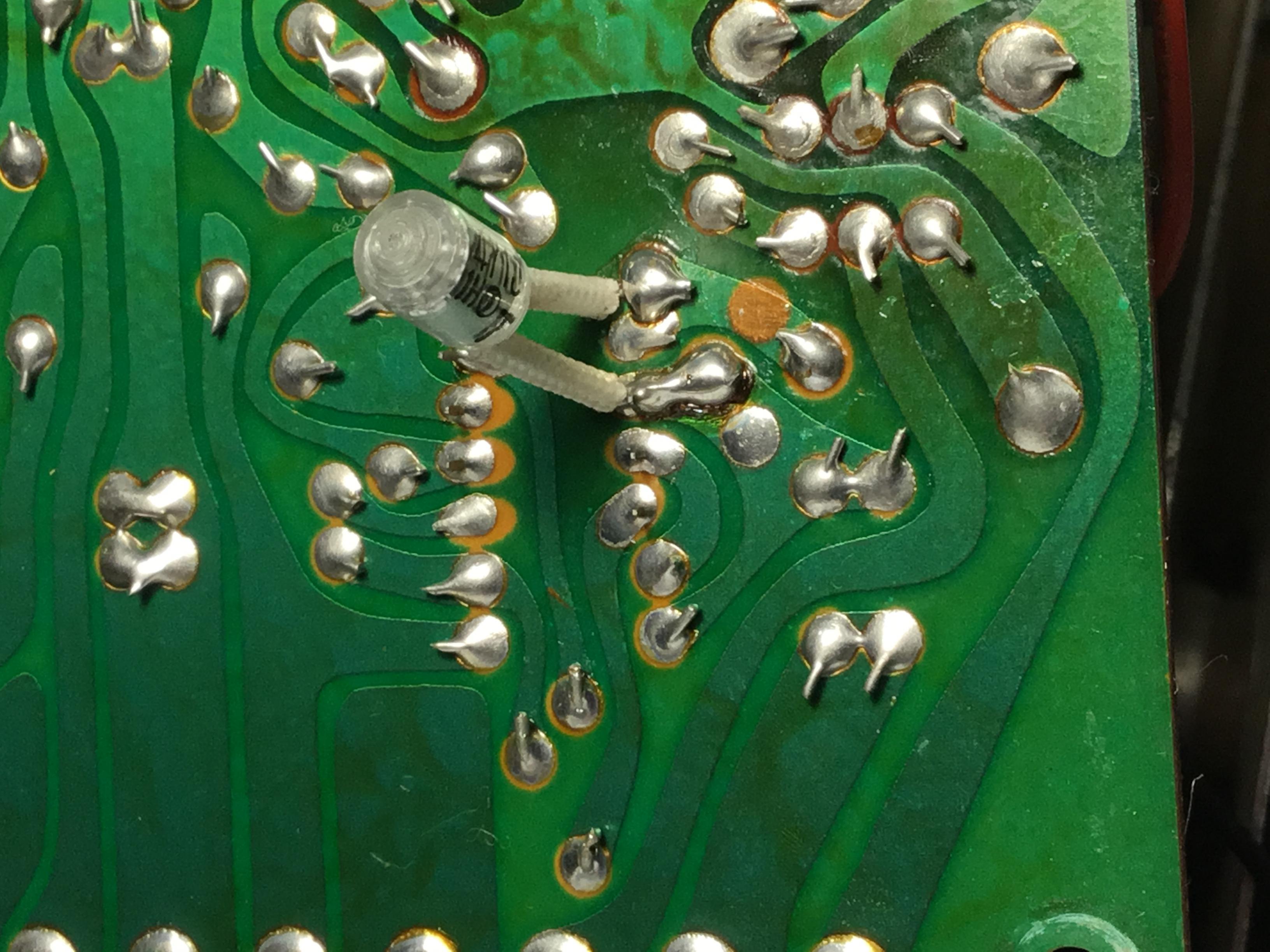

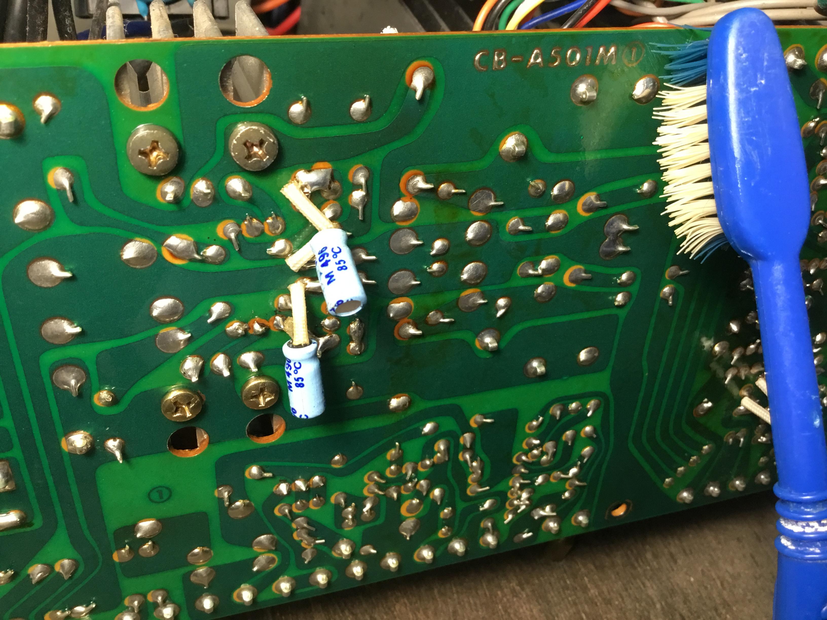

4558D OPAMP - Close-up Photo (Circuit Rear!)
So here's a close-up photo of the contentious are.
You can make out the 8-LEGS of the OPAMP here, with a silver can (Capacitor perhaps?) entitled 471J (I think?) inserted across a couple of the legs: Legs 1 and 3 I think, but I'm not sure.
Because I can't immediately spot any obvious circuit board cracks or rubbish solder joints, I'm gonna stop right here and wait for some expert suggestions about what's next.

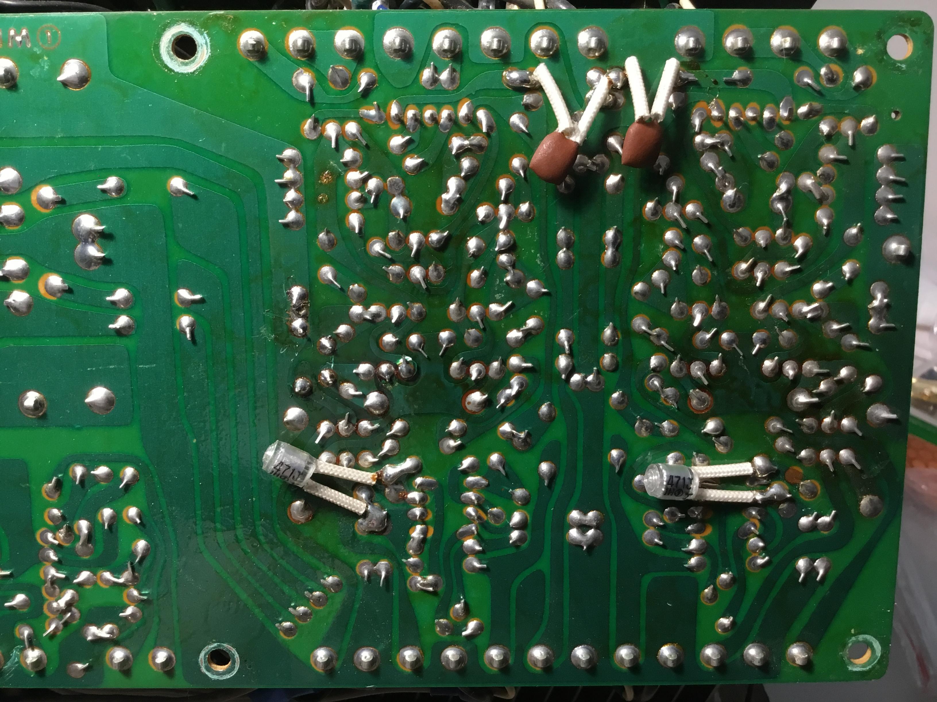

Could these be COLD SOLDER JOINTS???
I've been staring at this circuit board all afternoon "...looking for clues" as the late Robert Palmer once famously sang.
I have noticed that a number of solder joints on this board look a bit dodgy. It's almost as if the solder and the component have not quite got hot enough to become one, so there's a faint telltale "ring" around the component tail.
(I have circled these in RED for warning!)
This, compared with what I would consider to be superb solder joints, where the entire joint appears to be one piece of flawless metal, that encapsulates the component tail without any division marks.
(I have circled these with GREEN for good!)
Could the joints circled in red be potential COLD SOLDER JOINTS?
Could this be the source of my problems here?
(Interestingly, there are very few of these around the operationally normal LEFT CHANNEL, on this board...)

Yes, that are cold solder joints, to do it right you should suck (with the soldering pump) the old soldering and apply new that spot.
That is the primary reason why I was forcing you to do job with the soldering iron. For that old amp it is always good to see what is going on with solder joints.
Could you determine which opamp area is pretty hot. My suggestion is that you pull out right opamp ic and measure the voltage on the diodes which protects the input of the opamp (I am writing this way because on schematics opamps inside ic are swaped for each channel, so I can't conclude which numbers are right). Maybe you will have different DC offset on the amp output, to measure it right, do it on the resistor side which is connected to the amp out (that is correct info, diodes will limit the voltage to max 0,6-0,8V as I said).
It seems to me that opamp will do DC offset correct if it is working.
What Mooly suggested maybe will result to eliminate DC offset, but also maybe not. To correct the offset caused by some non balance in the circuit, which may be obvious after so many years, opamp will do.
Opamp is not intented to do the job if there are some sirious failure, or if there is DC offset outside the range which opamp can't manage. So, if there are the last described case, problem lies somewhere in the circuit.
First, do the cold joints, after that switch on amp and do measurement to see what hepened.

Thanks for the support, PITBUL.
Okay. These are cold joints. Aha! I'm not going to pretend that they will be my sole source of problems, as these cold joints have probably existed since the amp was built in 1981. However, I can imagine that over time, they slowly but surely introduce more anomalies into the circuit until one day, things just don't work right.
As you suggest, I will wait for my new desolder pump to arrive and will remedy these joints properly. The temptation - while I wait for the new machine to arrive from Australia - is to start collecting new Capacitors and Resistors for the joints that are affected. Hmmmm....?
If you don't mind, I may revisit this with you when the time comes as I'm not 100% clear on the process.
I think for now, Step 1 is - as you prescribe - to rid the board of Cold Solder Joints and then power-up and measure.

Working through the posts...
The only result that mattered was the behaviour of the amp with pin 7 grounded. It seems like doing this did indeed change the behaviour (which is good) but what we really needed was the voltage check of offset.
You could do that by anticipating that the click was the speaker relay connecting correctly and so wiring the meter across the speaker sockets and seeing what happened.
This result is a big step forward though and hopefully shows the main amp is basically OK. The circuit also seems to show a single LED, not a bi-colour type.
Discharging caps. Normally the circuit itself will do that. Just check to make sure there is no high voltage across them. Anything under a couple of volts is OK to begin working on the amp. To manually discharge a large cap use a resistor appropriate to the voltage. A 4k7 2watt carbon type should cover most situations on solid state stuff.
The shiny green is a mask which we call solder resist. The board still looks like a phenolic resin type to me and will have a distinct smell as you solder on it. The discolouration in response to long term heat is perfectly normal though.

4558D OPAMPS ARRIVED!!! (But...)
@Pitbul
Well, as agreed last week, I ordered the 02 x [4558D JRC 0079T0] And what arrived?
02 x [4558D JRC D001C].
(Sigh...)
Well, they certainly look the same as a 4558D JRC 2122 - as currently installed in the Z501 - but will they work the same???
Truthfully, I really have no idea.
In the event that it does not, I need to let the supplier know and seek the right OPAMPs.
(Wouldn't you think that they would run it by me first, before shipping...?)
Any light you can shed here would be appreciated.

Before I start attacking this PCB - the cold solder joints and the swap-out of the suspect OPAMP - I wanted to ask a question around recommended soldering iron / desolder gun temperatures, as I don't want to do more damage than good.
My trusty old PEMCO soldering gun is 100w and just keeps getting hotter the harder I squeeze the trigger. (And you've got to love the little lightbulb at front of the gun... lol!) Trouble is, it has never provided me with any understanding as to how hot the gun actually got; nor how many watts I was triggering.
So question: What settings should these new tools be set for, for this type of close and tight PCB work?
The new Soldering Iron has a maximum setting of 60W. Also, there is a temperature reading.
The new Desoldering Gun has a maximum setting of 90W. Also, there is a temperature reading.
Cheers!

Update... Beaten?
It's been ten days since my last post.
I've been wrestling with my new MICRON T2052 Soldering Desoldering Station. It arrived with next to no instructions and the Australian Agent has been less than helpful. I was wondering what I was doing wrong then realised that vital parts are actually missing, so there is no way to connect the Vacuum Hose to the main pump unit. Given that there was not even an assembly guide provded to show how the unit should be connected, it took me a while to figure this out. Anyways...
Again waiting for some response from the MICRON Agency - in the hopes that they will send me the parts they owe me; and not just ignore me - I pushed forward with just my trusty soldering iron and decided to attend to some of the cold solder joints identified earlier.
I elected to simply reheat the suspect joints and flow some new solder in too. It was a very slow process, but I did careful work and it went very well. Interestingly, these joints are so small that I needed to wear 1.5X Craft Spectacles AND use a magnifying glass to gain good visual access!!!
(I don't normally wear glasses at all!)
In all respects, I was careful to ensure that the welds did not spill-over and join others, avoiding shorts.
Once I had hit all the visually suspect looking joints, I reassembled the amp and carried out another final inspection, before hitting the power button.
(Moment of truth...!)
She powered-up and immediately blew the main protection fuse.
BUGGER!!! (As we say Down Under...)
So, I've since had time to sleep on it. I feel a bit beaten, so I've decided to put this amp project aside for a while and return to it, once my Desolder Station is fully operational.
I guess the starting point will be to re-check all the welds a be sure there are in fact no shorts - and get that right, before diving-in deeper.
This is very frustrating, as I thought I was making good progress. I'll come back to this repair project when I have more time; and a fresh and more positive attitiude.
(More later...
