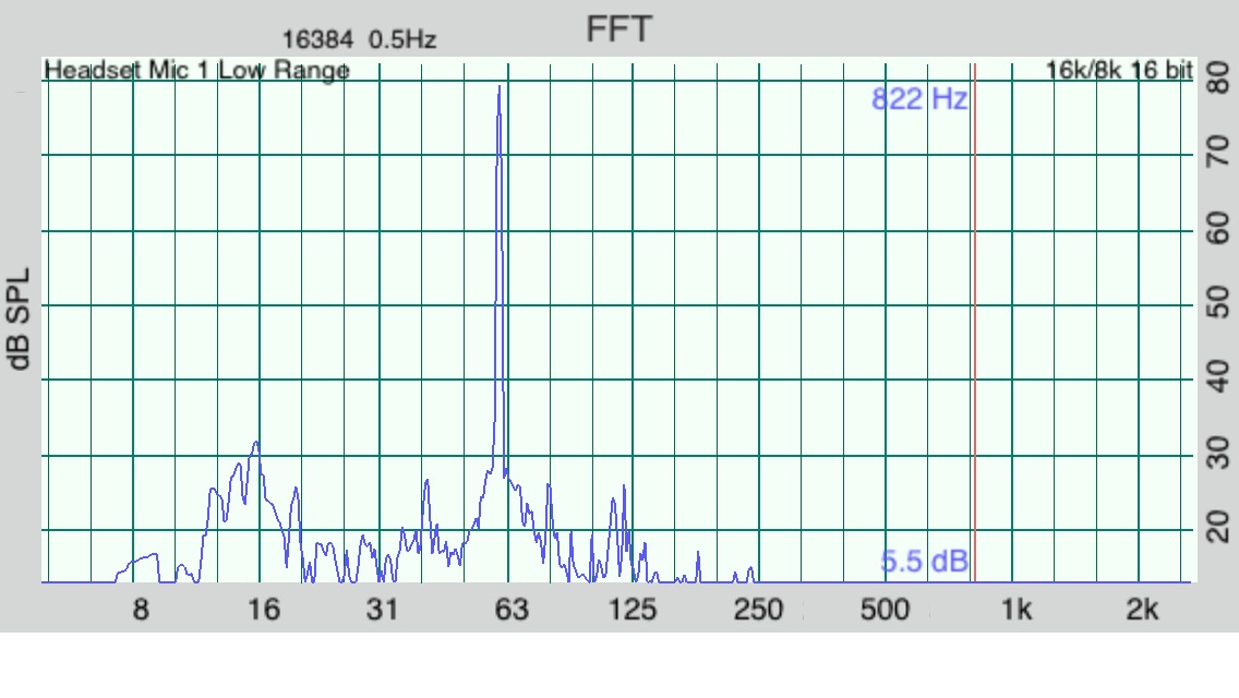

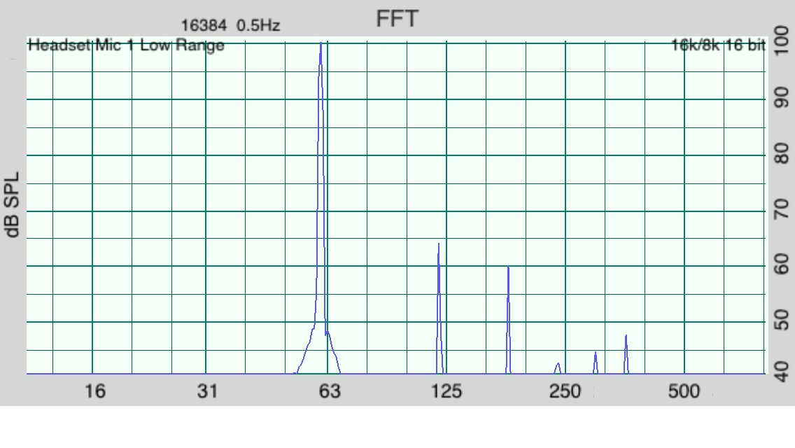

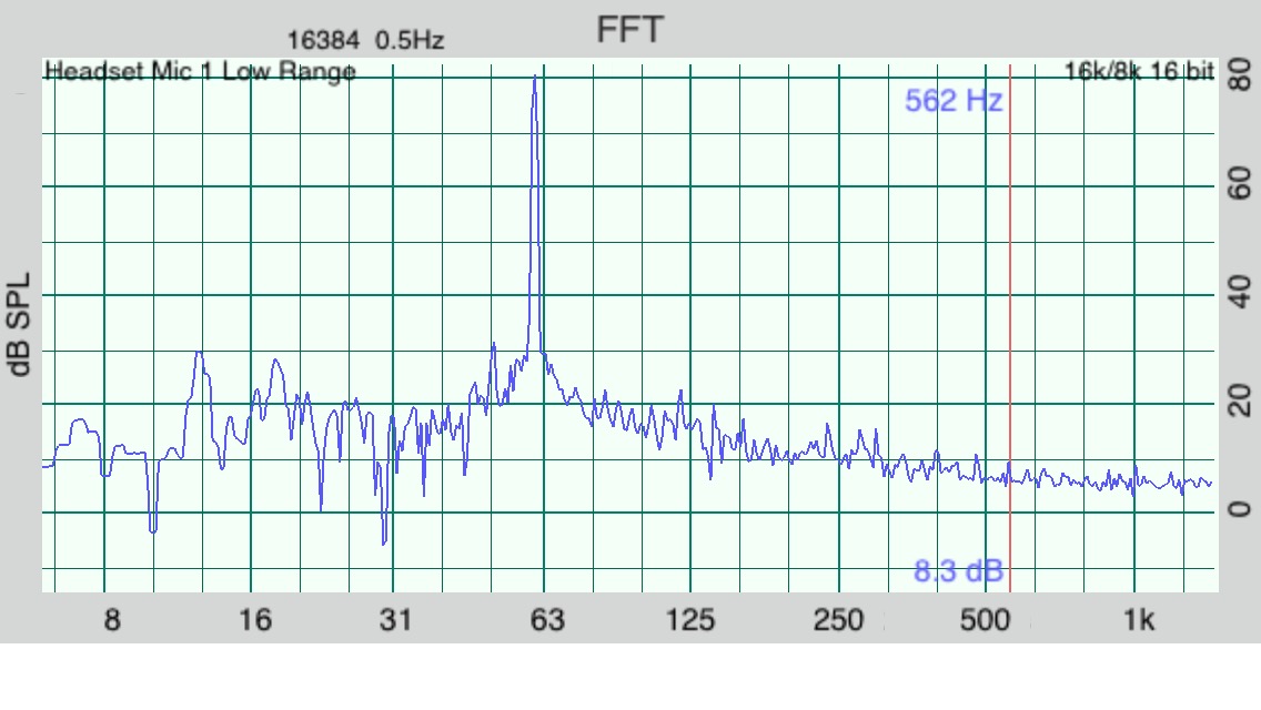

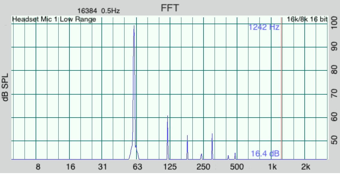

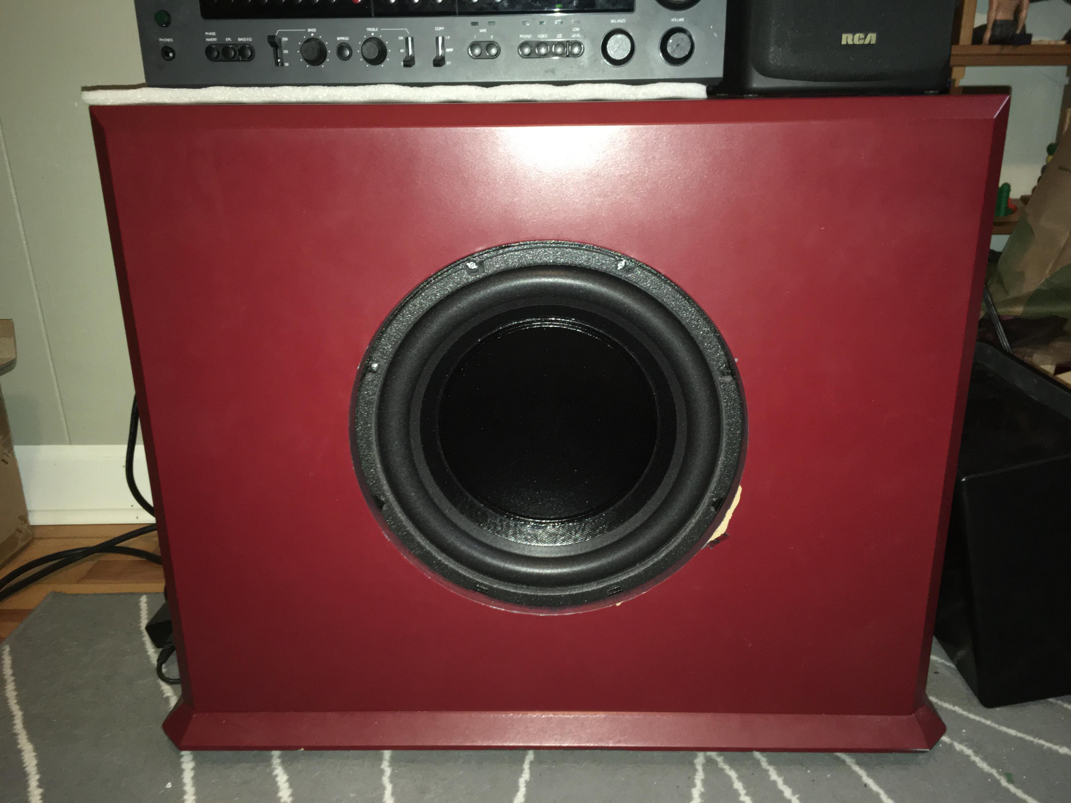

Next up is a Wavecor SW312WA03-01. This is a good looking and sounding driver. First test was in the 3 cu ft 38 hz ported tuning. This isn't a very ideal alignment for this driver, with a modeled 5db peak at 42hz but nevertheless there is good output below 50hz and good midbass articulation. I'm looking forward to testing this in the sealed and low tuned passive.
Here's the distortion measurements:
Frequency Spl of fundamental 2nd harmonic 3rd harmonic
16 60 -28 -22
20 72 -27 -24
25 84 -28 -30
31.5 86 -26 -32
40 103 -31 -27
50 110 -25 -40
63 111 -26 -56
attached is 60hz@80db and 100db

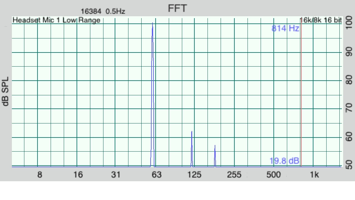

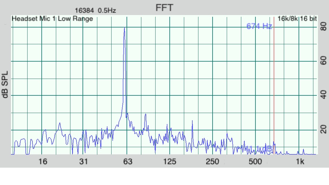

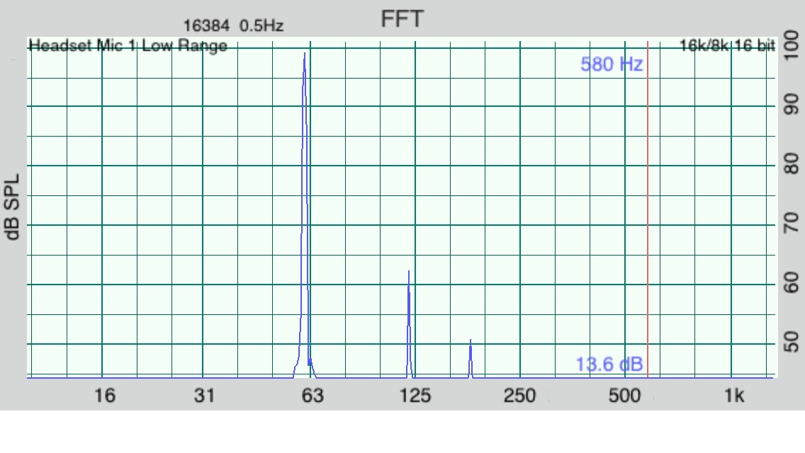

Next up the wavecor in a sealed 3 cu ft. (85 liter) configuration.
This is a great all around driver, especially as a music only sub. It seems it's motor structure is more optimized to 40hz and up. Check out how low the 3rd harmonic distortion is from 40-63hz.
It delivers strong midbass kick but a little less crisp than the diysg magnum. Upright bass sounds a little weak with notes around the 100hz crossover point.
16 71 -40 -25
20 73 -27 -22
25 70 -25 -30
31.5 62 -20 -34
40 92 -26 -41
50 109 -26 -44
63 111 -27 -49

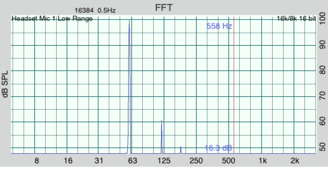

Last test with the wavecor is 3 cu ft with a 17.4 hz passive radiator tuning.
The passive radiator helps squeeze out an additional 16db at 20hz over the sealed version. The increased group delay of this design is pushed to such a low frequency that I couldn't notice a difference in transient response between the sealed and the passive. To me this is the best enclosure design for this driver of the three I tested.
I'm getting some cancellation at 31.5 hz in all my passive alignments.
16 73 -24 -37
20 89 -25 -23
25 80 -25 -32
31.5 60 -20 -26
40 96 -20 -34
50 110 -26 -34
63 111 -27 -49
attached is 60hz @80db and 100 db

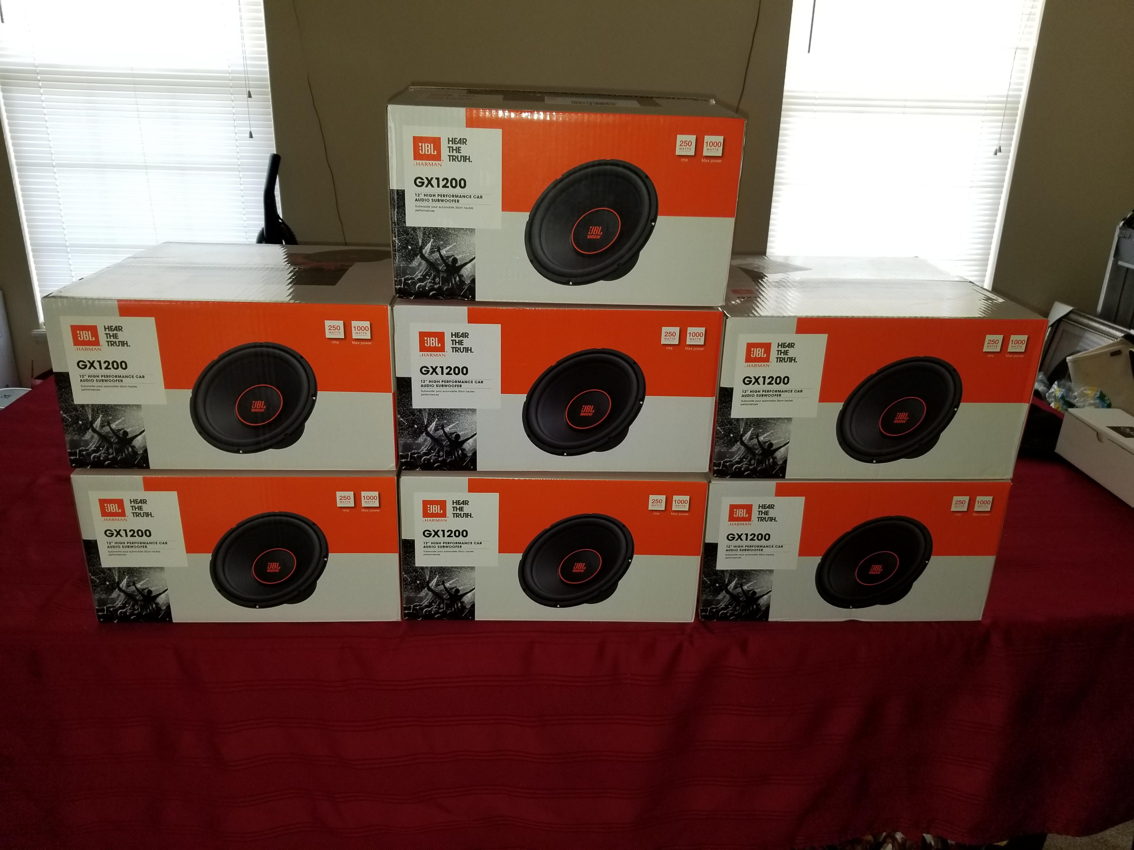

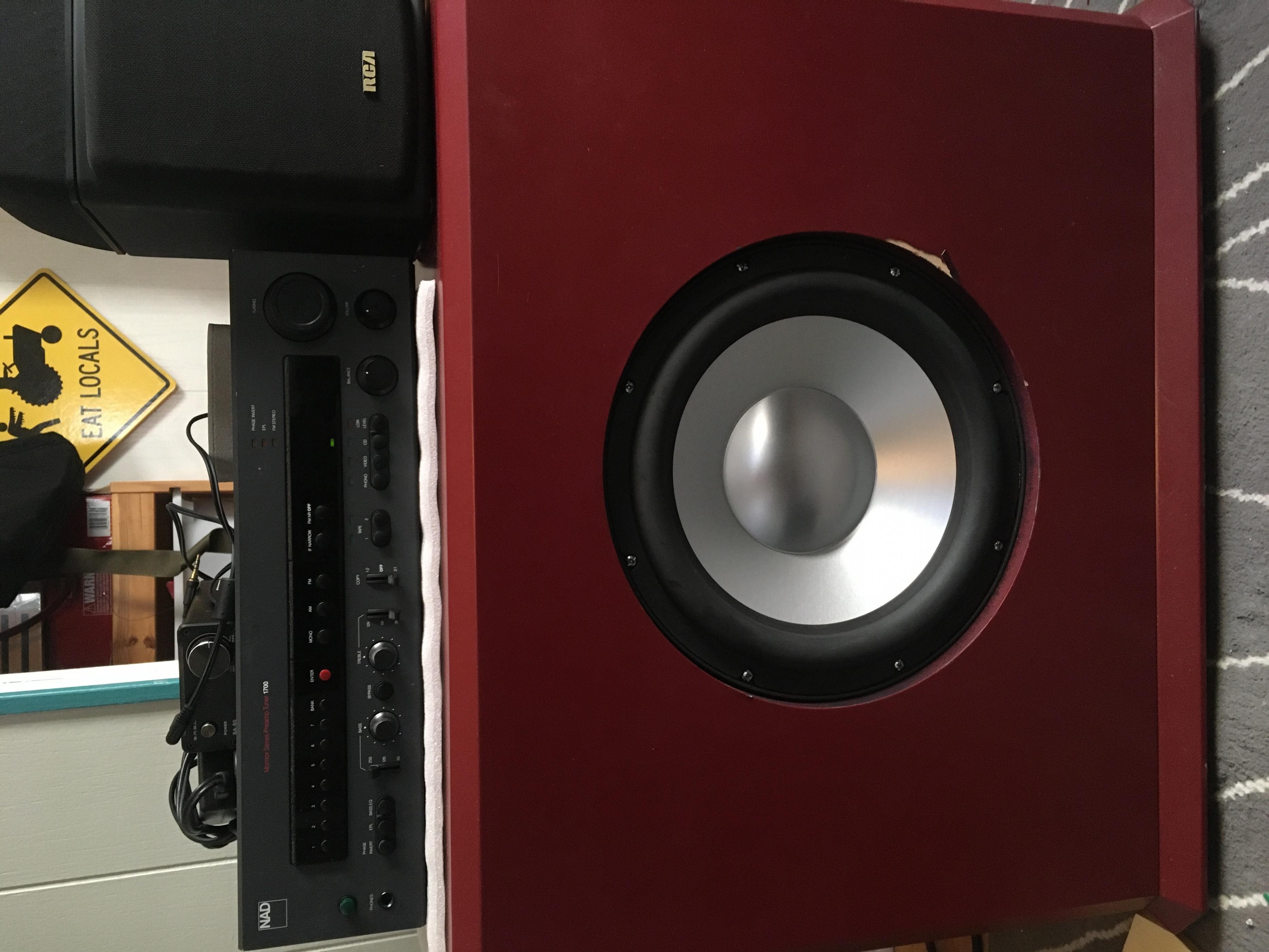

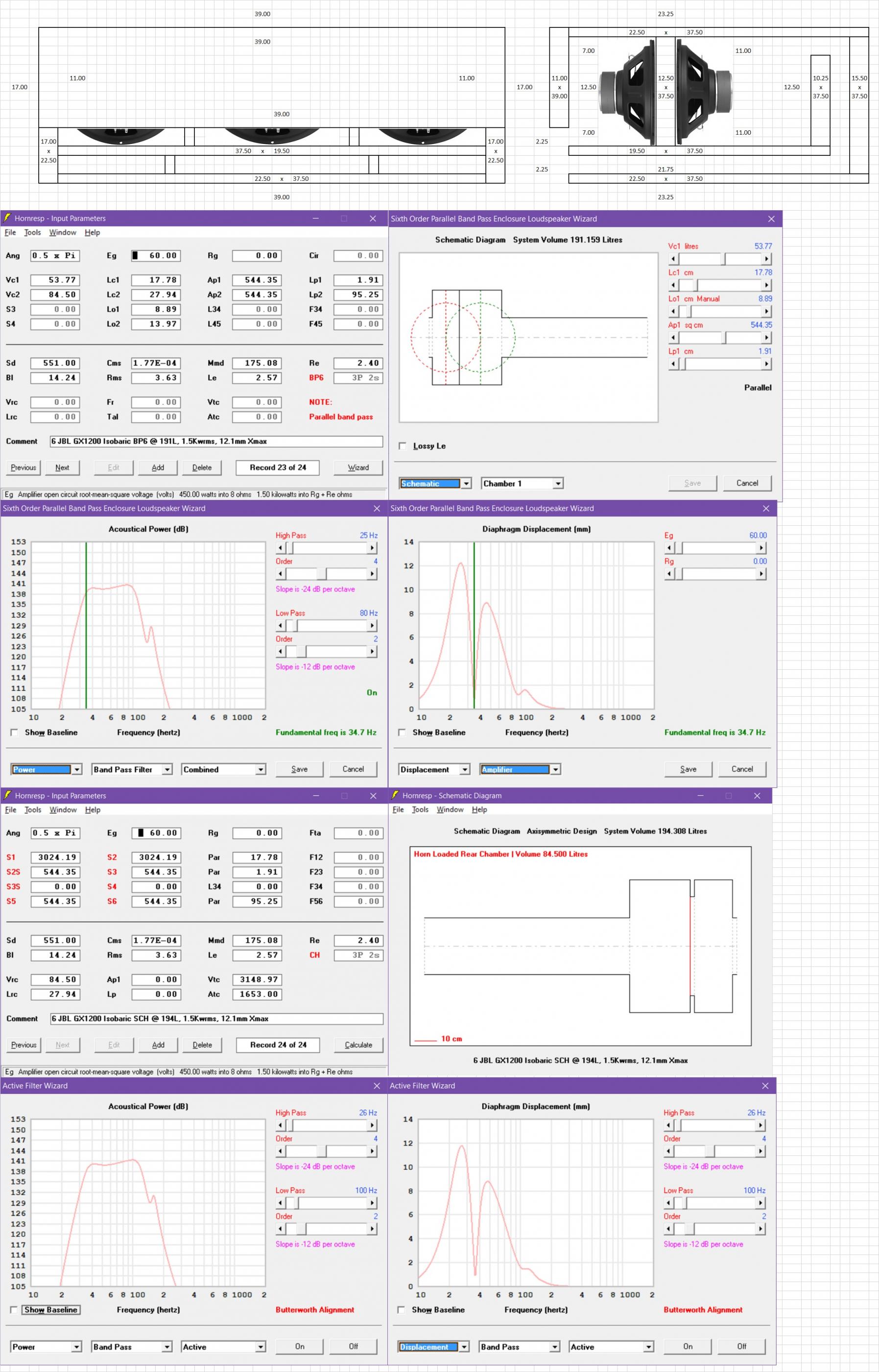

2 JBL's delivered yesterday. The wife and I are on way now to pick up 4 more now.
Here's what I modeled Friday night.
I like the way you push these areas with similar TS parameters. Double click on Le just for fun.. it’s a buzzkill for Rockford fosgate drivers I try to work around it..

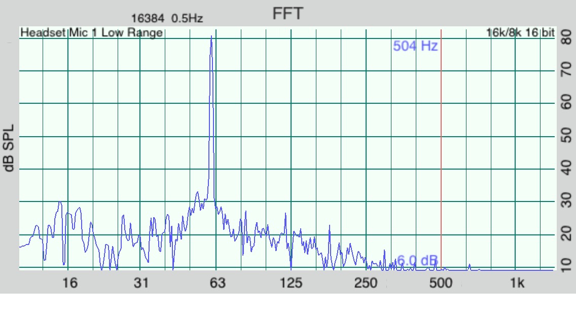

Next up is the Eminence Lab 12c in the 3 cu ft. sealed.
You can tell this drivers has roots in pro audio, when breaking it in I was working from a computer on another floor in my house and it sound like there was a band downstairs.
About an even tie for first with the Wavecor for highest spl 40-63hz in the sealed alignment of the six drivers I tested.
16 76 -34 -22
20 75 -30 -26
25 76 -24 -30
31.5 64 -22 -37
40 93 -24 -40
50 109 -26 -28
63 111 -25 -37

Next up is the lab 12c in the 3cu ft 17.4 hz passive.
At most frequencies this driver seems to reach suspension and electrical 5% distortion limits at about the same time. This resulted in a subjectively louder sound. I would recommend this as a home theater sub as it really had the windows shaking. To those that say the room vibrations are affecting my results I held the window pane from vibrating with no affect in the 2nd and 3rd harmonic levels.
However I would not recommend a high crossover point with this driver. Eminence recommends a frequency range of 20-100hz. I commend them for their honesty as other manufactures recommend a range up to 1500hz for their subwoofers and a quick frequency sweep will tell this not to be true.

Last test with the Eminence lab is 3cu ft 38hz vented.
I prefer the passive radiator alignment of the three.
