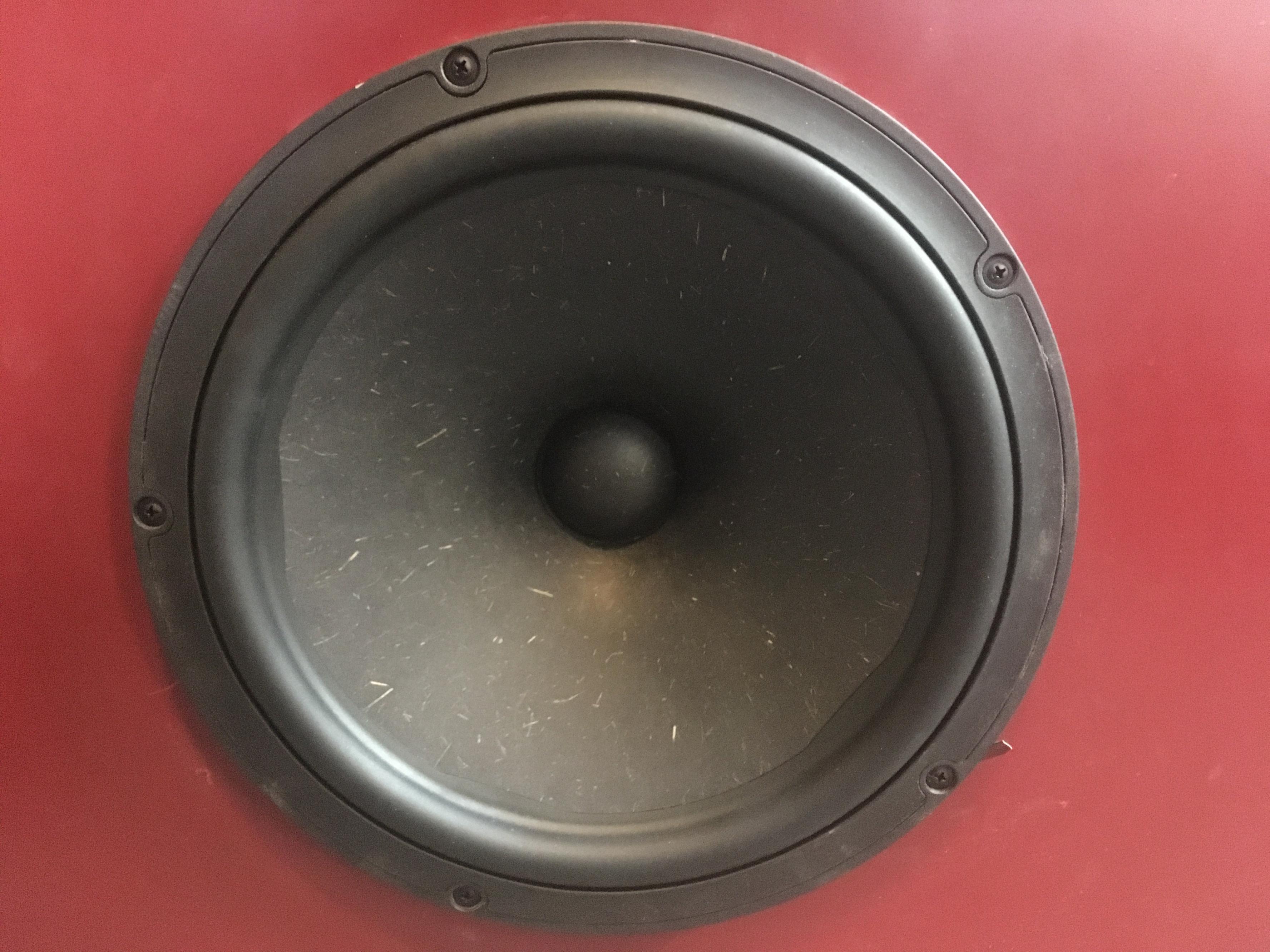

The next driver I tested is the Tympany NE315W-08.
This is one of the most attractive looking subs I've seen and the Neo magnet
makes it real light.

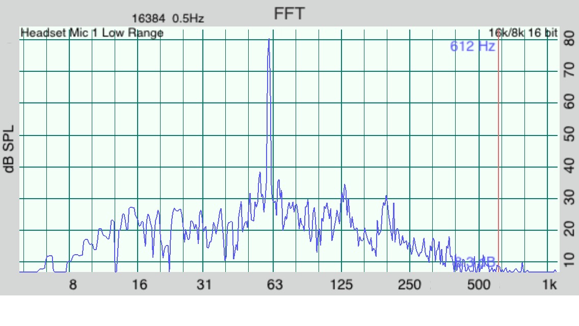

First off is the 85 liter sealed. At most frequencies 2nd harmonic distortion creeps up faster than 3rd, this is a similar result to when this driver was tested in Voice Coil magazine July, 2010.
Here's the distortion measurements:
Frequency Spl of fundamental 2nd harmonic 3rd harmonic
16 72 -36 -26
20 65 -25 -38
25 63 -23 -35
31.5 56 -19 -23
40 83 -24 -54
50 106 -36 -26
63 105 -26 -50
attached is 60hz @80db and 100 db

again attached is 60hz @80db and 100db
16 72 -36 -26
20 65 -25 -38
25 63 -23 -35
31.5 56 -19 -23
40 83 -24 -54
50 106 -36 -26
63 105 -26 -50
