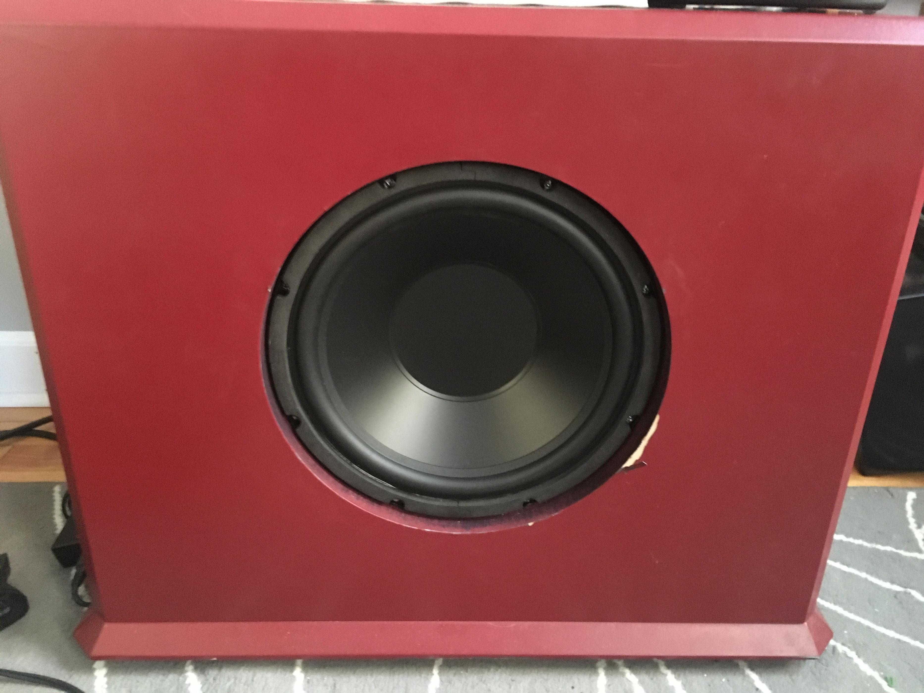

Thanks subwooer, I have updated them with dayton nd105s. Made a trim ring out of plywood. The Linaeums are great tweeters.
Keeping up with the thread namesake next up is another $15 sub, this time a little more modern. This is an open box GRS 12SW-4 a budget 12" sub from Parts Express.

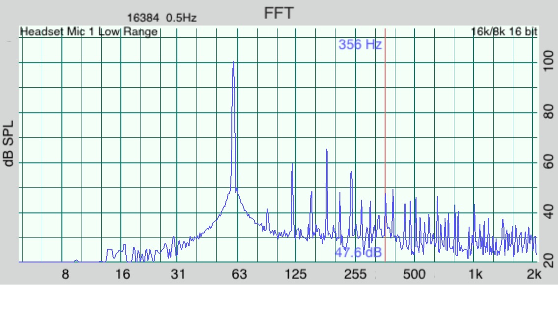

attached is 60hz @80db and 100 db

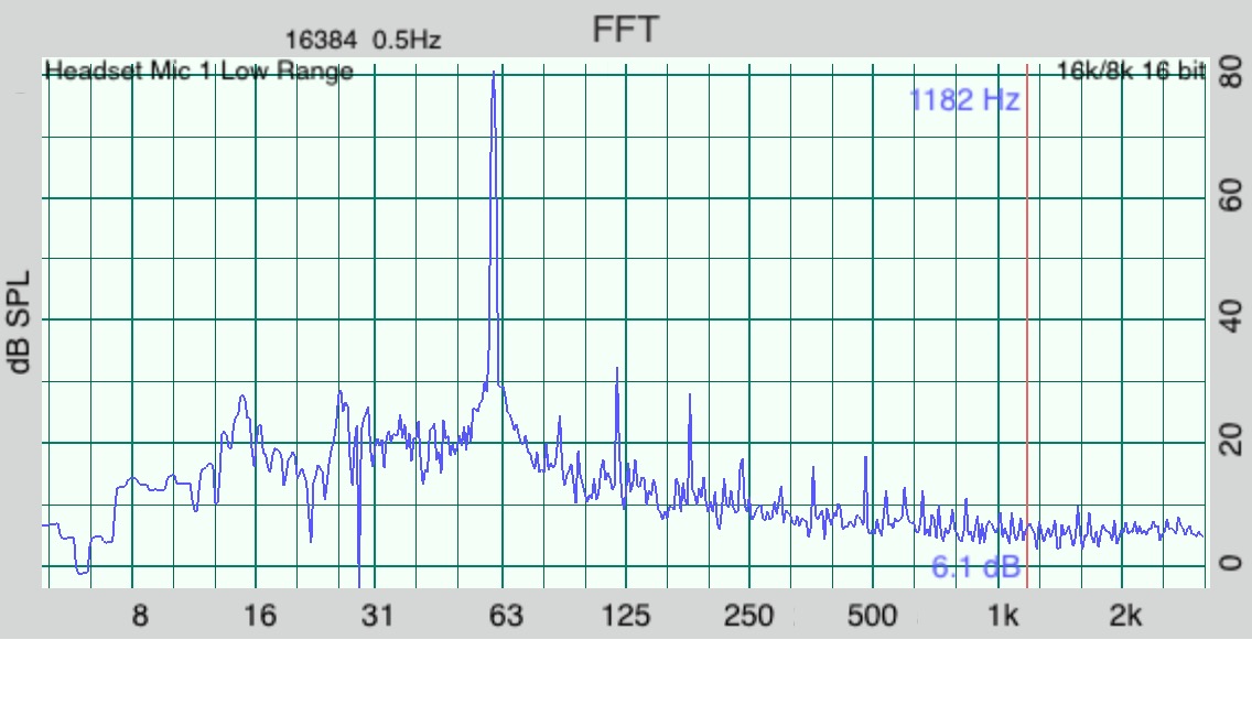

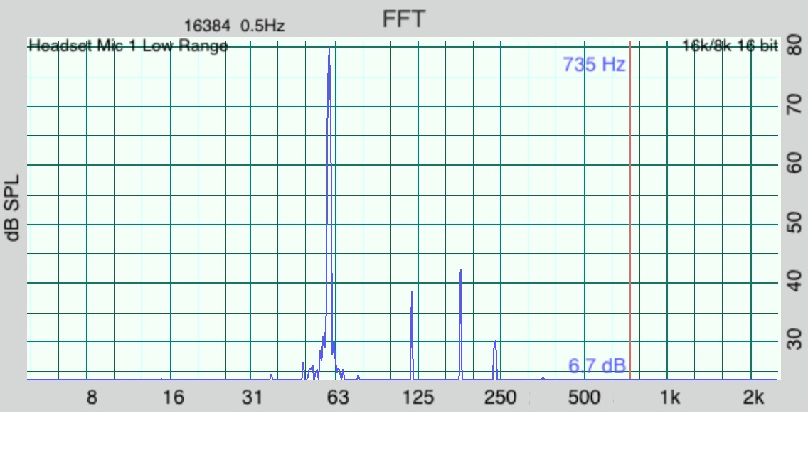

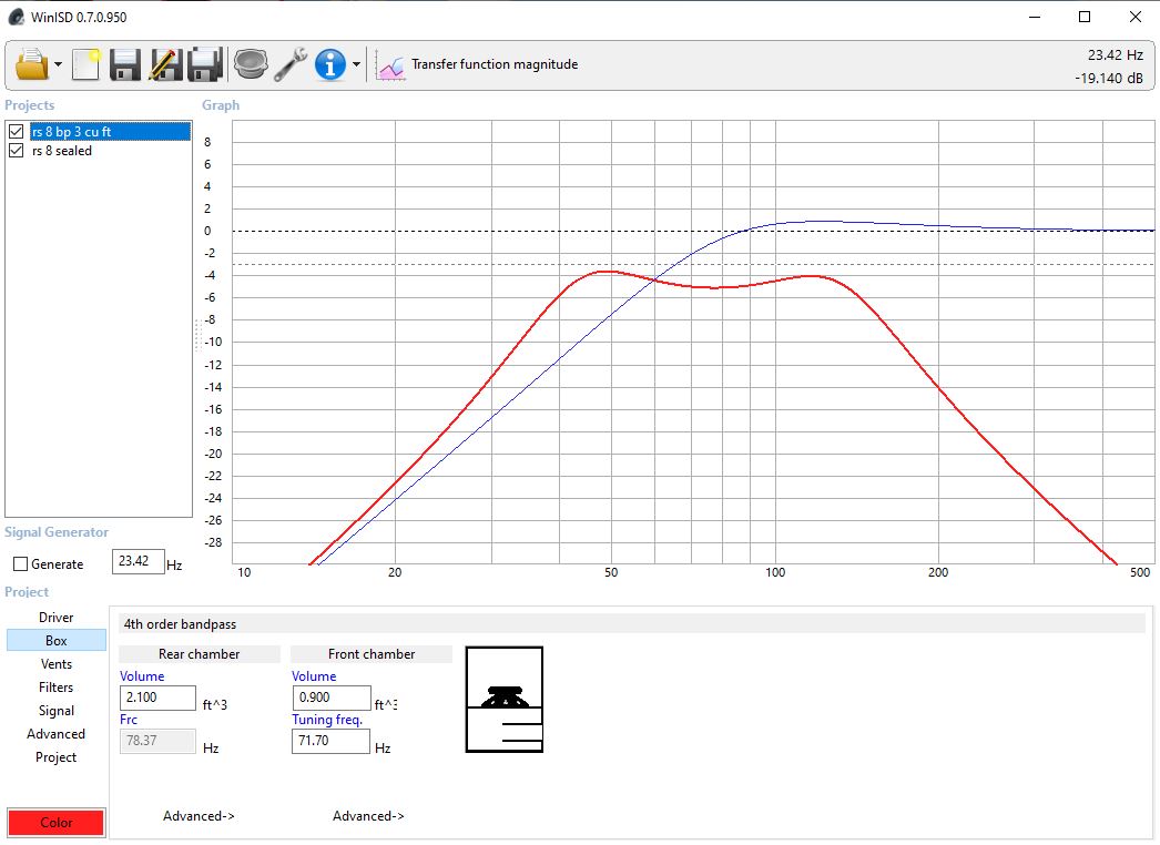

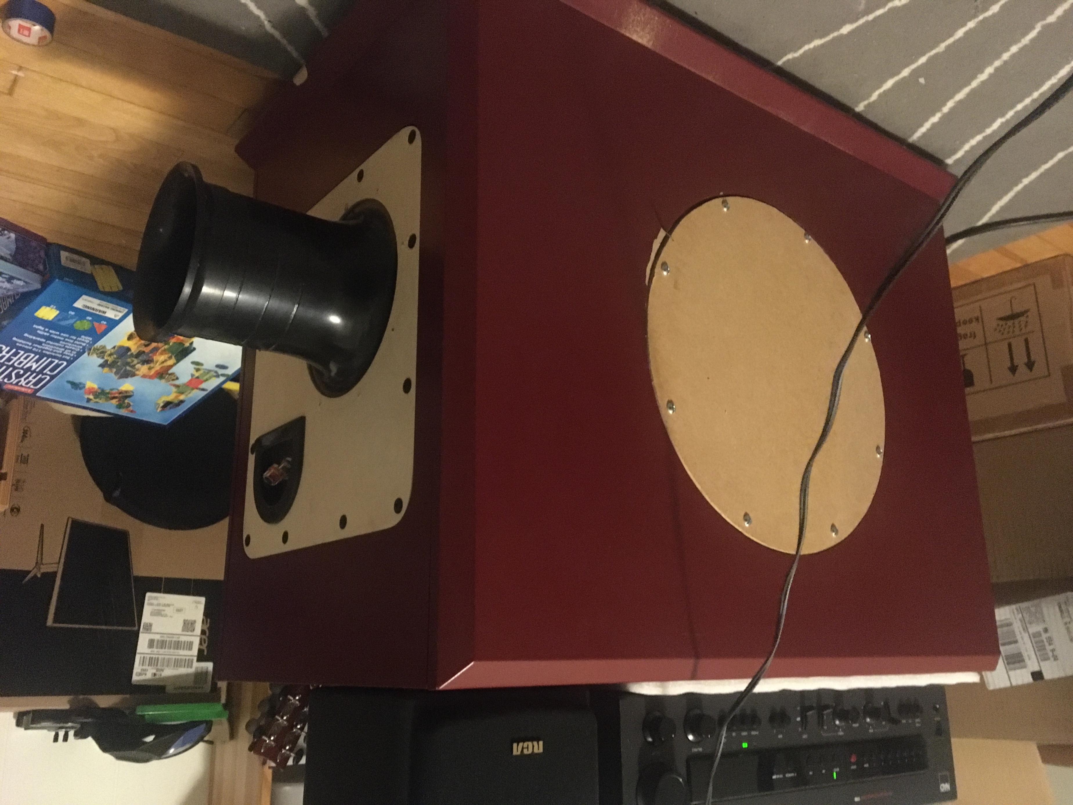

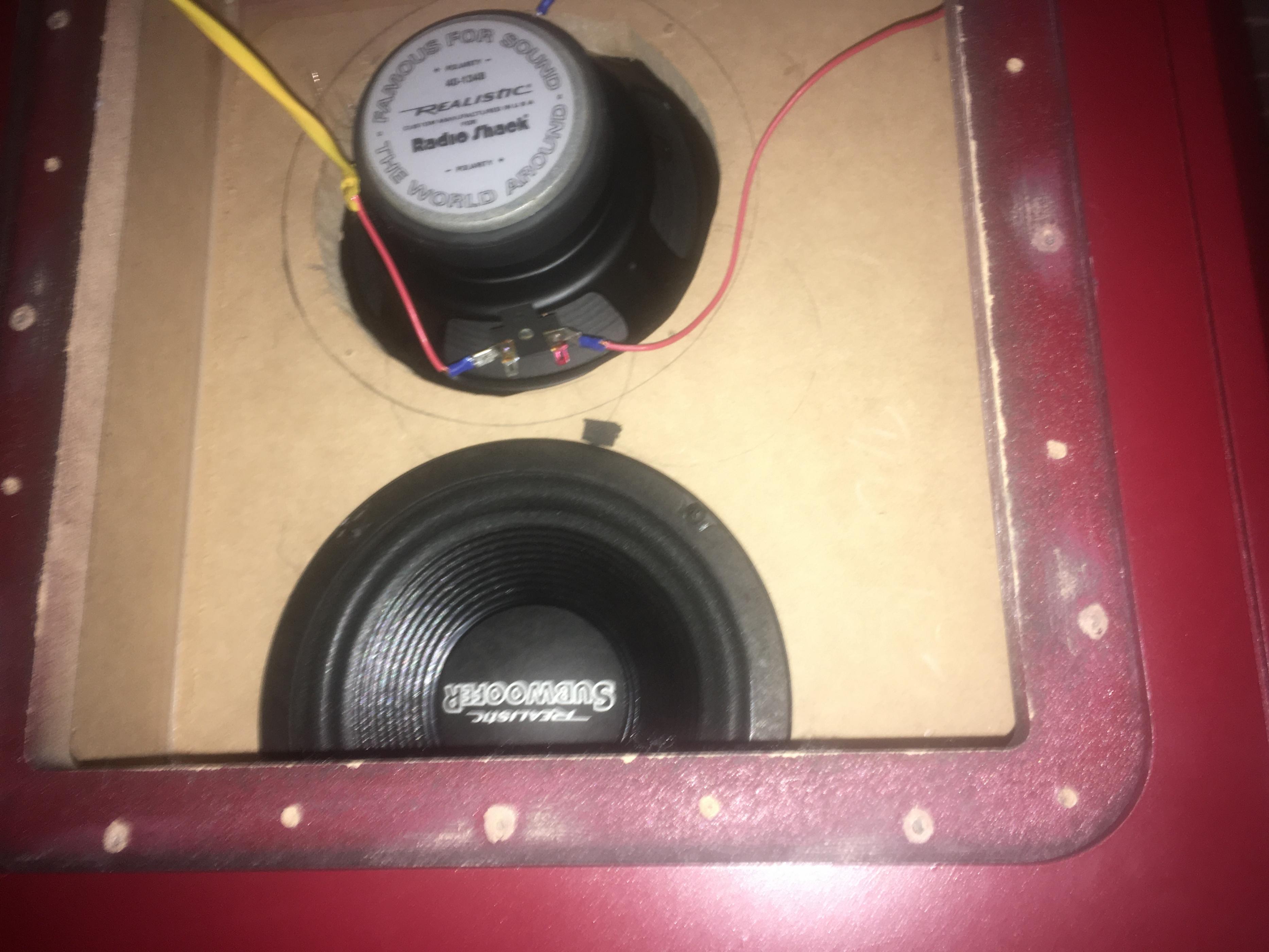

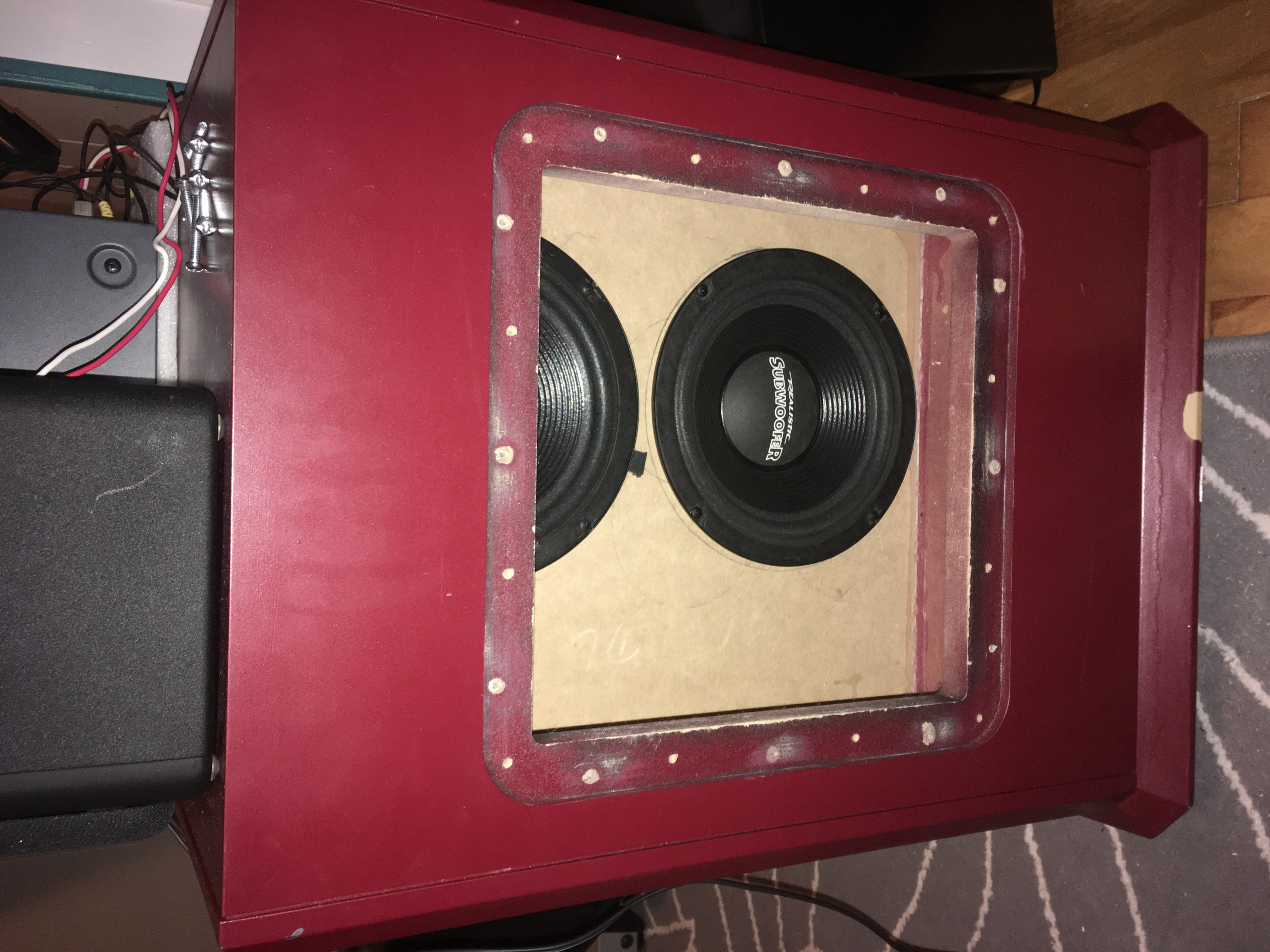

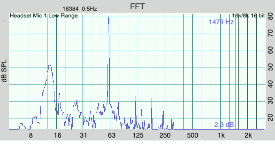

The next set of tests will demonstrate the effectiveness of using push-pull driver arrangement and 4th order bandpass for distortion reduction.
When I cut out the partition between the driver cavity and the plate amplifier cavity I cut 2 7" diameter holes. This allowed me two mount 2 old radio shack DVC subwoofers 40-1348. This should be a good driver for this test because it does a good job of producing distortion!
This setup is then a sealed cavity of 2.1 cu ft and ported cavity of .9 cu ft with a 4" diameter by 4.5" long flared port.

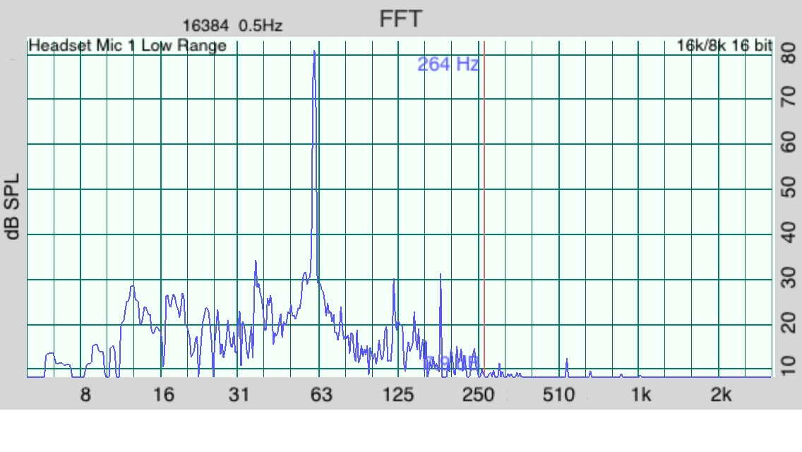

The first test was with out the front cover so basically two 8 inch subs in 2.1 cu ft sealed with standard mounting.
Here's the distortion measurements:
Frequency Spl of fundamental 2nd harmonic 3rd harmonic
16 70 -26 -25
20 56 -31 -19
25 64 -24 -34
31.5 55 -20 -31
40 56 -20 -25
50 91 -26 -37
63 99 -30 -25

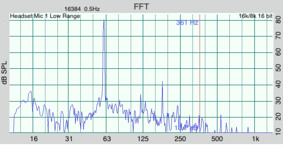

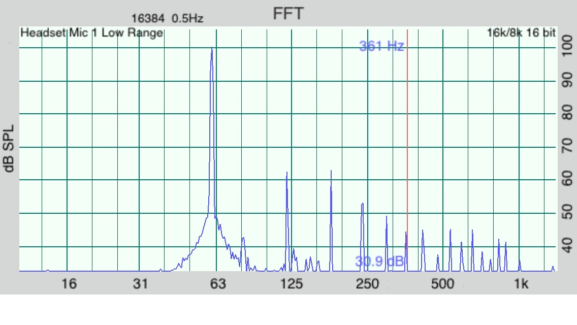

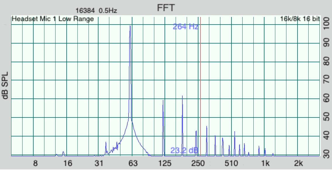

Next up is the same radioshack 8" drivers with the cover installed so this is a 4th order bandpass with both magnets in the sealed section. I've attached the pink noise RTA at the port. It's approximately a 50-120hz passband.
I had to stop the 50 and 63hz distortion measurements before I hit 5% distortion in the 2nd and 3rd harmonics as I was getting so much mechanical noise from the drivers that I was worried they would self destruct.
16 70 -24 -29
20 65 -25 -34
25 64 -24 -40
31.5 64 -23 -43
40 70 -25 -39
50 102 -30 -40
63 100 -35 -30

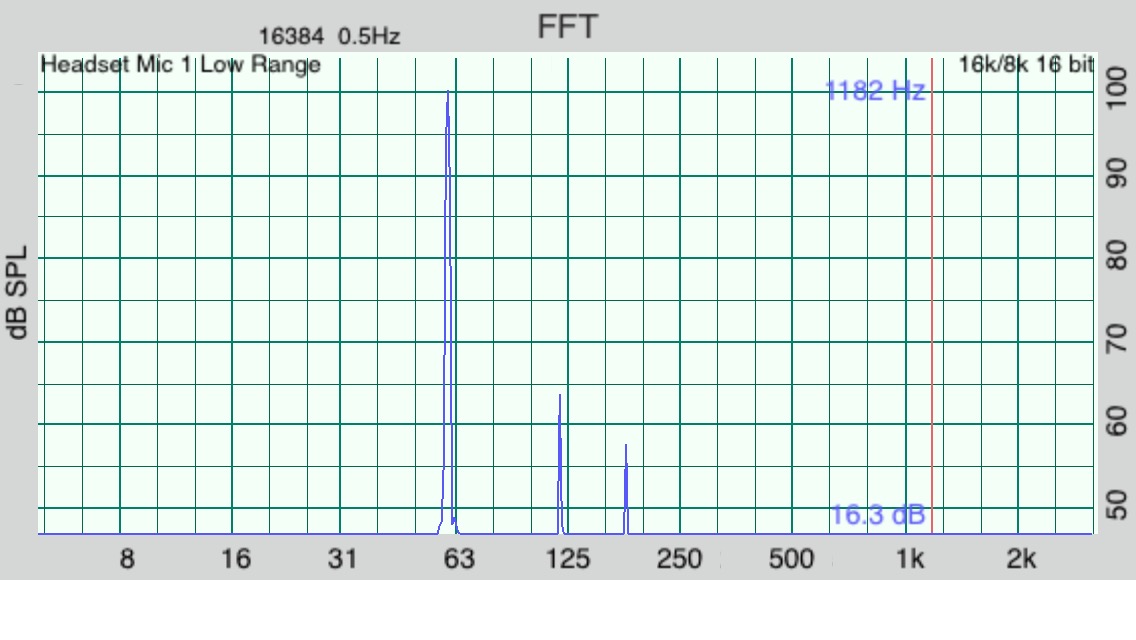

attached is 60hz @80db and 100 db and pink noise at the port.

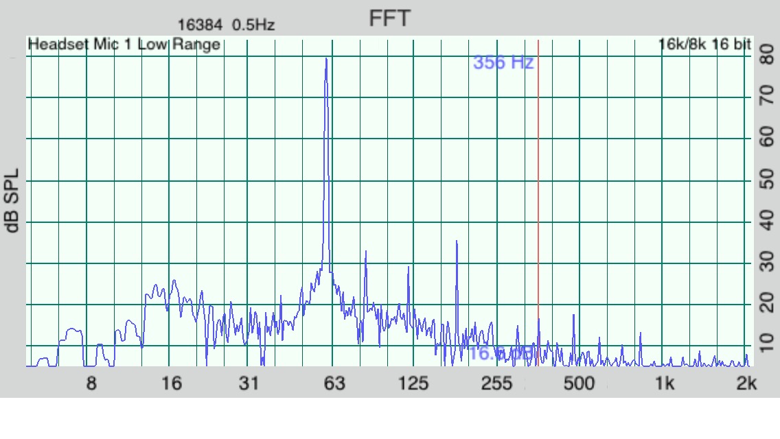

Ok next up is the same radio shack 8s sealed in push pull orientation.
More output 40hz-63 than the standard sealed but less below 31.5hz. However, with levels this low 50-60 db in the low bass I'm fighting against the noise floor so I wouldn't focus on this.
16 54 -35 -18
20 51 -27 -20
25 56 -21 -34
31.5 55 -20 -33
40 73 -26 -28
50 99 -39 -22
63 100 -40 -27

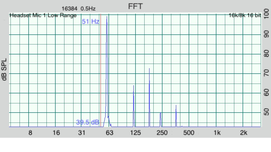

Final test in this series is keeping the push-pull orientation and with the cover. So it's a 4th order bandpass with the drivers in push-pull.
I wish I could live with the sound of this setup, the distortion is low but with the increased group delay and stored energy of the bandpass alignment every bass note sounds the same, kick drum, bass guitar, taiko drum are all just BOOM. Of the 4 variations using this driver the push-pull sealed variant sounded the best to me with music.
Again I capped the 50 and 63hz measurements off at 100db as I was getting a ton of mechanical noise. At 50 hz 5th order distortion is highest distortion product at -42db.
16 65 -41 -20
20 76 -30 -24
25 80 -25 -24
31.5 76 -25 -29
40 78 -25 -42
50 100 -49 -50
63 100 -38 -35

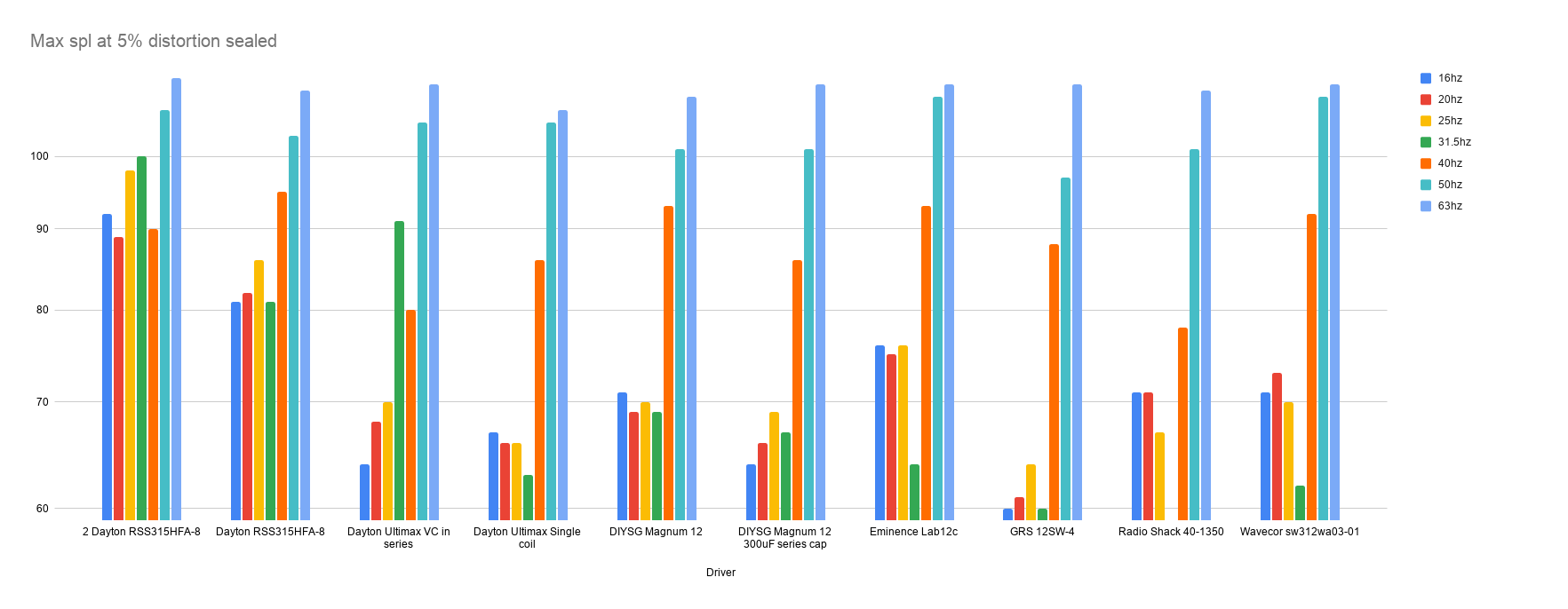

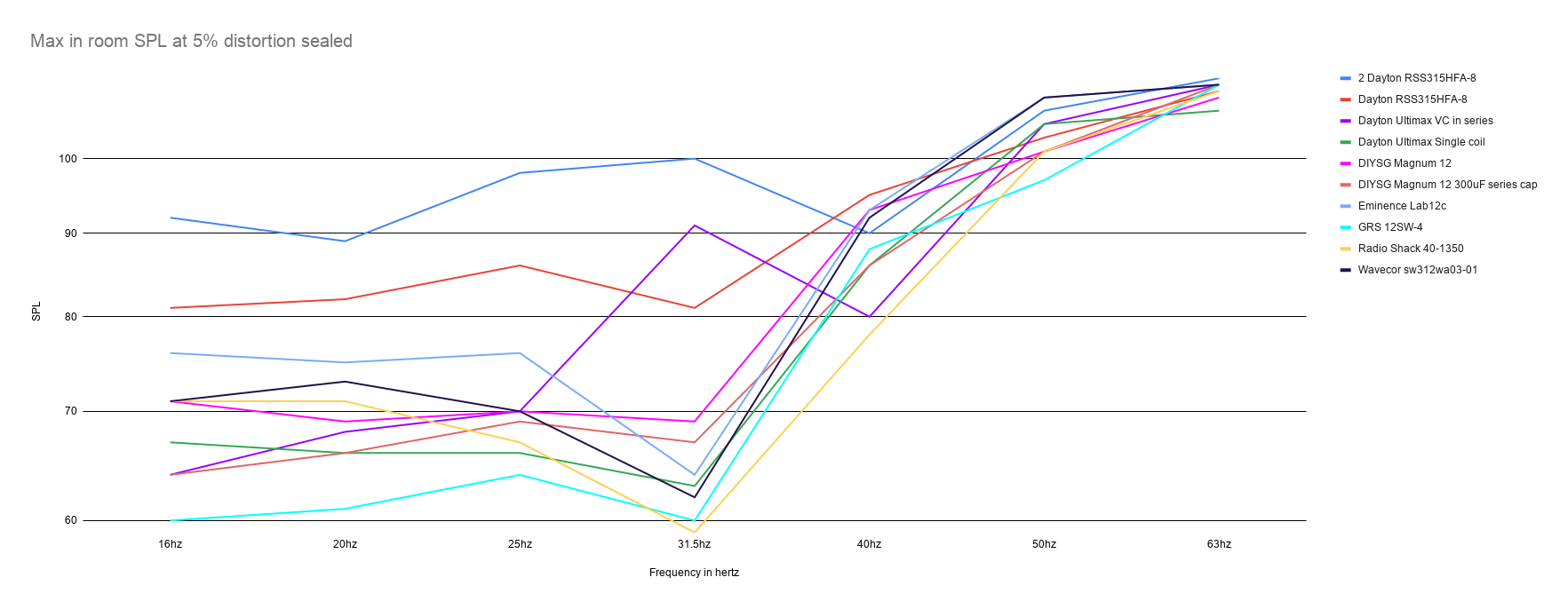

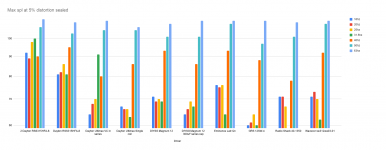

Your generic BP4 enclosure is probably not optimal for the speakers, hence the increased group delay and boom.
Can you post all 4 enclosures' frequency response and distortion measurements together?

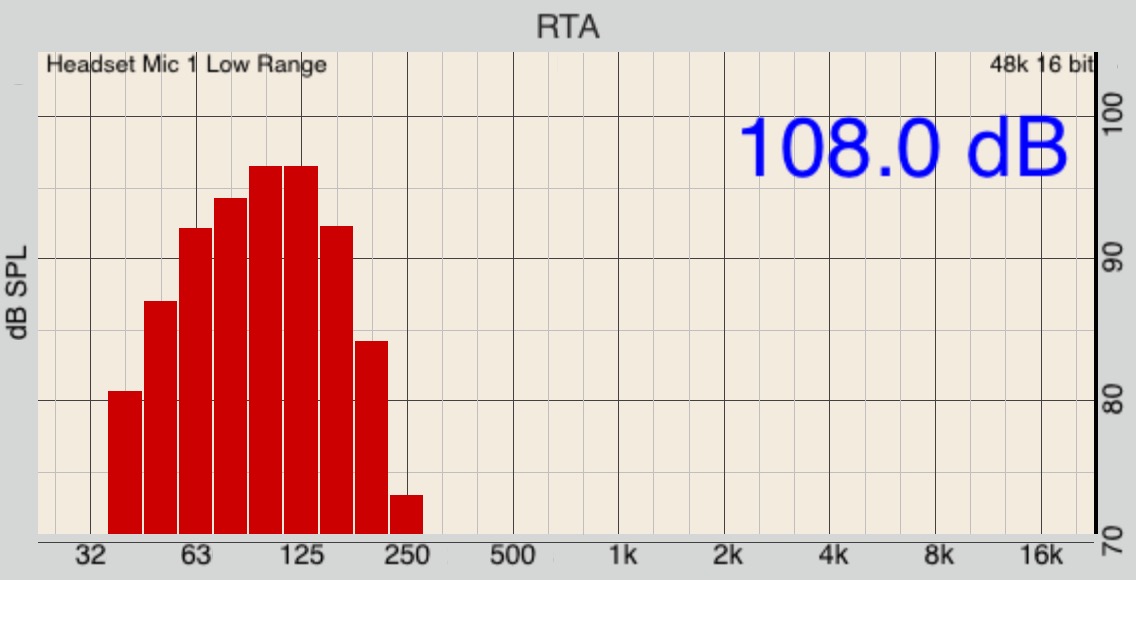

However BP1Fanatic, look at my measured pink noise frequency response which is showing a higher f3. I'm just going by published t/s parameter and hornresp is more accurate than WinISD at modeling bandpass enclosures I would think.
I was playing music while converting the box from the sealed to bp. I could notice a definite degrade in transient response after going to bandpass.
I'm thinking of a way to share my data. Would a excel graph be best or maybe google sheets so I could keep updating it?
