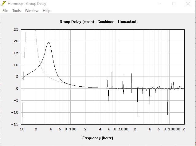

Attached is the group delay of the ported 38hz magnum in bold and the other line is the 20hz tuned passive. To me the higher group delay was audible in the ported version.
so the bottom end was all <sluggish> or phase funk, something wierd, ?
or was it just excessive and overbearing to the other speakers and sounds? as if it had crept up with more gain(not bad sound, just much of it maybe?)somehow?
Booger, I would describe it as the low bass thanks a little longer to build up to full volume and by that time it is behind the beat.
